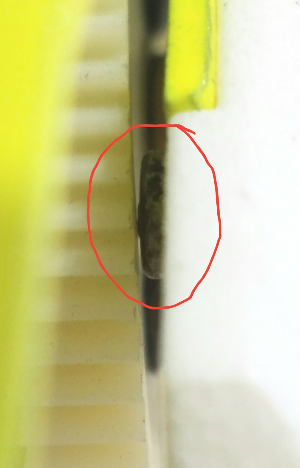

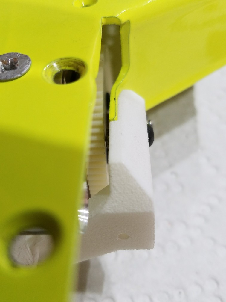

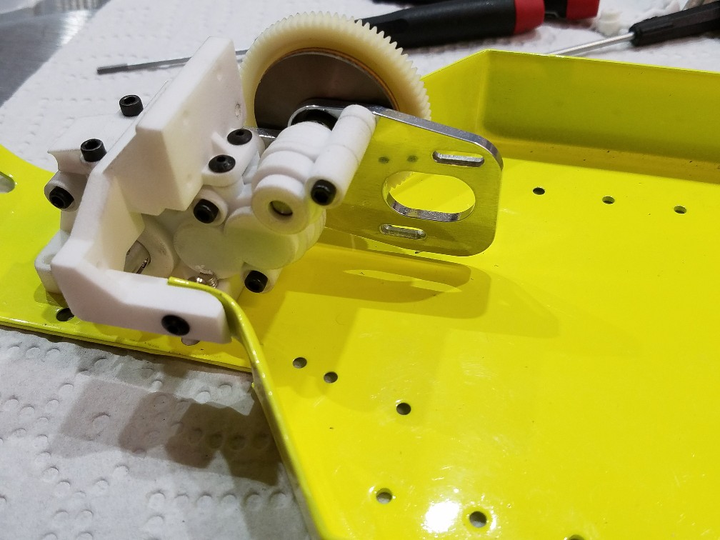

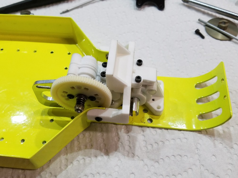

I'm getting very close to releasing the kit! I got the first motor plate sample today and it fits as good as it Looks!
As you can see, this assembly is put together with an original Stealth slipper. All the development to this point was based on a B4 top shaft and v2 slipper, so I wanted to check compatability for those that may want to run the Stealth setup. Well, it clears, but *barley*, versus the nut that holds the bulkhead and chassis tabs together.
I think I'm going to machine the inner slipper plate about 0.020" to give more clearance. For people who buy the kit and want to run a Stealth slipper I'll machine their inner slipper plate for free, no problem.
Also, I need a slight modification to the trans case to clear the Stealth slipper assembly. No big deal.
Other than that I need to order some tubing for the rear braces for those that want them, and make them up. I'll try to get some instructions together too, I've already been documenting the procedure with pictures. Getting oh so close.
