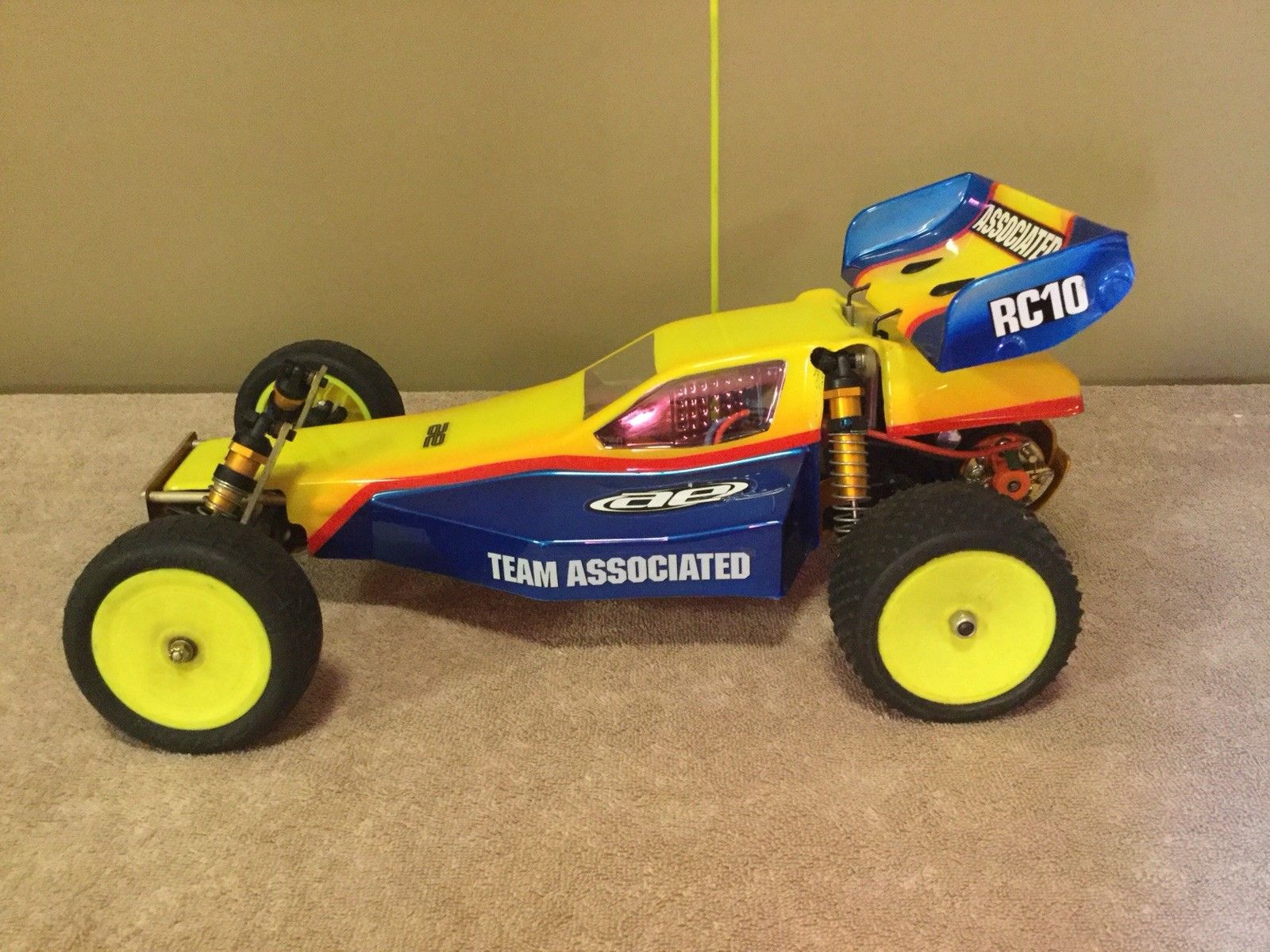

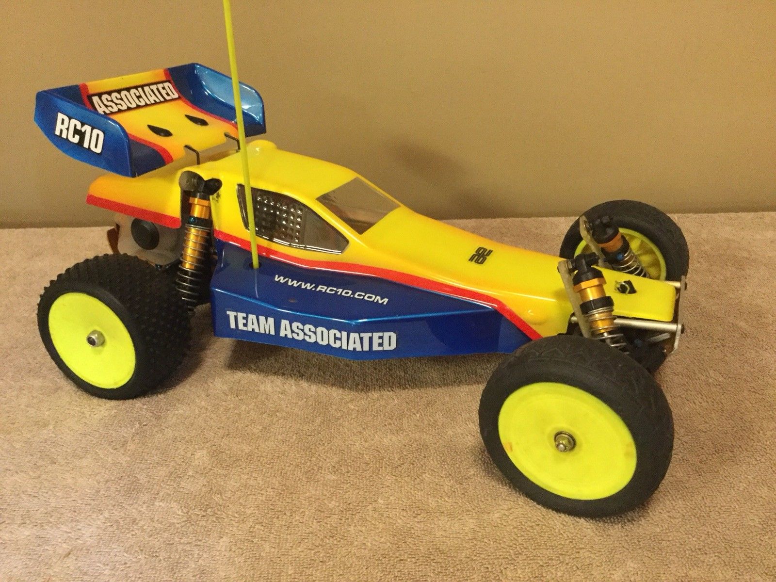

It lives!!
After having issues with one of the shiny, blue, front axles being out of spec. And (losing) a battle with a stripped grub screw. I've finally received and fitted a replacement.
Now I've been able to mount the wheels, test fit some electrics and see if it moves.
So far it's only done a little drive down our hallway and back. But it runs and drives
Next step is to firmly fit the electrics and mount the nicely painted body that I received yesterday. I also need to rebuild the diff with the proper lube as I could hear slipping even on the little test drive.
The electrics fitted are:
Reedy Sonic M3 17.5T brushless motor.
Trackstar Sportsman 60A brushless ESC
Bluebird 621DMG-HS servo

Pics will be coming, but I want to get the body mounted up first.
A friend of mine put a lot of effort into the body for me, so I want to get it fitted so I can show it as a whole.
Soon as I've done that, I'll post some pics and list out the changes/tweaks I've made (the ones I can remember anyway!)
