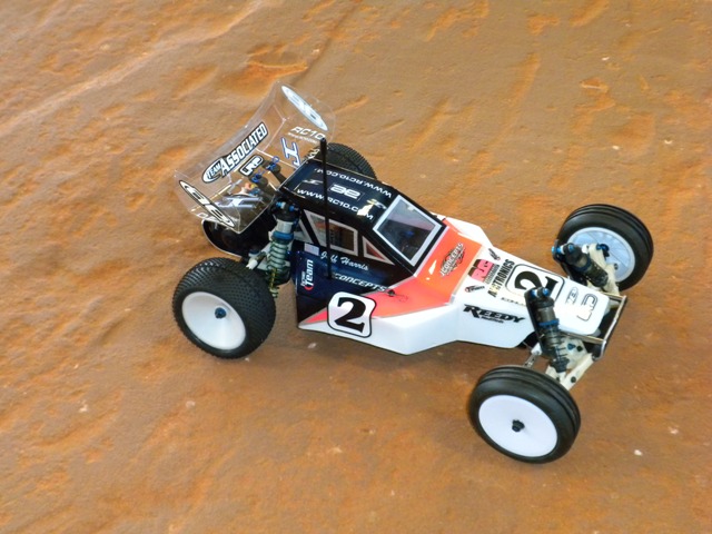

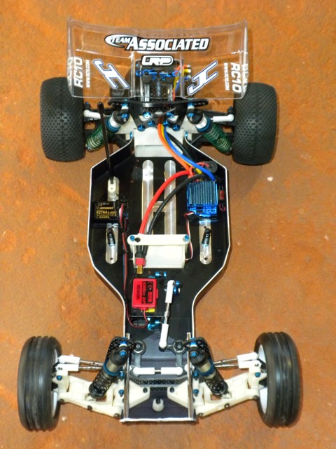

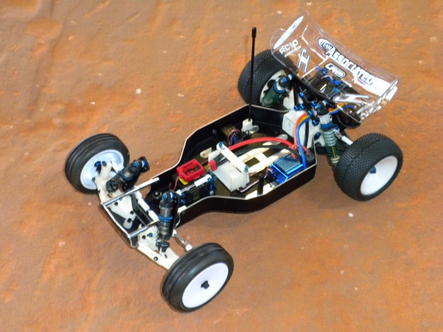

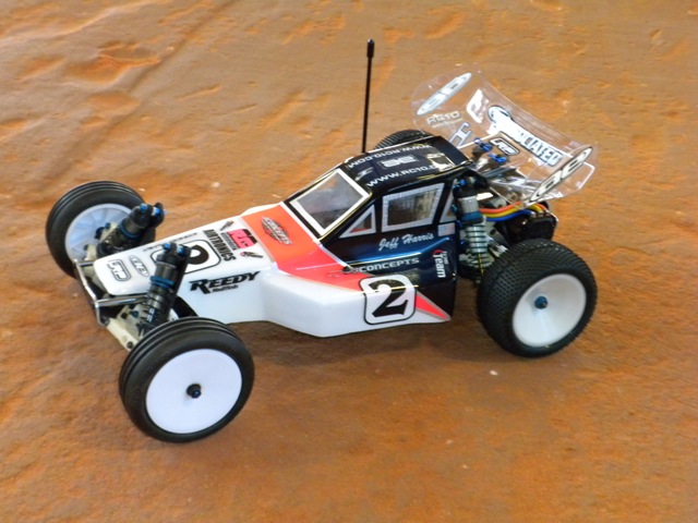

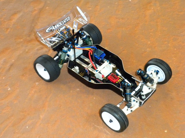

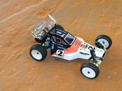

Here's the latest creation from the Harris garage. I'm working on getting a video put together of a run from last Sunday. The car uses stock suspension except that I use threaded shock bodies and the front uses the .89 B4 shocks. It really doesn't drive any better than it did with the .71's. The rear uses TT wheels (no, they don't fit the taper without reaming them) and the front uses B4 wheels by using the wide GT axles. Very simple and very straight forward.

JHarris, who did the machining on the chassis? I'm looking to do that on my next build too...

That looks like the car he was building for Ruona-JK Racing wrote:JHarris, who did the machining on the chassis? I'm looking to do that on my next build too...

The milling was done by Jake.
The car is very similar to Ruona's cars, but not the same. Jason's cars are 100% pre-94, all the way down to the RCPS turnbuckles and white AE ball cups. Mine uses Atlas towers, threaded shocks, Lundsford turnbuckles and JConcepts ball cups. Similar, but not the same.

Agree, this car is absolutely beautiful!!!
And when he let me drive it it drives so easily, you can put it anywhere you want and it works well!
