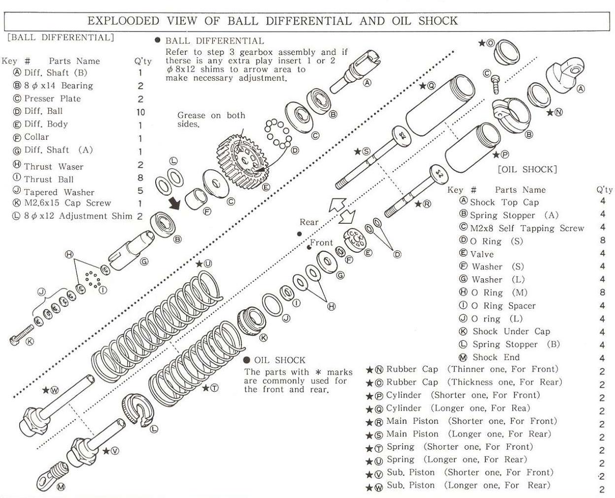

And there is one difference more to Gold or many other shocks: The rubber cap/diaphrams is different in front shocks and rear shocks. In rear the volume for air should be bigger. See pic below, rubber cap parts are N & O :
Jirka- Lonestar
