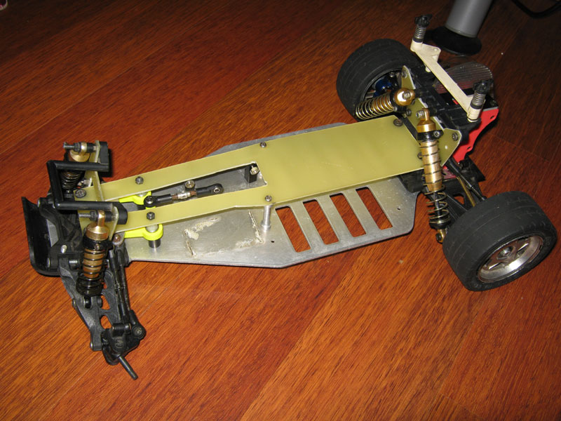

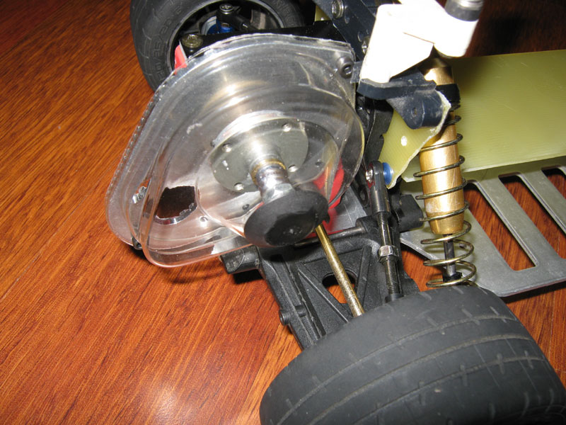

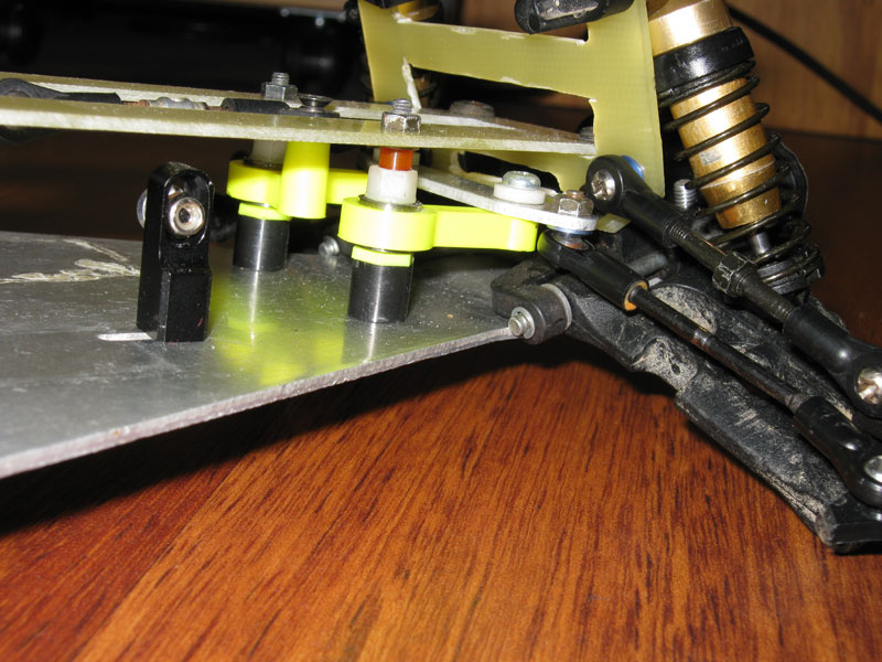

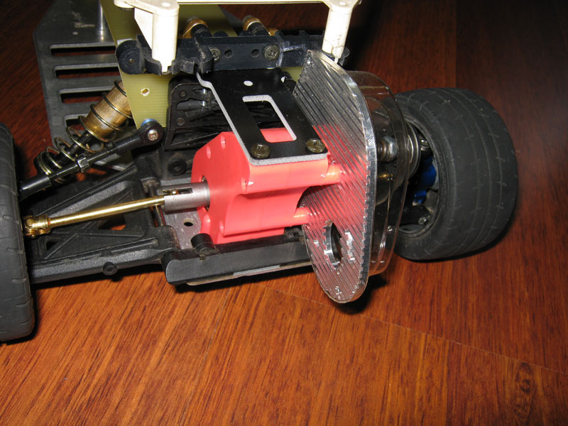

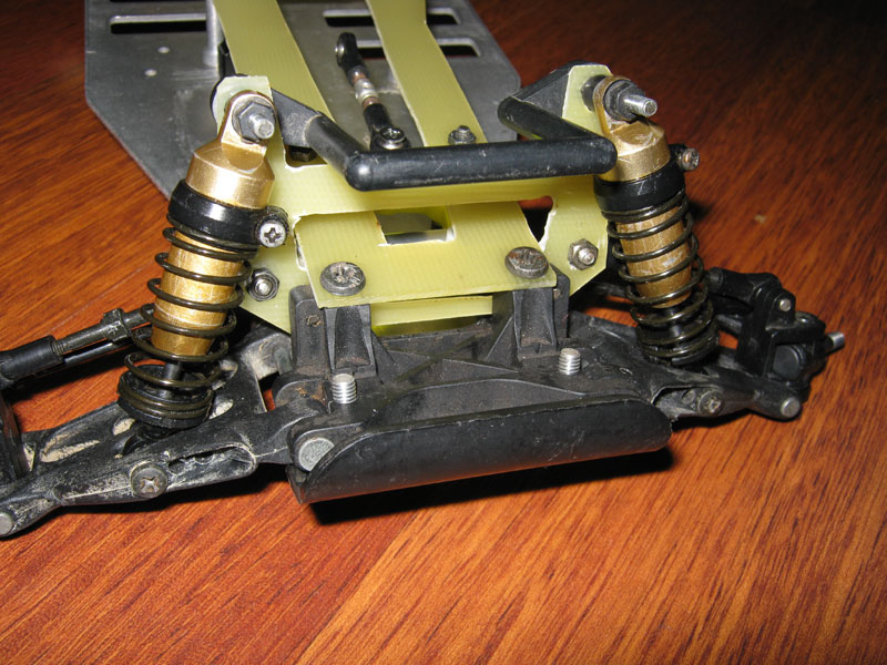

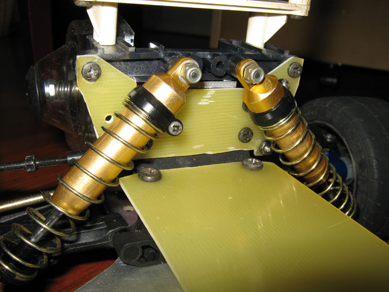

Realized I never actually posted any pictures of the car's current condition, so here we go:
As the project stands, with custom top deck and shock towers: Still have to figure out a custom battery mount system. I might make a new top deck that moves the servo to the right side of the car just in front of the rear shock tower, so I can put the battery in lengthwise...
Front end, with homemade fiberglass shock tower with some reinforcement compared to the stock piece, Rampage front bulkhead and hinge pins and bumper, refreshed gold shocks, and some turnbuckles: Steering comes from a Factory Works set for the Spider GP with some original assembly to make everything work bumpsteer free: Homemade rear tower: The rear end had the transmission replaced with an A&L Lethal Weapon 2 tranny in hot pink, with the A&L slipper: The rear arms are stock, the rear uprights are 3Racing parts for the TF-5 that I had left over from another project. They required some spacing using shims to get them in the right place. The universals are modified Cross FW-03 Super10 universals with a spacer added and alloy Tamiya drive hexes. I also used a GP-10 shock mount set by Cross on the rear shocks and replaced the original springs with some softer ones from a GP-10. The rear end is narrowed compared to the stock pieces, which works better with the Porsche body:

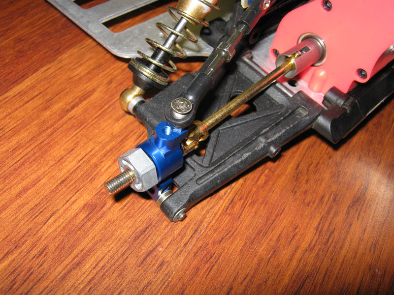

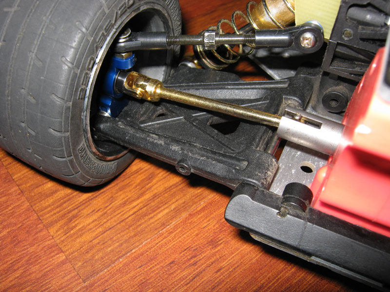

Looks interesting, EvoRevo...I like those Cross U-joints, are they stock Optima length? I'd love a set of those for my Zebra Optima.

The dogbone part is somewhat shorter by about 4-5 mm, while the outdrive part is the same longer. Because the Super 10 uses different upright bearings I also had to pry off two alloy 'hats' that allow the outdrive to sit deeper inside the uprights.Coelacanth wrote:Looks interesting, EvoRevo...I like those Cross U-joints, are they stock Optima length? I'd love a set of those for my Zebra Optima.

Actually, I just realized those aren't dogbones, they're universals. Weren't gold universals an optional Option House item for...was it the Rocky or Turbo Rocky or something? Just wondering if those weren't actually made by Cross, but Kyosho Option House...EvolutionRevolution wrote:The dogbone part is somewhat shorter by about 4-5 mm, while the outdrive part is the same longer. Because the Super 10 uses different upright bearings I also had to pry off two alloy 'hats' that allow the outdrive to sit deeper inside the uprights.Coelacanth wrote:Looks interesting, EvoRevo...I like those Cross U-joints, are they stock Optima length? I'd love a set of those for my Zebra Optima.

As evo mentioned higher up these are 4-5 mm shorter than the optima ones. You can tell cause the optima ones would never fit between the outdrives and those rear axle carriers.
(the optima rear carriers having lots more offset)
