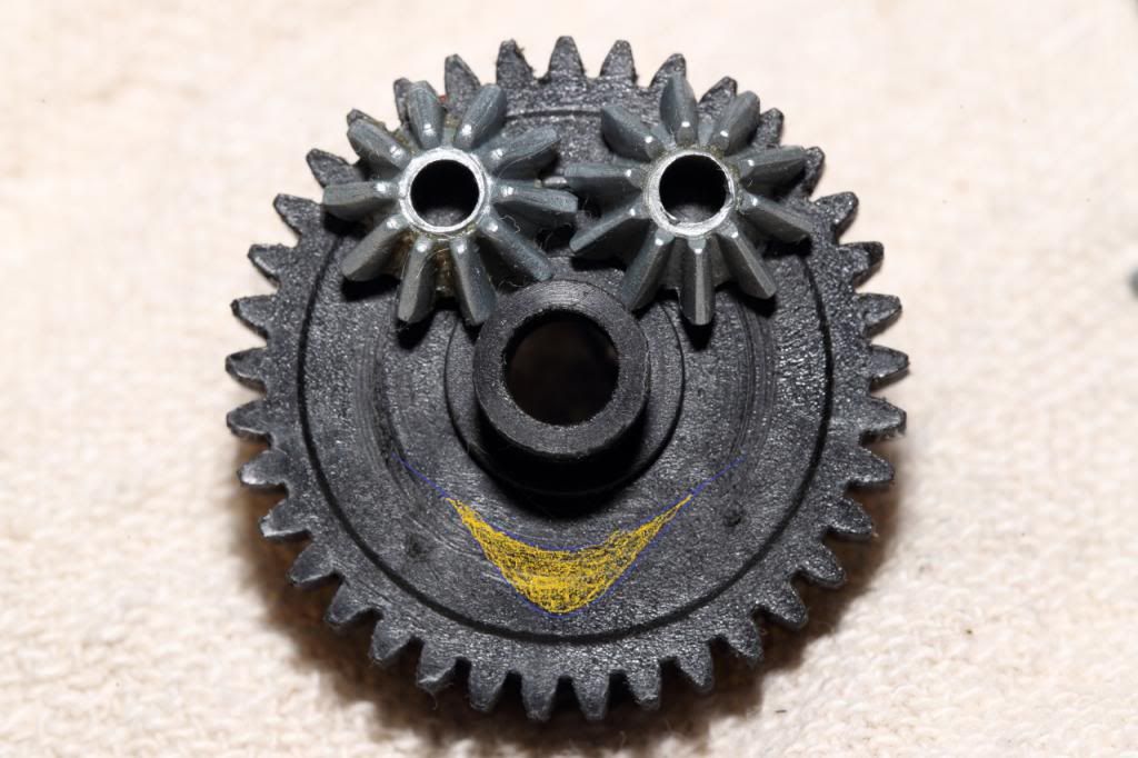

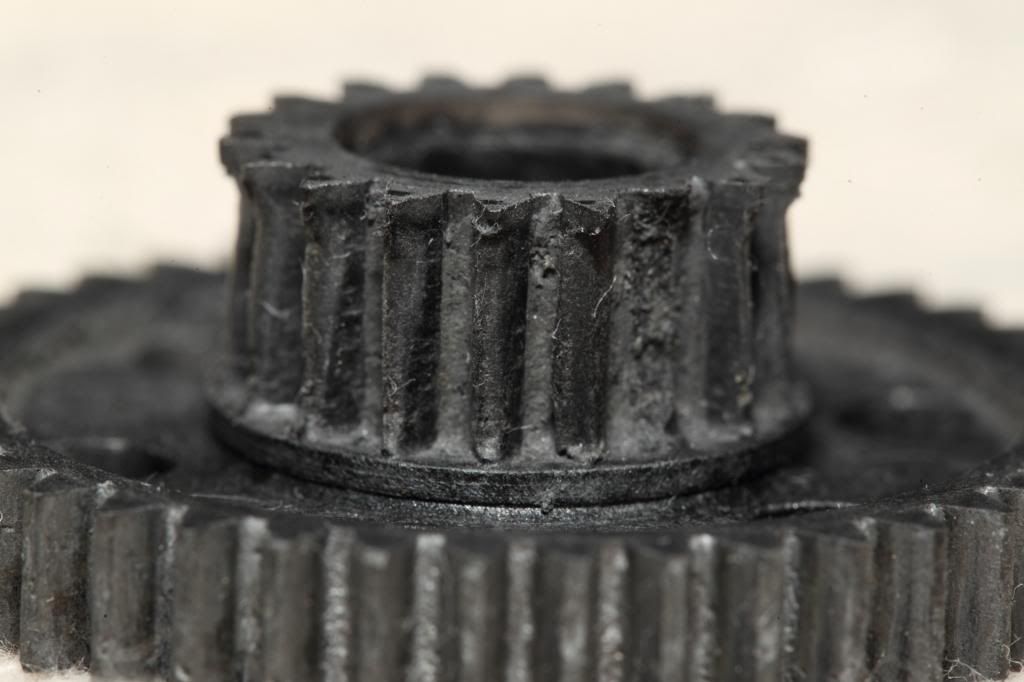

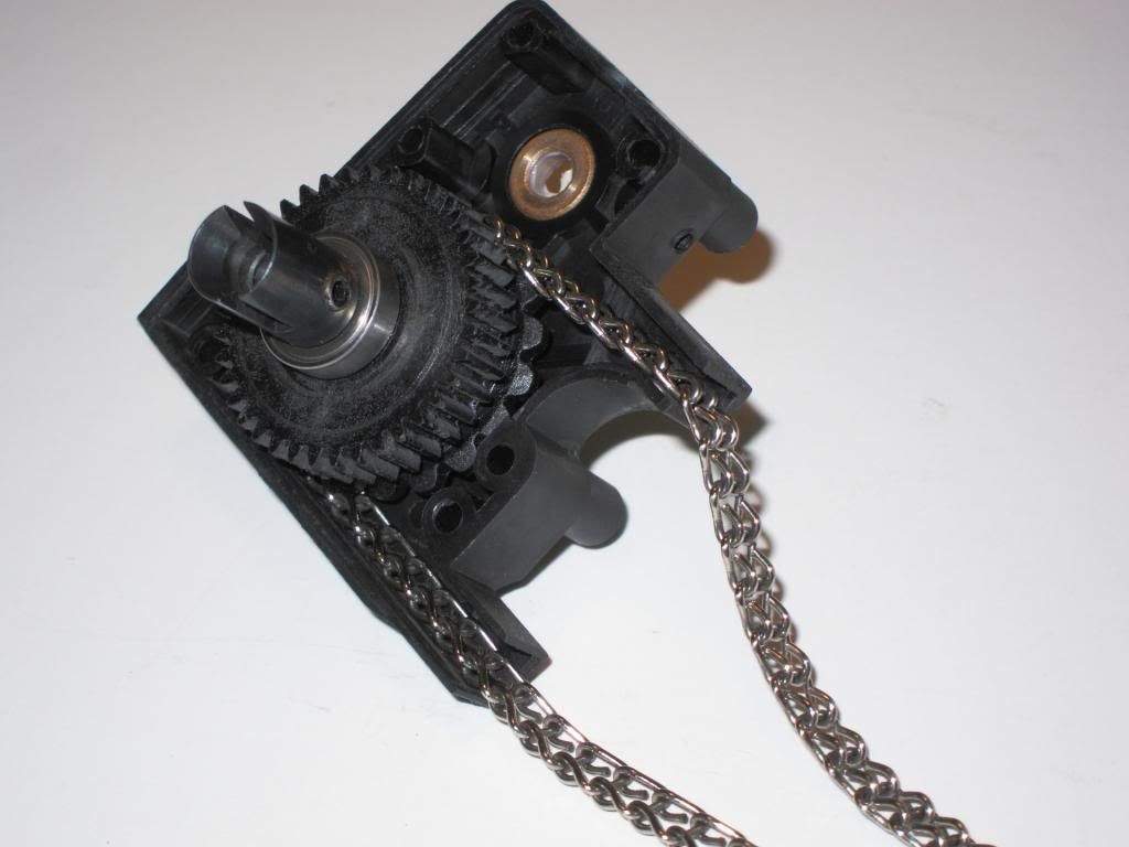

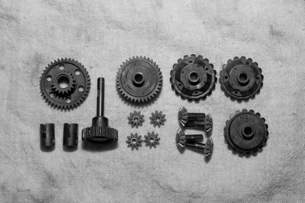

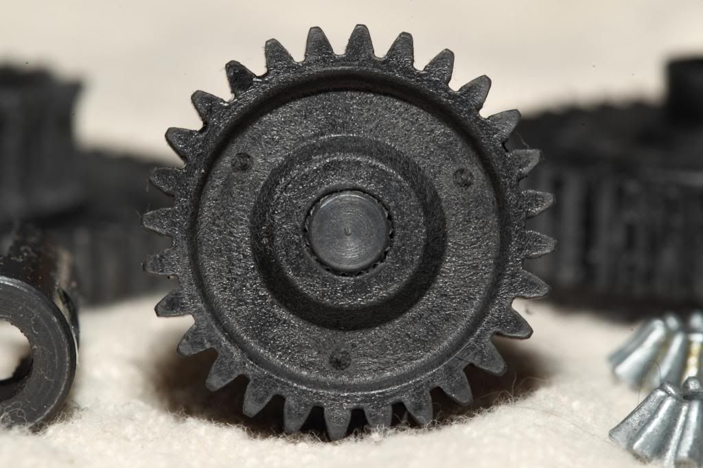

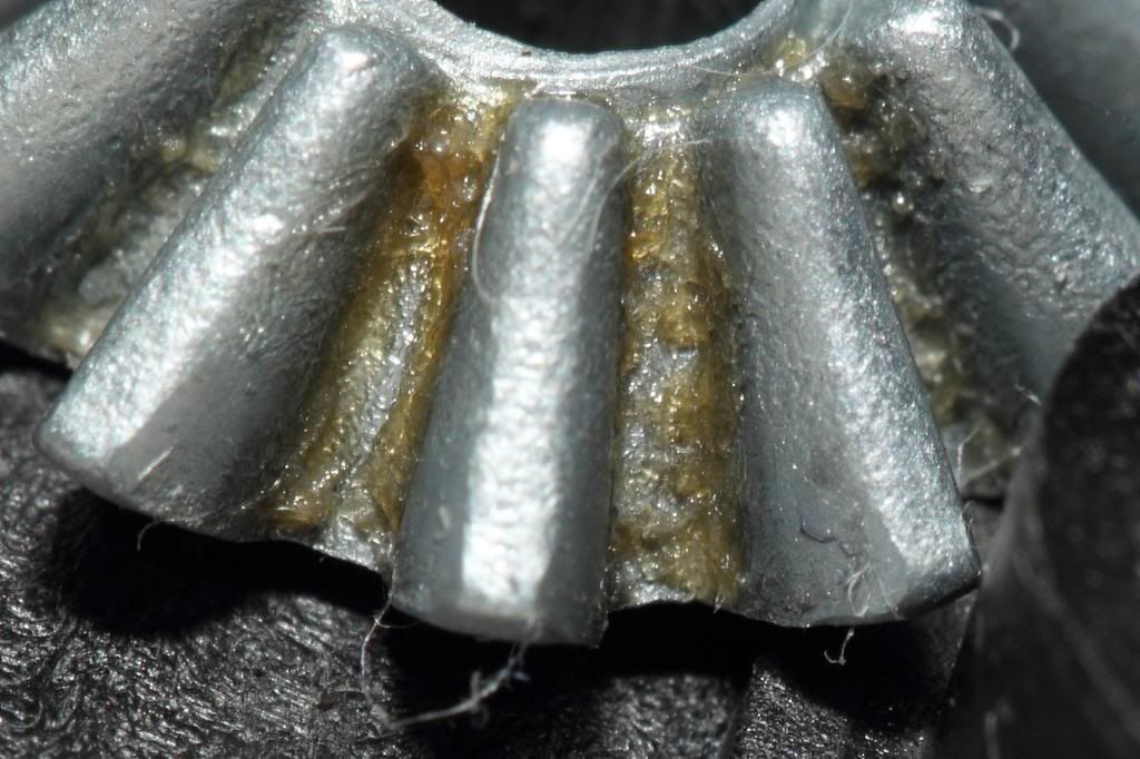

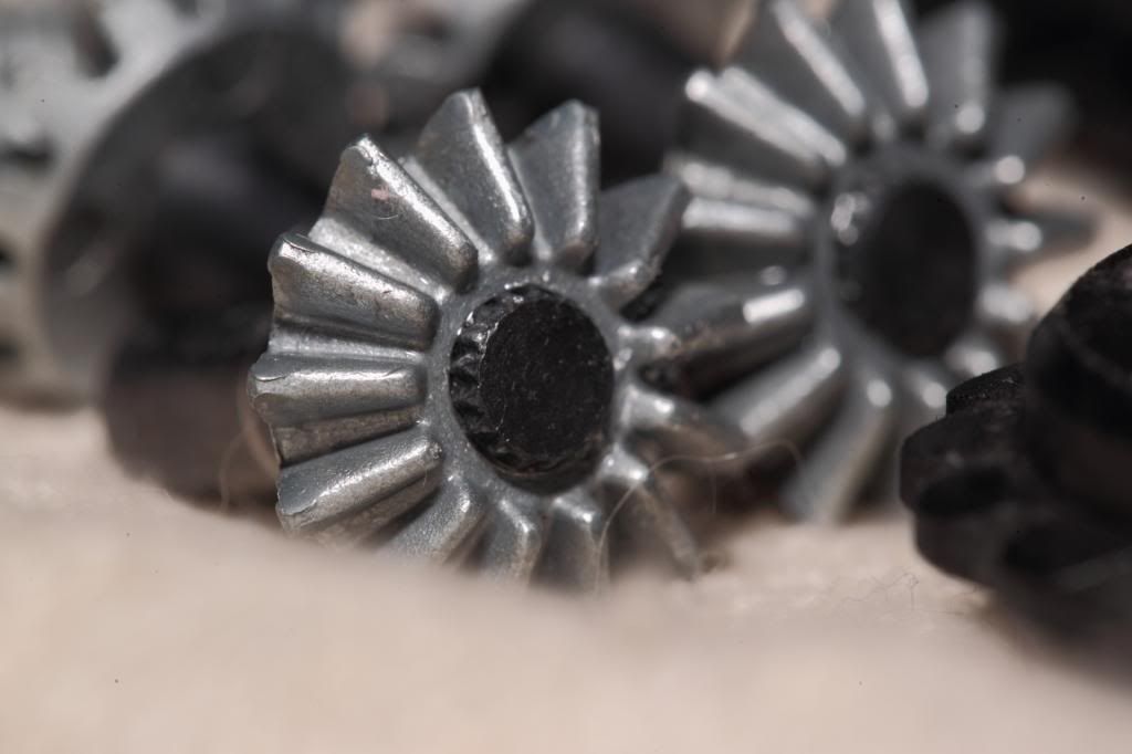

Next, I cleaned the gearbox and differentials, and of course I had to take pictures. There was some very sticky grease inside which definitely had that "old grease" / box of Crayons smell to it.
Need to replace this one:
How did that get in there?

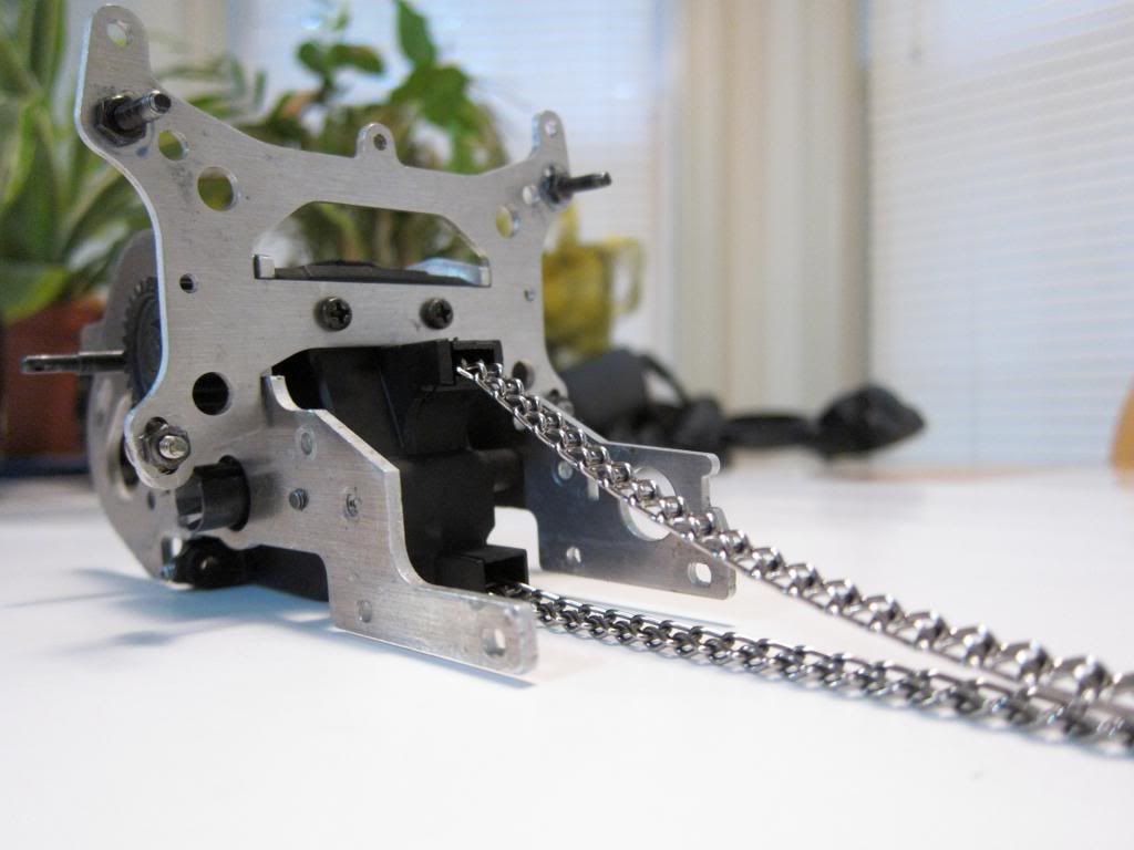

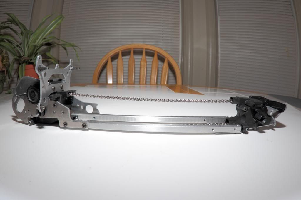

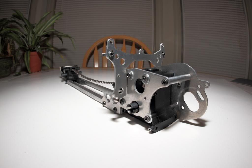

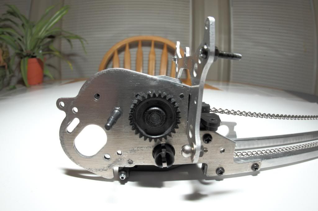

I started the reassembly, only to realize that I'm going to make myself go back and fix something.

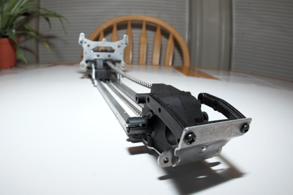

Well I built both front and rear gearboxes:

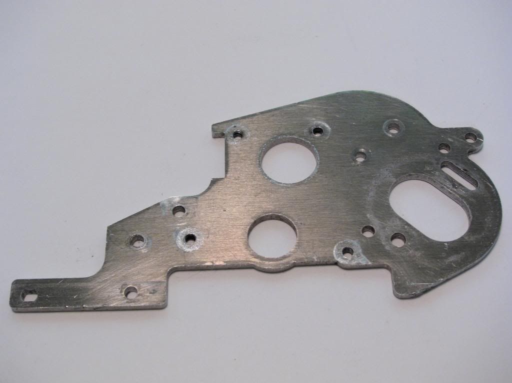

And added in the siderails. I decided not to polish them but rather to wet sand until most of the blemishes were gone. I started with 400 grit and ended at 600, to leave a nice horizontal grain:
But... I'm kicking myself for not doing the same to the rear aluminum sideplates. Even after all the threadlocking of screws, I am going to dismantle the rear gearbox mounting so I can sand out the scratches. I'll sleep better.
But... everything is spotless, so I'm happy about that.

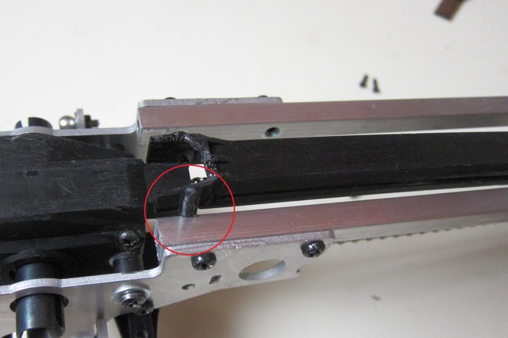

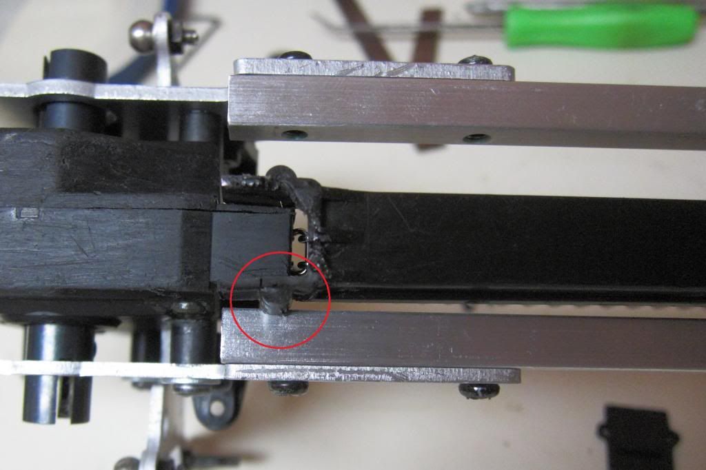

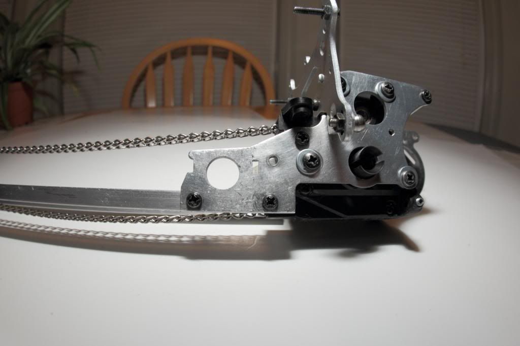

ok, I've ran into a snag. I don't think I have skipped any steps in the instructions, yet I have an interference with the chain guard and chassis tube (see areas circled in red). Have I done something wrong? I could of course bend things and squeeze it in there, but it doesn't seem right:
The instructions make it clear that the M3 spring washers go on the outside of the Left Rear plate (if they were on the inside, between the gearbox and plate, I would have enough clearance):

Re: Kyosho Optima Teardown, Cleaning (, and rebuild...)
Mine appears to haave been filed down on side the trans case for that to fit properly .Im no exspert on thses but i have 3 or 4 them lol.don

Good point... I need to get a few more so I can compare!THUNDERSTRIKE1 wrote:Mine appears to haave been filed down on side the trans case for that to fit properly .Im no exspert on thses but i have 3 or 4 them lol.don
I'll do the same and file a bit off the side of the screw mounting post. If someone forced it on, that may be why this area of the chain guard was broken when I got it (as shown in the pics).
If You mount the transversed alloy "pipe" between the gearbox mount plates, I think it all falls into place?

Just eyeballing it, I believe you are correct. That pipe (Joint Collar) certainly doesn't fit in there now, so once it IS mounted, that should leave enough room. The strange thing is, that second joint collar doesn't get installed until step 24; I am only on step 16!DennisM wrote:If You mount the transversed alloy "pipe" between the gearbox mount plates, I think it all falls into place?

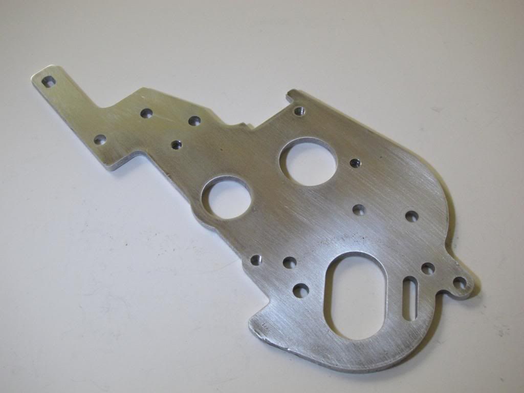

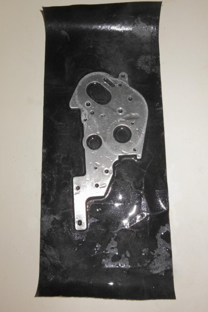

The side plates sanded up nicely:
Before:
During:
After:
It's hard to get the light at just the right angle with aluminium to get a decent photograph.
Before:
During:
After:

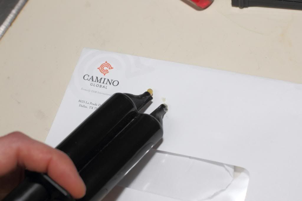

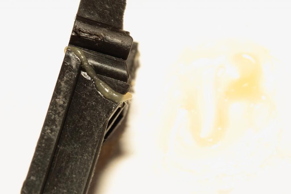

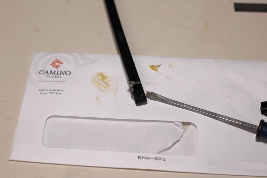

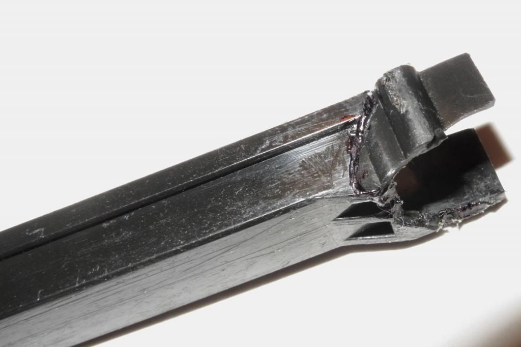

This is how I fixed the broken piece on the plastic chain guard (one of the pieces anyway; the top piece is long gone):
1. Get some plastic weld. This stuff is great and I have used it for a wide variety of fixes. The label is gone, so I don't remember the brand name.
[EDIT] The brand is Permatex® PermaPoxy™ 5 Minute Plastic Weld

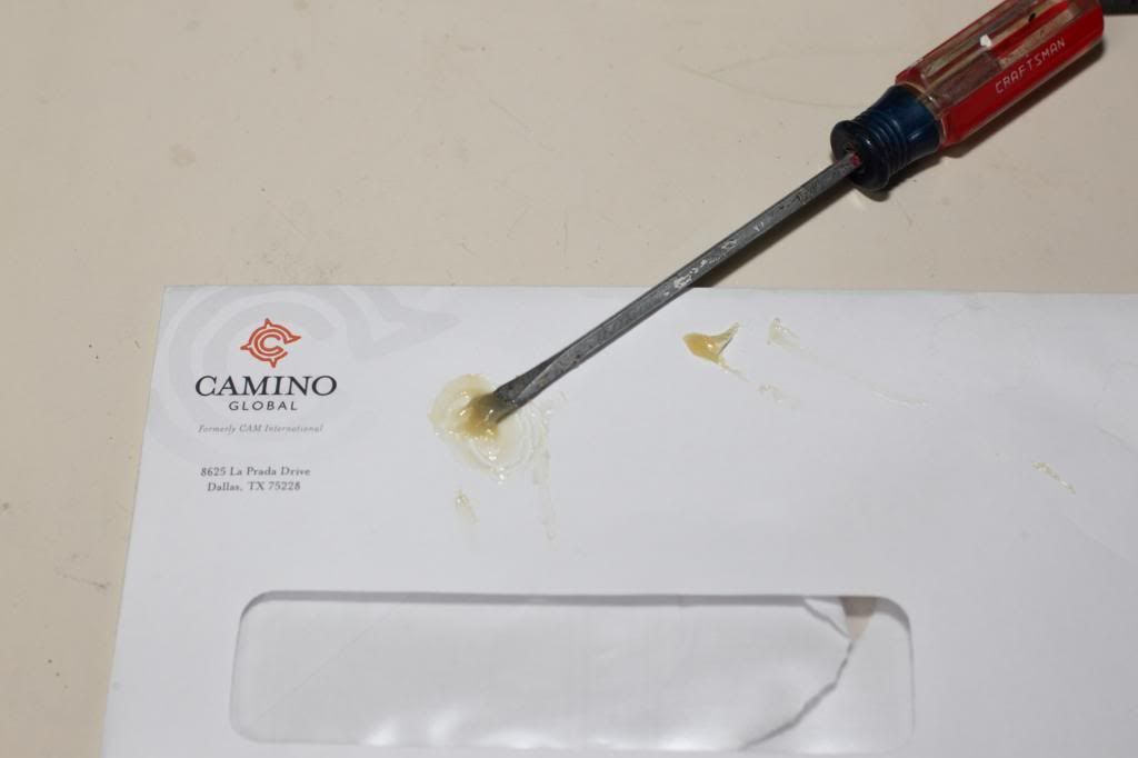

2. Mix equal parts on a piece of paper or cardboard (I used an envelope):
3. Apply to the broken pieces and hold them together. It dries quickly, so you have to move fast.
Once it dries, you can trim off the excess with a blade. In my case, I also colored over the dried weld with a black marker:
