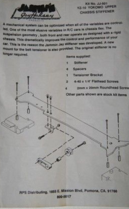

Whats wrong with the top brace? How did u screw it on the front bulkhead cap? Really long m2's and a long plastic shim?? Can u buy these shims?

The jammin upper calls for 2x20mm screws and spacer tubes.
Stolen pic...
Stolen pic...

So is it still possible to get the spacers? Ta never seen the diag before..i have a couple of those top decks but none if the spacers nor the thingy to tension the belt

On my personal car I made the belt tensioner bracket- it's just a piece of angled aluminum. The spacers I made out of aluminum tubing.

I lucked out and one donor car came with a complete stock jammin top brace with the long screws, and the white plastic spacers. the top brace does have some serious glue globs on it though. Some work with a dremmel, and a nice sticker on top will make it good enough.

Coolio! How long are those spacers, i think i found a replacement that may work, they are 9mm long?

I'm measuring 11mm on my homemade ones, and I feel like they may be a touch short actually
