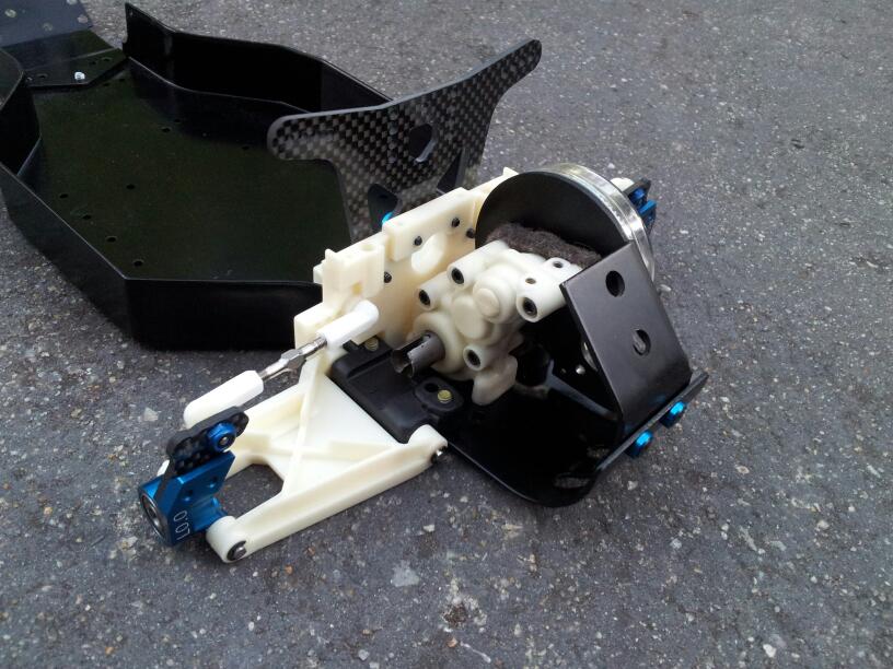

I should have waited for the new worlds car as it will probably be out before I finish this one, and cheaper. Even the new stealth would have been a cheaper option.

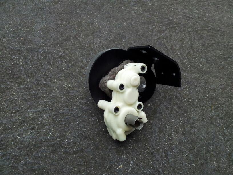

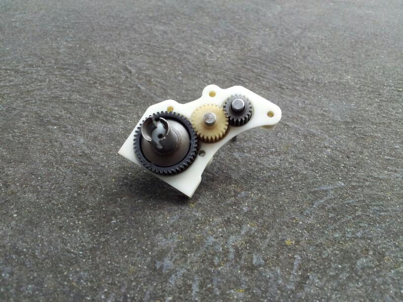

Anyways, new internals in the stealh with the typical B4 top shaft. I also went with the VTS slipper. The outdrives will be replaced when they become available again

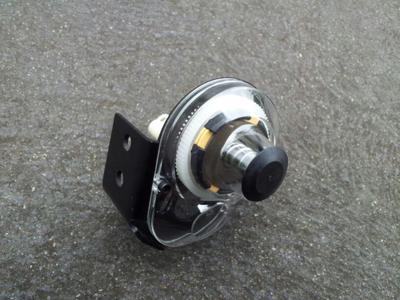

Trans is mounted finally and it's starting to look like a buggy now. I pulled the pin and ordered a set of big bores.
I don't think I'll want to run this car when it's finished.

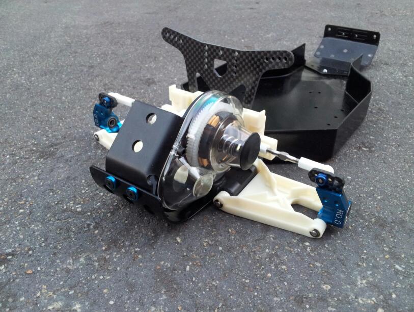

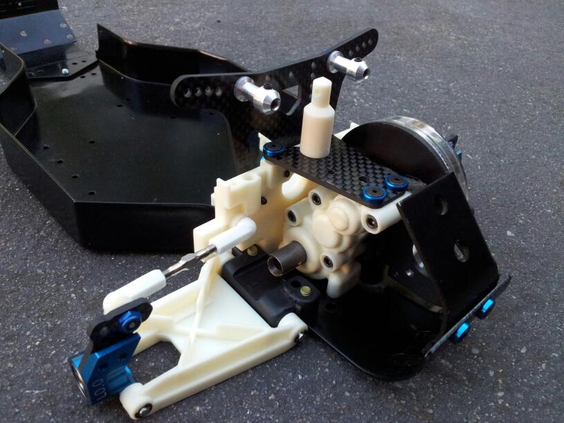

Here is a worlds trans brace, factory body mount and A&L wing mounts. I had to re-drill the tower to get the mounts where I wanted them. I'm not sure if I'll run the big bores in front of or behind the tower. The general opinion is behind but then the tower needs to be spaced forwards slightly....... We'll see when they arrive

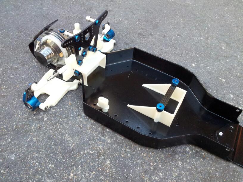

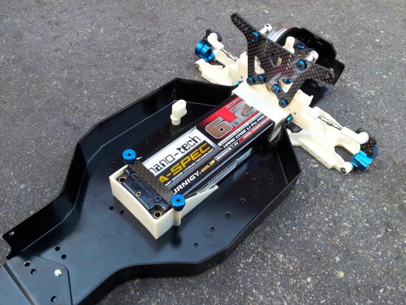

Battery cup relocated to accept full length lipos. I made a custom battery strap out of a carbon brace and also cut out the bottom of the battery cup.
So far so good.......

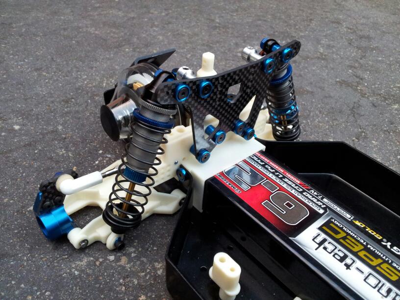

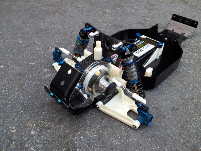

Big Bore shocks installed. Although I didn't want to I ended up spacing the rear shock tower forward 6mm. The shock angle seems correct and the tower doesn't seem to flex from normal use. I think next time I'll ask for a 3mm racers edition rear shock tower just for added stiffness.
