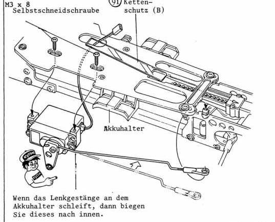

Extending the wheelbase should be easy to do, just new chassis rails and a longer top deck. But as said above the Optima will understeer, so much so that the Optima Pro top deck moved the battery pack forwards where the servo is mounted and moved the steering servo behind the battery. It runs and jumps fine as it is so I wouldn't think it is worth going to all the trouble of extending the wheelbase.

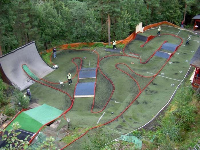

There is always a risk when you prolong a chassis if you don’t rebalance the car. I did prolong my VONats Tomahawk R with 12mm, and that made it much steadier. And sins I almost never practice I prefer a car with some understeer rather than oversteer. And this Oslo track’s surface is made out of Astroturf and carpet.
I’m thinking about using a saddle-pack and make it adjustable length wise. Another alternative is to use a shorty on one side and all the electronics on the other side to balance it up.
The Oslo track
The Oslo track
Cheers

Beautiful track!

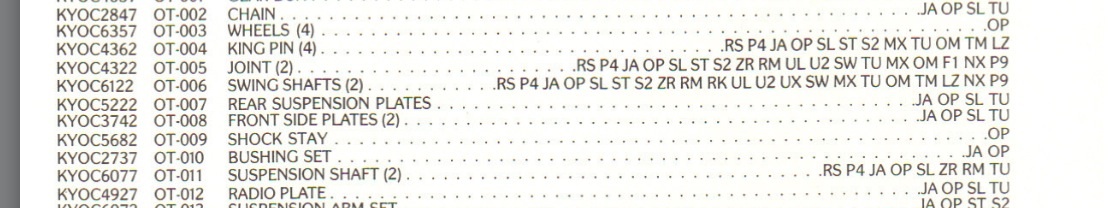

I just looked in my parts compatibility sheet and the same upper is used on the javelin, optima, turbo and salute. Looks like the Pro was on its own

Interesting list you have there gomachv, where can I find that?
Cheers
Lars
My Feedback
Posts: 12336
Been thanked: 3919 times
Re: Kyosho Optima for NVC
If you follow the link in my sig "my garage" it will take you to my website, which is in progress.
Under "links" (not sure why it ended up there, it will end up in documents when I can fix it) you will find a link to the 1990 Parts Guide, and it's a big download but hosted on google so it should be fast. The compatibility area is in the back. It's an amazing manual to have, showing exploded views of many of the cars along with part numbers. Also has a section on the shocks and diffs. Enjoy :mrgreen:

All Optimas except the Pro use the same top deck. The Pro top deck moves the battery around 20-25mm forwards, which means the servo has to go behind the battery and Kyosho used a long linkage to get the steering to the servo saver.
