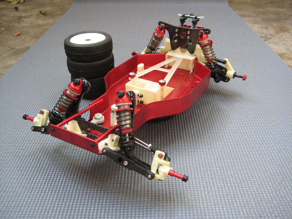

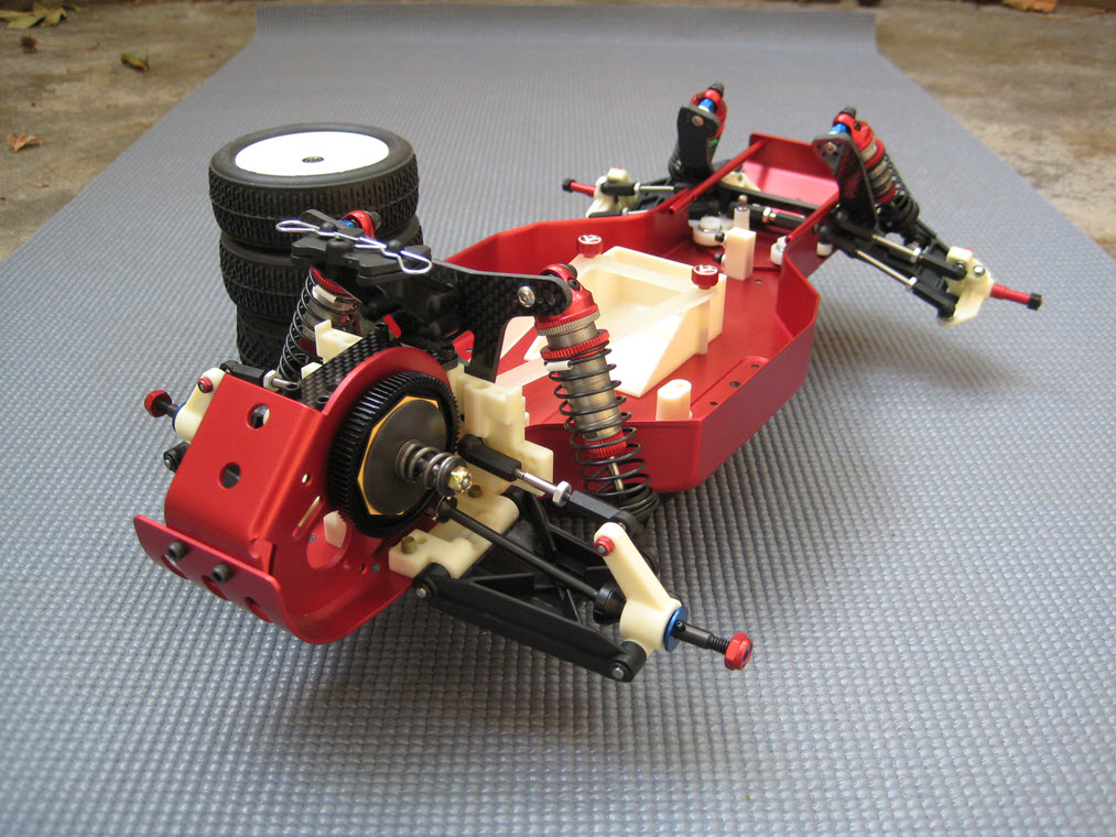

I received my replacement axle from AE and the Lunsford turnbuckles, so I was able to make some progress over the weekend. I still have several little things to do like sourcing a few of the correct screws and other bits and probably send the little blue parts out to change them to red. The electronics are in, too, so I should have all of that mounted up soon. Anyway, it's getting closer.
It's hard to see in these photos, but as others have already discovered trying to use 12mm shocks, there's a bit too much offset (front-to-rear tilt) on the rear shocks. I don't want to use spacers between the bulkhead and tower and mount the shocks in back of the tower, so I'm working on an idea for the rear tower that may fix this issue. Stay tuned.

Like you said, using the big bore shocks creates interesting angles when spacing them out from the shock tower for clearance(You have clearance Clarence...
) I wonder if that will affect handling very much?
Looking forward to seeing your solution.

Curious, why dont you want to move the rear tower forward to run the shocks behind? Personally, I love the way my car runs with it reversed. I have gone back to "small" bore shocks but left the spacing alone, still running them behind the spaced out tower.

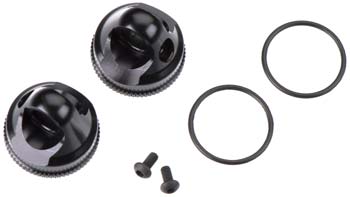

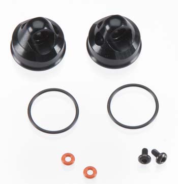

As it turns out, it may not take as much work as I'd originally thought. The V2 aluminum shock caps have a new design that provides a tad more clearance.
New V2 12MM Caps Earlier 12MM Caps It may not look like much, but that extra bevel makes a difference. I think it's going to work just fine with some spacers and maybe a little Dremel work on the tower. Had I not used the 3MM thick tower, I probably wouldn't need to use the Dremel.
I considered going that route, but I'd like to keep the stock configuration, if at all possible. Mostly, I just wanted to see if I could get it to work. Stubbornness, I suppose.JK Racing wrote:Curious, why dont you want to move the rear tower forward to run the shocks behind?
