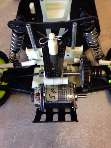

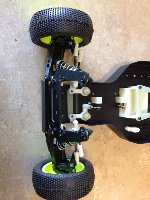

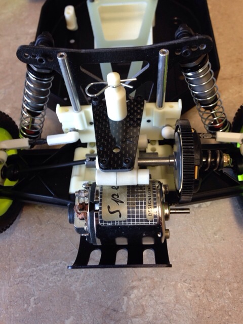

Here's a few pics showing the width, how much room is freed up for the front gearbox, and the motor "centering" mod to allow for a wide pulley

Re: Gomachv's 4wd RC10v2.0 project- mock up
GT2 topshaft eh?
I did this with my 06' HRC Disruptor (in mid motor). You will likely run into trouble unless you create another bearing support near the pulley, the bearing spacing inside the case isn't far enough apart to support any torque out that far (like the spur) but if you make another bearing support neat that torque point you'll be good to go!
What's the measurement on the front wheels outside to outside? Looks narrow...or maybe it's just the pics
I measured it against a team car and it's close, but the 12mm drive hubs will change widen it once I get the correct ones. I'll get a measurement once it's "proper". With the b44 wheels it was too narrow for sure...and the wheels looked stupid hahaha
As far as the topshaft wobble, I was noticing that as well but figured it was my $.99 bearings lol! I will have room to make a support that can ride on either the inner slipper hub or the shaft depending on where it ends up. I'll probably use a flanged bearing along with a g10 plate that will use existing holes. When the pulley gets here I will finally know my exact measurement for the spacers. My other problem will be the slipper cover, it's going to be hanging out there a bit!

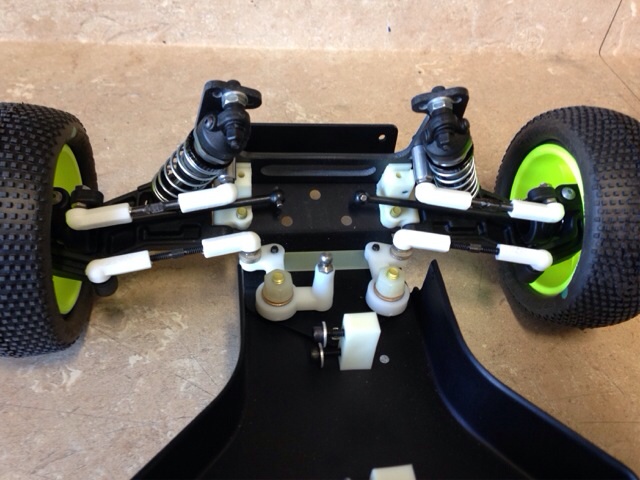

Got the front axles in. The rear stub with hex and a spacer are the perfect width, as compared to my stock team car anyway

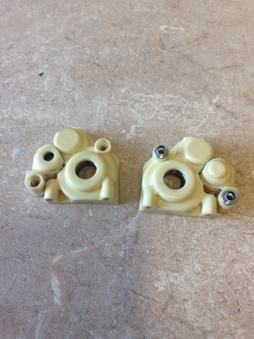

So here is the next major hurdle
looks like AE didn't do any better on the new casesgomachv wrote:Got the front axles in. The rear stub with hex and a spacer are the perfect width, as compared to my stock team car anyway
Can anyone on the board do a 3d scan then print this for you?
Yup.. I have offered to help out.. I told Jeff that I can model this up and print prototypes.. I'm actually in the process of getting my 3d Scanner up and going.. Was missing a part but it arrived and just need to finish putting it together.. But we will see.. I think he's working out some things before taking the next step...pumpkinfish wrote:Can anyone on the board do a 3d scan then print this for you?

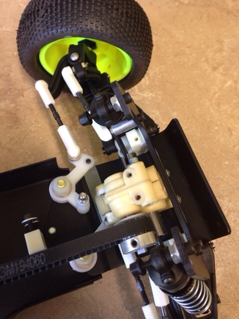

Just checking fitment. Bones are too long...this isn't a bad thing tho. New caster blocks with less caster and fix bone length too. This also will allow me to go back to b44 wheels, simplifying the parts list
6mm HTD pulleys and belt, no slipping allowed!
