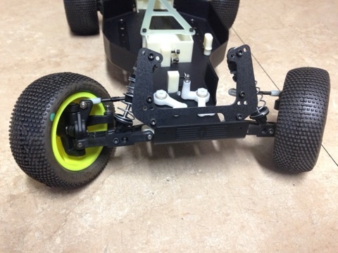

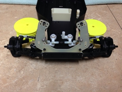

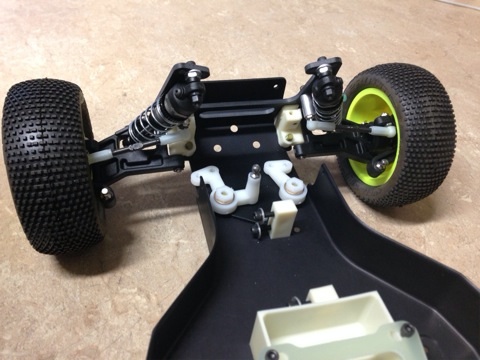

I have decided that I am in the minority on staying era correct. I have decided to remain AE loyal however and will try to graft the B44 front knuckles and carriers to the stock wide clip. So far it's not too far off, just slightly narrow (maybe get rid of the hideous offset wheels to help width). I drilled an old tower to experiment with camber links so I don't kill my Worlds tower. I'm not sure the direction of the front trans yet, I would absolutely love to get a 3d modeler to make me one and have it printed by shapeways or similar. I know the gear layout that would fit well just have to put it to paper. I have decided to keep the pulley behind the motor plate as I did on my last one, but this time it will run a wide belt, so the motor plate will be spaced a bit. I think this may help center the new motors better as well. It's a win-win
Here is a teaser

Looks good. Maybe b4.2/b5 hex front wheels will get you wider up front. They've got more offset than the b44 wheels.

First off the caster blocks are giving me 20 degrees caster. On a 4wd thats a bit excessive. I had to reverse them to get DOWN to that. Anyone know of any b44 blocks with MORE caster (because I'll need to reverse them)? I can't use ones with less caster as it wouldn't be nearly enough.

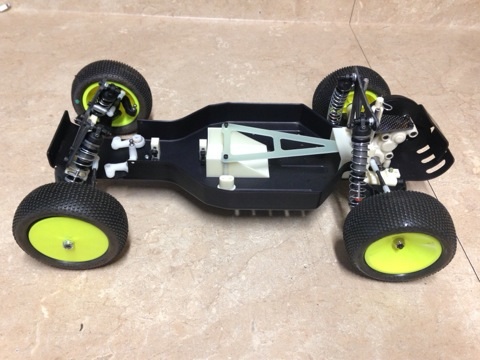

Built up the rest if the kit to make it a roller and get a little feeling for where its going. I'm going to stick with the drive system I ran previous but with a wider belt (no cutting) and premade pulleys. I will be extending the trans spacers 5mm or so and adding a longer topshaft. I've cleared out a lot of room up front, now I need to see what I can get to fit
I'm pretty excited to keep stock (relatively stock) geometry this time.

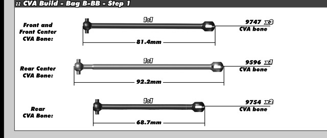

Spent a little time playing around with things, found out the B44 uses a smaller hub than the industry standard 12mm like the b4 wheels, so next up is swapping over the front cva to a rear style. The good news is that the width look perfect now and the parts are still all "off the shelf". It also looks like I will be using a gt2 topshaft instead of a hydra shaft to keep it easy to source the parts. Pulleys and belts should be here Tuesday
I could use more measurements guys. Anyone know of a CVA axle that is a bit shorter than the b44 front? Per the associated manual they are 81.4mm end to end, I need to loose 2-3mm or so
