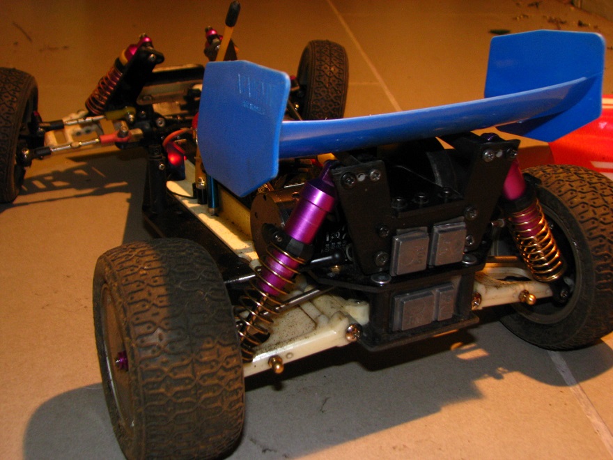

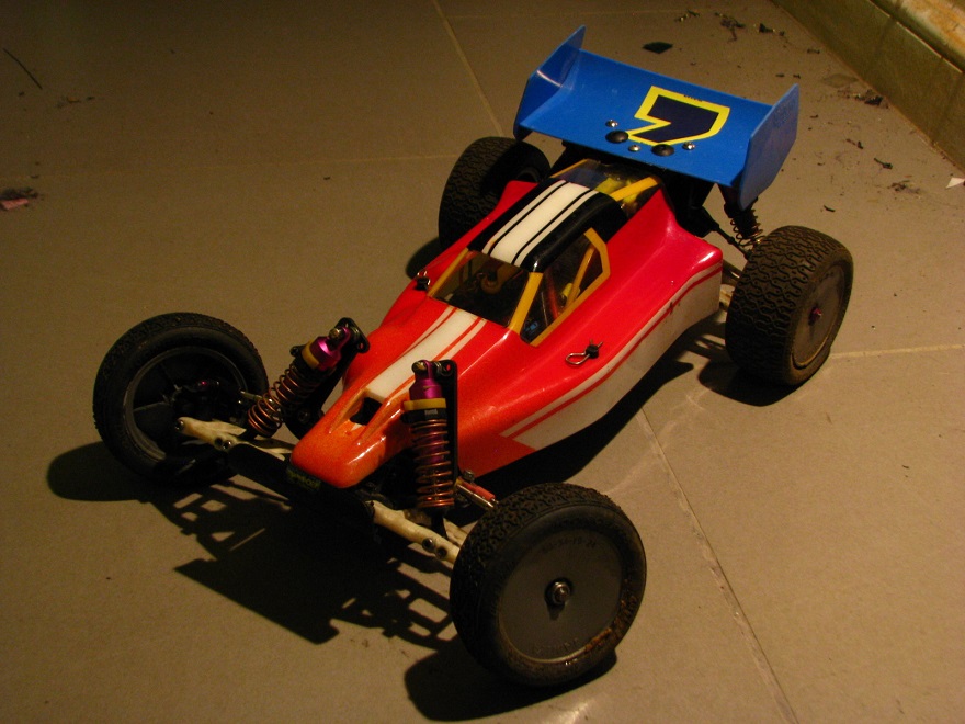

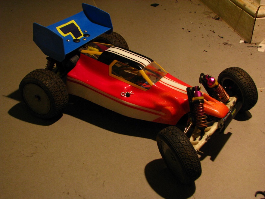

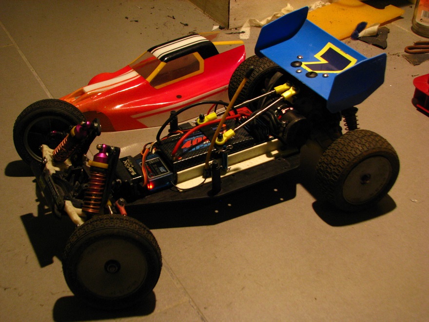

I've had this one almost ready for awhile, but only put the electronics in last saturday evening as the radical ultima was not doing well on the slippery hard clay track.
Turned out to be the right decission as the car felt sooo much better on this particular track on Sunday.
The front remained basically the same but the rear end received a cleaned up stealth with b4 topshaft and home made GF moterplate to replace the bent original.
Rear bulkhead moved behind the gearbox, some extra braces, new wing mount, new rear shock tower, brace for the rear bulkhead and gear case, and some more timming on the body to fit the upside down B4 spurcover.
And voila:
