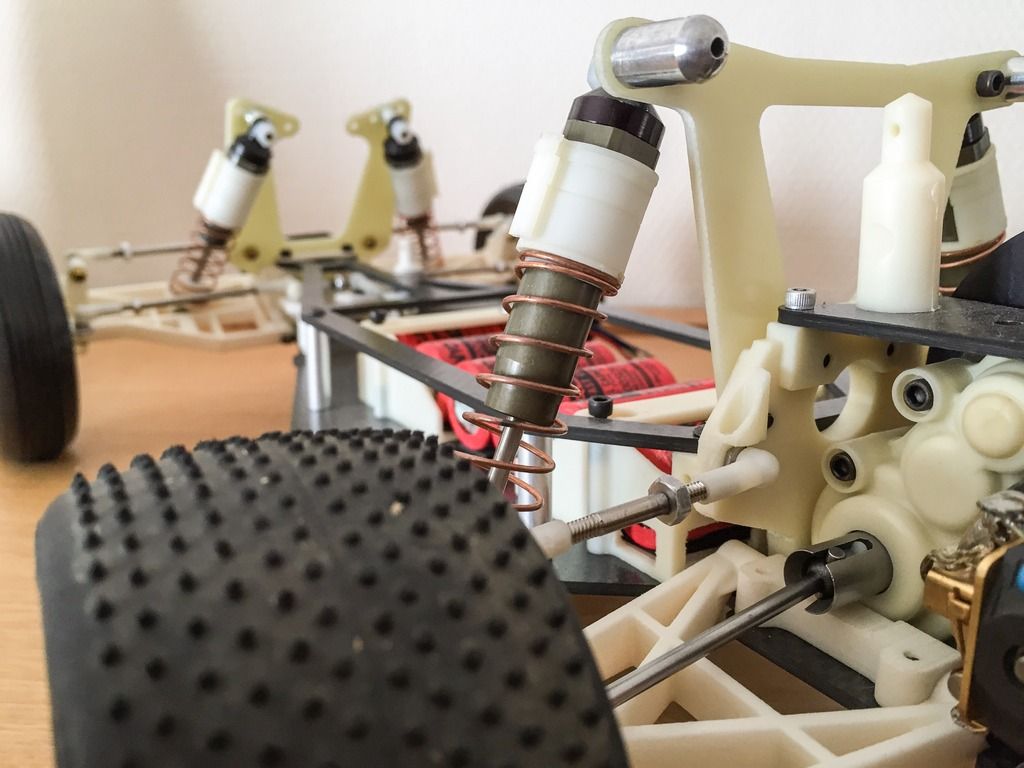

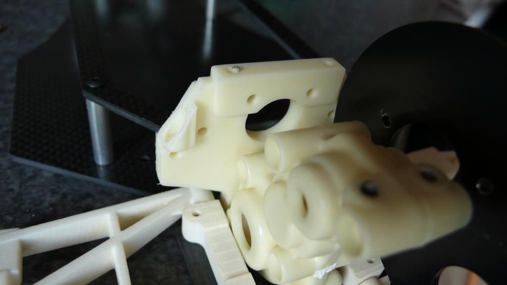

So happy New Year to all of you! I had two weeks off and managed to work a bit on the Stealth car project. I had a ton of fun reaming the Shapeways parts, modifying nylon parts and test fitting everything. I must have assembled and disassembled the car 4 or 5 times already :D
I also found more parts as I went digging up the part boxes. It just seemed every time I went looking for a specific part I went back with another one. There are so many small details to make this thing as close as possible to the original.

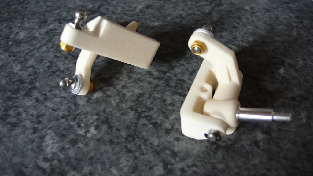

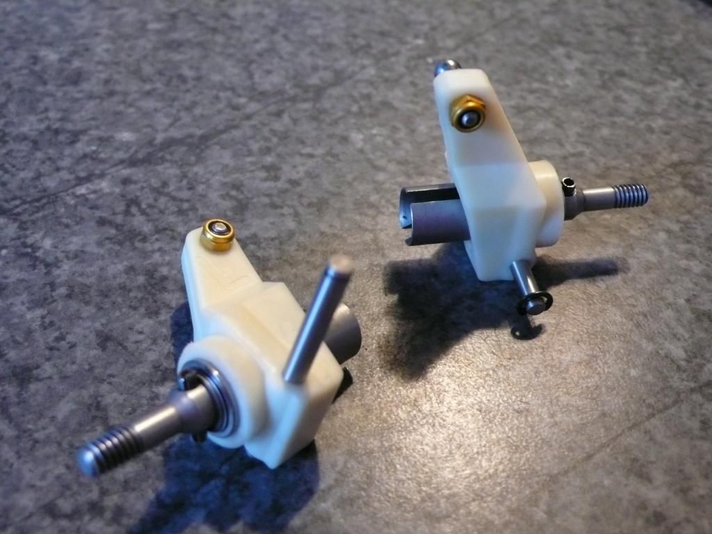

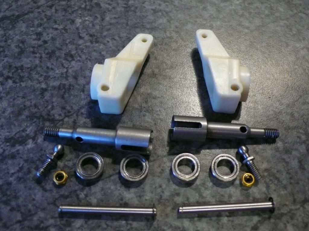

First thing that was assembled were the front c-hubs and knuckles using 2 alloy washers under each steering ball stud along with the gold 4-40 nuts. The only thing that puzzled me here was that the c-hubs have a too thick ear where the linkage ball stud attaches,

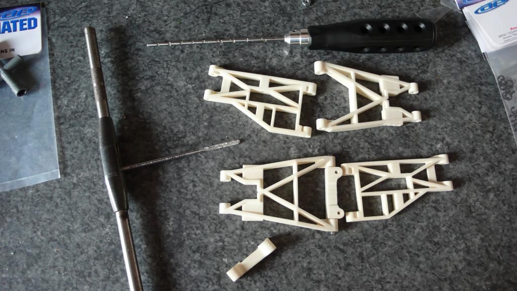

Then I further reamed the suspension arms and blocks using a 1.248 reamer:

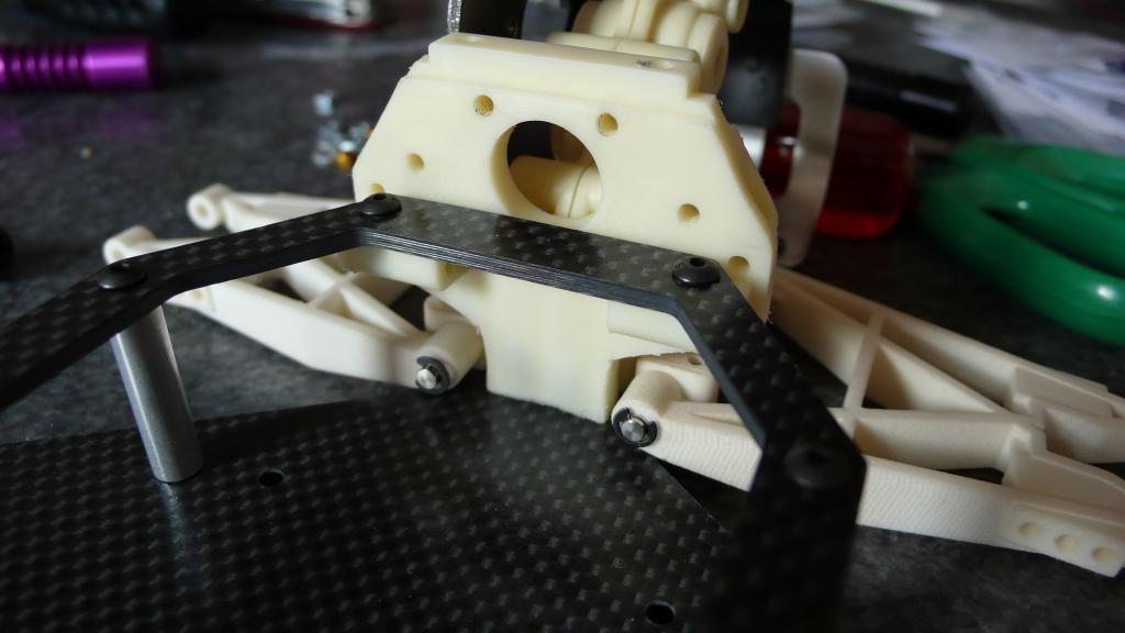

Trimmed the rear bulkhead but still need to remove some flashing and finish it a bit better:

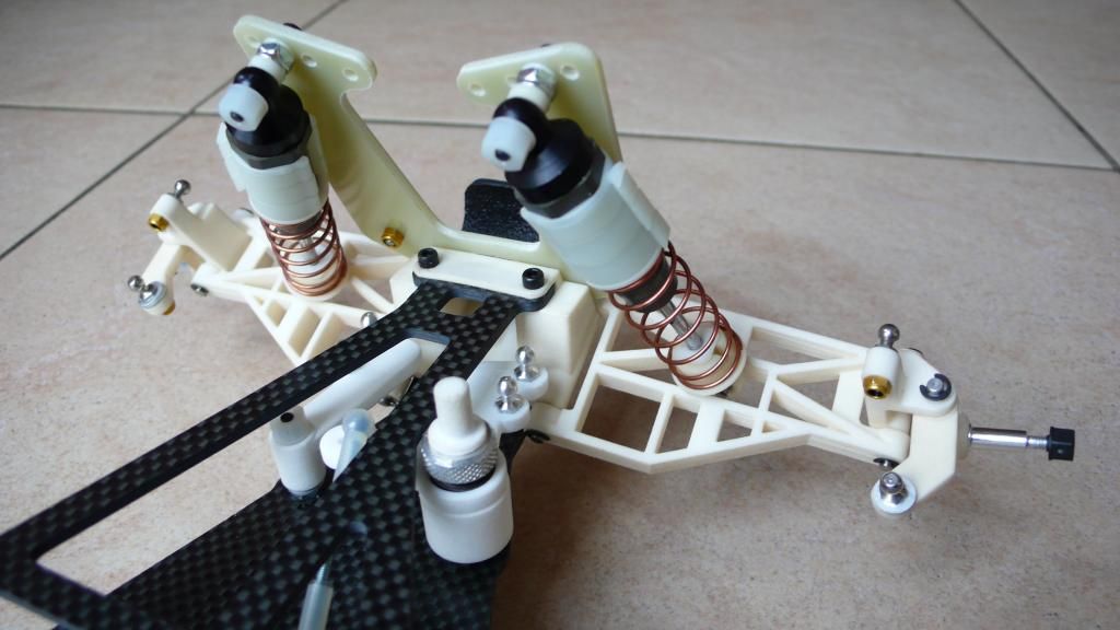

Made some progress on the front end and have a question: where can I find the white nylon nuts for the front axles?:

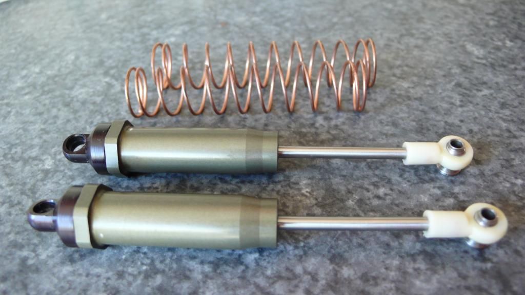

Rear shocks were assembled with vintage parts only as I didn't want to use the re-release shock bodies as they differ too much in colour (the OE ones are kaki where the new ones are gun metal) and have an extra recess at the bottom of the body.

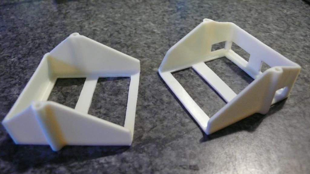

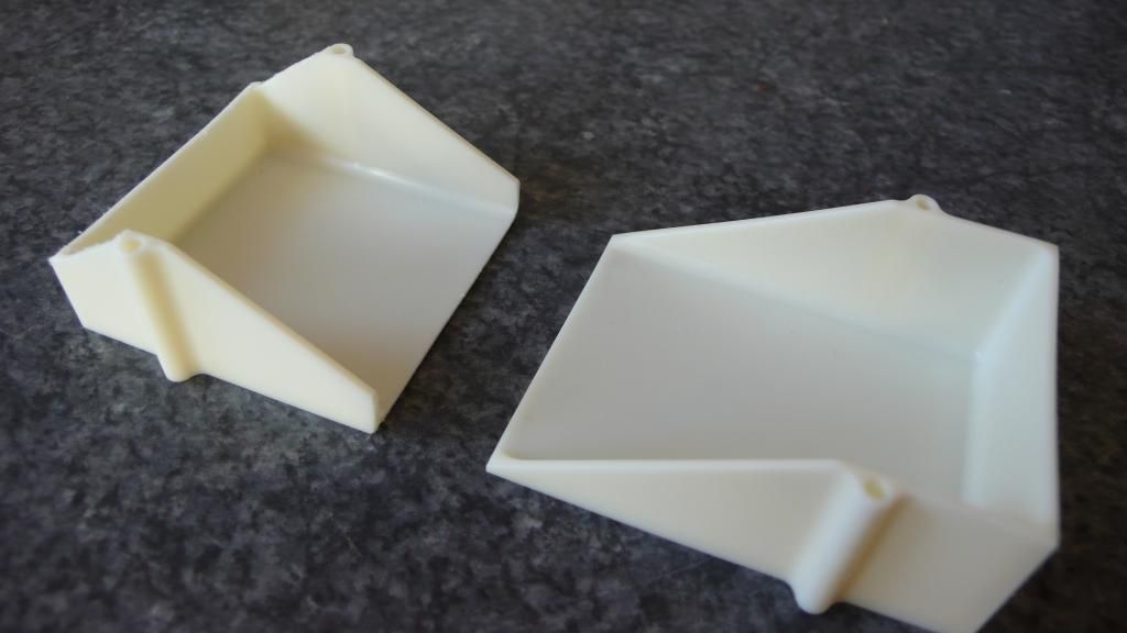

I also started working on the modded battery cups but got a bit tired and stopped here:

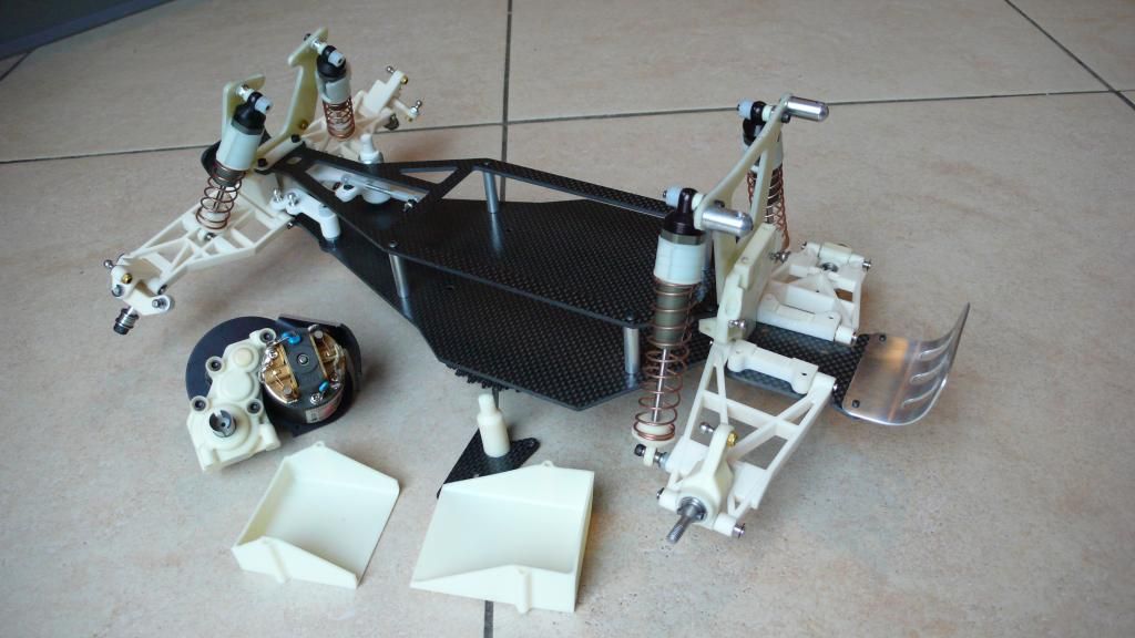

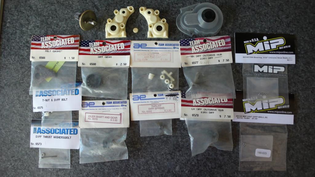

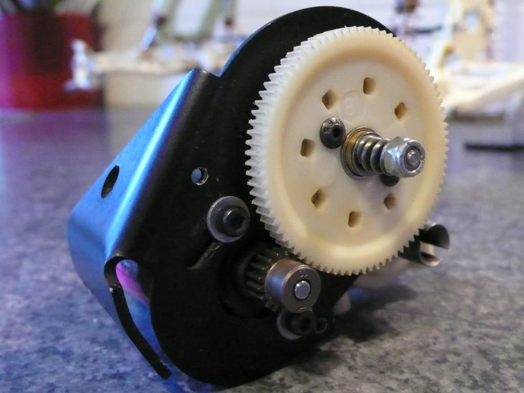

The infamous Stealth transmission was essentially built with vintage parts, most of them being NIP:
I even went for a used and yellowed spur gear, just need to replace the bronze bushing with a thrust washer assembly as used by Masami. Motor screws are now correct, but would need to make some further investigation about the spur gear/pinion gear ratio:

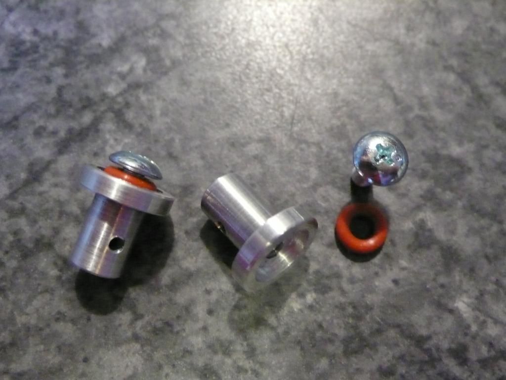

I also received these during the holidays, they are just perfect and just need to get anodised gold! HUGE thanks to Mark aka Limestang who machined these according to Pedro's (metric) measurements. I even found the correct Yokomo screws to attach the wing:

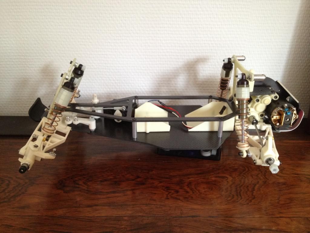

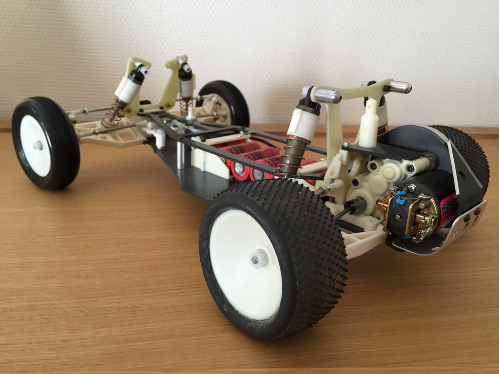

And here is how it sits right now (still plenty of details to fix). Note that I used vintage Yokomo wing mounts as I found they were a tad more correct looking than the ones kindly included in Jake's kit:

Thanks! I do have these nuts on the shock mounts already and have plenty left, but they come factory threaded for the 4/40 standard screws, the thread is thicker on the front axles and you would have to force them into place, I thought there could have been a more adapted white nylon nut.
When assembling the rear shocks, I was also scrutinising about the internal spacers in there and how much were needed for this car. When looking at Stealth car pictures, it seems to me that the rear arms have a lot of droop and go below the drivetrain level. To get there, I had to only use one thick spacer in the rear shocks, were 3 were used on the front shocks.
What did you guys do?

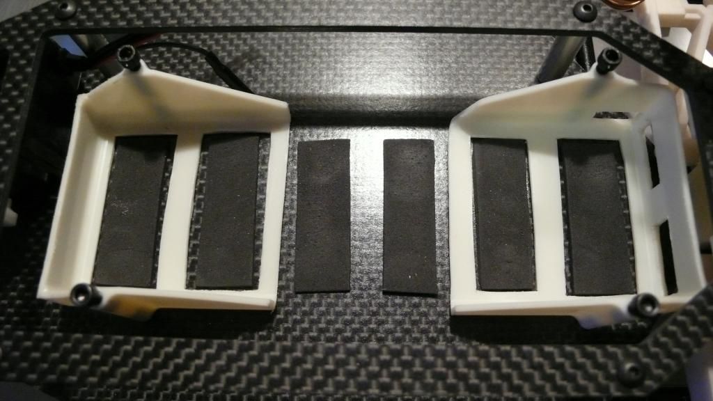

I spent some time in the details today and hell these battery cups are still a b#@&h to cut nicely. Did my best to mimic the cuts on the original car, but wasn't easy. I then installed them along with a T2 foam pad I cut in pieces.

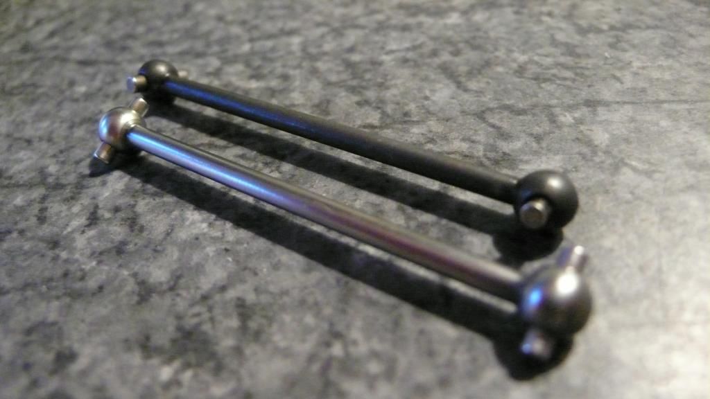

The dogbones were gently sanded to give them back the lightly polished look they have on the Stealth cars.

Your battery cup look excellent!

Thanks guys, took me a few hours to complete this with no less than 6 different cutting/filing/sanding tools! I could do a better job now that I've done these but it will do for now. By far the heaviest mod on the car. Result is a COG a few milimeters lower, a car a few grams lighter, escape holes for dirt and debris and easier removal of the battery :mrgreen:

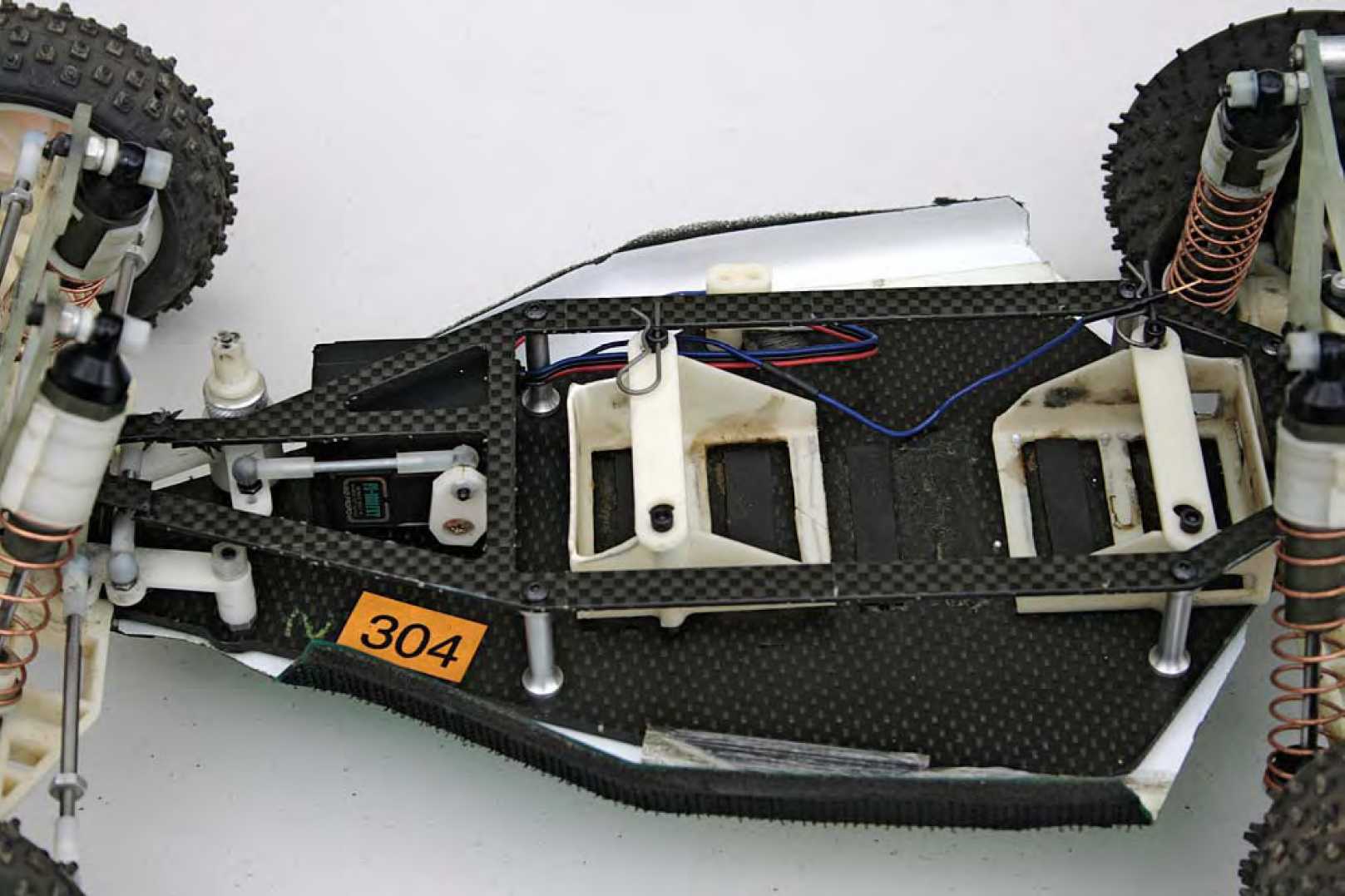

Where did you see original pictures of the foam battery pads?
Posts: 16810
Re: - '91 Stealth Masami replica -
Nice work David!
Rod, you can see the foam pads in any body off shot of Masami's car.

Post by Mr. ED »
scr8p wrote:Nice work David!
Oops, David it looks like you'll have to remove one of the foampads and make sure it leaves some sticky residue :wink:

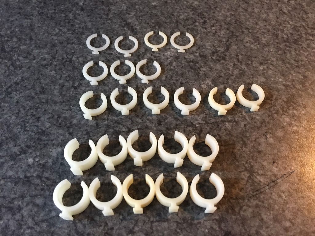

Made baby steps in the meantime: I managed to source a used set of Yokomo preload shock clips that needed I thorough cleaning and thanks to a deal with Minisforever, I now have the TR32 rear tires. The body is being taken care of by VintageAE and finally managed to contact Ultrahive to get a set of stickers. Still a lot of details to be fixed and parts to be sourced like the illusive Novak 410 M1c without the fuse, the even more illusive front tires etc...

Couldn't resist any longer the car standing without shoes, so I used provisional ones.
