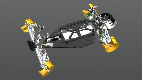

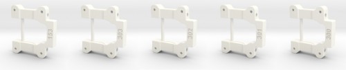

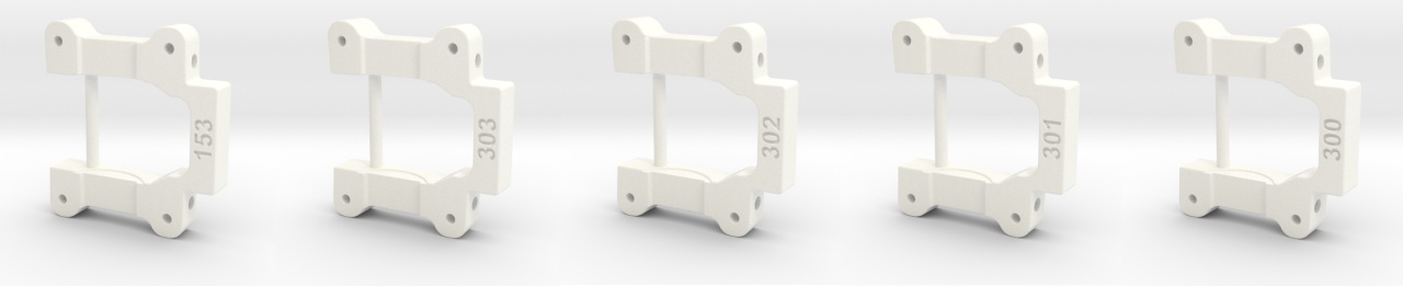

Full range of RACE rear arm mounts available now.
New part numbers indicate degrees of toe-in/side and anti-squat. New HD design protects chassis around arm mounts.
-Niki-
-Niki-

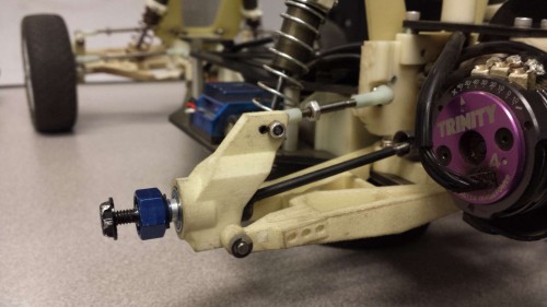

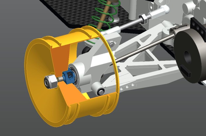

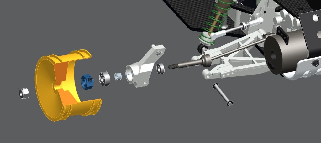

For those who want to race with modern 38mm wide B4/B5 hex wheels, this setup makes it possible:
#9696 or #9695 wheel (or compatible hex wheel)
SC10/T4.1 hex adapter (JC2081 or similar 9mm wide hex)
#7935 bearing .187x.50x.196
#7933 axle spacer crush tube
NIX63652 hub (http://shpws.me/H1BS)
#3977 bearing 3/16"x3/8"
#9756 B44 CVA kit (CVA bone #9754)
This setup works in a standard arm RC10 also.

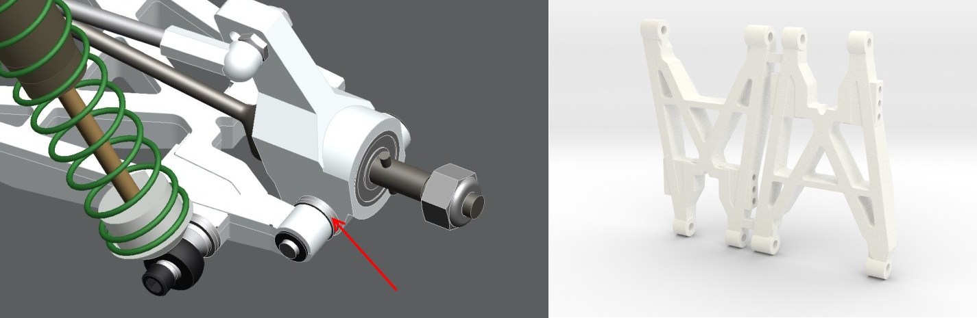

New race arm versions. More rigid geometry.
Mark tested new caster block and rear hub tuning options. These new arms makes it possible without cutting parts.
http://shpws.me/ChS0
http://shpws.me/Crvq
-Niki-

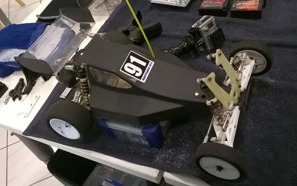

Still need to pick up a full set of arms and work on the B5 rear 'conversion'...but here it is. Currently #2 pistons all around, 32.5 front, 30 rear, green big bore springs all around (understood these will change). Felt good/quick in front of the house. Cant wait to get some track time with it.
What are you guys coming in at weight? I dont want to move to a full size pack, so me and the lead fairy are gonna have to talk.

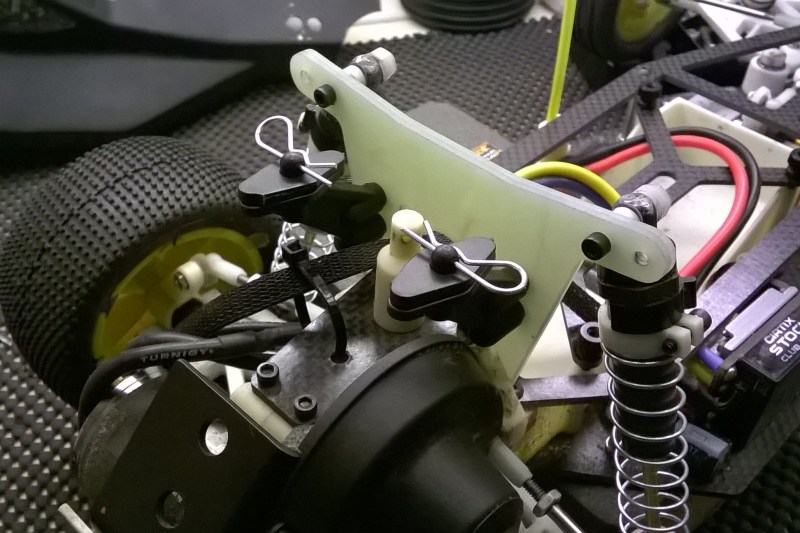

I made a new rear tower design and used B5M wing mounts
Wing can be mounted lower and it doesn't change angle in a crash.
Last year one final was ruined when someone jumped on top of my car. Wing pointing 30 degrees down isn't fun... specially when racing.

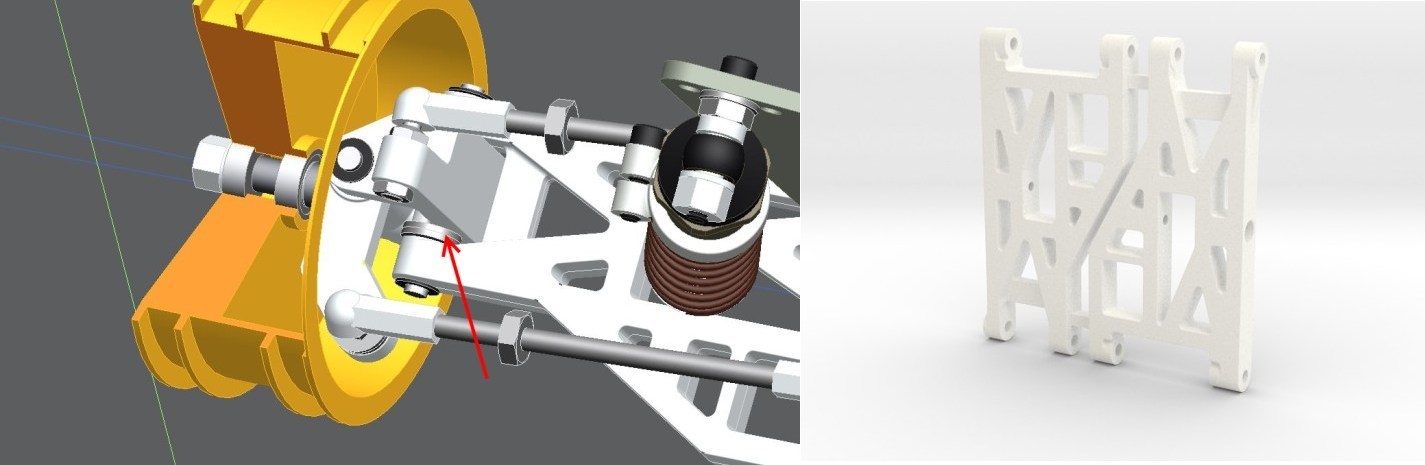

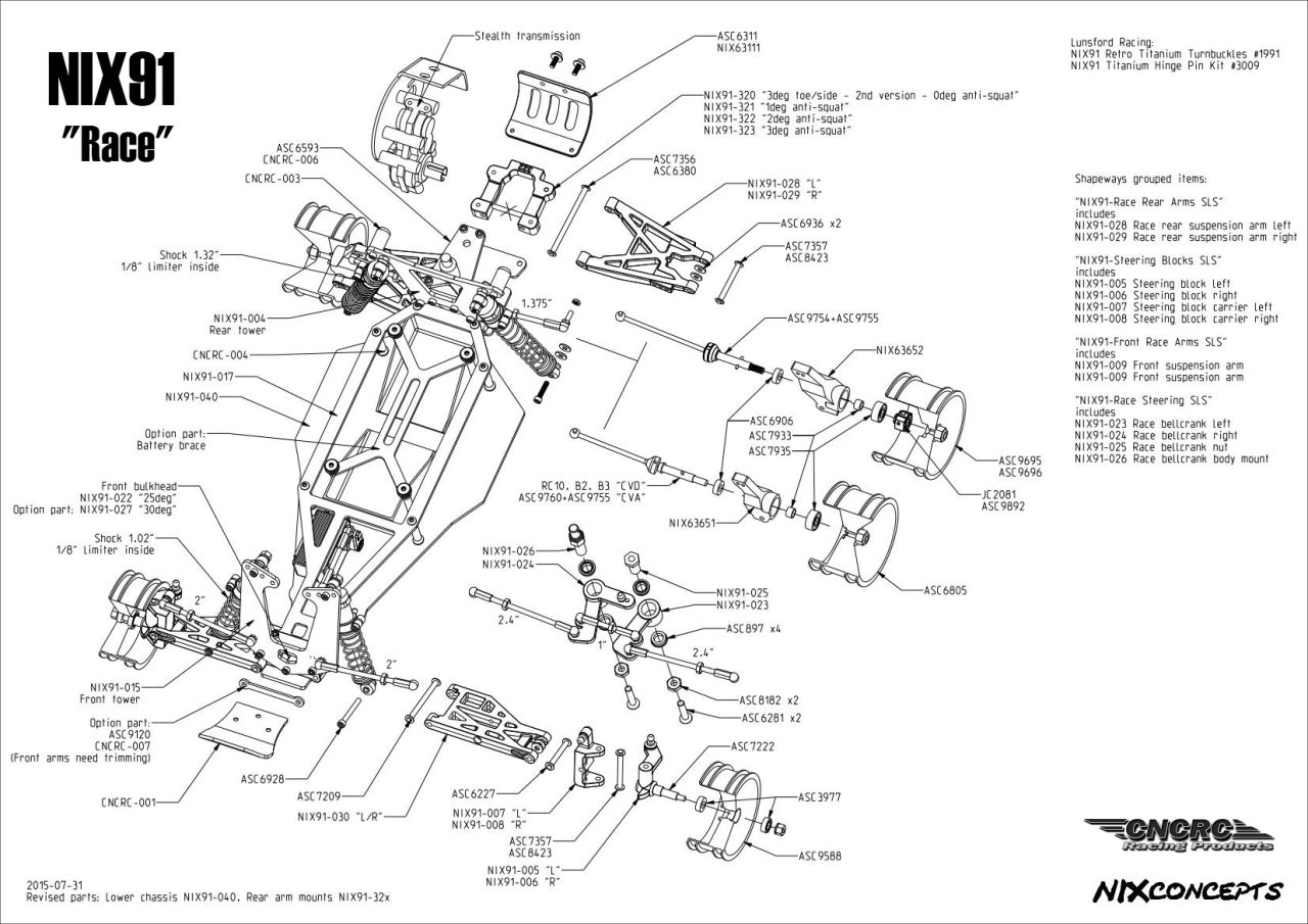

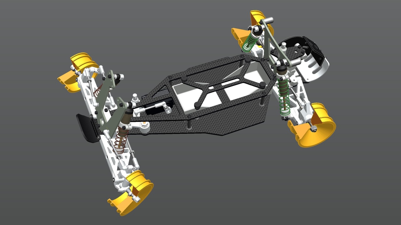

Updated "Race" assembly.
New lower chassis (NIX91-040) will be stronger now around rear arm mount screws.
Rear arm mounts needed an update also as those old ones can not be compatible with new chassis version. New codes are NIX91-320...321...322...323. Check out the drawing below. In all other ways new lower chassis 040 is compatible with old chassis 021.
-Niki-
-Niki-

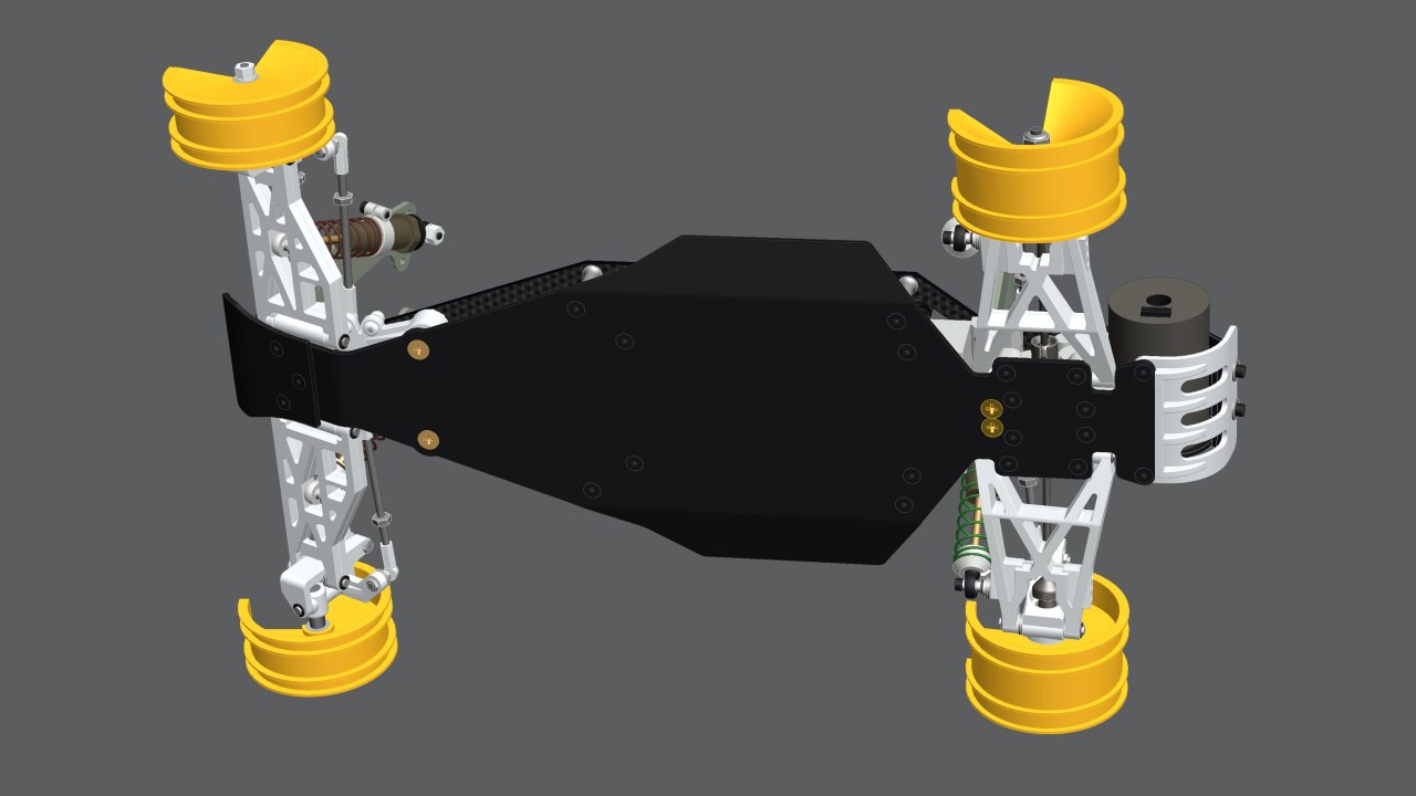

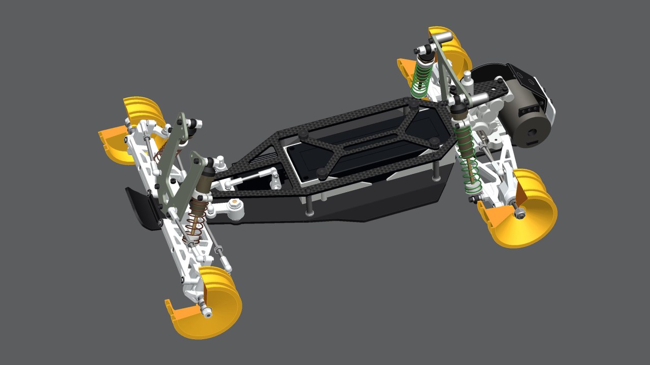

7075-T6 hard anodized aluminium chassis kit will be available soon.
