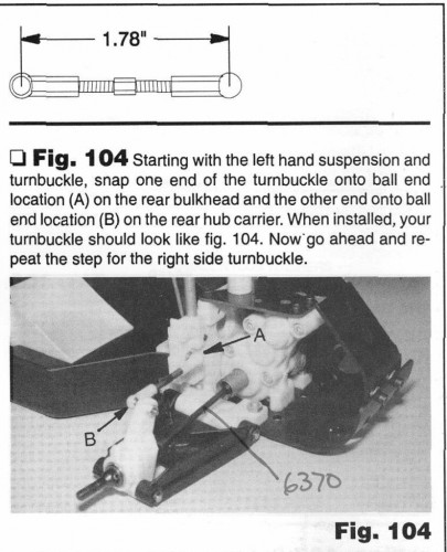

My Lunsford retro worlds rear camber turnbuckles are a little short as well using regular RC10 ball cups. That will be an easier fix but still weird it's not as much of a direct fit as I assumed.

- Posts: 12335
- Has thanked: 1129 times
- Been thanked: 3917 times
Re: Worlds rerelease CVAs on a CE
The real Worlds car used shorter camber links. AE screwed up the rere and didn't put the holes in the Worlds location. It's easy to drill them yourself tho, right between the rere hole and the upper inside of the group of 9

Super info regarding the OG worlds ball stud location. I had no idea! Easy to fix a couple different ways. That certainly explains why the turnbuckles appear too short.

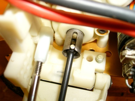

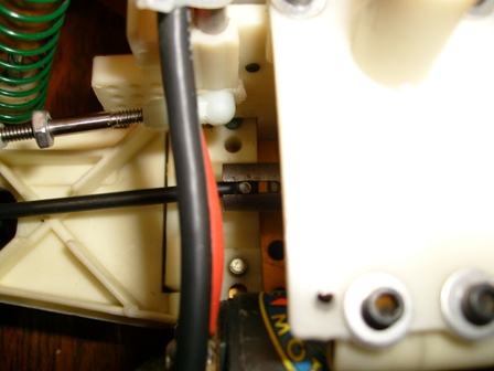

Just thought I'd share a few pics.
The B44.2 center bone is coming Saturday which probably means Monday. I hate waiting the extra two days. I'm anxious to see if it fits?

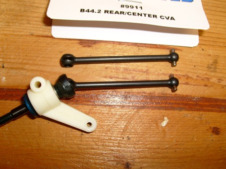

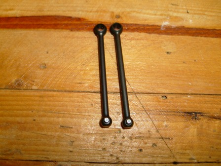

The ASC9911 B44.2 rear center bone is a perfect fit. Just a couple mm longer. Great suggestion. Pics of ASC 9911 bone next to worlds rere kit ASC 6371 (ASC9760 in manual). I paired the ASC 9911 with the 3/16 axle. It's a sweet driver. Two battery runs and no issues at all.

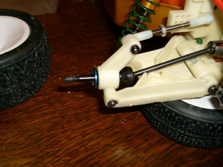

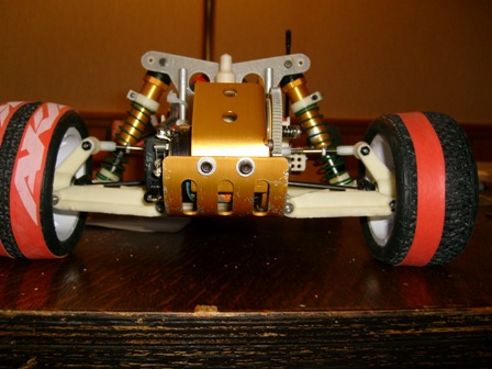

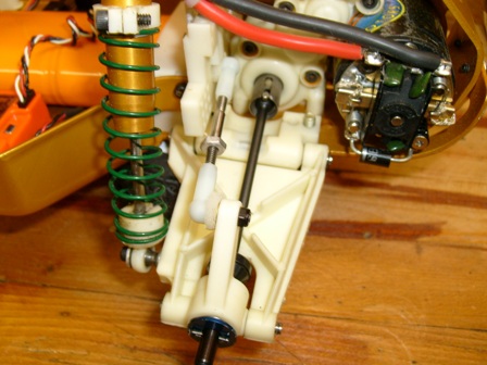

Fitment pics at full droop and ride height
