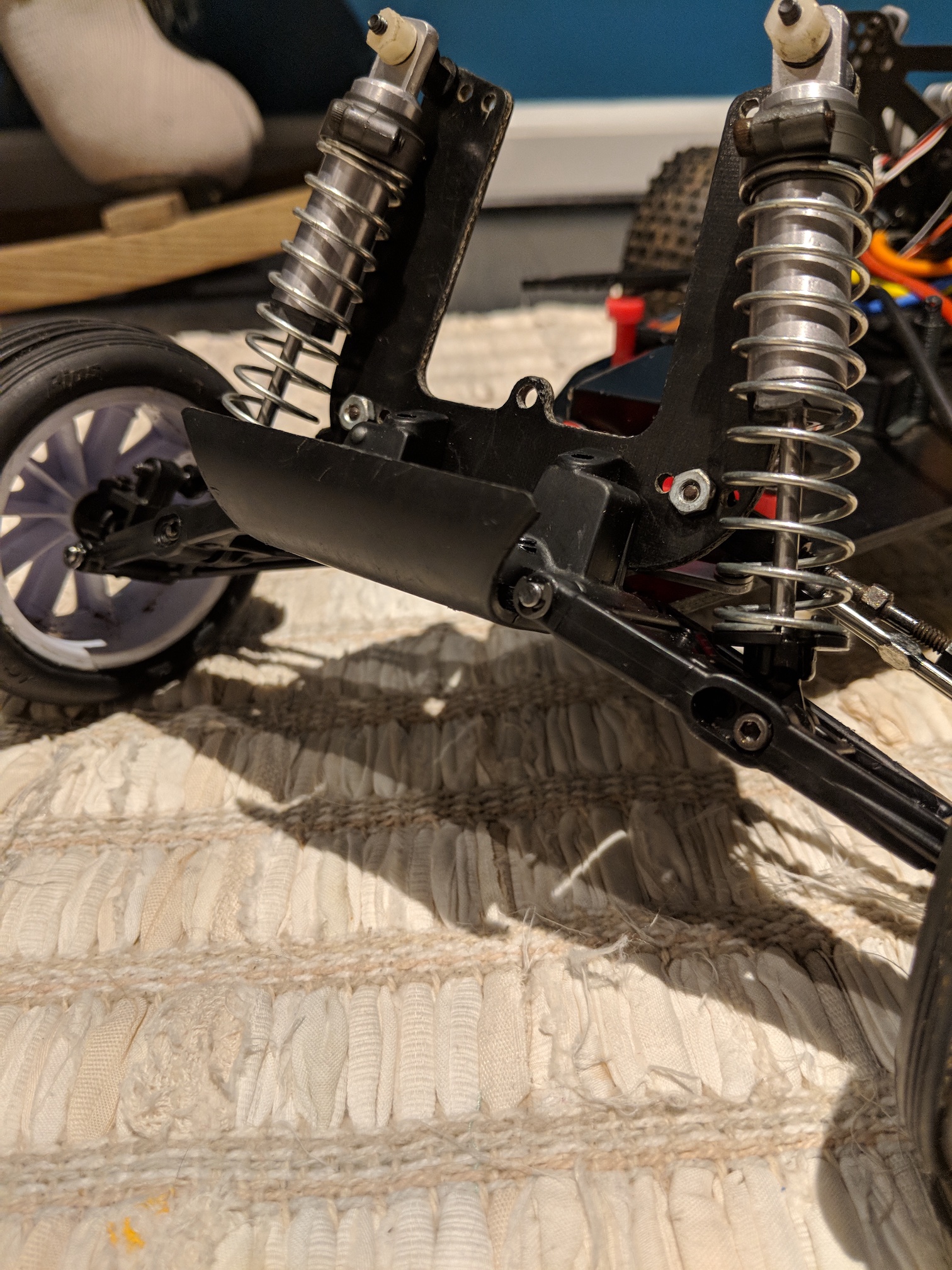

I played around with it a little more tonight and I think it may be due to the ride height. When I compress the shocks a bit the binding goes away. The manual recommends that the front A arms be parallel with the bulkhead, but I'm not able to get the front end that low even with the shock collars all the way up. Should I be using internal limiters? What am I missing?
jwscab
Posts: 6580
Location: Chalfont, PA
Been thanked: 505 times
Re: JRX Pro Rebuild
Post by jwscab »
Yeah something is binding due to the extreme angle. You'll have to play with some internal limiters in those shocks, but once the car is full race ready, drop it from 10-12 inches to see where it squats. From there you may need to play with spring pressure, you may be using springs that are too long for the front.

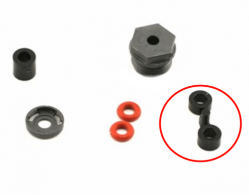

It's not just the springs that are the problem is is the shock cartridge.
you have the newer double o-ring cart which is much shorter than the original both inside and out. you need spacers inside the shock to shorten them up and spacers outside to limit travel slightly.
Top_Billing
Posts: 41
Joined: Mon Nov 27, 2017 5:32 pm
Location: Delaplane, VA
Re: JRX Pro Rebuild
Post by Top_Billing »
Got it. I'm gonna add a pair of these to each shock.
