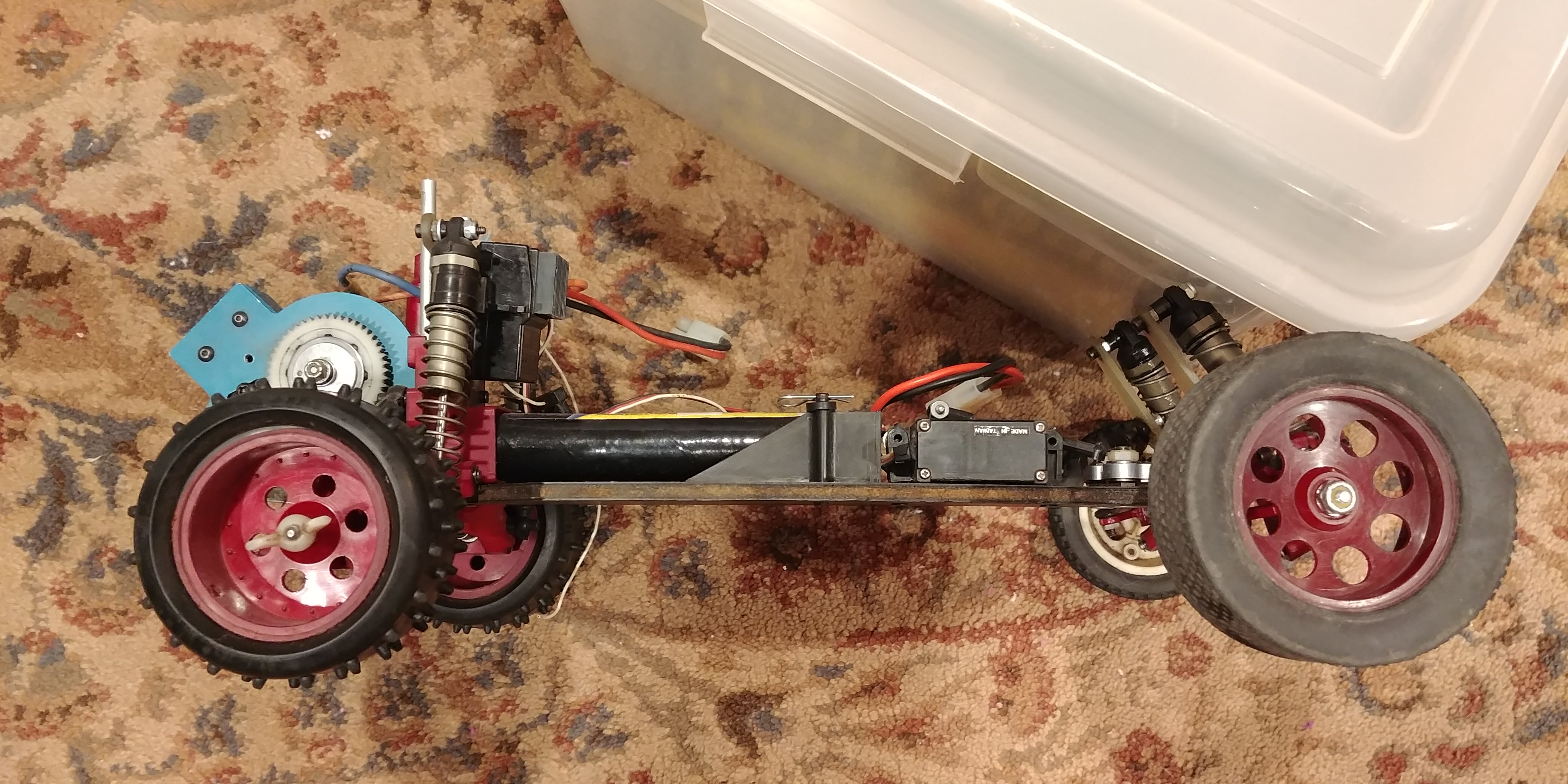

What you have on there is an upgrade. The bodies are hard anodized and Teflon coated

jwscab wrote: Thu Feb 15, 2018 9:20 pm The shocks are hard anodized associated team shocks. You should be able to getting all of your replacement parts from Associated directly, start with the 'classic' manual for trans rebuilding. Steering bellcranks are rps/losi
Looking close at the pictures it appears your right bellcrank needs to be flipped. The flat-most side should point towards the inside.

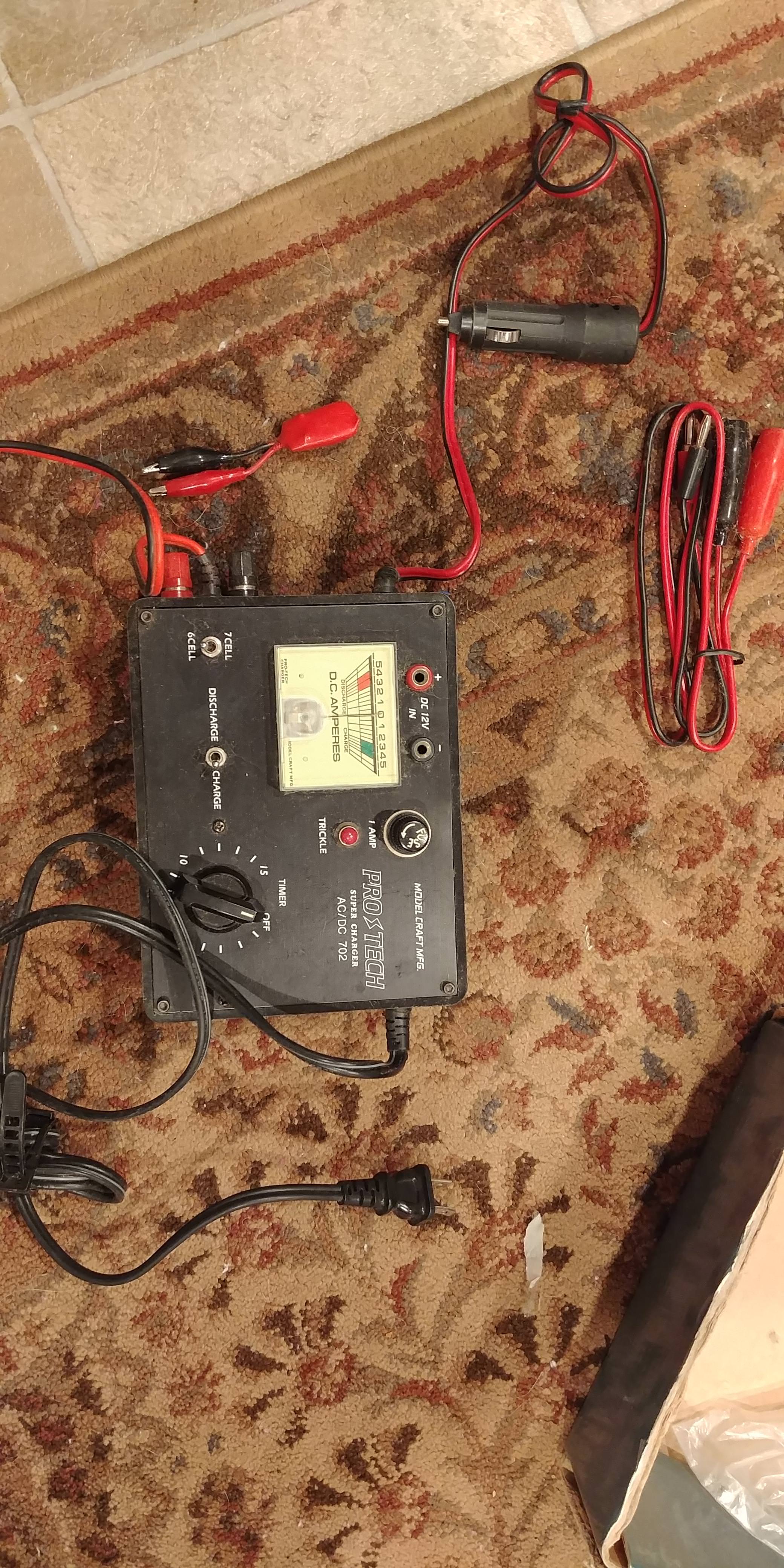

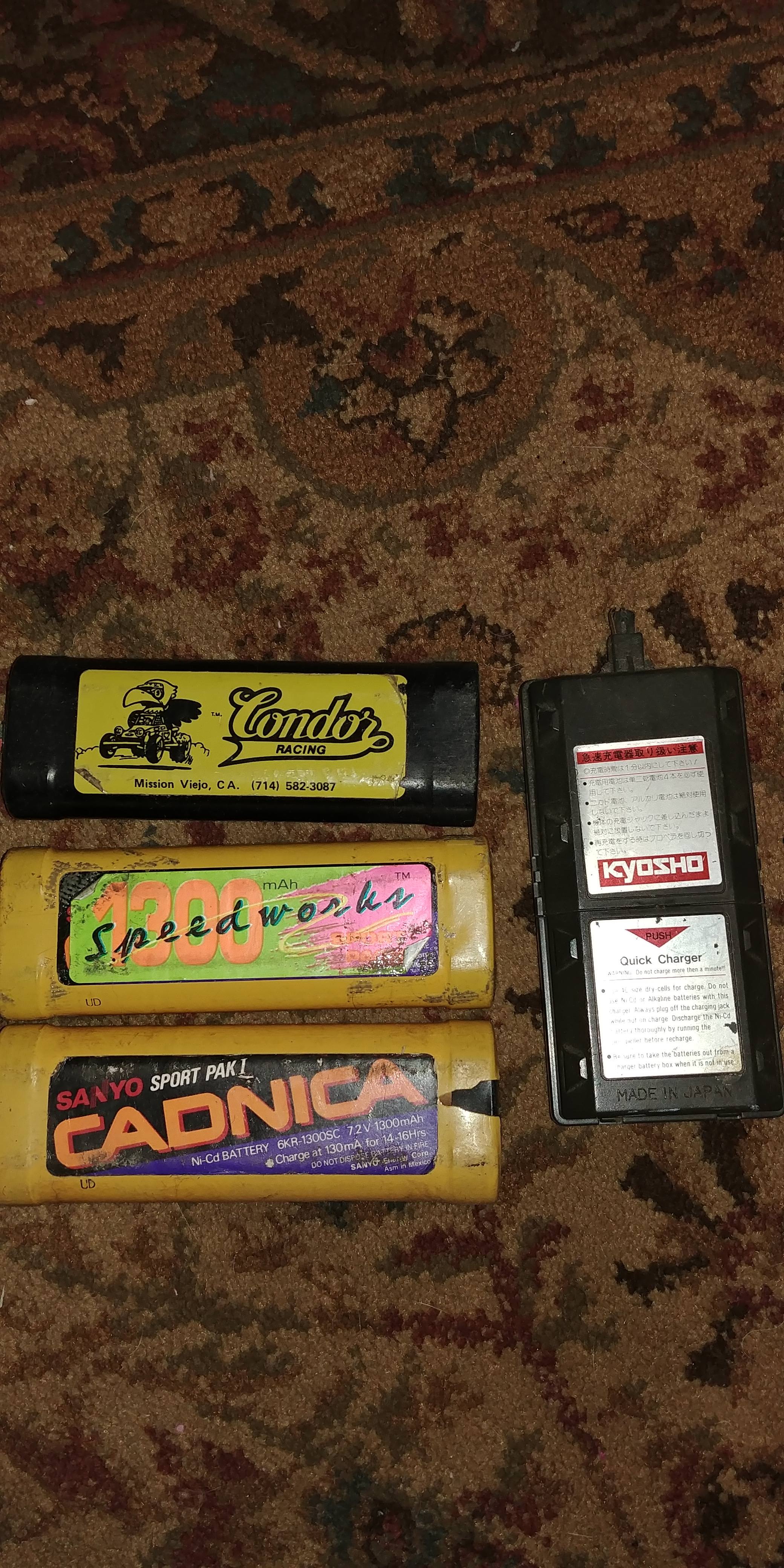

Old Charger, it should work with new NiMh batteries? Just takes longer?
Some other memories i found in the box:
Thanks. I will look into that.

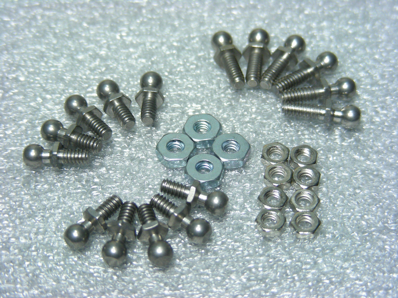

I ordered the rod end cups, not the stock open top style. So I need to get the regular ball studs to work with the RPM cups? Which ones should I get?

So i bought some unused Worlds car ball studs from ebay, those should work, right? At least for the front? How about the rear, anyone know the sizes from bulkhead tab to knuckle (4)?
Some parts arrived today. Not sure how I feel about the black RPM ball cups. I want to try and keep a 'vintage aftermarket' look to this buggy, they look too modern. Maybe I will keep them.

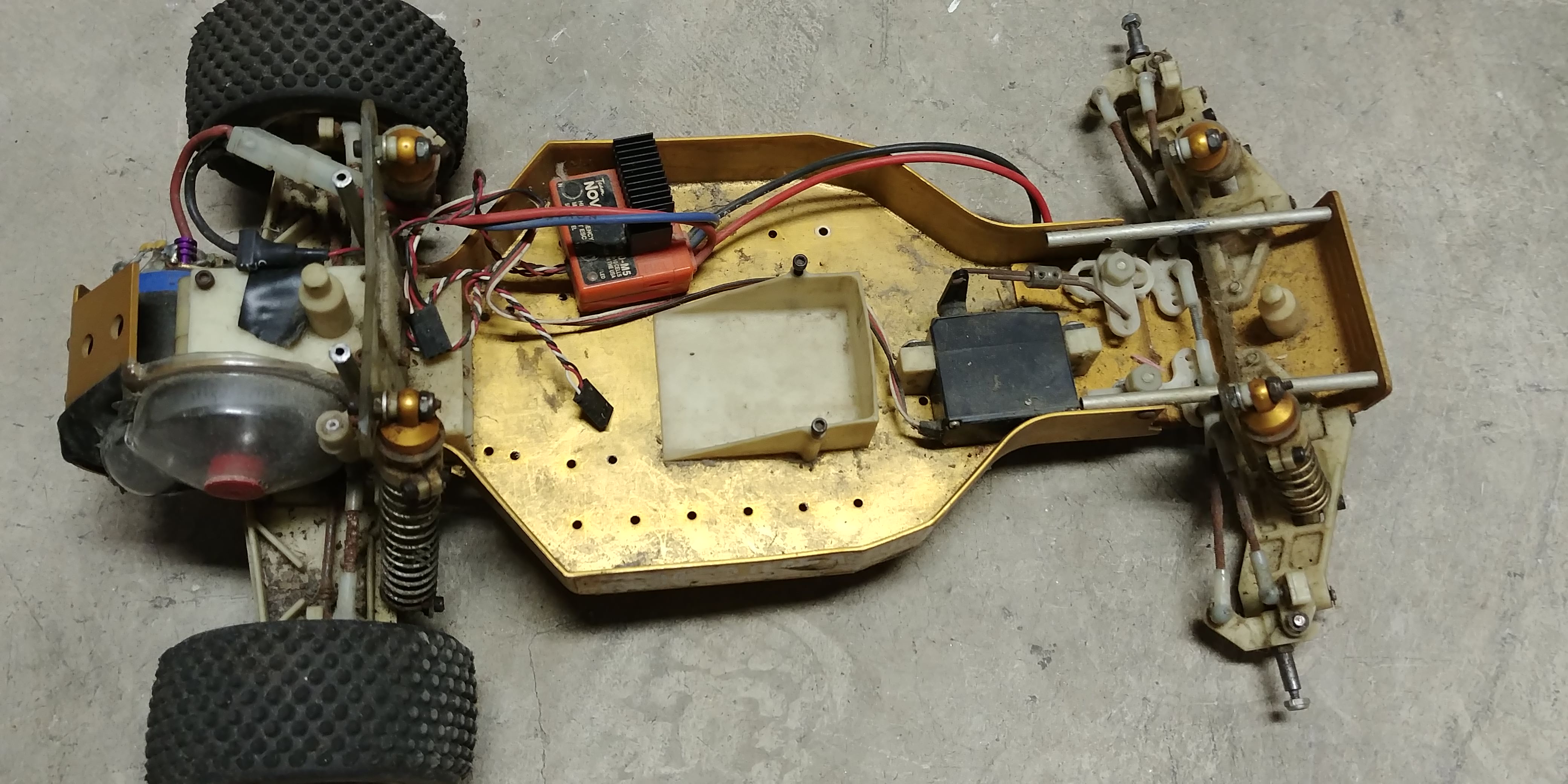

ThankS! I stole the stock one from my older Brother's old A-stamp that needs a lot of TLC, sat in my parents wet basement. It was a quick car, think it has a 10T Trinity motor and Novak M5. The old rust shocks have the old plastic sheet material for seals, they always leaked.

If your brother isn't looking to take that gold tub car back, I'd suggest you use that for all the new bits and put the foam core chassis on a shelf. The aluminum tub is going to be sturdier than 30 year old foam. :wink:
Swap the gold shocks for the gray team shocks.

Hmmmmm.... I told him I would clean it up a little, replace rusty parts and ship it out to him. Is a 30 year old foam chassis really that bad? Better off buying a cheap gold tub from fleaBay? A stealth trans would be nice if I found a cheap parts gold/black tub, i never find those deals. Dang it, why are you making me spend more money? :lol:
