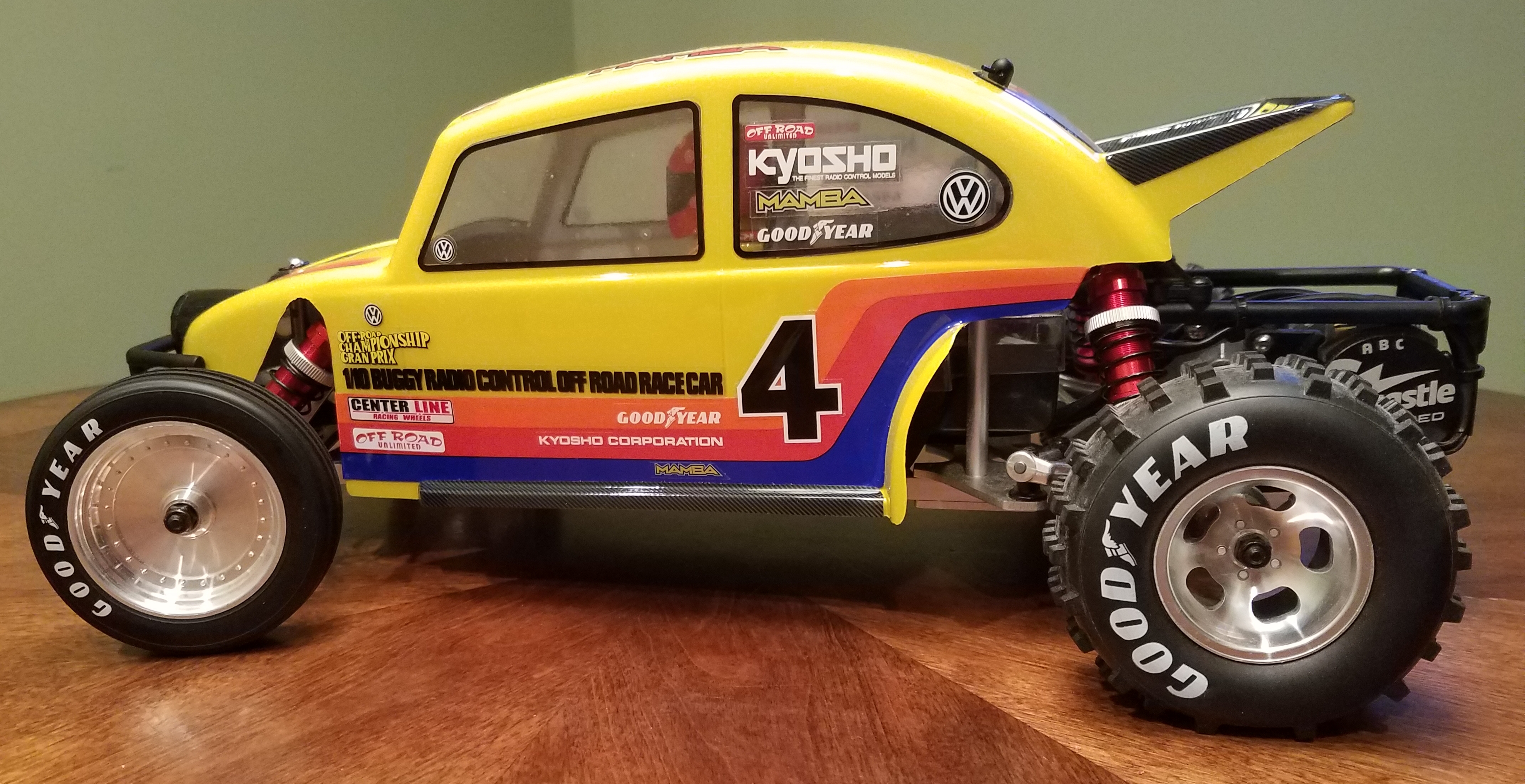

WOW, the car looks awesome! Nice job!! The Centerlines and GoodYear branded tires really add scale realism.

Pretty or not...this Beetle was purpose built to run in the sand and relive some mid-80's middle school. I've replaced all of the screws, nuts & washers with stainless hardware. The rear tires hook up reasonably well on asphalt & the wheels don't seem to spin on the hubs, however, I do have satin chrome 2.2" Turbo Scorpion wheels en-route that I plan to install for bashing that are hex's in the rear. That should take care of any worries about the hubs spinning on the wheels.
Lonestar wrote: Mon May 07, 2018 4:58 am it's very sexy 8)
Thanks...I do dig the way it came out. The decals supplied in the kit make it very easy to get the box-art look with a single color paint job. The driver figure took more time and effort than the body.
As a whole I've really enjoyed building the Beetle which is pretty much the same as the Turbo Scorpion I built before it. With the changes I made it is the same except for the body, the rear body mount posts and the front post...along with a tub cover which is one reason I decided on the Beetle when I wanted a beach toy.

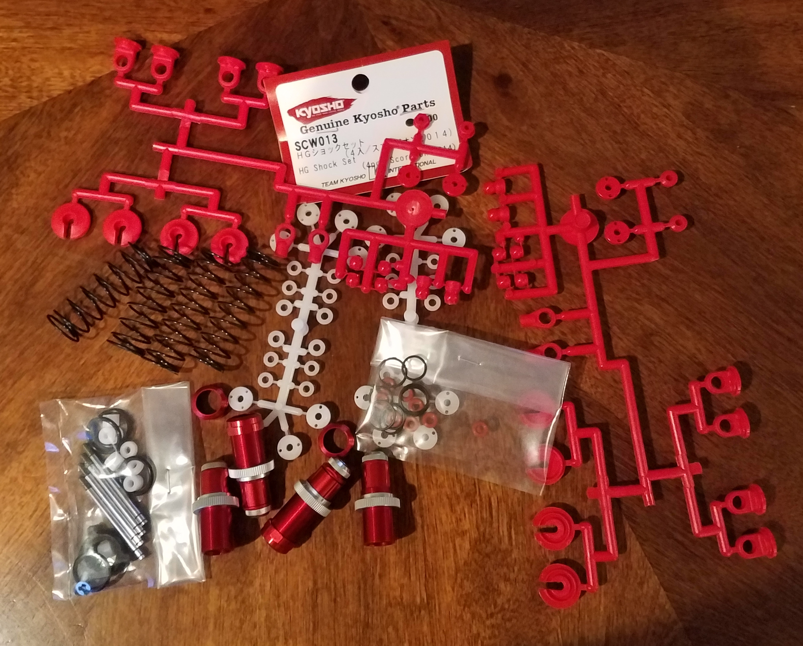

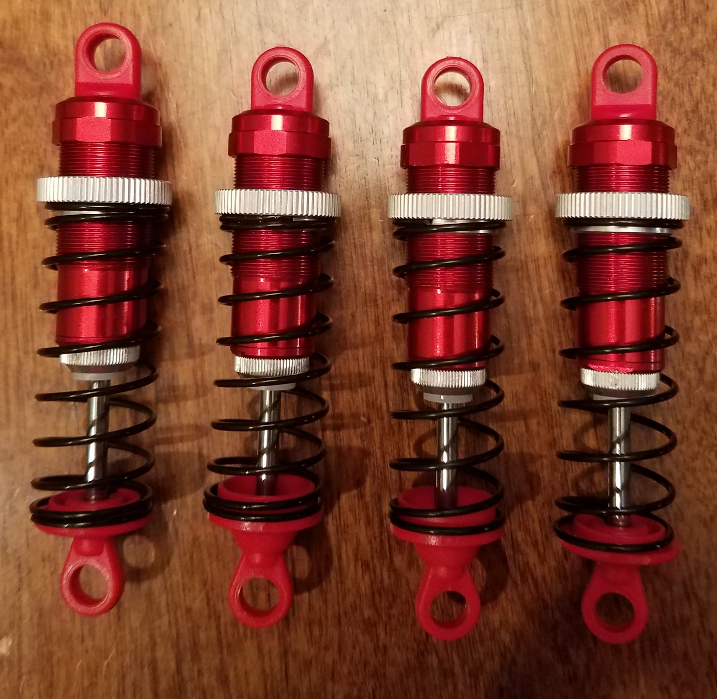

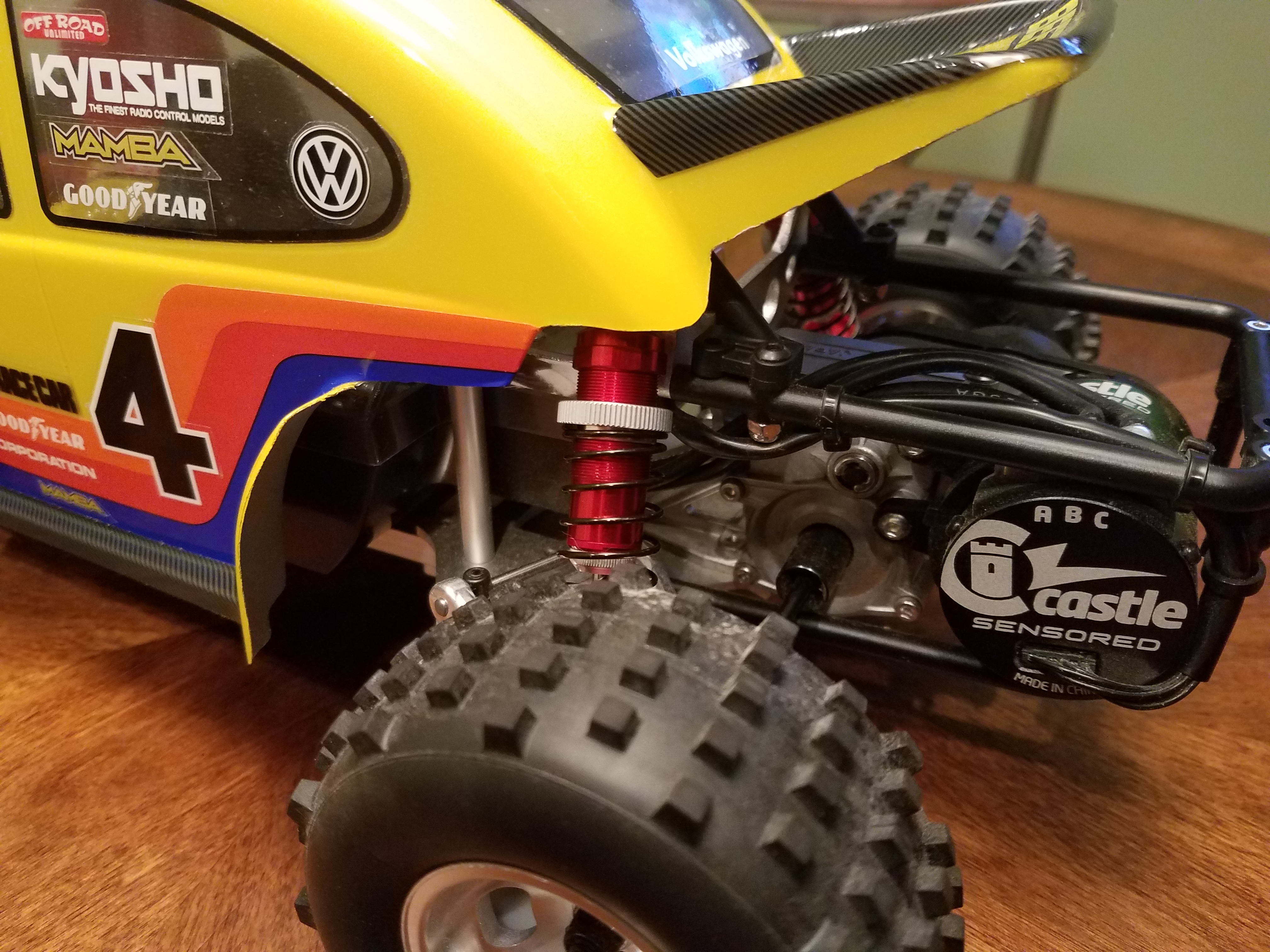

The HG shocks arrived yesterday.
The HG's are buttery smooth. They are tons smoother than the stock Turbo Scorpion shocks I had on the Beetle. I wasn't sure when the HG's would arrive, so I robbed the shocks off of my re-re Turbo Scorpion to use on the Beetle temporarily. The front suspension seems to be much better with the HG shocks. I haven't had a chance to run it yet, but the difference smoothness is very dramatic.
Here they are installed:
Adam

Very cool build. Do you recall what weight oil you used in the shocks? I have HG's on the way but didn't know what oil to use.

Garage Hack wrote: Sat Oct 26, 2019 12:29 pm Very cool build. Do you recall what weight oil you used in the shocks? I have HG's on the way but didn't know what oil to use.
I used 25wt Kyosho shock oil that was from my Turbo Scorpion kit. I'm no shock oil expert but it seemed to work well.

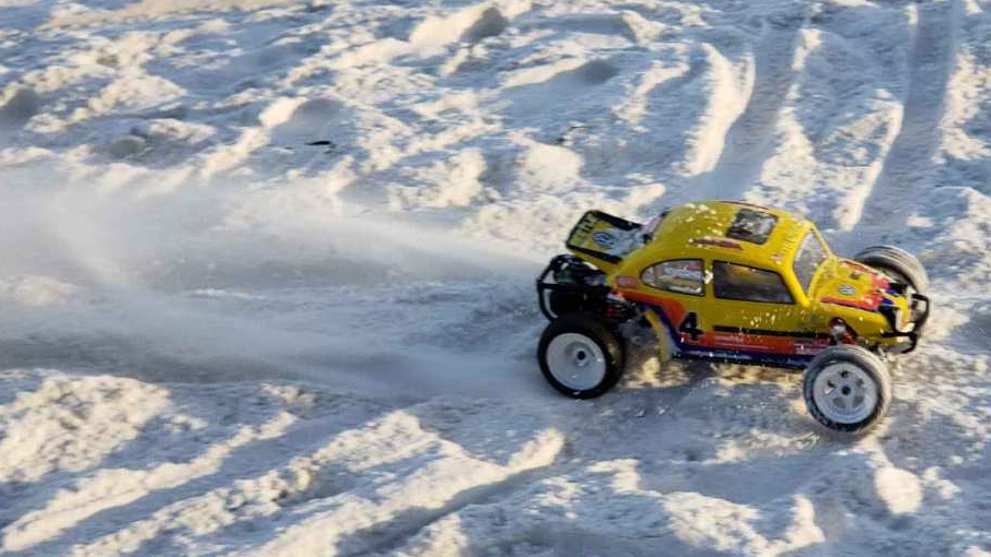

Btw, I never posted an action shot...
It did well but was (as others suggested) way overpowered. I've since removed the esc & motor & will replace it with something a little more tame...probably the Kyosho LeMans 240S & 15.5 turn brushless motor.
Big power makes the Beetle very hard for me to drive. I've built a re-re Javelin, Optima & Turbo Optima and they are fun & easy to drive with tons of power, but my opinion is that Turbo Scorpion & Beetle are better suited with 13.5 or more turns brushless.
