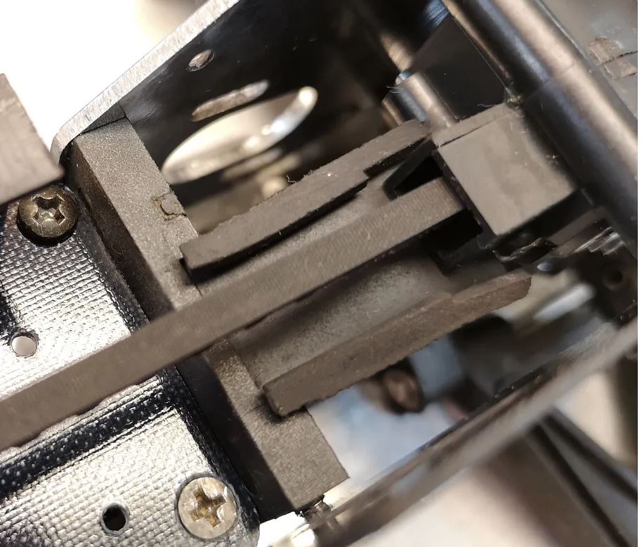

adam lancia wrote: Sat Mar 06, 2021 6:13 am
XLR8 wrote: Fri Mar 05, 2021 7:00 pm FWIW, I've owned 3 or 4 Mids and all of them were missing part OPM-9. You can see it here on page 13 of the manual.
I've never actually seen one but I think it's rubber. It's meant to seal the underside of the belt cover where the belt exits the rear gearbox - directly above the motor. This part never comes up on ebay so I think it's rare.
I've made a rather poor substitute by forming a piece of lexan but it really doesn't work very well.
I'd reckon this part would be a perfect candidate for 3d printing if anyone has access to one they could replicate.
I've never even noticed that in the manual. You're right that it never comes up in auctions, it's gotta be a hens teeth sort of part. And you know, when I went to university in Urbana-Champaign, I spent a lot of time at an LHS that got all the scratch and dent pallet loads from Tower Hobbies. Those got sorted into huge Rubbermaid tubs of parts, almost half of them Kyosho, and I have never seen that part, ever.

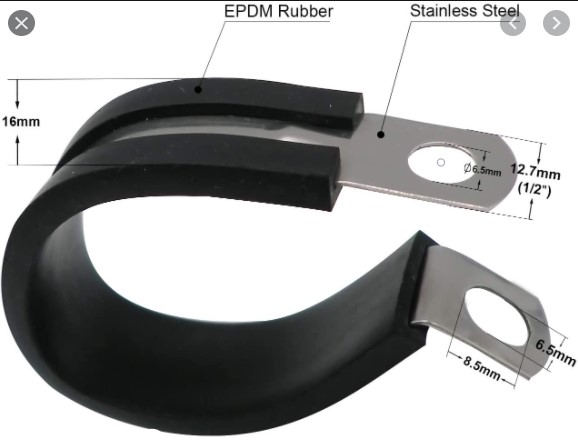

Do you guys think this might possibly be a solution?
While out in the garage I stumbled over an old cable clamp.
New clamps are cheap enough to experiment with.
Chuck
In fact, I don't even recall seeing this part in any build photos. It would be great if someone here could confirm that it even exists.
I could attempt to make a CAD model using the mating parts as reference if someone with a printer would be interested in printing it. ... or I could send it to Shapeways.
Anyone else interested in having a printed replica of this part?

radioactivity wrote: Sat Mar 06, 2021 11:15 am
Chuck
It's definitely worth a try Chuck. Its gotta be better than what I came up with. It's the right shape and material.

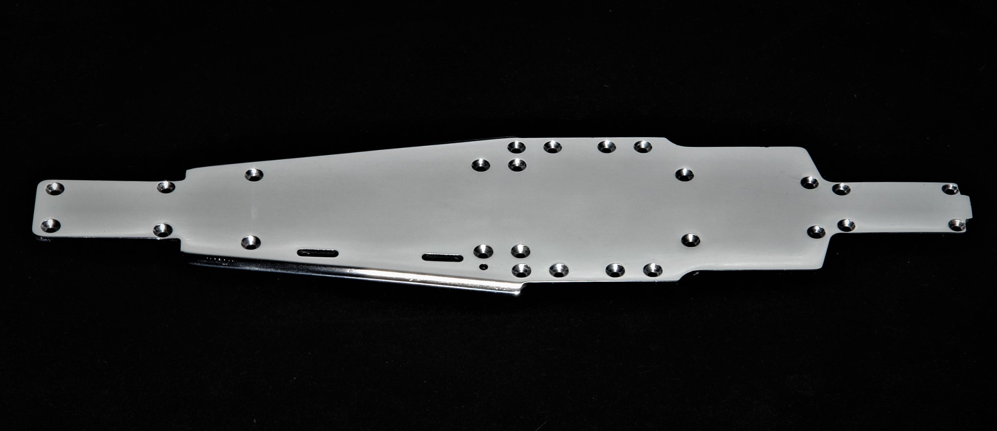

Cleaning , polishing and a little paint.
Hours of cleaning. Hours of sanding. Hours of polishing. And a little paint on the wheels.
Toothbrush with simple green, dishwashing detergent and marvel mystery oil.
220grit, 320, 400, 800, 1000, 2000 and 3000.
May be 50% of the way done with cleaning and polishing. Ordered a new buffing wheel for final polishing.
Will admit the chassis turned out way better than expected. Shiny as a diamond in a gophers butt.
Wheels are OK but were rough to begin with.
Trying to decide if I should do the anodizing myself or farm it out.
The rear diff and gears were trashed but just can't justify the expense of those dang rear diff halves (gear side in particular).
Ordered more parts yesterday, ordered some last week probably more next week :(
Chuck

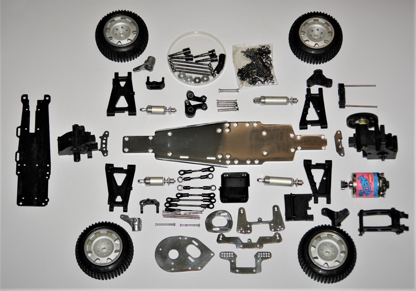

Let the assembly begin! 8)
radioactivity
Posts: 856
Location: Dripping Springs Tx
Has thanked: 384 times
Been thanked: 618 times
Re: Turbo Optima mid (SE???)
Post by radioactivity »
Coelacanth wrote: Mon Mar 08, 2021 12:19 pm Let the assembly begin! 8)
Oh boy...
I wish I was there.
Lots more parts to go.
Gears, rod ends, anodizing, CF towers and upper plate, fabricate shock ends (not fun), body and belt/gear covers, OT17, OY45, OT28,OT26, OT33 bla bla bla.
Time to let my fingers recuperate from all the sanding and polishing :roll:
Chuck

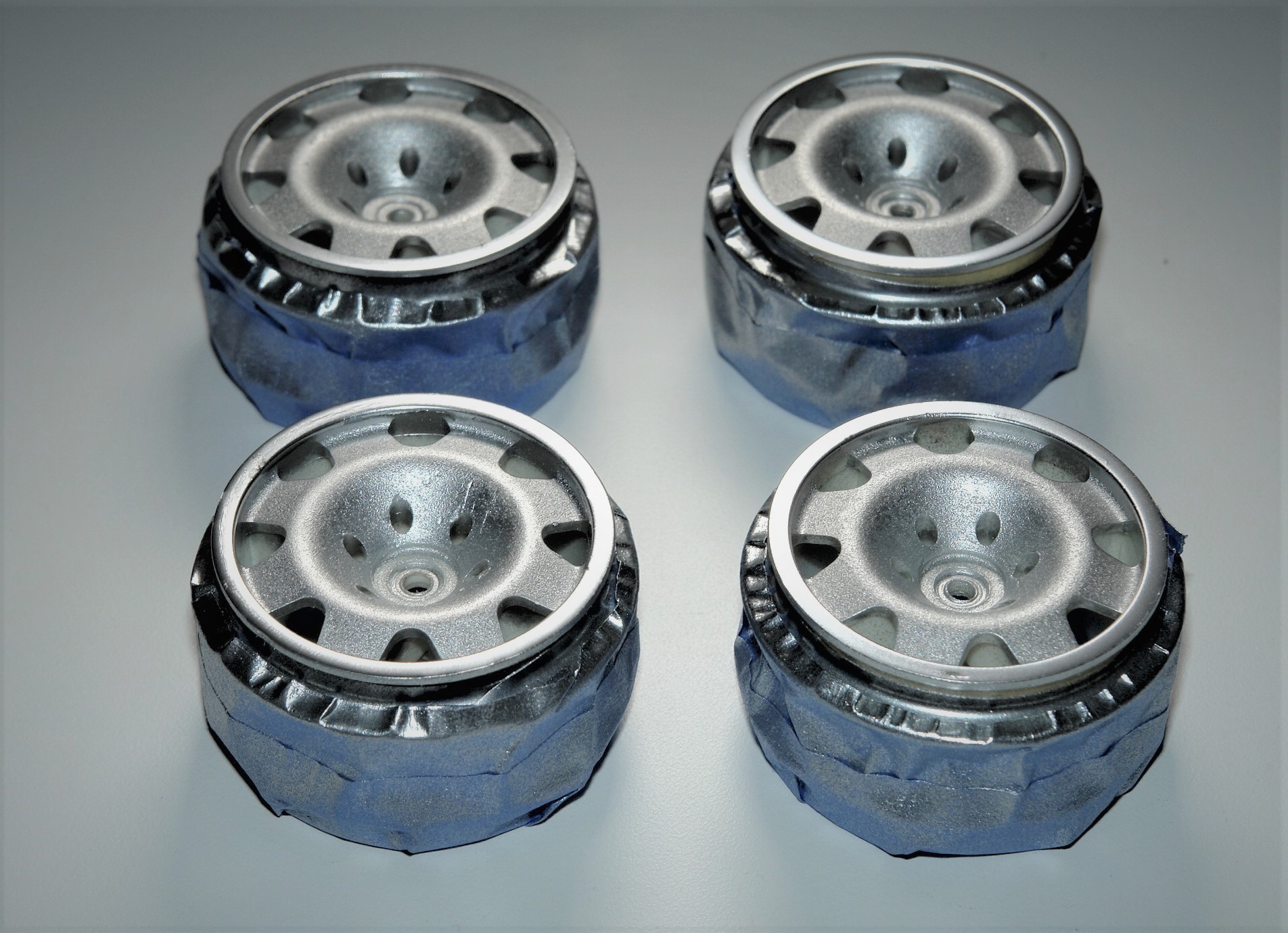

The wheels were a little scary.
Last week I totally melted down a pair of Duratrax wheels in acetone.
The Duratrax wheel had a lot of tire rubber and cyanoacrylate glue on them and I was trying to clean them.
Checked on them after an hour and they had melted, guess they weren't nylon Should have checked first :oops:
And before I get flamed, painting nylon doesn't work, don't paint nylon, it will not work, you will never be able to use those wheels.....
That said...
Only had one shot on the SE wheels so I got 95% of the chrome and glue off with alcohol a toothbrush and cotton swabs.
Then picked the small hard pieces off with a small dull straight slot screwdriver.
On the raw nylon? I sprayed adhesion promoter maybe 10 minutes before any silver.
Next the entire wheel got the Dupli Color universal silver.
After drying, the outer rim was wet sanded 2000 then 3000 to get as smooth a finish as I could.
After masking I shot only the rim with the Rustoleum chrome paint.
May have a hard time finding that particular Rustoleum paint 'cause it's probably older than most of the people on the forum :lol:
In retrospect some CA as a filler for some of the small dents may have worked somewhat like Bondo. But I'm done with the wheels for now.
Chuck
