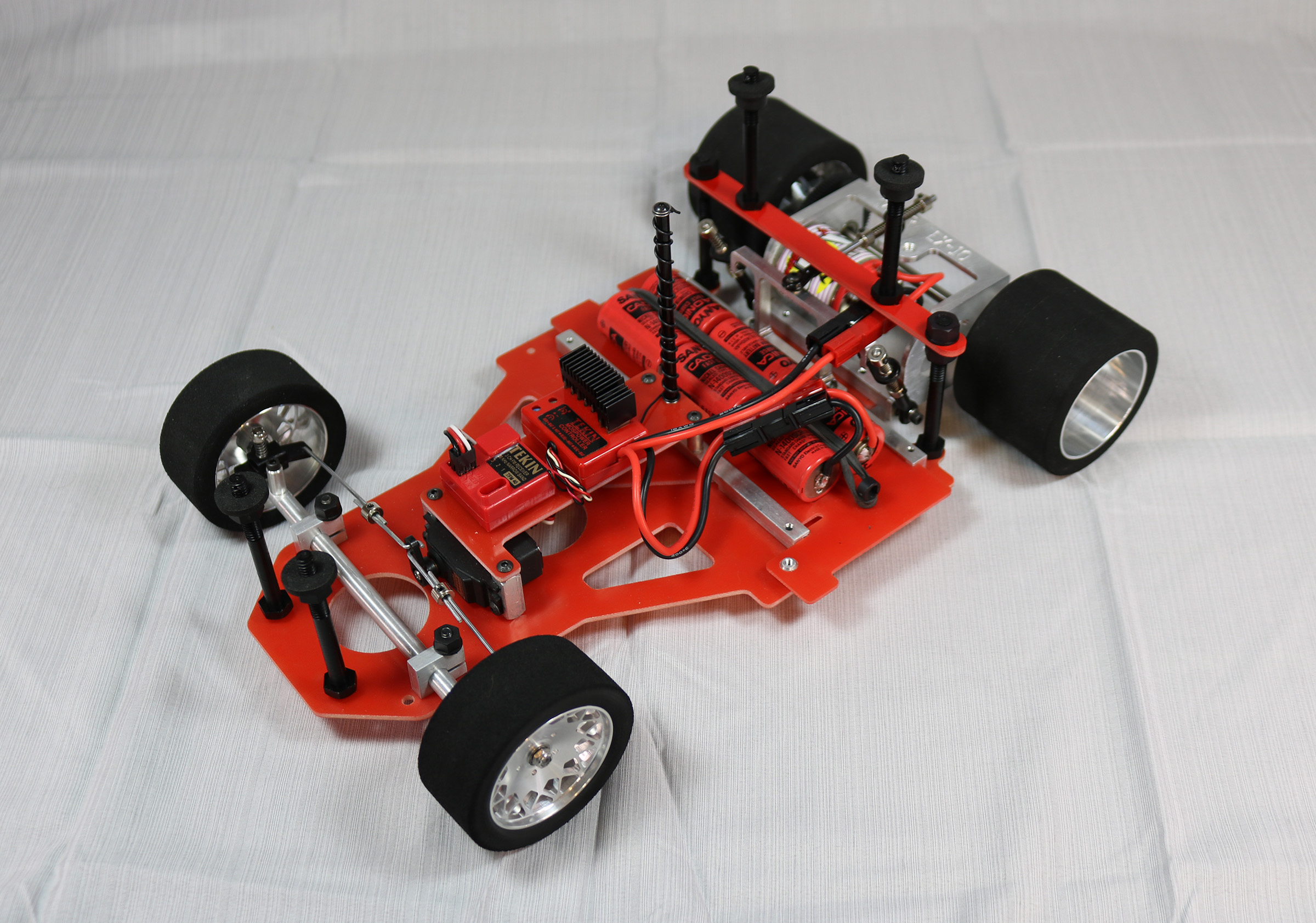

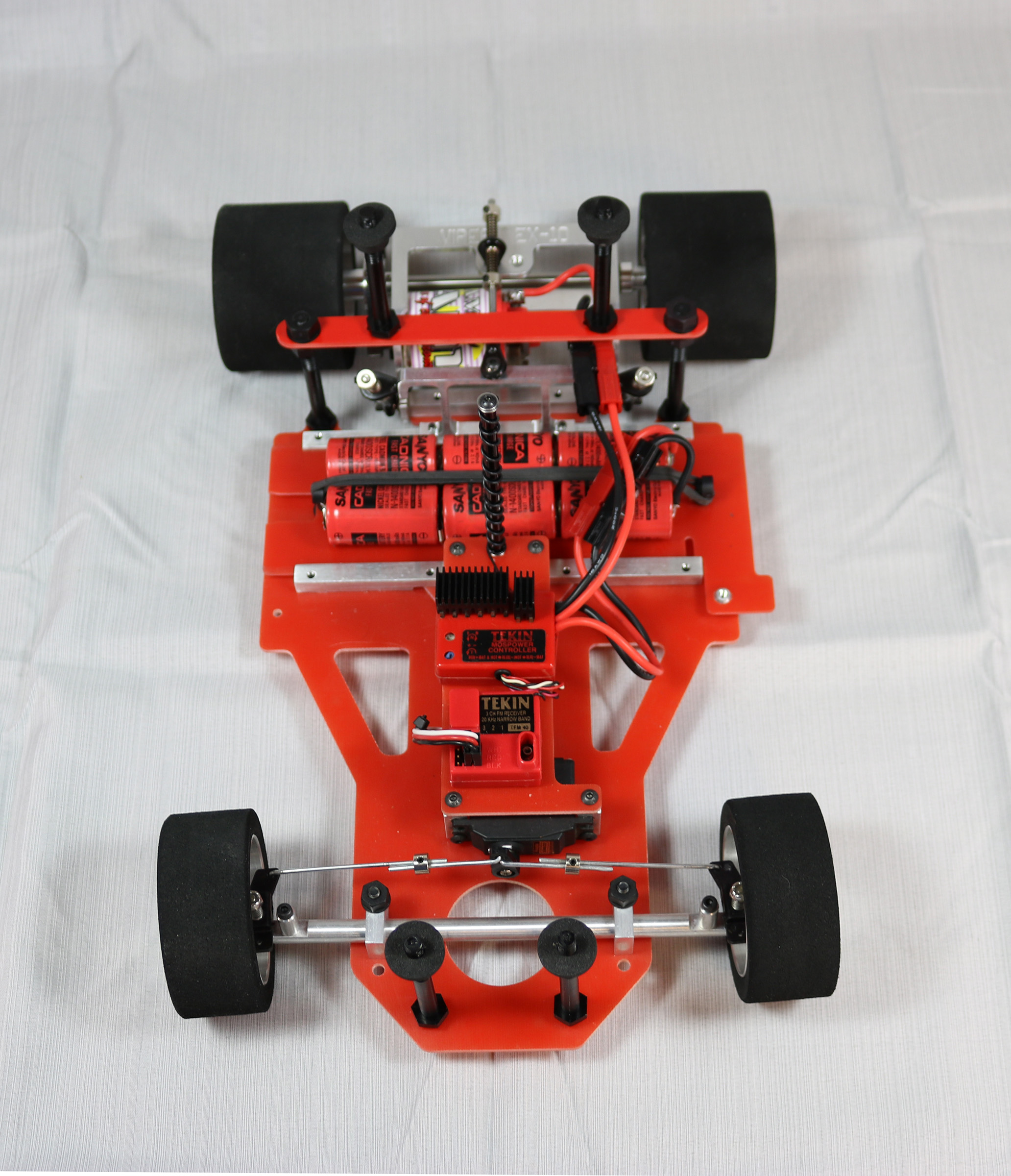

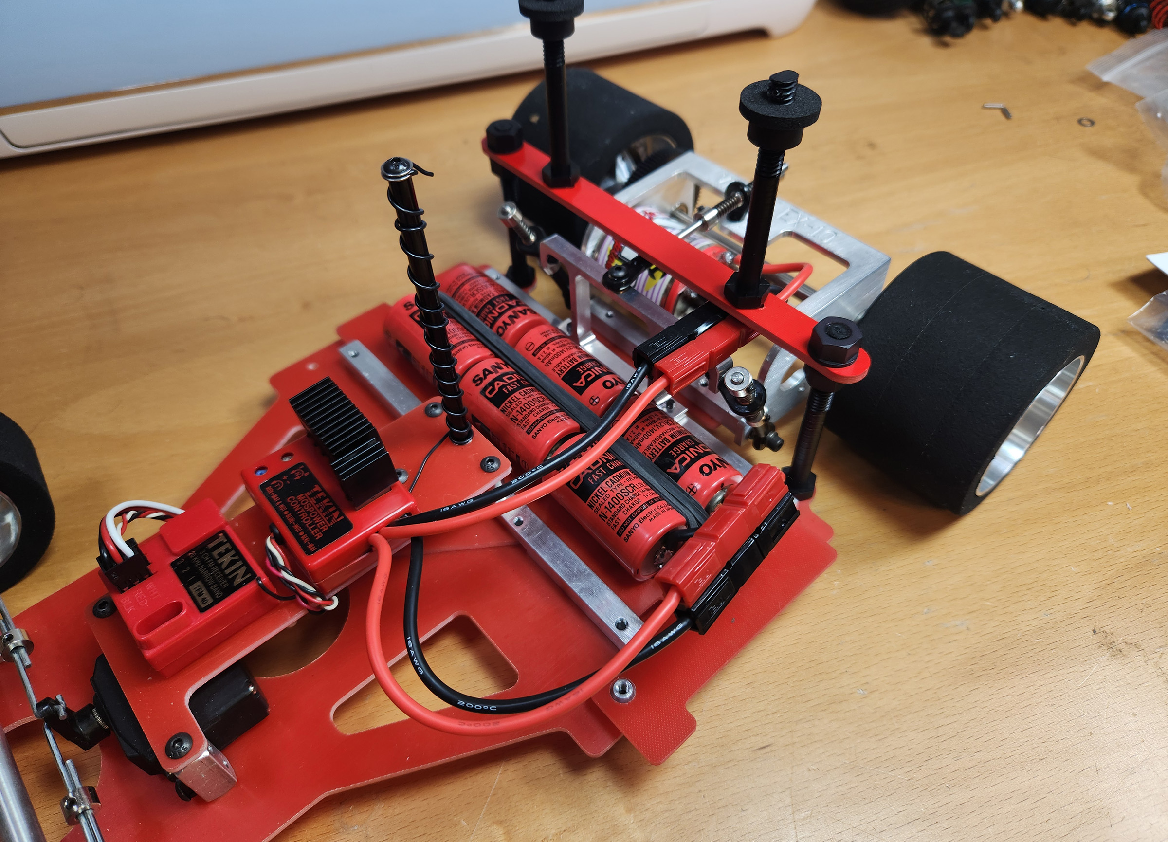

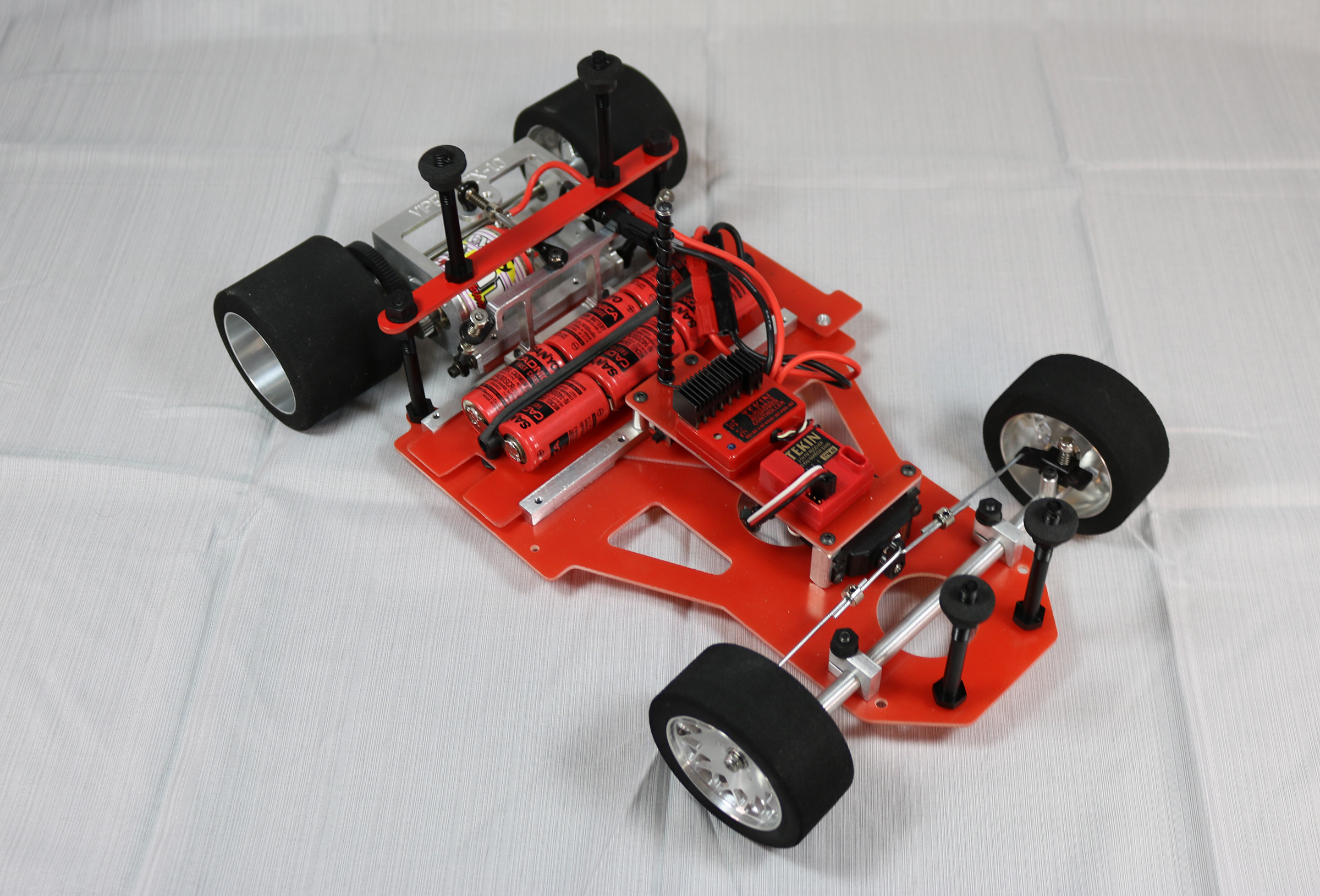

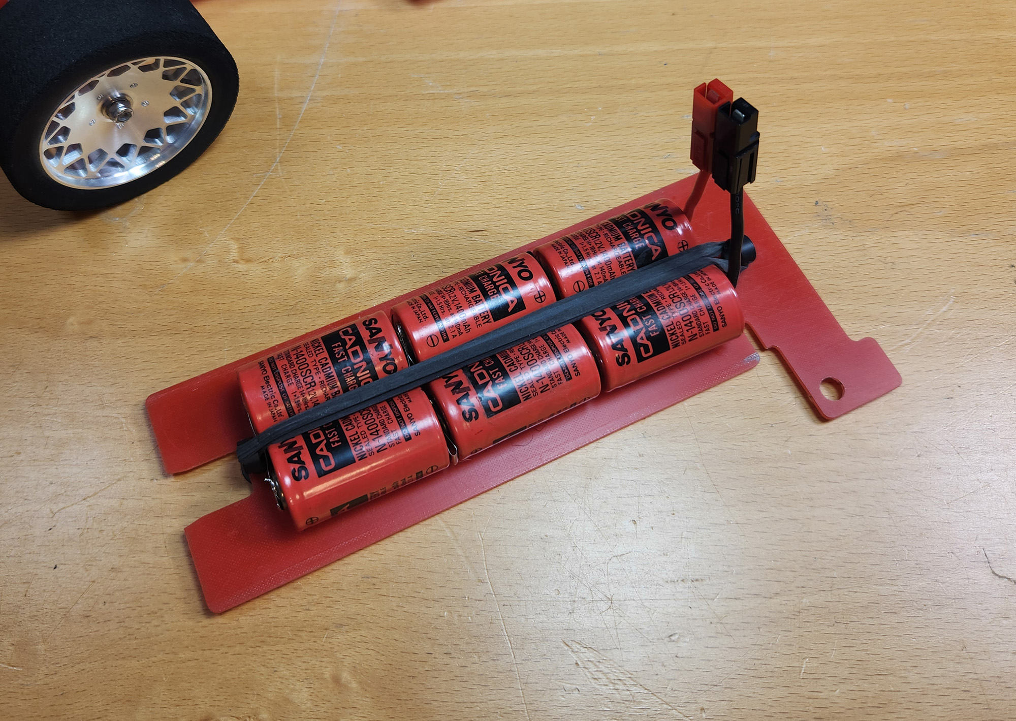

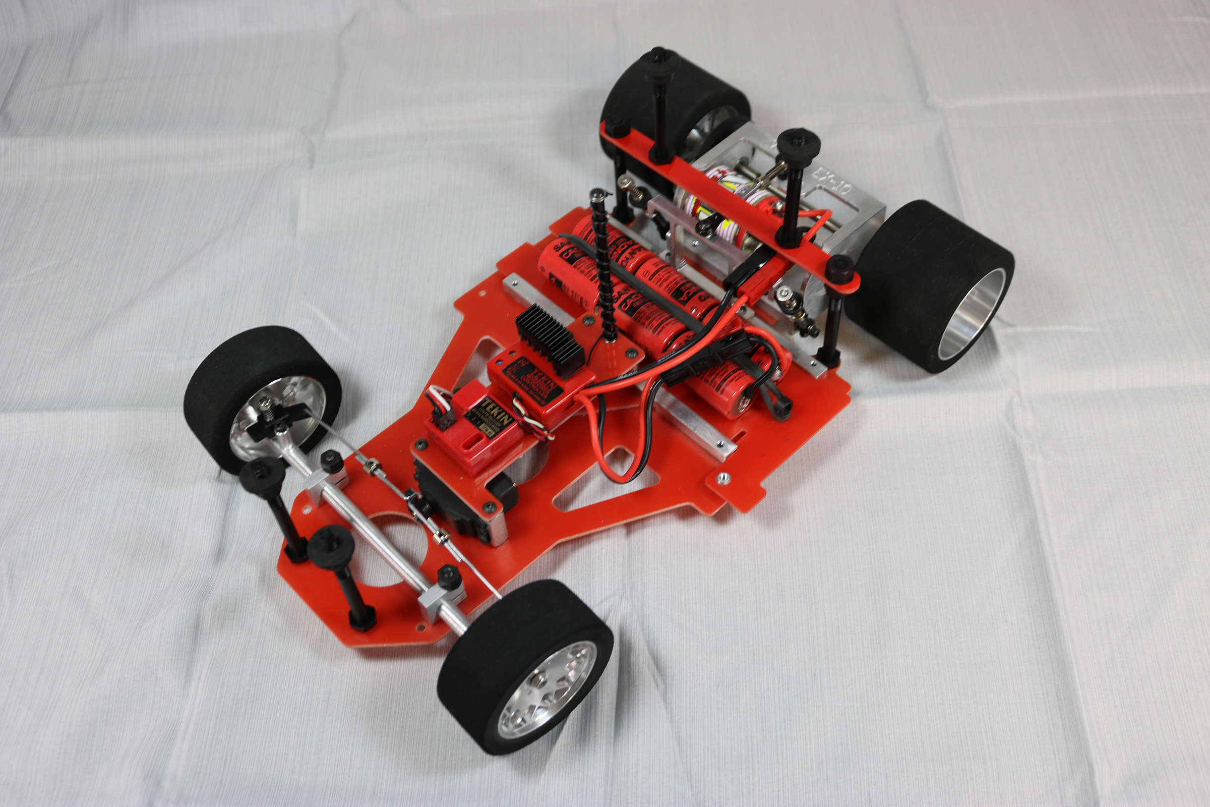

Got the battery pack made up, which completes the chassis, I think.

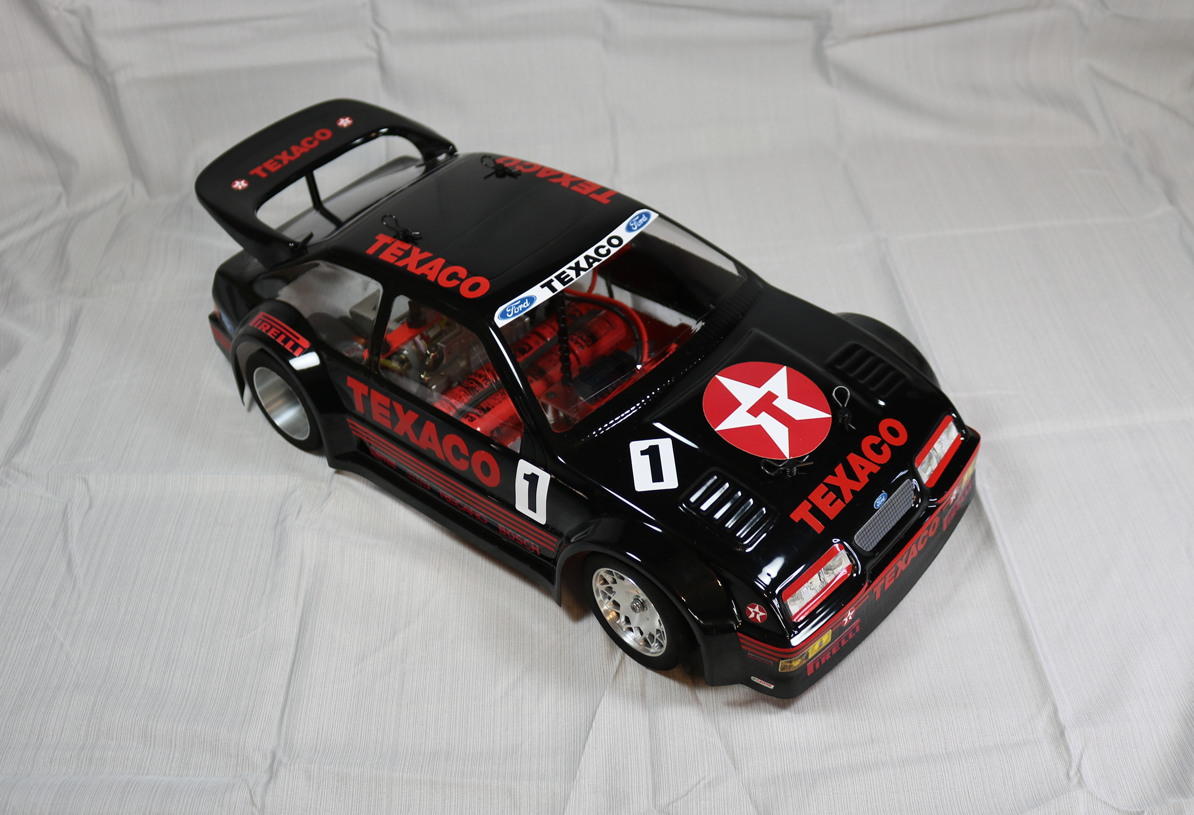

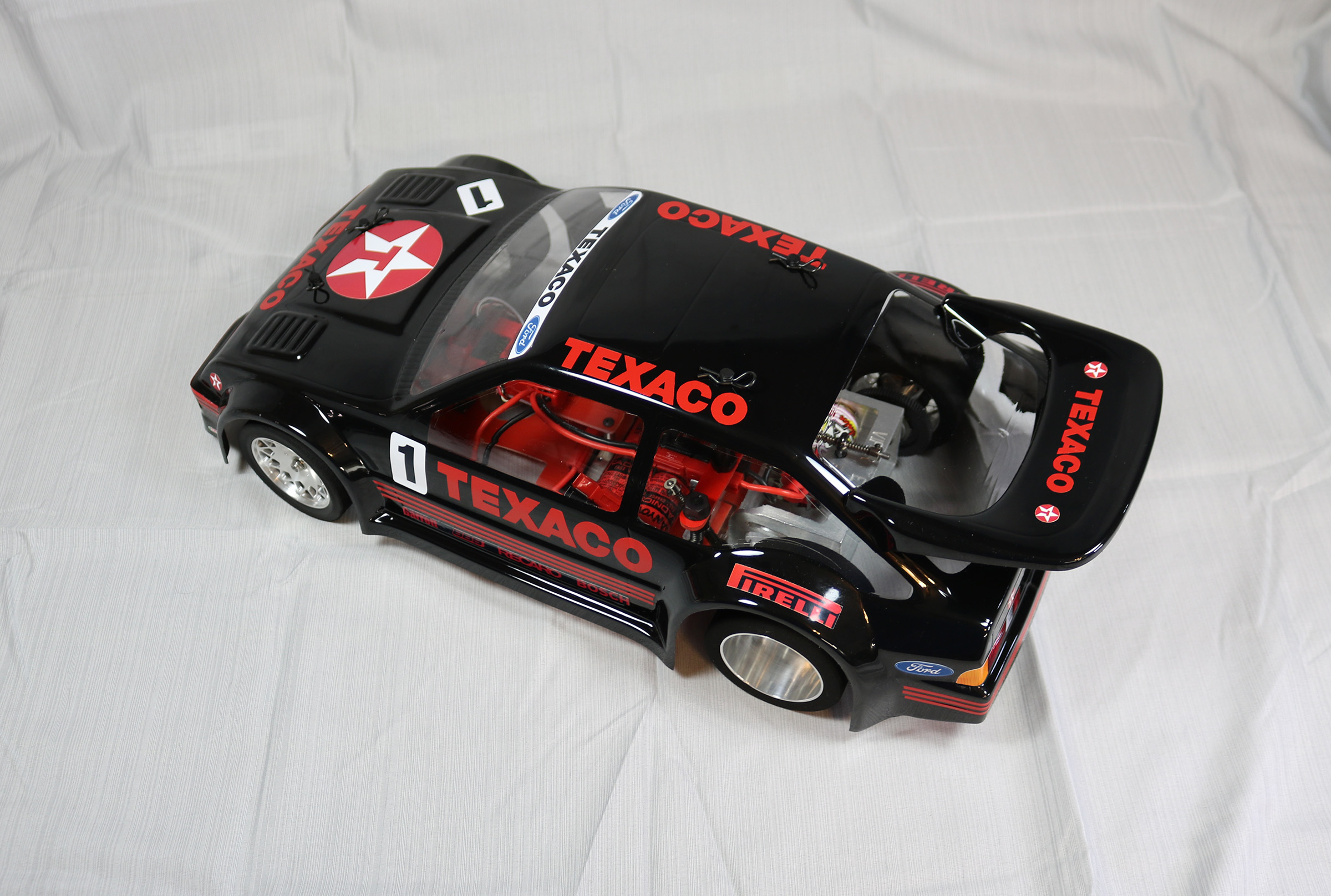

The whole chasing the red thing has just been an experiment, and it proves that you aren't going to get pro results with an inkjet printer and white sticker paper. Now, I do have an eco tank and want to play with different ink types on clear, but that is for the future. Half way through my search for the red I realized that I was trying to match the vinyl that was still on its white backing, and that completely changes once placed on black paint (became much more orangey). So I wasn't even chasing the correct color. So, again I got it close under some lighting conditions, but not all, or even most. Simple fact is the decals are red backed on white, and the vinyl is red backed on black, so they will never match across all lighting scenarios.
Then you run into the issue that the white sticker paper will always show its white on the edges. Have to get this all to work on clear before pro results can happen.
Back to the car, got the whale tail on. Didn't have any means to mount it, so just went with a nylon body post cut to size. FYI, RJ Speed black nylon threaded body posts are not black nylon. They are white dyed black. Glamour shots in the near future.
edit: just realized the body matches the chassis pretty well, since there are about eight different reds on the chassis

I suspected it was...but wasn't sure.
She's a beaut, Clark! The chassis, the batteries, the Cossie body, the Texaco scheme, all of it!

Is this for a shelfer or a runner? I don't know what you mean by "pro results"...but by coloring the white edges of vinyl sticker paper with a black Sharpie does about as good a job as anything to make the red blend onto a black body with barely visible lines. It's either that or have someone make custom decals for you.

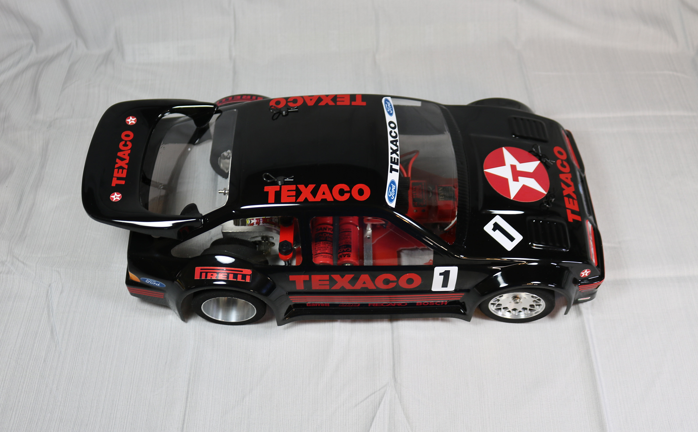

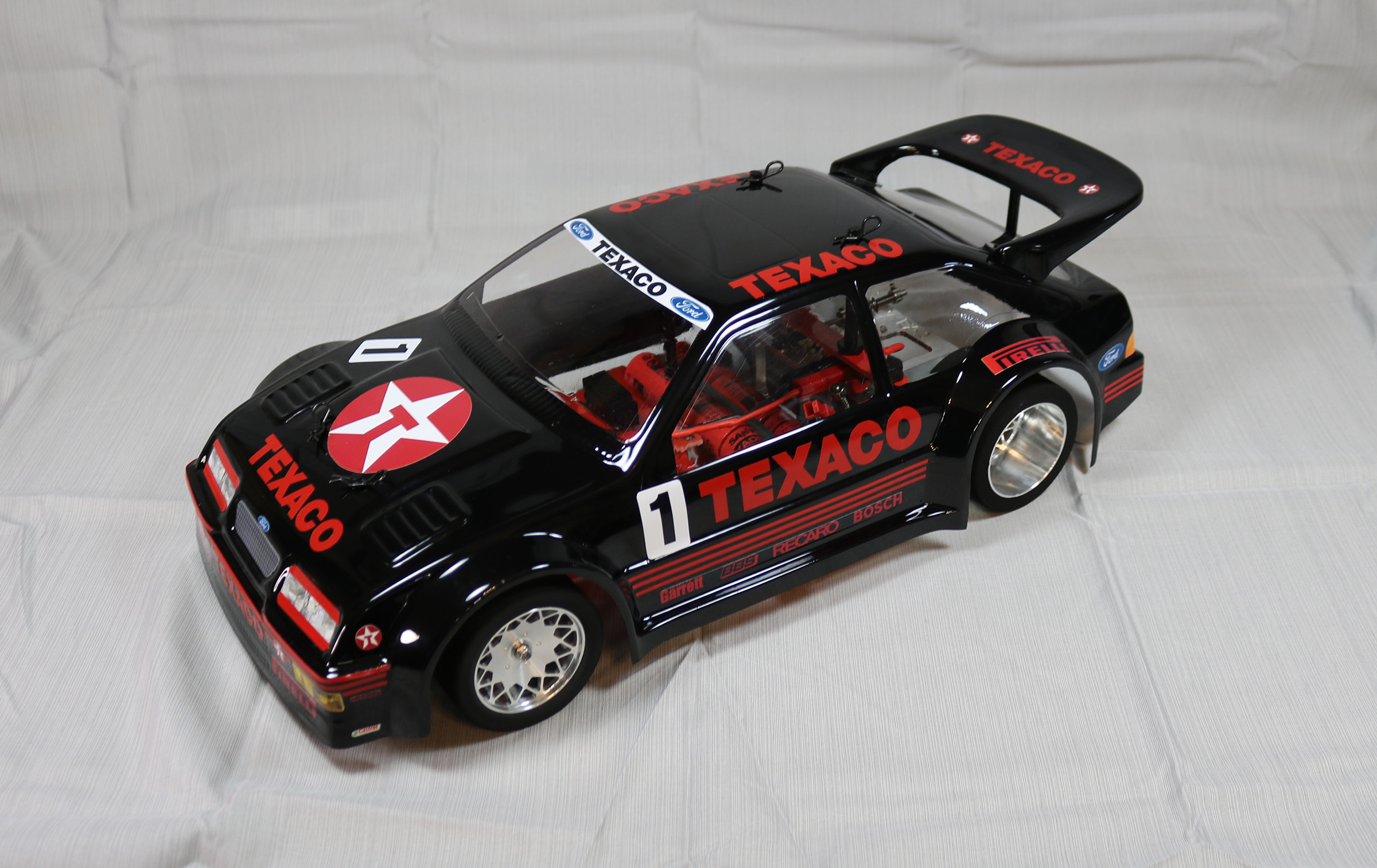

Glamour shots.

- Frankentruck
- Posts: 3808
- Location: Texas, USA
- Has thanked: 2604 times
- Been thanked: 2977 times
Re: Inter-Fab Viper EX-10
Looks ready for a Euro rally circuit! Nicely done!

I love how the chassis is mostly red with some black, and the body is mostly black with some red.
