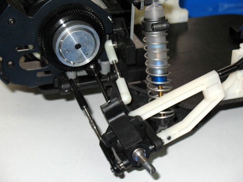

mrlexan wrote:Thanks for all the complements guys.
Anthony, that setup is per the directions provided with the Lunsford kit.
I didn't want to go with a stock steering setup, but the color was the deciding factor.
I'm refering to the lower link that attaches near the gearbox, and appears to be a tecnacraft turnbuckle instead of the solid link that you have on the front side of the gearbox. did that come with the lunsfod kit?
I've got a White MIP ball bearing steering bellcrank kit still in the package. It is labled as for the pro-SE (I think, I'll check tonight), so it may not be exactly period correct, but it fits the all aftermarket/color theme.

Re: My Ultimate JRX2
Post by mrlexan »
Yes, that is what the kit came with, short the T-craft piece of course. They just had a threaded rod. Take some pics of the MIP if it turns out to be a Losi kit. Thank you sir.

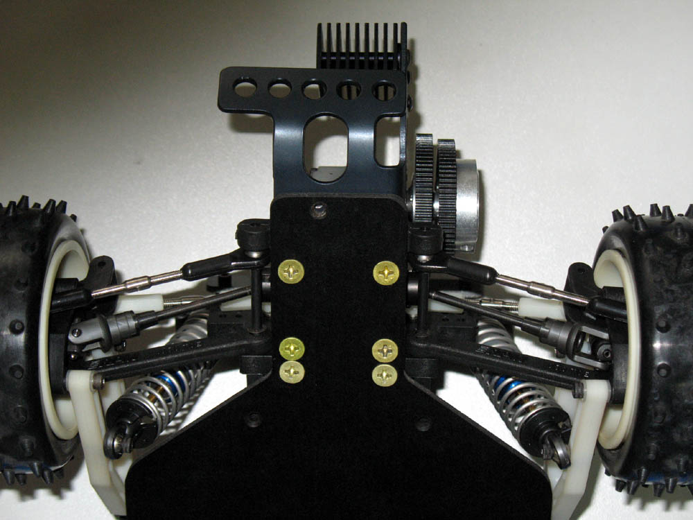

mrlexan
Posts: 6250
Location: Upstate SC
Post by mrlexan »
Pics per Anthony's request..... also thanks to Anthony, I will have a white MIP steering kit to be installed! Thank you sir! :D
www.gojammedia.com
Posts: 16808
missin' a screw in the motor plate. :wink:

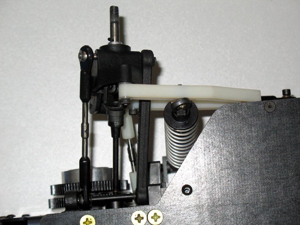

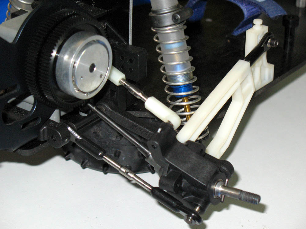

aconsola
Posts: 1999
Location: Upstate NY
Post by aconsola »
Thanks for the pics, now it all makes sense. I could not figure out how the suspension could move without binding. The single large combo link will cause the hub carier to pivot which would cause binding if the 2 stock rear links were used. Having ball pivots on the rear most link(the one with the tecna turnbuckle) will prevent the binding. Cool system.
