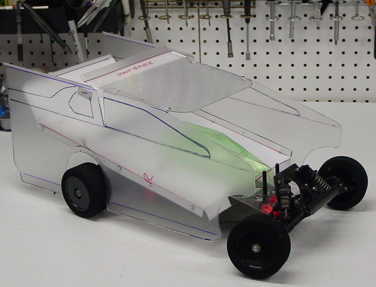

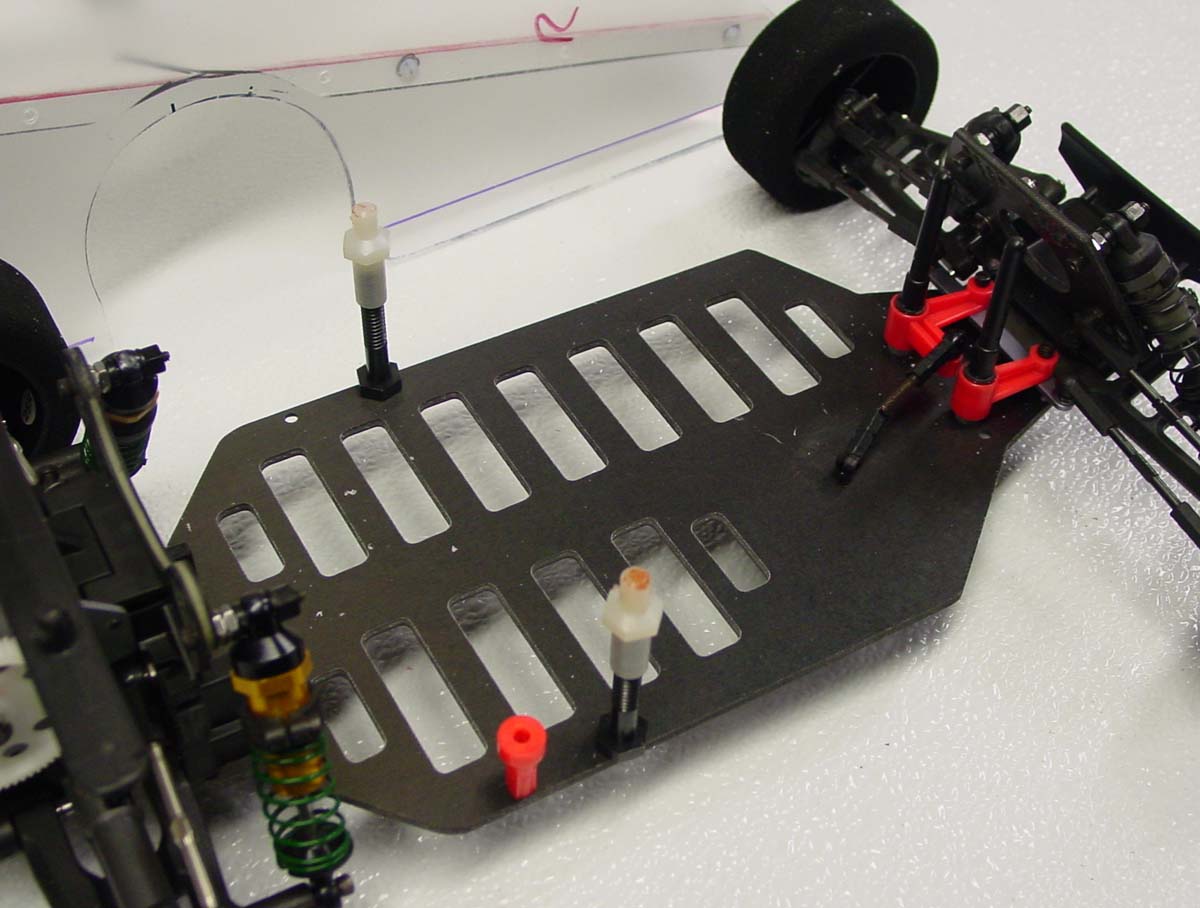

A whole month and finally something to update.
I got some custom works foams mounted. I needed to put a set of .2" spacers on the rear axle to get the rear spaced out evenly with the front, overall is about 9.75" front and rear.
The body is a kippshobbies.com #K1009 USOWC Legal Eastern Dirt Modified Body. It is mounted in 6 spots, and I did not have to drill a single hole in the chassis to do it. The rear is mounted with the jrx't rear mount cut down to the lowest setting. The middle posts are just mounted in the forwarrd hole for the 5-link side bulkheads.
The front mount was the most work. I drilled up thgrough the steering posts and tapped 4-40 threads. I ruined 2 posts before getting it right. I tried to tap from the bottom up so that I could just use really long 4-40 flat head screws to tie everything together, but the tap was about 1/16" too short. I figured I could just wing it with a long screw for the last couple threads, but of course I snapped the bolt off inside the post. Then I snapped a tap on the next one(It was getting tired and did not cut like it used to and i tried to go too fast with it).
The body posts are attached to the steering posts with 4-40 studs, they seem secure, but I will probably wind up putting some loc-tite on the studs to keep them from vibrating off.
