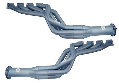

I can't wait to get a set of headers on it, I know the cast manifolds are restrictive and robbing power. I decided not to put headers on it for cam break in due to the heat involved, and I'm quite surprised my pot belly paint held up to it on the manifolds.
I'm going to go with these Pacemaker tuned length headers, 1 3/4" primary to 3" collector. Should be good for up to 500 HP and have good exhaust port velocity.
