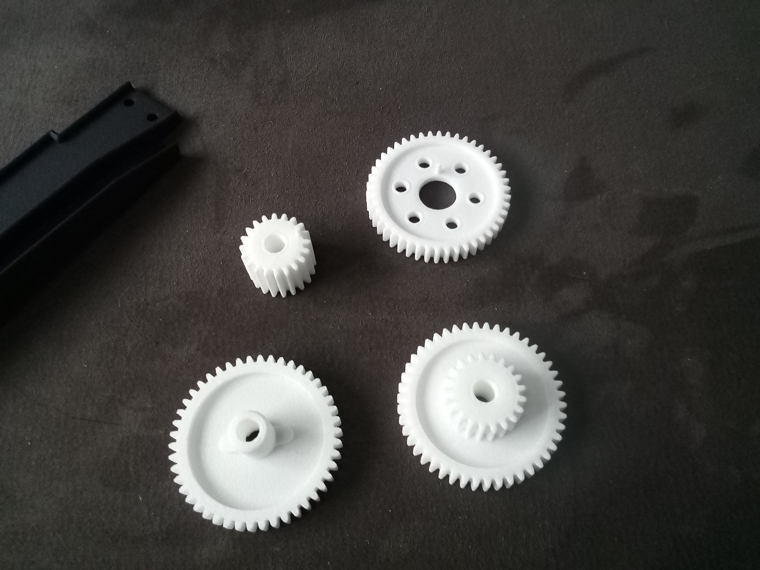

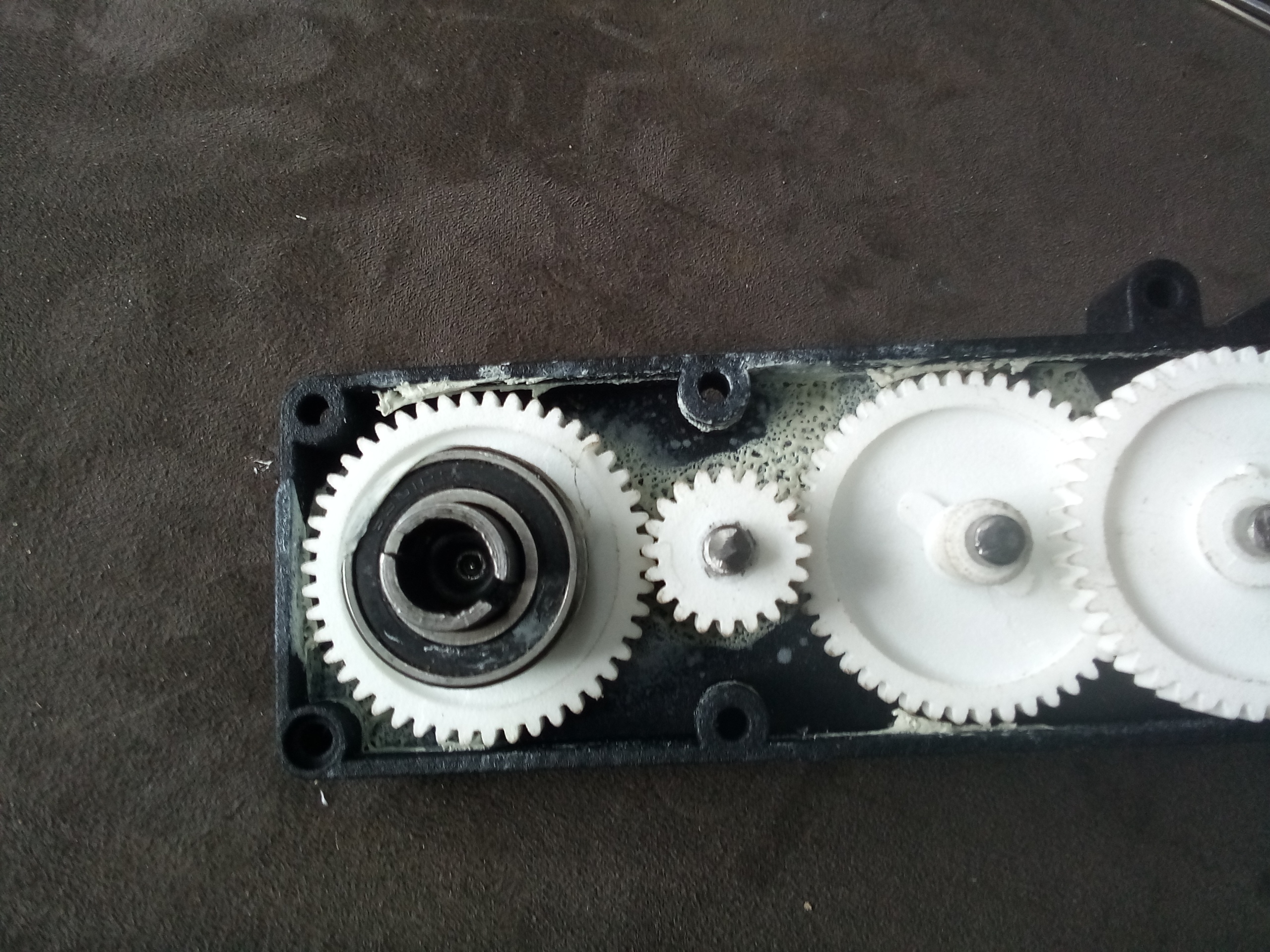

Bit of necro posting but this is the gear set commercially printed by Shapeways , the gear mesh looks and feels great , I need to just tweak the diff gear slightly as the pressure plates make very slight contact with the gear rather than just floating on the balls but we're talking only 0.1mm more clearance .
Next is road testing before I release them to the public for sale , this is the last piece of the puzzle as the rest is now all on Shapeways

Oh the horrible burden! I have to go run my RC car for 1 hour with back to back runs!
What materials are those gears printed in? Are you running them dry? For testing I presume you are because that would be the most harsh.

They are professionally printed in PA12 Nylon, SLS printed (selective laser sintering) by Shapeways .
They are lubed with white lithium grease , I'm not that cruel , I'm up to 45 min now , got bored with the silver can and switched out for an Epic "EA motorsports " 27 turn heavily timed fixed timing motor and it's ripping along now , motor is just getting toastie after five min on 2s lipo , I should probably drop to 7.2 v NiMH but I'm having fun
When I changed out the motor there was no sign of wear yet in fact you could still see the layering in the contact area so it's looking good

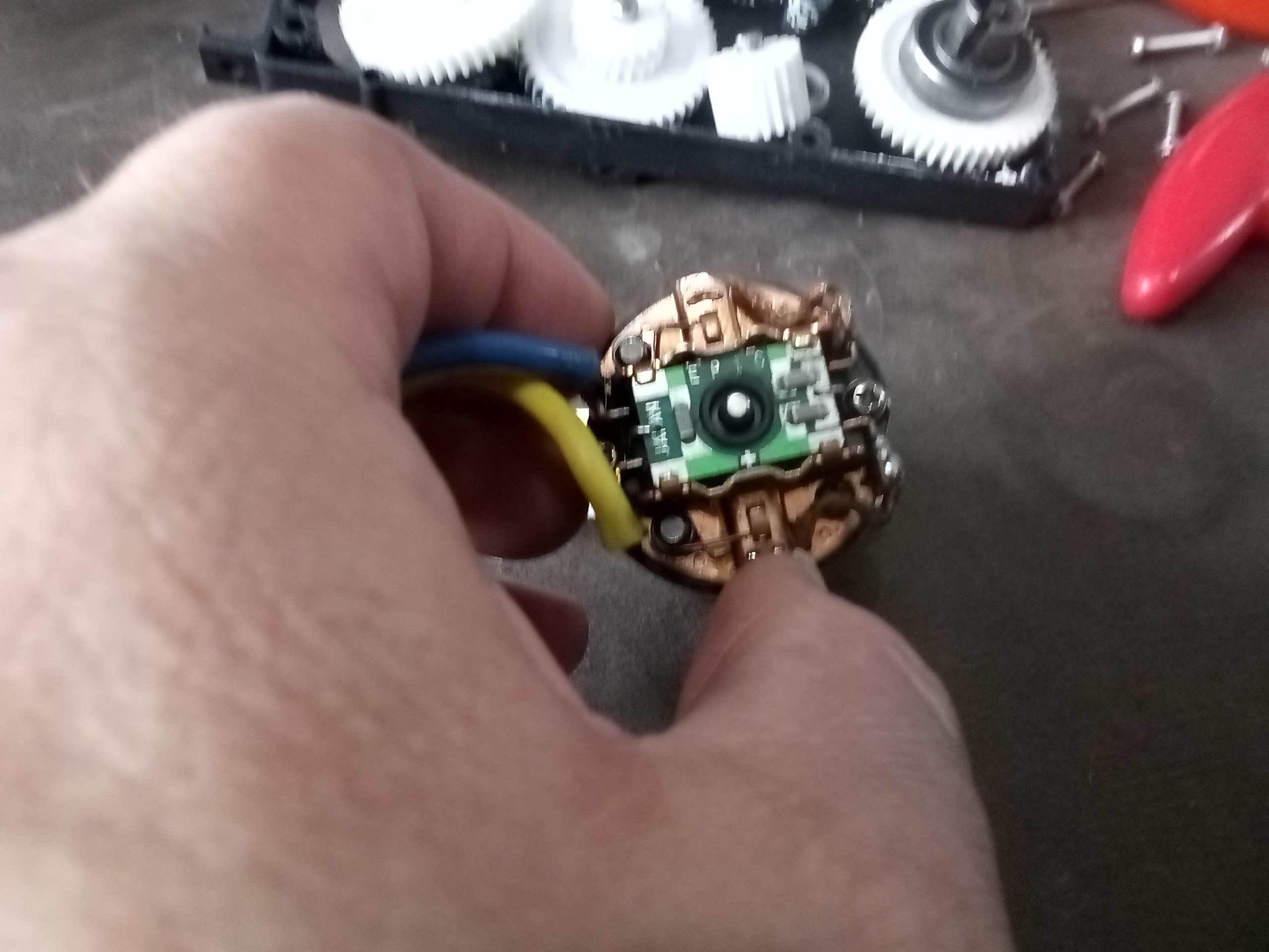

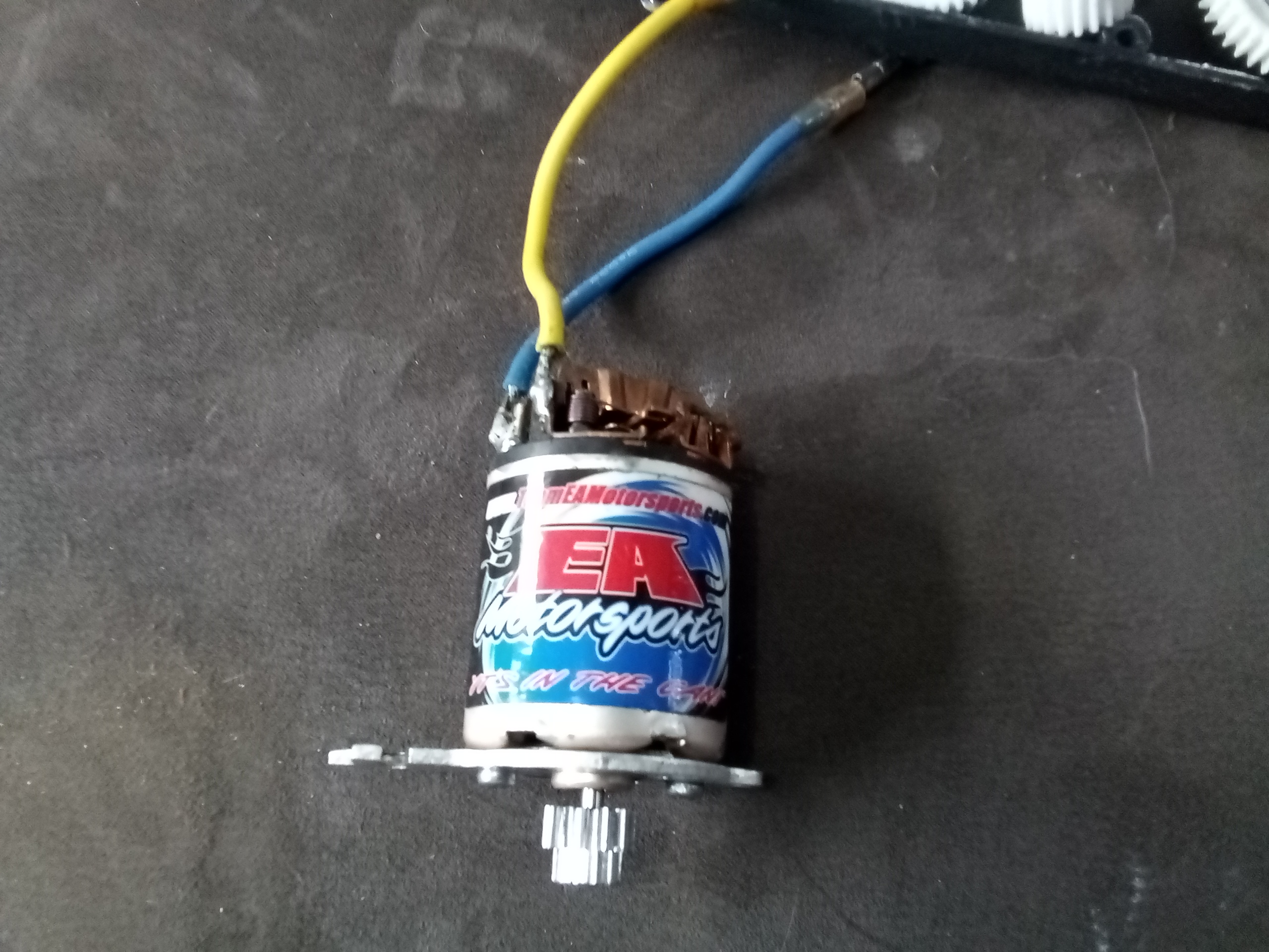

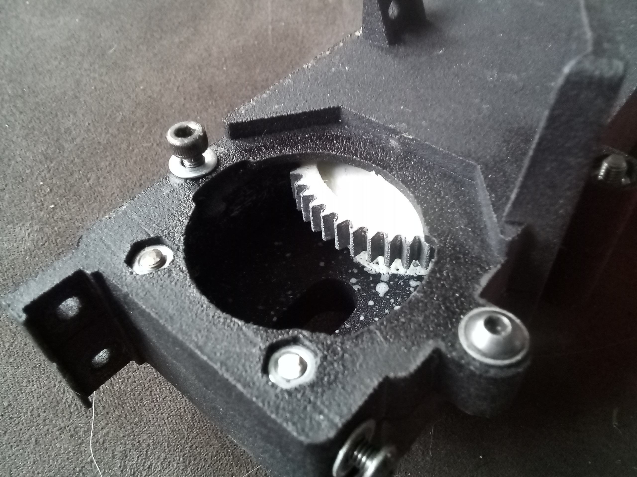

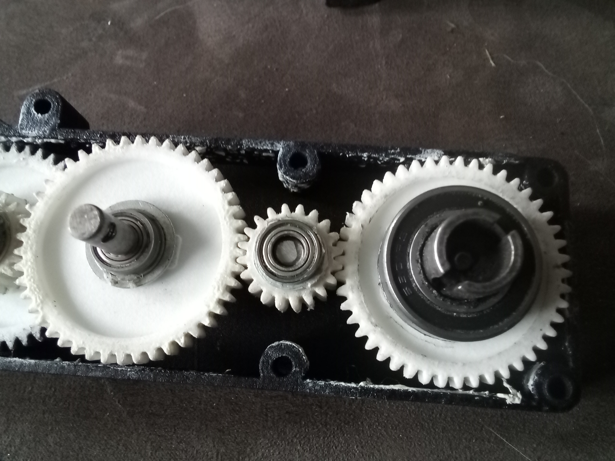

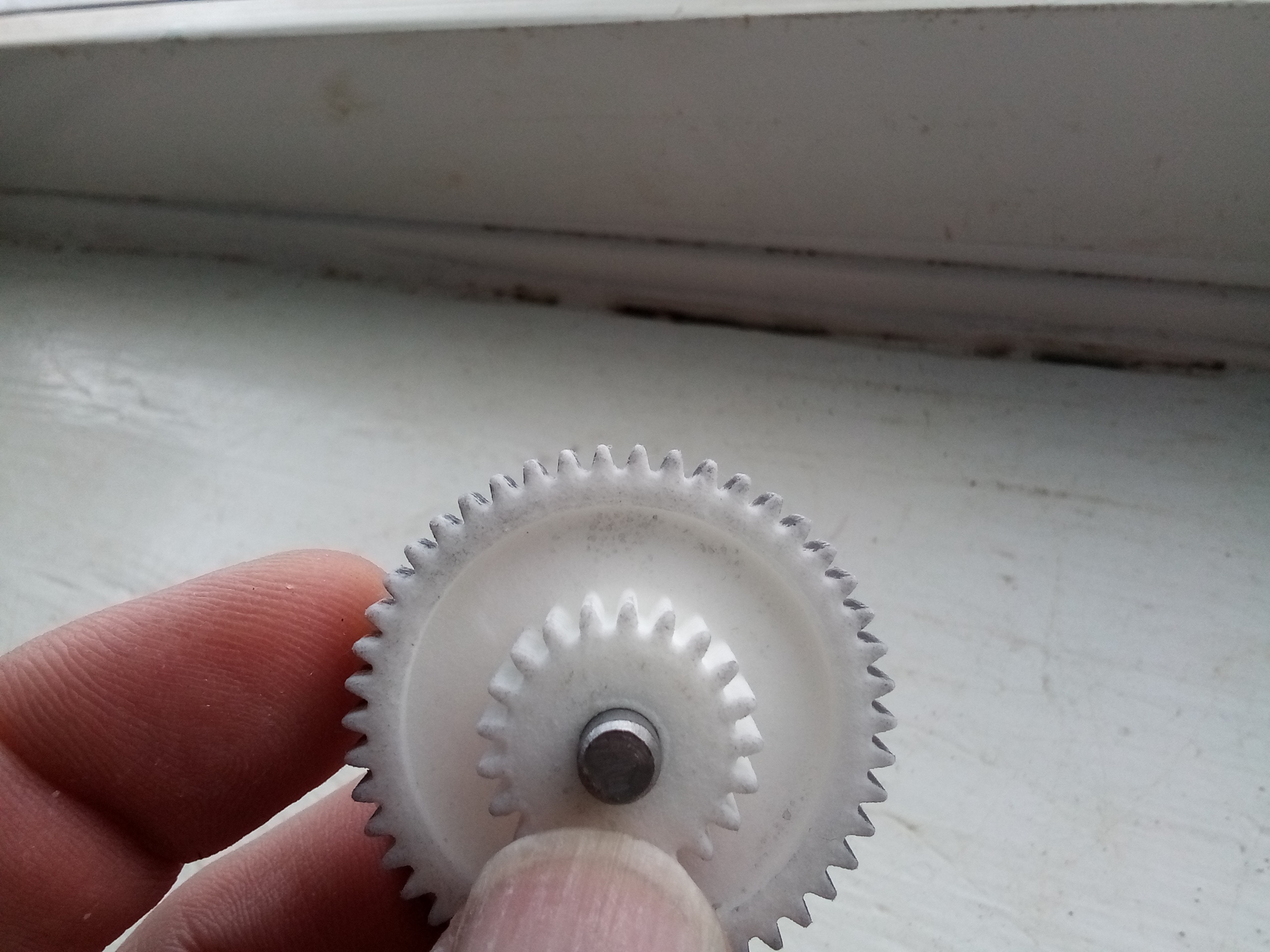

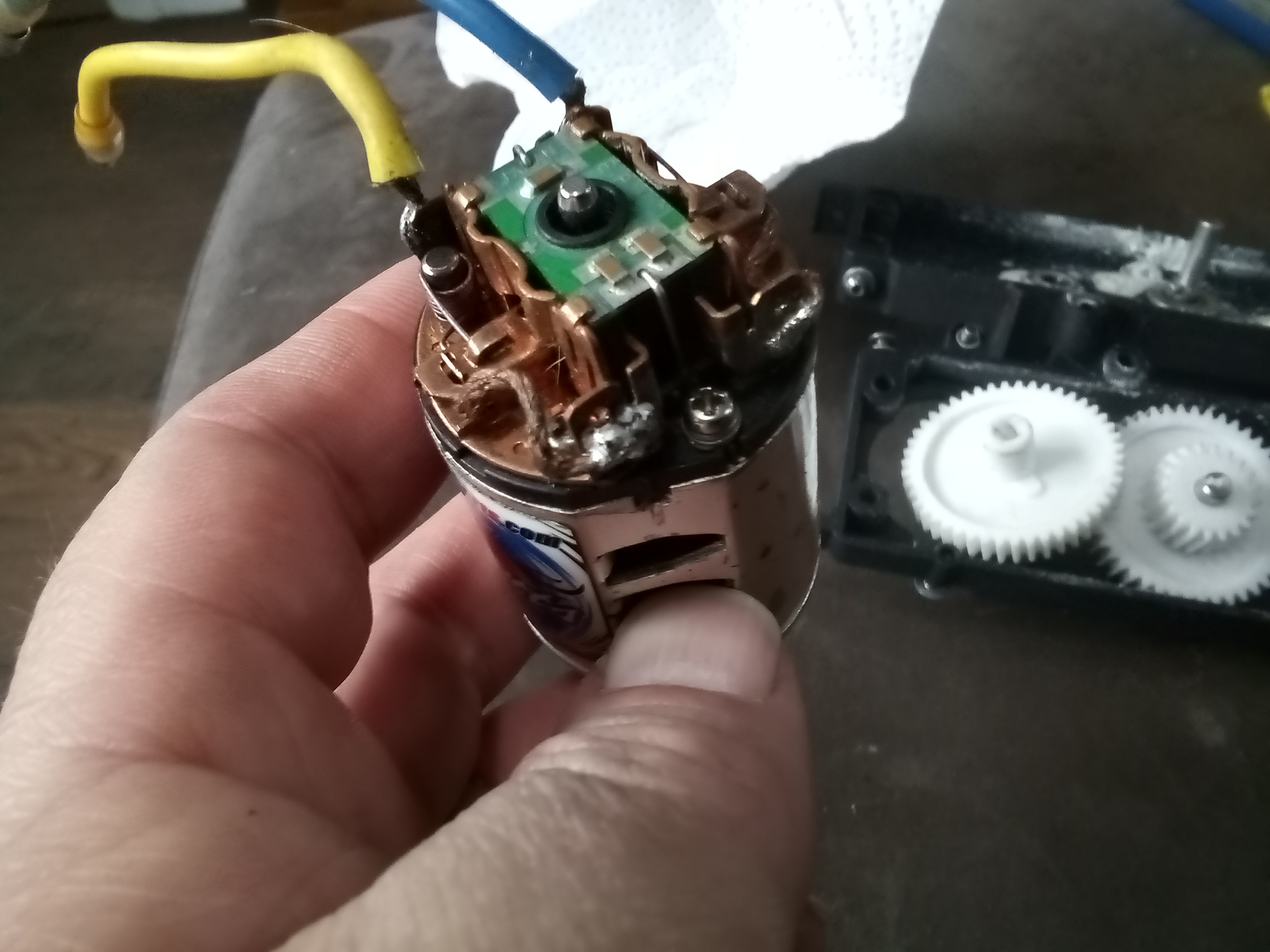

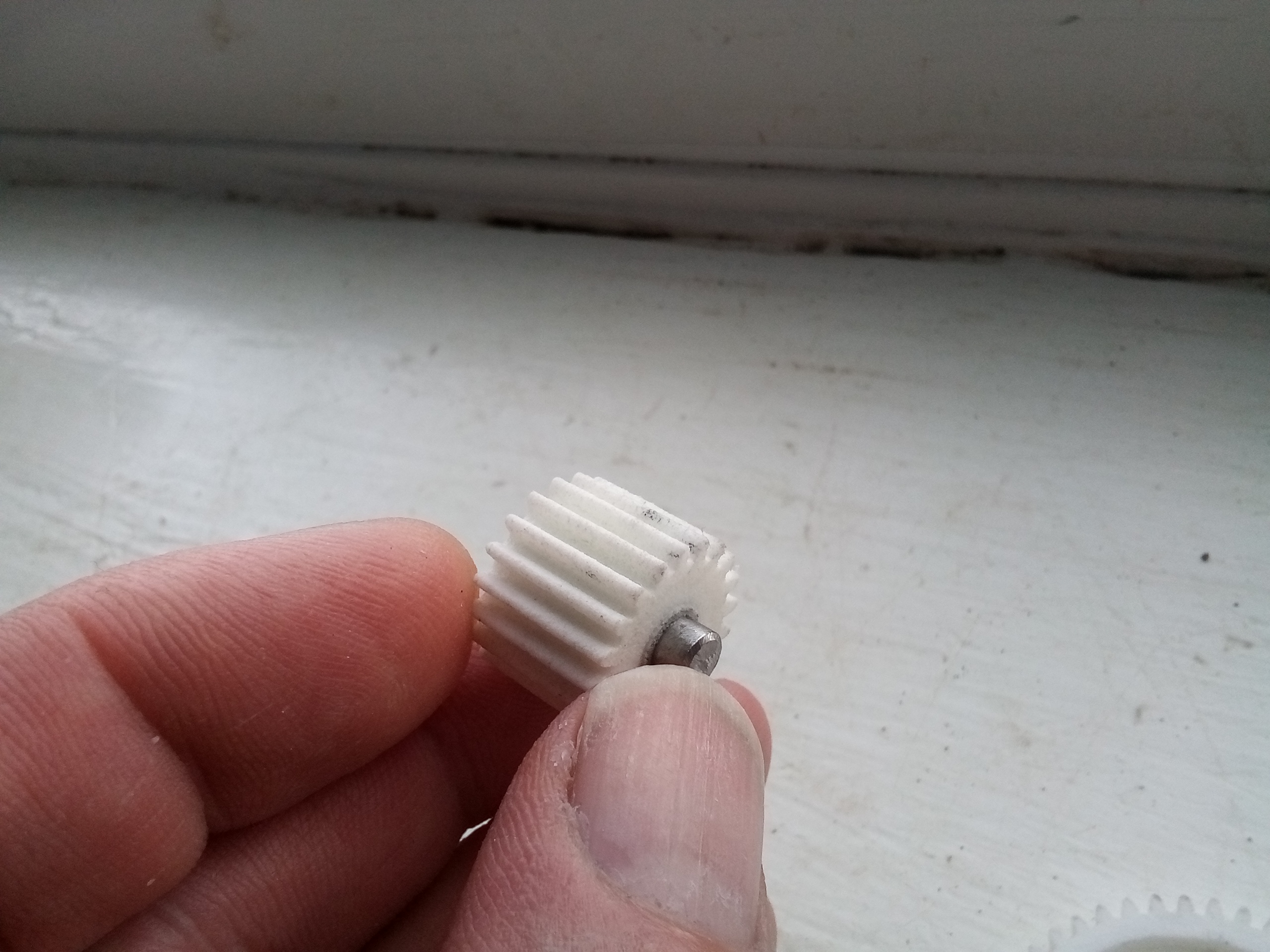

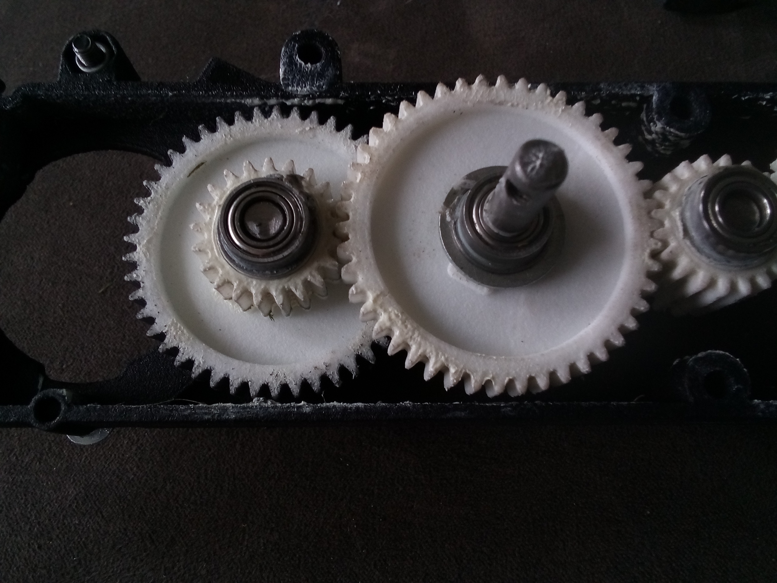

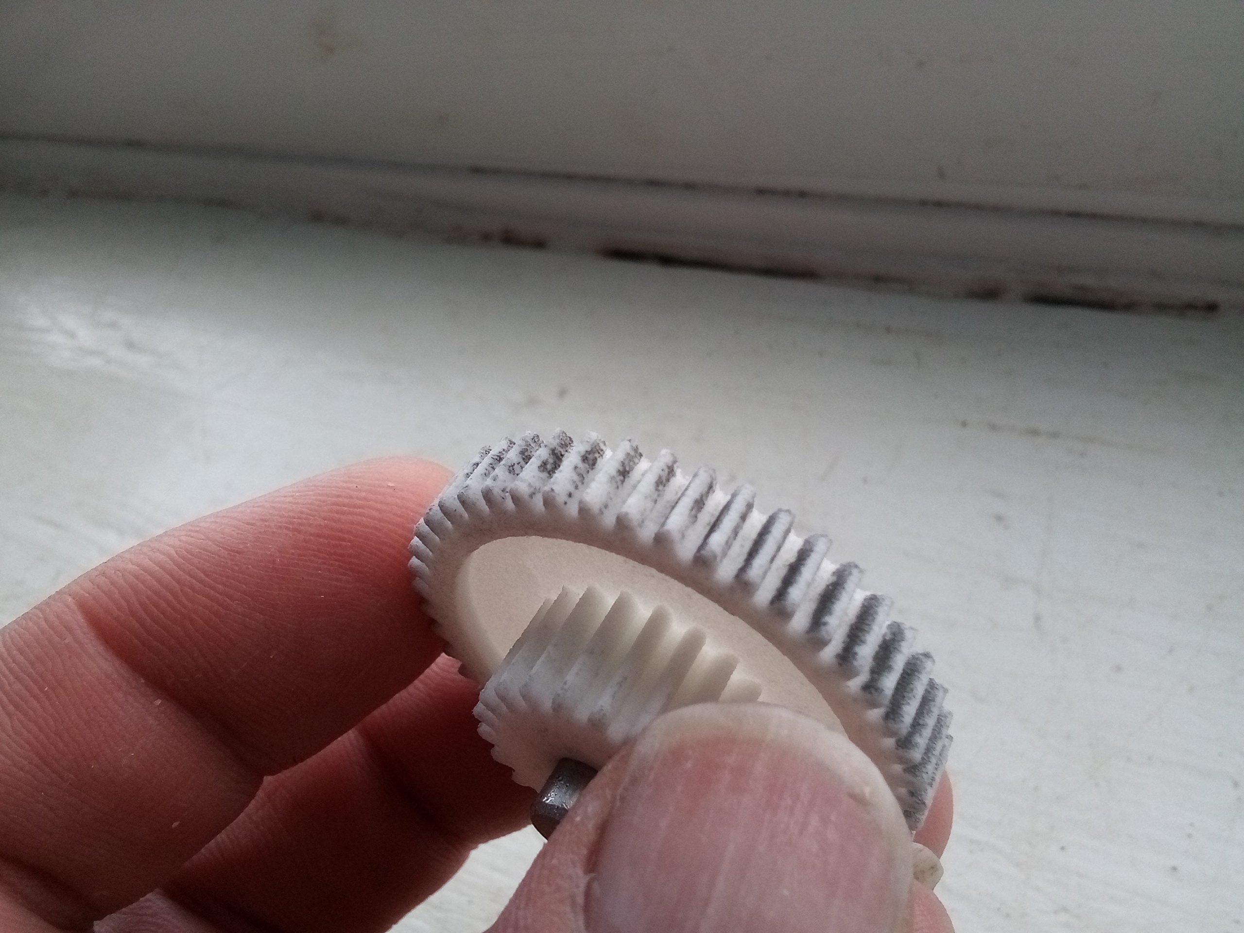

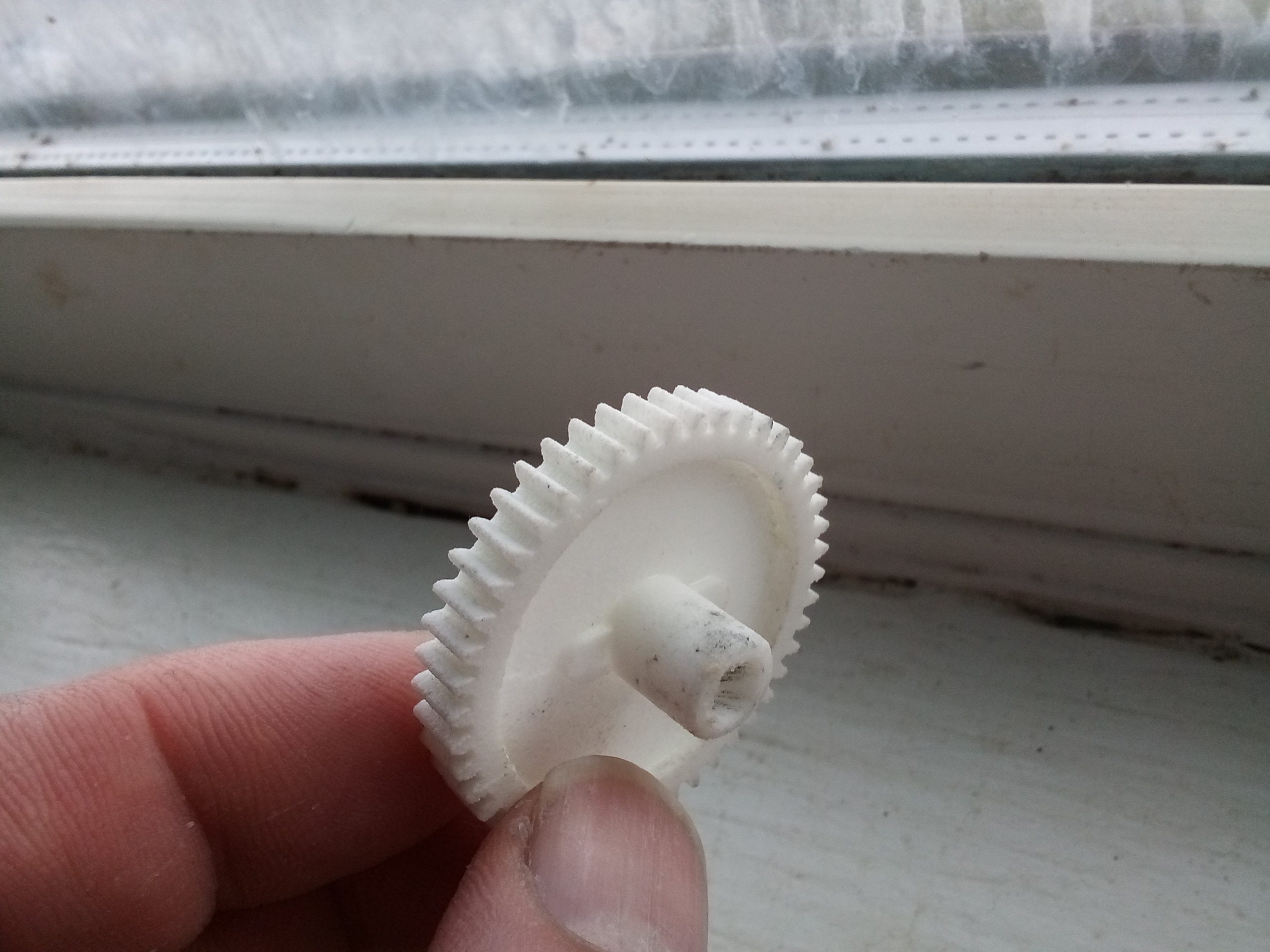

I actually ended up running 4 4000mah 2s lipo's through the gearbox , about an hour and ten minutes , the last half hour with a pretty pokey motor and I've just pulled the box apart .
Below is the motor used in the latter half hour of testing .
After cleaning you can see no significant wear , the spur gear is kind of stained by the aluminium pinion and these prints do have a textured finish not polished smooth so the slightly mottled staining is not wear , in fact it's not even worn the texture flat so it's more promising really to see it.

I think phase 2 of testing should be driving the buggy for an hour, so there's load on the gears.

Re: Yo-clone-oh Dogfighter
Its has been driven so far for over an hour , mostly on road but with some short grass as well so it's been fully loaded not just bench tested , no real value to bench testing , my feeling is they are good to go but if the consensus is to go another hour of road testing then I guess I'll just have to suffer through it .
