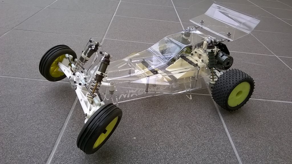

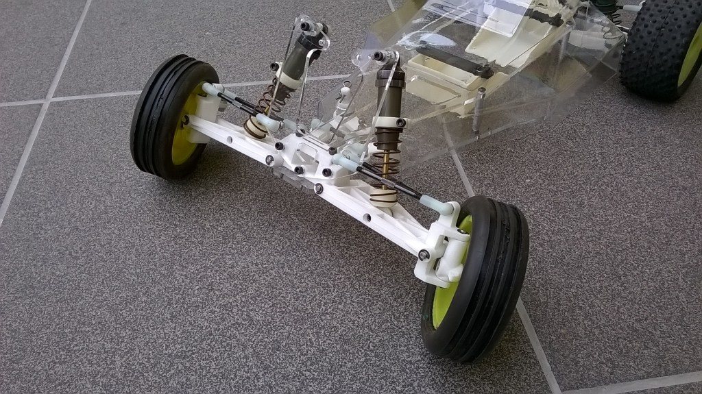

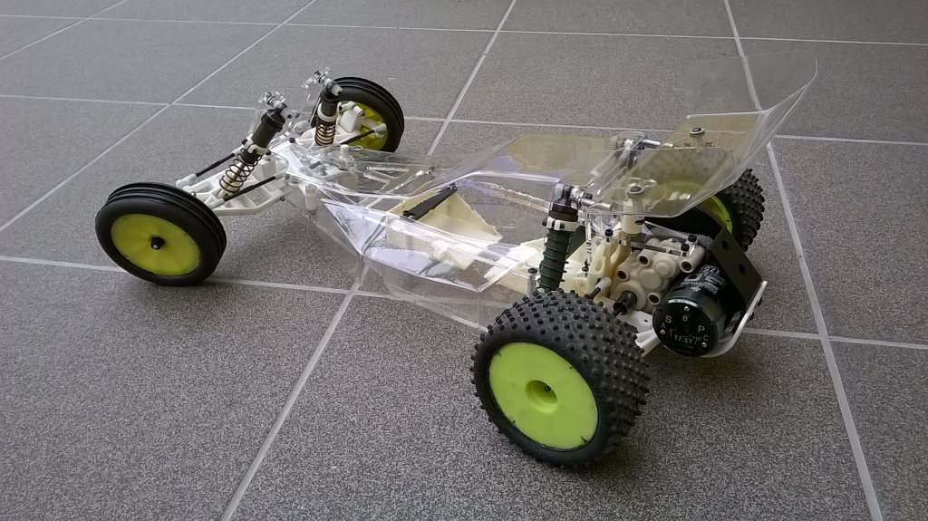

This PA2200 SLS material Shapeways uses flex more than standard molded or extruded nylon. Still it's really strong and viscous. I have seen JQ racing with his prototype cars SLS arms attached. Even with 8-scale nitro buggy! In this project - when the look is critical - SLS arm will flex more than it probably flexed in original Stealth car. Still the car will be driveable... full attack. If more arm stiffness is wanted, wall thickness of arm geometry can be increased. All other SLS parts will be just perfect like that for a runner. Last winter I drove my B2 Graphite project car weekly hours and hours. Not a single problem with SLS front and rear chassis bulkheads. And as you all know - indoor offroad track isn't gentle for cars.
Here you are... clear view mockup car... in day lights this time
-Niki-

Niki....I might have to send you some HG clear shock bodies for the mock up!

Holy freaking attention to detail Niki! You've even got the mold parting lines of the original arms!
