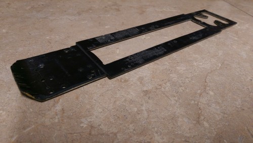

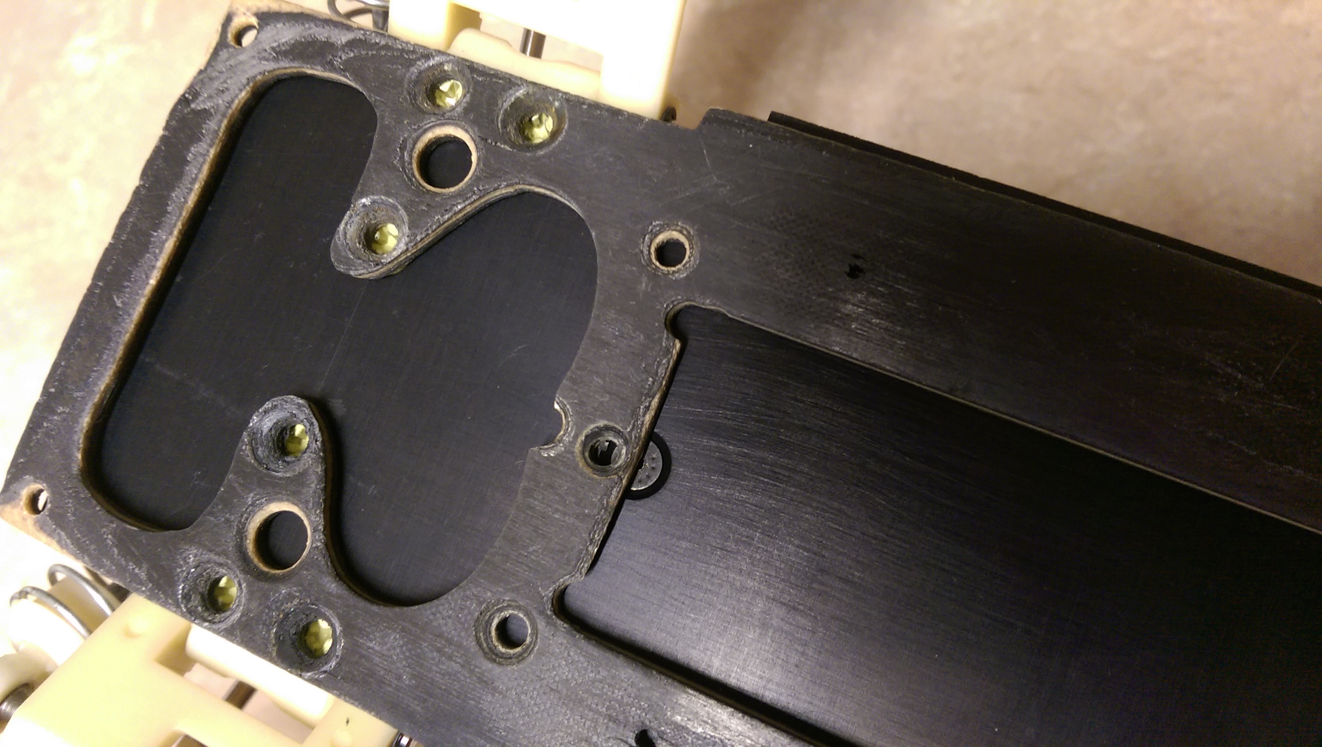

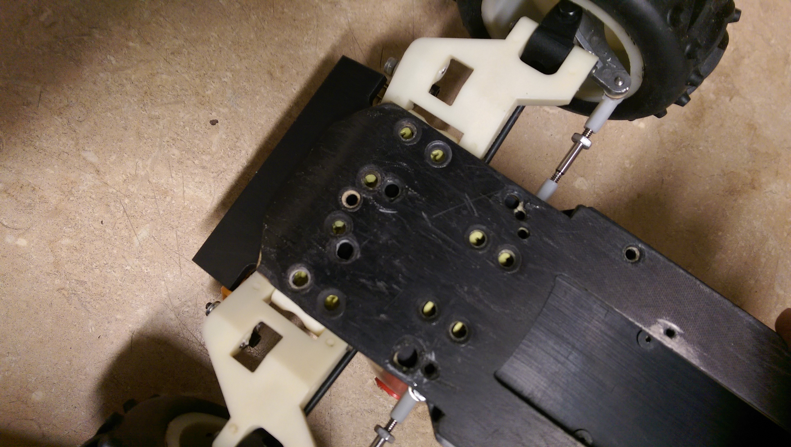

Well Phin, I would say you were pretty close! Could even be running changes as the width is perfect and the individual front and rear sections are perfect- just the overall length between is a tad off. Towers turned out great too, you can kind of see the holes line up perfectly

Are the front bellcrank holes off like the rear one is? Looks like the auction chassis might have had the four brace/battery lift holes cut out since none of the holes that might be them are countersunk.

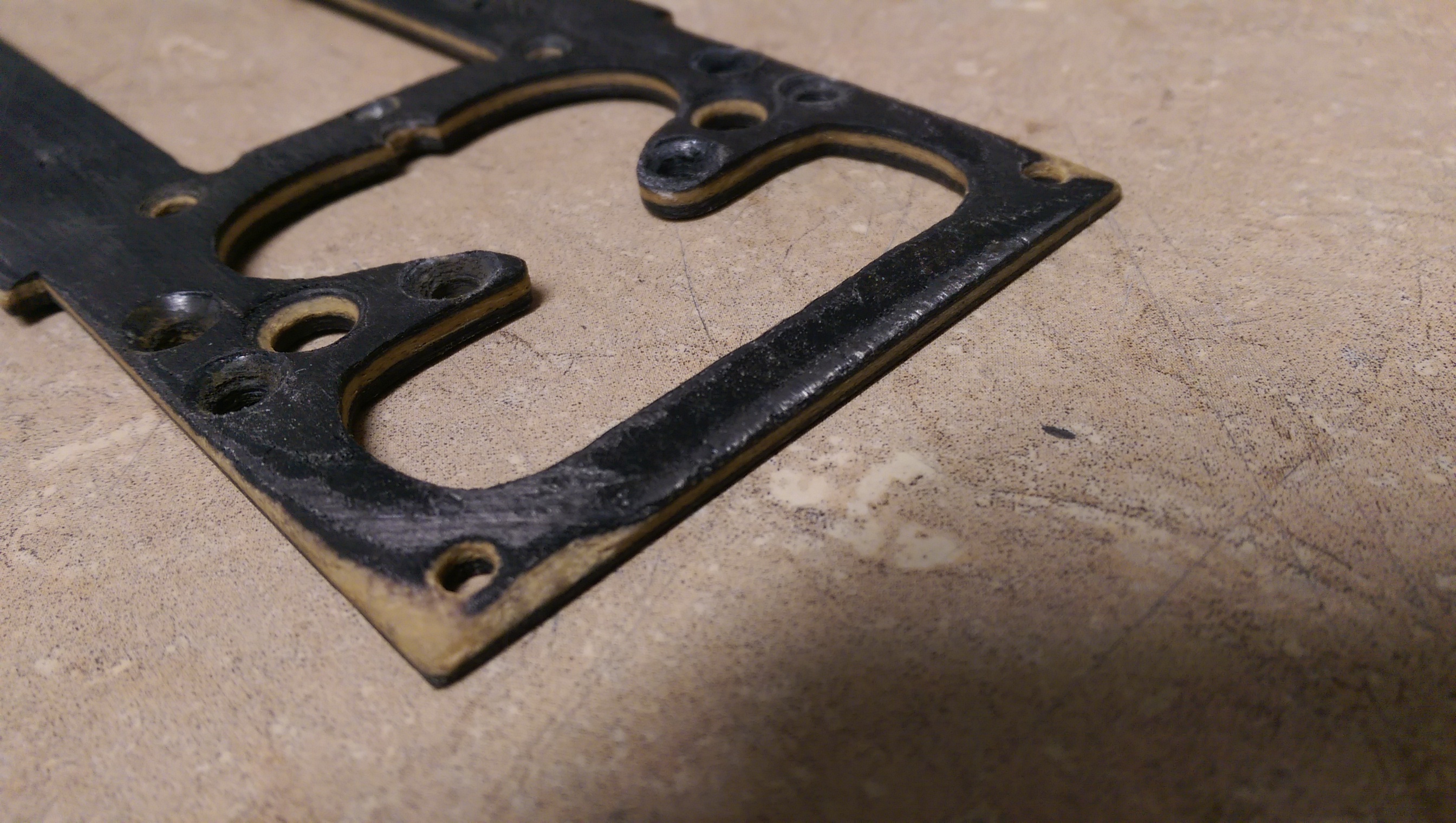

Also what kind of material is the core of that chassis made from? In some pics it looks like fiberglass and in others it almost looks like wood.

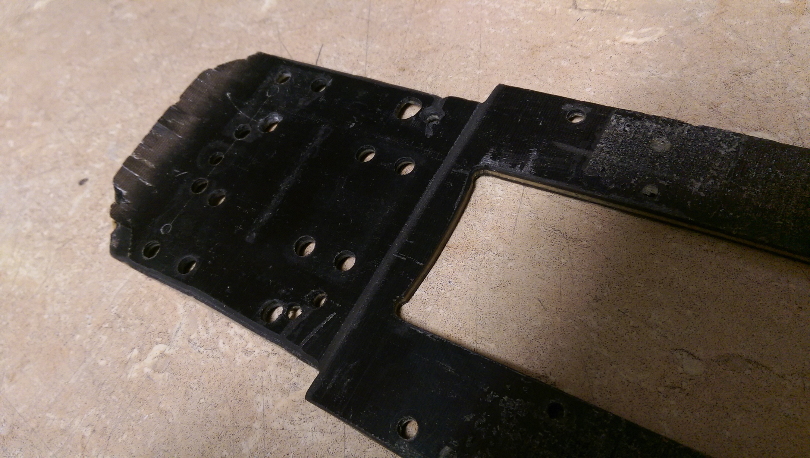

I'll have to take some better pics. The core looks like the losi white core (foam?) But these were laid up garage style from my sources so hard to say. Only one kick up and that is the bumper so it makes the instruction manual chassis incorrect.
Edit....it's wood.
The steering holes are further apart than the manual car. The battery holder holes may not be the ones I show because it's missing one hole on the other side. Strange it lines up tho! And in the correct spot too. I have some more playing around to do, but I'm amazed how close it is!

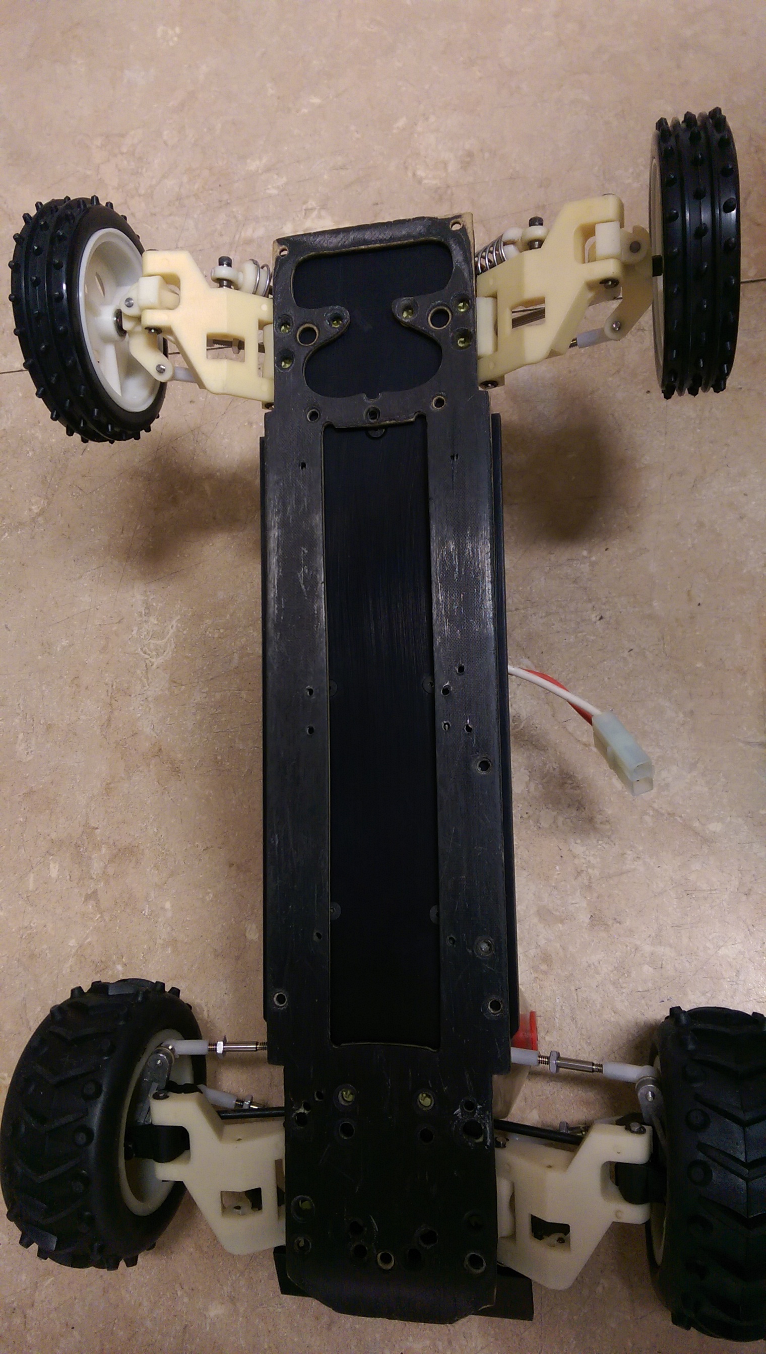

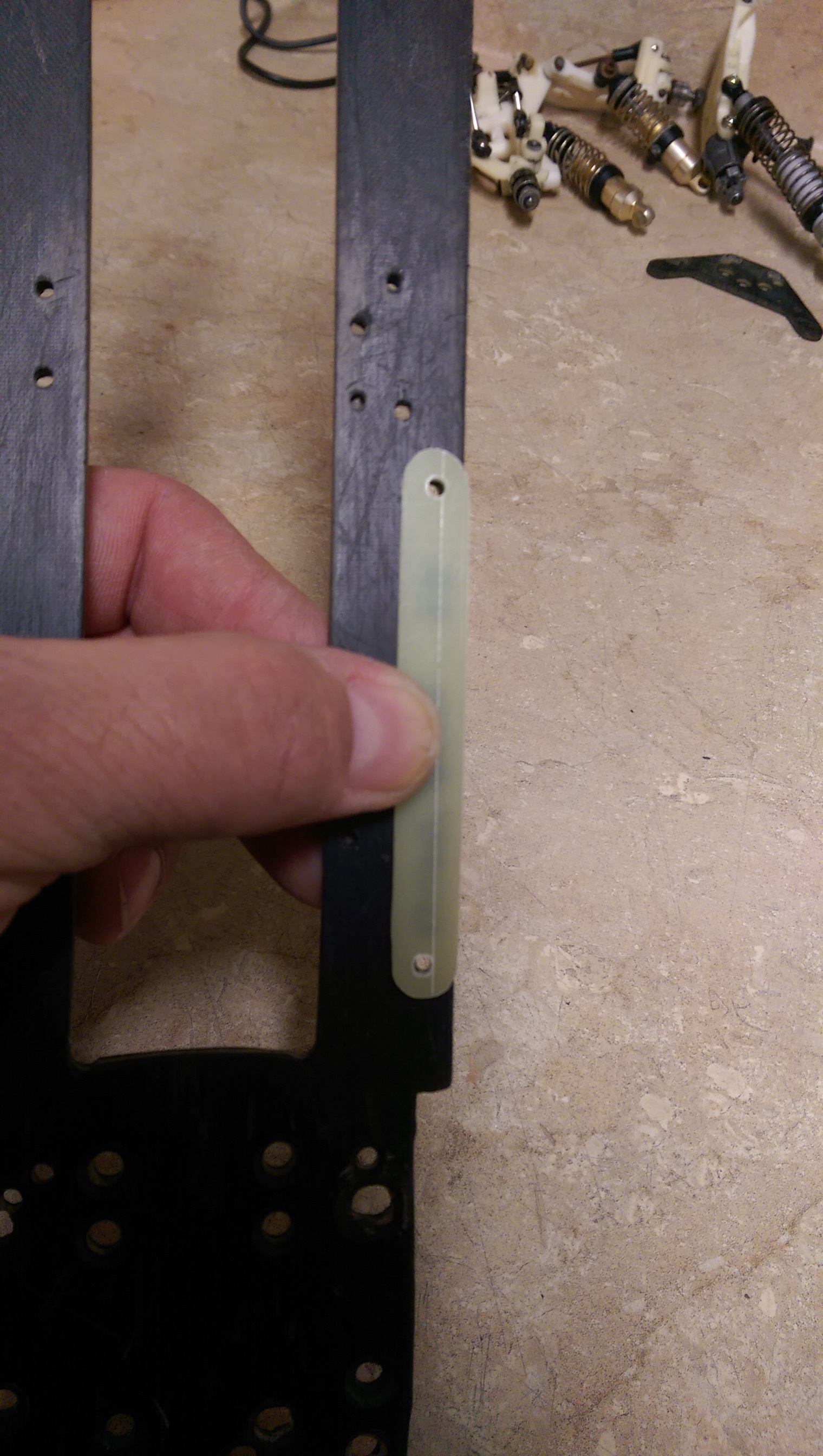

More pics.

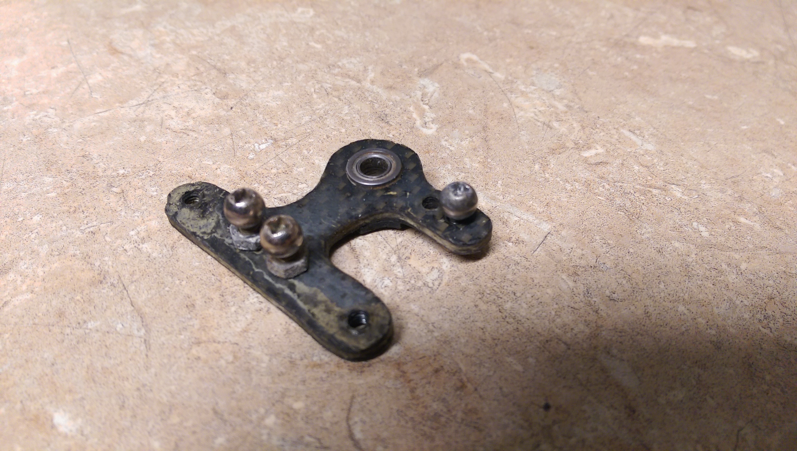

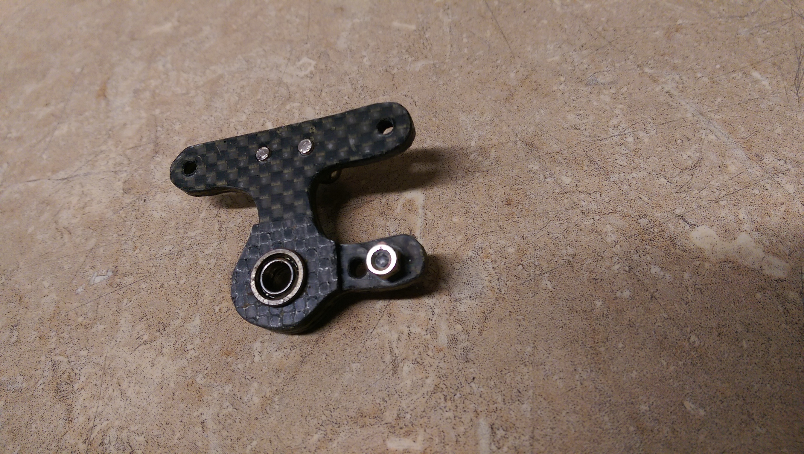

Bellcrank is two pieces glued. Can't tell if it's homemade, it's not super symmetrical but looks like the same wood core material as the chassis

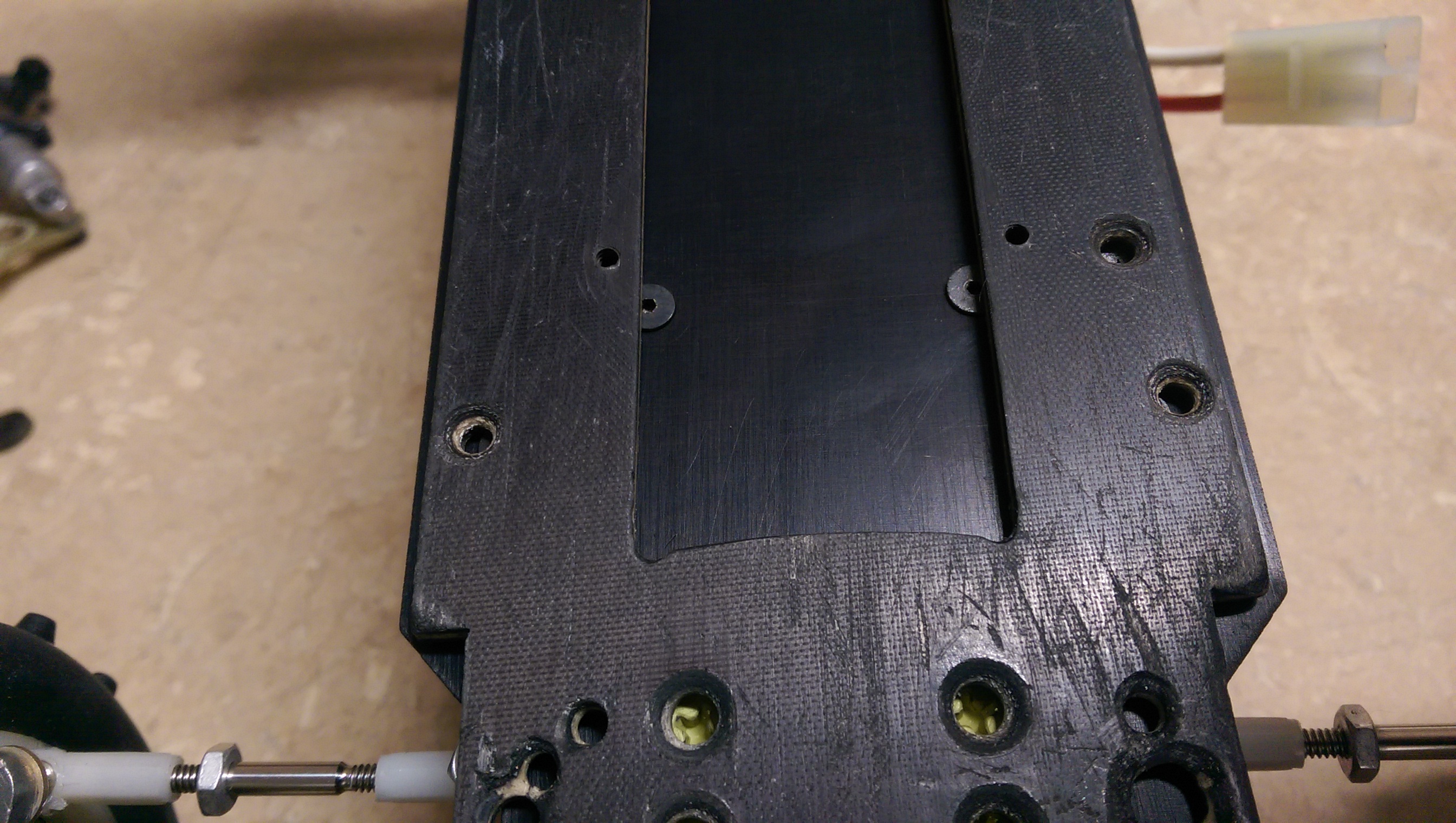

The battery mounts/ chassis braces are in fact cut out as phin mentioned. The servo mount holes are very close, and the bellcrank holes are further apart.
Also the rear bellcrank mount hole is in a different spot, but I can't tell for certain which it is. The hole that is intact is not perfperfectly centered.

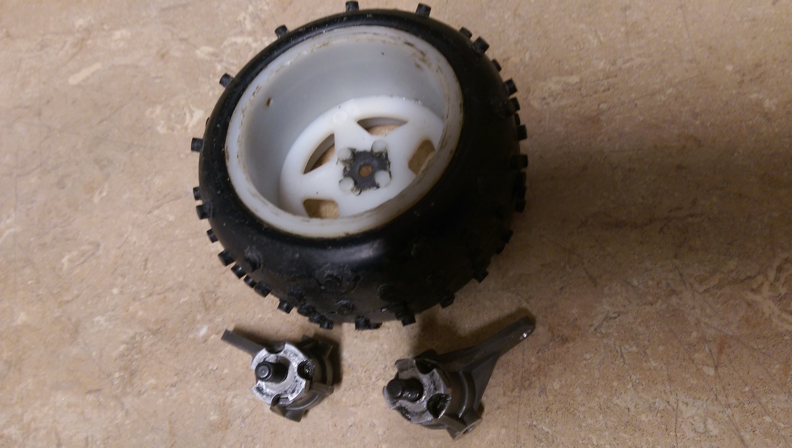

Also found this interesting. The kyosho drive washers are machined to fit late tamiya wheels

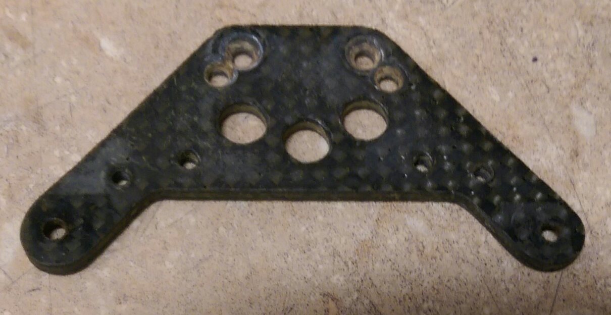

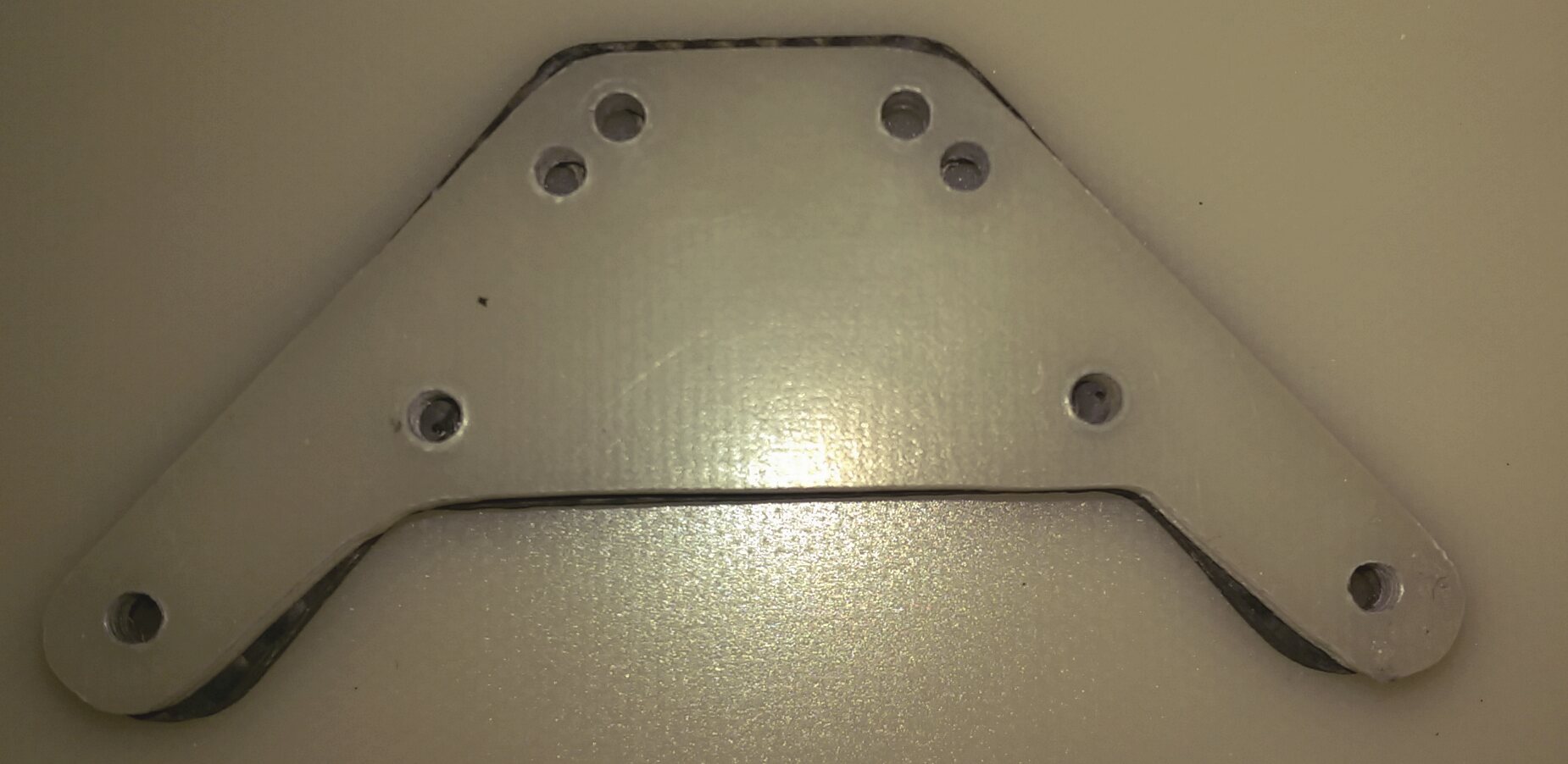

Shock tower holes are not centered. Likely not stock
Chassis is well used.

Hah, I had the same idea for using bearings in the bellcranks...funny that it may have actually been a thing. :D
Phin wrote:It would stray from the original design, but you could glue a small piece of 1/8" thick fiberglass underneath the bellcranks, just at the pivot point, in order to make each crank thick enough to hold a couple of 1/8"x5/16" flanged bearings, top and bottom, instead of standoffs.
You'd need a small shim between the bearing and the chassis to keep the outside edge of the bearing off the chassis.
Also pretty funny that, being made from wood core graphite, A-Main might have sourced the material from DA like we tried doing.

Is that core MDF or some kind of ply? the carbon looks like uni.
Posts: 12336
Been thanked: 3919 times
Re: A-Main Bullet Fwd 4ws RC10 conversion Tribute build
It looks like a ply

Can get balsa and birch core from Dragonplate in twill weave but they never replied to me when I asked if they'll do a kick-up.
