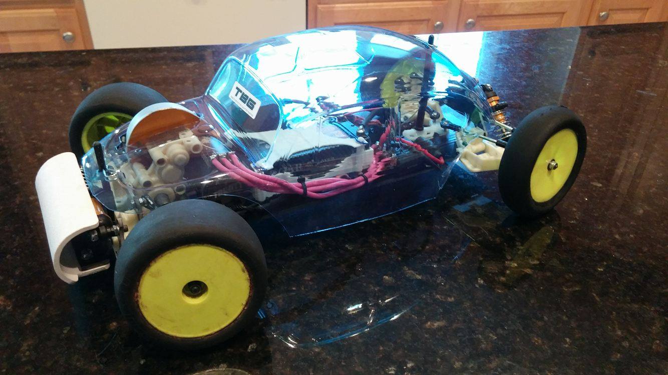

John had me send him the pieces to build a bullet with a flat chassis and caster shims since we don't have kickup material (yet? :mrgreen: ) and just finished it up. He went with a stealth trans and brushless power. He sent a video and I just chopped it down a bit, it's definitely front heavy as it should be, and he says the steering is better than expected. It is also hard as heck to control lol. I'll update as he send more pics or videos. First Bullet I've ever seen run 8)

Thanks for posting Jeff. I approached this build trying to buy easily available parts. That being said, you will probably be better off buying a decent Optima roller with the Kyosho parts you need. I scoured ebay a good while for what I needed but some parts are just plain expensive. Now that the rere is hitting the streets, that may be changing as I haven't checked since I procured all the parts.
I think some of the handling issues I have may be caused by using the Dubro 4-40 eyelets. The turnbuckles all have more extreme angles than we normally see with the market ready buggies and I think this is causing the Dubro eyelets to bind. I was having a hard time getting the endlinks to operate smoothly and tried getting some of the angles smoothed out.
That being said, Jeff and I both experienced some weird bump steer issues in the rear steering. I have been trying to minimize it, but it still exists. I was glad to see the survivor car that Jeff has exhibits the same so I can rule out the dubro endlinks binding.
As for the jumping, it is definitely weird and takes some getting used to it. I want to get the body painted and mounted and get on an actual track and not plastic skateboard ramps to see how it handles. It is fun to whip around, I will say that.
Hopefully I can find some decent priced rere Optima ball links and try them. I think with a little finessing this could be a fun vehicle to drive. I am also going to design a 3d printed battery tray as I don't like my lipo ziptied to the "battery tray". I don't want to chance it sliding out and causing issues.

Quick update to the project. I designed a shorty lipo cup. It's going to be tight on the vehicle but I was trying to keep it centered. Also had to include Mr. Graphite somewhere! :lol: Job is already processing at Shapeways, so we'll see how it fits when it gets here.

Now that little league and my vacation is over, I had time to work on the Bullet. I made a delrin bumper, the 3d printed battery tray arrived and got the body mounted. Just need to work on getting the wing wire bent correctly. The stock camber setting are way extreme :lol:
Almost time to race it!!!
