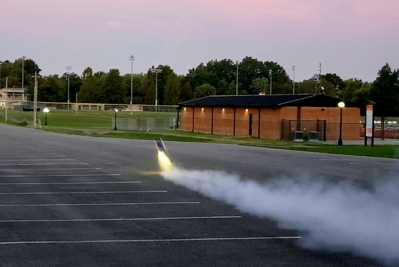

This morning. Spoiler alert: it doesn't fly very well... :lol:
Dangeruss
Posts: 1474
Location: Surf City USA
Has thanked: 425 times
Been thanked: 1408 times
Re: Old School Rocket Car Build
Post by Dangeruss »
I put together a compilation of all the runs so far into one video!
In all seriousness, rough run. Would moving the rockets forward change the center of pressure and reduce the cars tendency to become airborn?

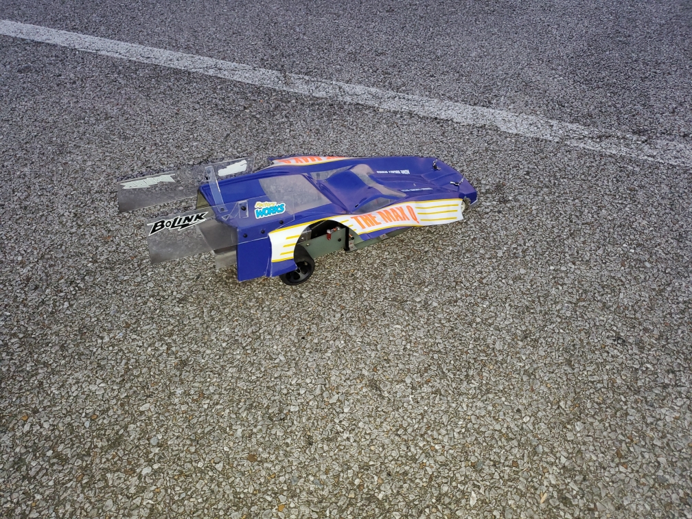

Here's a pic of after it landed...
An internal investigation🔎 was launched after the crash....and the reason was discovered:
The left/right and up/down stabilizer rods both broke half way thru the run....this is what centers and and angles the engine and keeps it stable...after they broke the engine flopped all over the place, up down left and right causing the catastrophe....this engine had so much power it just couldn't hold up....video doesn't do it justice...when i hit that igniter it sounded like a bomb went off....the thrust curve on that engine is max at intital then tapers off...if u watch the video slowly it was on a real nice pass....until it broke....I will rebuild the car, make some improvements and do it again!!

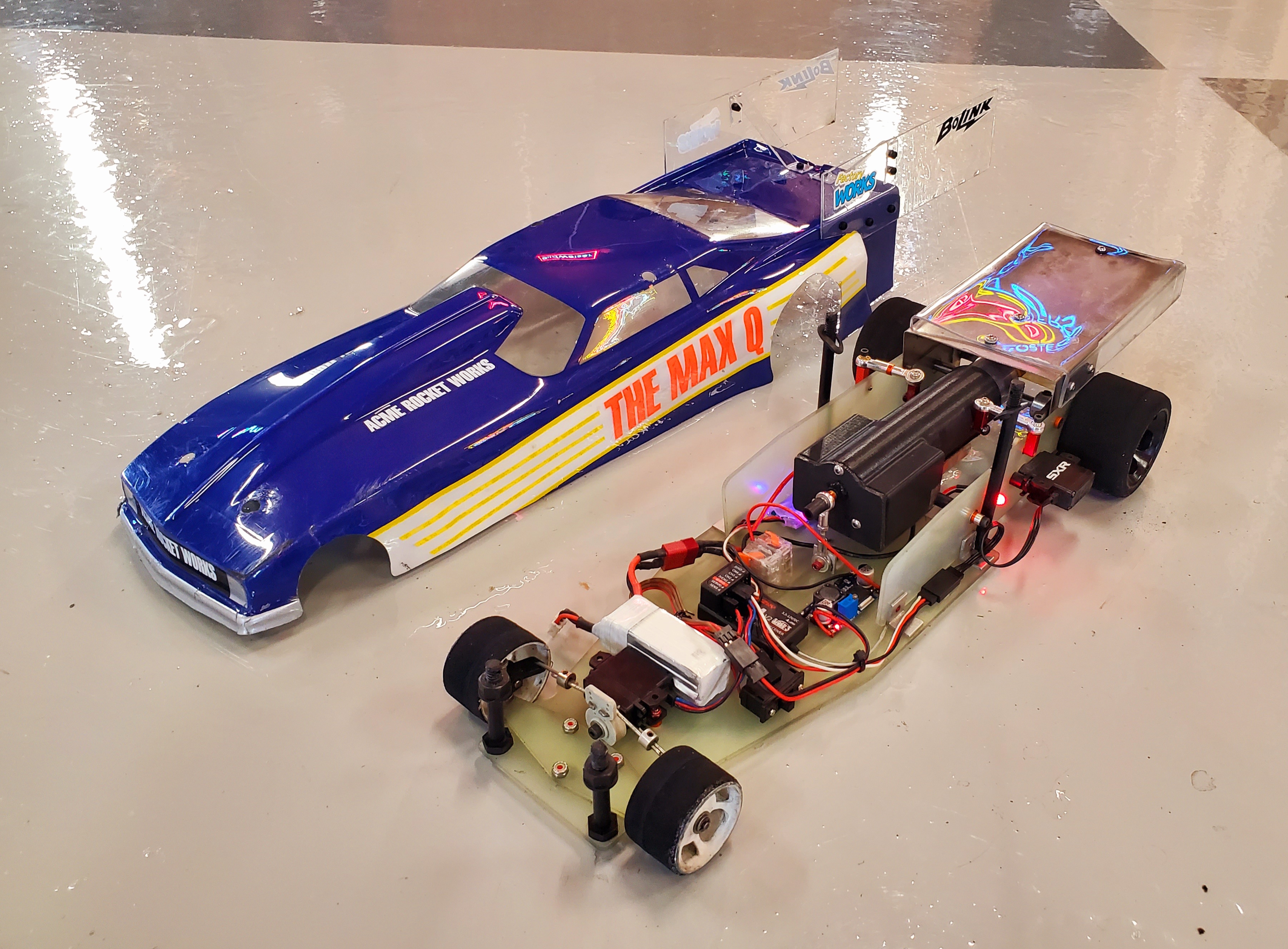

It is Alive!
earlier when it all went wrong
Currently...after repairs and modifications
