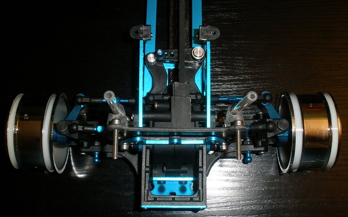

Bah...this project hit another road-block. I thought I had spares for both upper & lower chain guides, but it turns out I have 2 lowers and no upper! After waiting 2 weeks for and finally receiving new chain guide covers, I find out I'm missing the upper chain guide!
On the positive side, I got the steering assembly and lower chain guide & cover installed. I sealed off the lower chain guide cover with Goop, as well as all the area surrounding that little external Lexan piece that's used to mount the tiny belt roller gear for the belt conversion. I had to cut down the upper 4.8mm balls to make room for the higher-profile 4.8mm ball cups, as they require more room going side-to-side than the stock 5.8mm ball-ends. It's finally steering smoothly without binding, but it sure is close! The cups should reduce the possibility of the tie-rod ends from popping off, that was a common problem with the stock 5.8mm balls & ball-ends.

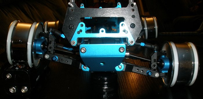

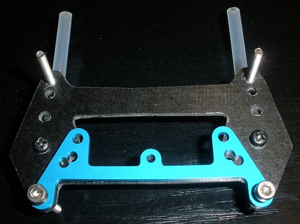

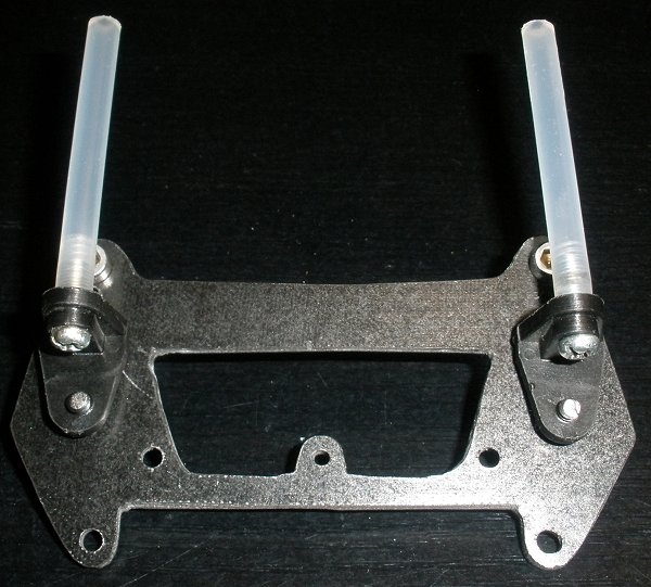

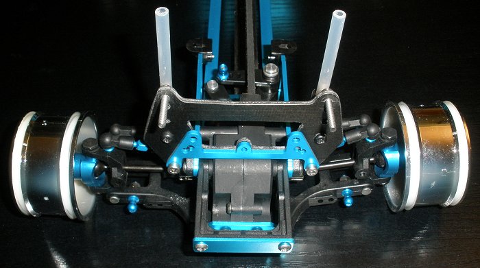

Some Christmas Eve updates:
-I cleaned up my front CF shock tower, and filed down some of the excess height where the shock bolts go.
-I custom-made mounts for body mount tubes using some spare Optima parts, the little angle pieces that attach the side-plates to the upper deck.
The last pic shows the range of suspension travel, which is pretty impressive even for the shortened control arms, and seems to show very little change in camber throughout the range of motion. I'll be setting up the fronts to have a more horizontal alignment than the pic shows, by using my shock tower's upper holes. The lower holes will work for the full off-road clearance.

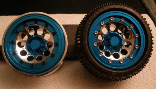

Sneak peek - the perfect offroad wheels for CYANide!
Here's a peek at the wheels I chose for offroading use. About a month ago when I first saw them after spending countless hours on eBay searching for 2.2 wheels, I discovered these 3Racing bead-locks, which are actually narrow wheels for crawlers.
They came in all sorts of colors for the anodized lock rings and 2 styles of inner chrome piece, but do you think I could find a set in light blue? I knew they were made in that color, but I couldn't find a set anywhere! But eventually my diligence with eBay searches paid off and I found this set from a seller in the Philippines.
The moment I saw these wheels, I just knew I had to have 'em. The reason I love them so much is the design is actually reminiscent of the original Turbo Optima wheels, with a 10-hole design instead of 8.
All the questions about measurements paid off and they fit just perfectly 2.2 tires with a width of 35 to 40 mm or so. Though eBay seller dinball didn't have a set in stock, he really helped out by taking measurements of a similar set of wheels he had in stock. As for tires, I had a hard time finding good old-style knobby tires in the modern 2.2 size (that were affordable, anyway) but these Losi IFMAR tires were pretty good, and only $11/pair (including foams).
I didn't like the cheap look of the wheels' included black steel M2x8 cap-head screws so I checked into special-ordering 100 stainless steel ones from RCScrewz (after testing that size from my RCScrewz pack for the Optima to fit perfectly), and it was only $9.95 + shipping...I think the SS screws look much better. What do you guys think?

- walfre
- Posts: 113
- Joined: Tue Feb 02, 2010 4:17 am
- Location: Borlänge, Dalarna, Sweden.
Re: New Optima Build: Project CYANide
Killer wheels!
What was the name of the seller?
Looks really stunning!
i like the rims a lot
but will you let us in on the cost of the rims
Paul
Paul
Thanks for the comments! You can find several examples of these wheels by searching eBay for "narrow ax10" or "narrow crawler". Several sellers have them now, but a month and a half ago, 3Racing itself was out of stock of this exact rim in light blue. Now I'm seeing more of them on eBay again.walfre wrote:Killer wheels!
What was the name of the seller?![]()
The price for all 4 wheels is about $36 shipped. I thought that was a steal for the package which includes all screws, chrome rims & 2 alloy rings & a center-cap per wheel.
the-toyz, toadztoyz and rcplatform and several others have them.
http://cgi.ebay.ca/AX10-CR-01-Crawler-2-2-Red-Narrow-Bead-Loc-Lock-Rim-/400185708708?pt=Radio_Control_Parts_Accessories&hash=item5d2ced50a4
http://cgi.ebay.ca/3-Racing-2-2-Inch-Narrow-Crawler-Rim-Circle-4pcs-Green-/150519674973?pt=Radio_Control_Parts_Accessories&hash=item230babf85d
nice for looks, nut are crawler wheels not kind of heavy for a fast offroader?
- Coelacanth
- Posts: 7421
- Location: Alberta, Canada
- Been thanked: 325 times
Definitely heavier than the stock wheels & tires are, even moreso because they're 2.2's instead of 2.0's (or is it 1.9"?) Even still, remember that these are "narrow" wheels, I'd never seen them before made by any other brand. There are 2 styles by 3Racing and that's it. All other crawler wheels are fat wheels meant for meaty-muffin tires. Just for the heck of it, I'll compare the weights tonight. At any rate, I won't be racing this car competitively. I have my offroad zebra-painted Optima for that, if I should ever go beyond bashing, and that car is almost too fast for me to handle, anyway.Mr. ED wrote:nice for looks, nut are crawler wheels not kind of heavy for a fast offroader?

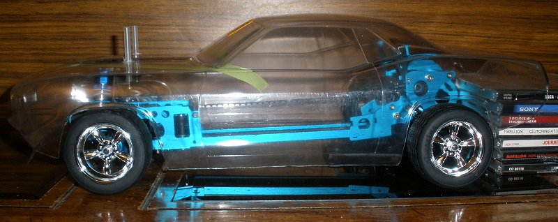

'70 'Cuda body test-fit
Back to on-road stuff...
I began fitting the '70 AAR 'Cuda body on the front body mounts. The rear tires stick out about 1 cm each, which isn't too bad, and actually looks like how many people ran their muscle-cars back in the 70's & 80's. The fronts are almost flush with the front wheel-wells, but I think I'll be able to suck them in at least a couple millimeters each after all is said and done. I had to extend the fronts of the front 'wells by about 2 or 3 mm to make things look right in the rear 'wells, but was able to keep the general shape and it's not even noticeable.
I'll hold off drilling the rear body mounts and final body alignment until I've finished the rest of the chassis (adding chain guide, servo mount, upper deck) and adjusted the belt tension, but things are starting to look really nice!
