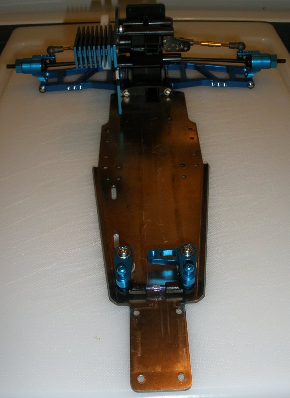

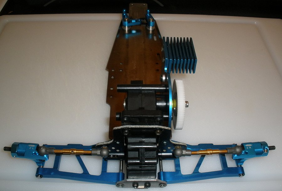

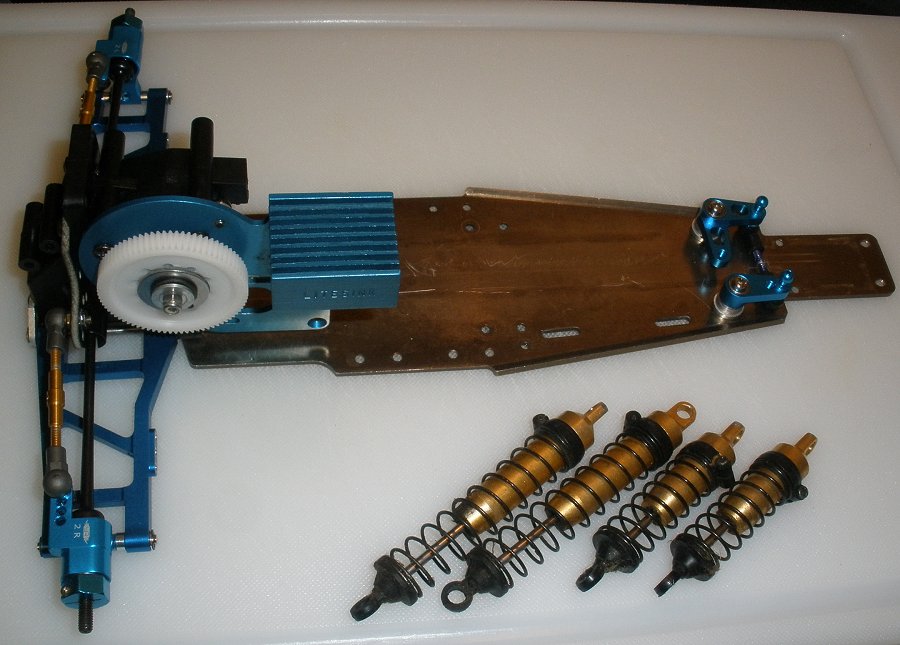

Here are some early pics of a new project I'm working on. I don't have a RWD RC car yet, and tons of spare parts for the 4WD Optima...so what to do? Well, I bought a couple parts cars and spare parts from flipwils11 that included 2 mostly complete Optimas and what turned out to be a nearly complete Turbo Optima Mid SE which was mostly in parts. It wasn't until many months later when picking through all the parts and parts bags that I discovered I had almost all the parts needed to build the Mid SE. However, I didn't want another 4WD, I wanted to build something different (as usual).
The idea of a mid-motored RWD car intrigued me, so I thought about how to do this. I spent 3 or 4 months just figuring out what I had that could contribute to the build, and a lot of research on how to make it solid as a rock. I'm fond of aluminum (of course) so alloy parts would be an important characteristic. I don't have the spare dough to de- and re-anodize everything in funky custom colors, so I'm going with a mostly blue & gold theme.
This build will use parts from GPM, Tamiya, Yeah Racing and Kyosho (of course), and probably more to be determined. So far, it's looking pretty good!

That looks really nice. The blue and gold complement each other nicely. That is also one heck of a heat sink on there. Looks cool so far!

Which rear arms and bellcranks are those?

The rear arms are made by GPM for the Tamiya DF-02. I've used these arms with both my CYANide and Barney custom Optima builds. They work almost perfectly as a swap for the regular Turbo Optima arms but are ~5mm longer, so you'll need 68mm Kyosho Lazer CVDs instead of 62.5mm stock Optima units, all else being the same.HKS_TRD wrote:Which rear arms and bellcranks are those?
Where do you get stuff anodised, I have some Optima Mid chassis posts I want to get done in blue and a pair in gold, and a Lazer ZX motor brace I want to get done in blue but no one here will do small parts
http://www.ebay.ca/itm/ALUMINUM-REAR-LOWER-SUSPENSION-ARM-B-TAMIYA-DF-02-DF02-/400414695336?pt=US_Character_Radio_Control_Toys&hash=item5d3a935fa8
The bellcrank is Tamiya #54235 for the FF-03.
http://www.ebay.ca/itm/Tamiya-54235-RC-FF-03-Aluminum-Racing-Steering-/230825007019?pt=US_Character_Radio_Control_Toys&hash=item35be3e17ab

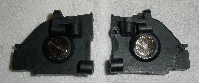

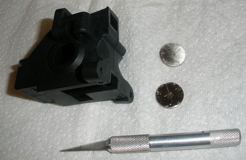

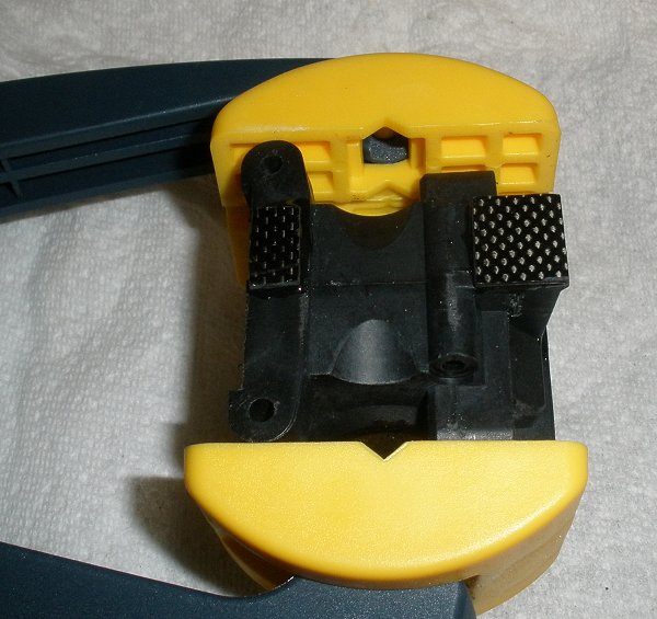

Sealing the front gearbox
You're welcome, j0pp3.
Since I won't be running 4WD with this Mutt, and will be needing the front gearbox to mount the shock towers and other front end stuff, I wanted to seal the unnecessary holes...I just figured I didn't want clumps of dirt to end up trapped inside the gearbox, even though there's no diff in there.
I found some random pieces of chromed steel with a perfect fit for where the diff bearings go, cut it into 2 disks, and ground them down so they were quite thin--to keep weight down. I've seen some people just pour gobs of epoxy inside a diff they wanted to seal, but that would add a lot of unnecessary weight and looks like crap. So, a few dabs of 5-minute epoxy and in went the disks.
I then had to seal off the 2 rectangular holes where the belt feeds into the front diff. One issue I noticed was that the bottom standoffs for where the lower belt cover attaches got in the way of my Tamiya steering bellcrank, so I removed both top & bottom standoffs and shaved them nice and flush with an X-Acto knife. To seal off the holes, I had a sample piece of 1mm carbon fiber that was big enough to cut into 2 pieces...and how cool does that look?
