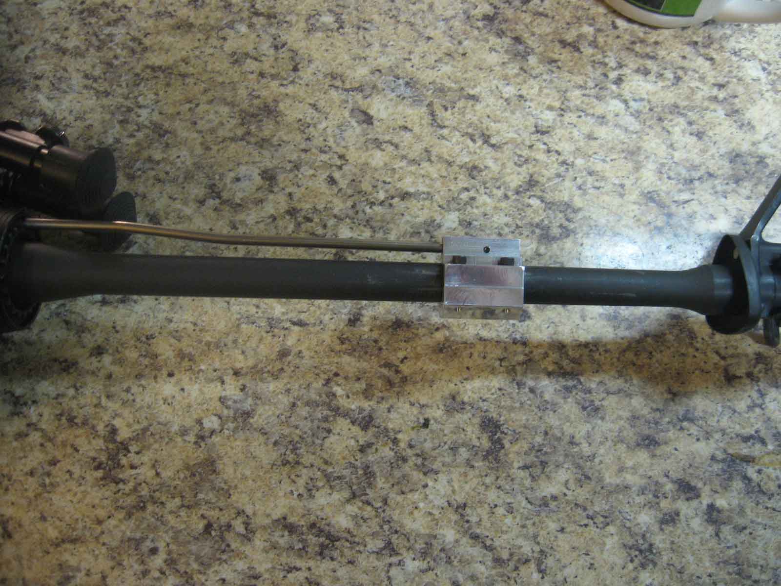

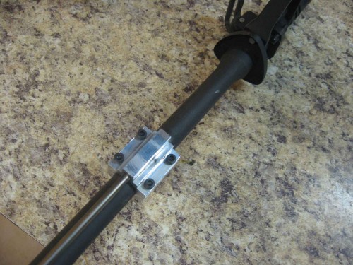

Here is my Zombie security. I took a 20 inch barrel, cut it down, machined a new crown, and threaded the barrel for the compensator.
I machined a new two piece aluminum gas block and moved the entire gas system back 5 inches.
Turned out pretty nice and shoots accurate. Basically recreated a bushmaster disspator whitout purchasing the stuff from them.
I have been toying with the idea of registering the rifle as an SBR and going down to an 11 or 10 inch barrel, but I keep procrastinationg on the paperwork.

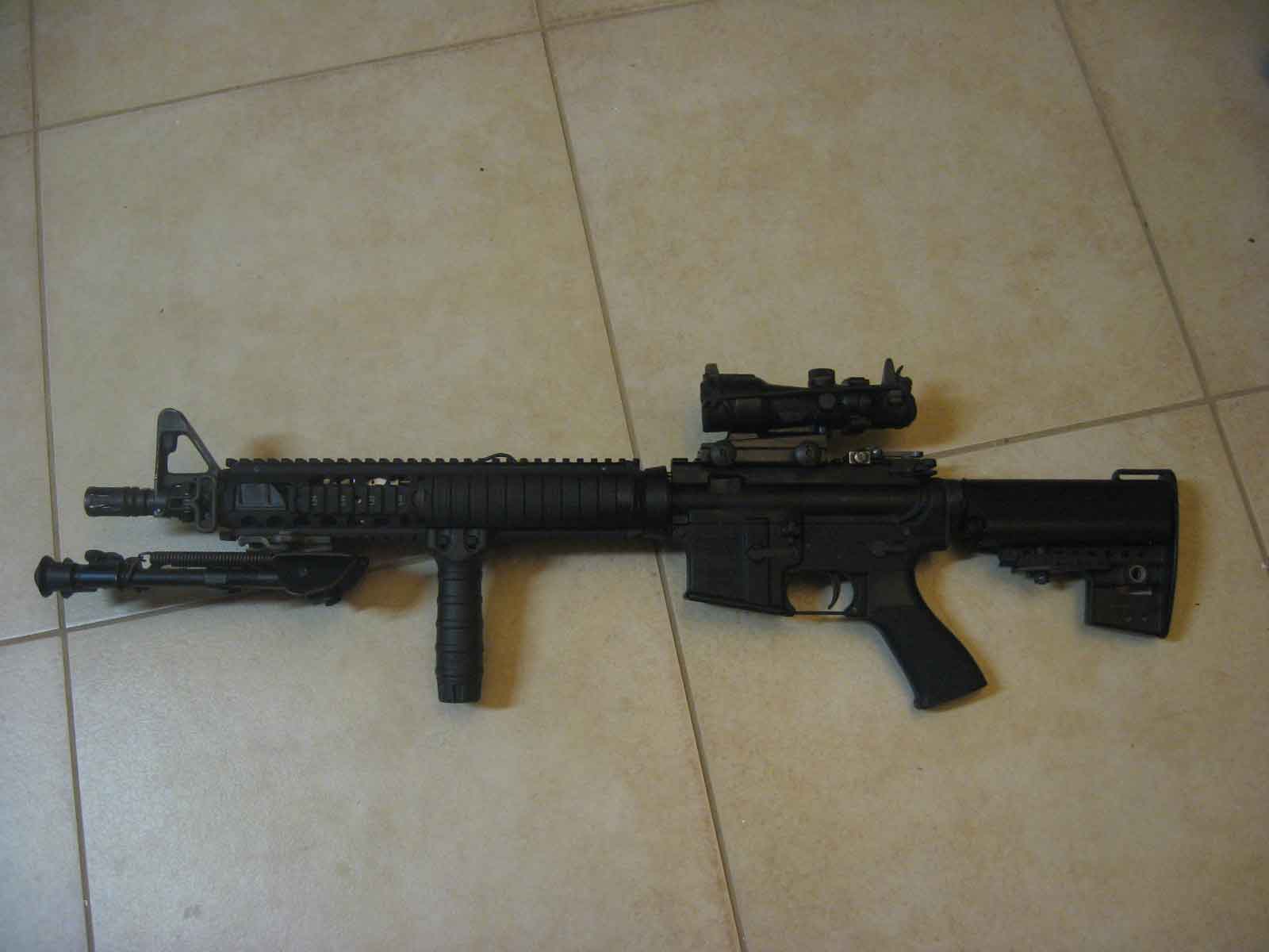

The only time i had to hold M4A1 was when i bought an airsoft... Nice RIS there... And ACOG...
Is the Zombie security same as the Killer? Dont know if such exist, but i do remember reading it in a mag....
