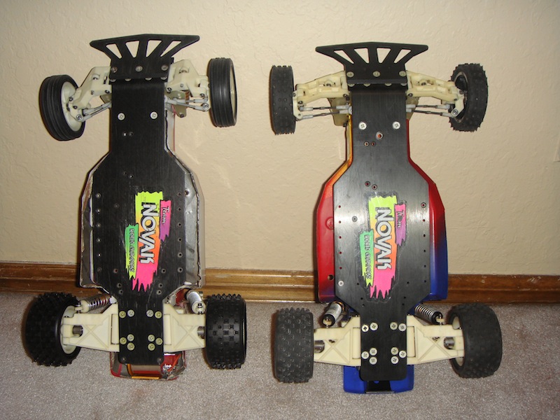

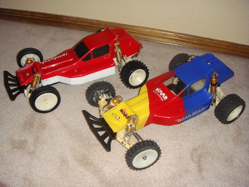

Re: Early TQ10 build (Chassis for now)
Here is a pic of the early and late TQ10's.
The "early" short arm has the countersunk chassis with a gold motor plate.
The "late" long arm has less countersunk chassis with a black motor plate.
your backwards, I promise1990Racer wrote:Here is a pic of the early and late TQ10's.
This is how these were built in 1989. I raced the short arm and my brother raced the long arm, both with bushings.
Take a look at the chassis you have installed on the long arm car, just after the kick-up you can see where the chassis had been partially milled, then removed and re-jigged (nose is cut perpendicular to the chassis plane too) the other chassis is fully CNC routed- also, the offset battery holes were templated by the 86-88 pans, after that they corrected the offset holes and the middle nose hole (at the bellcranks) which served no purpose on the TQ.
20 year old memory sometimes remembers things askew
