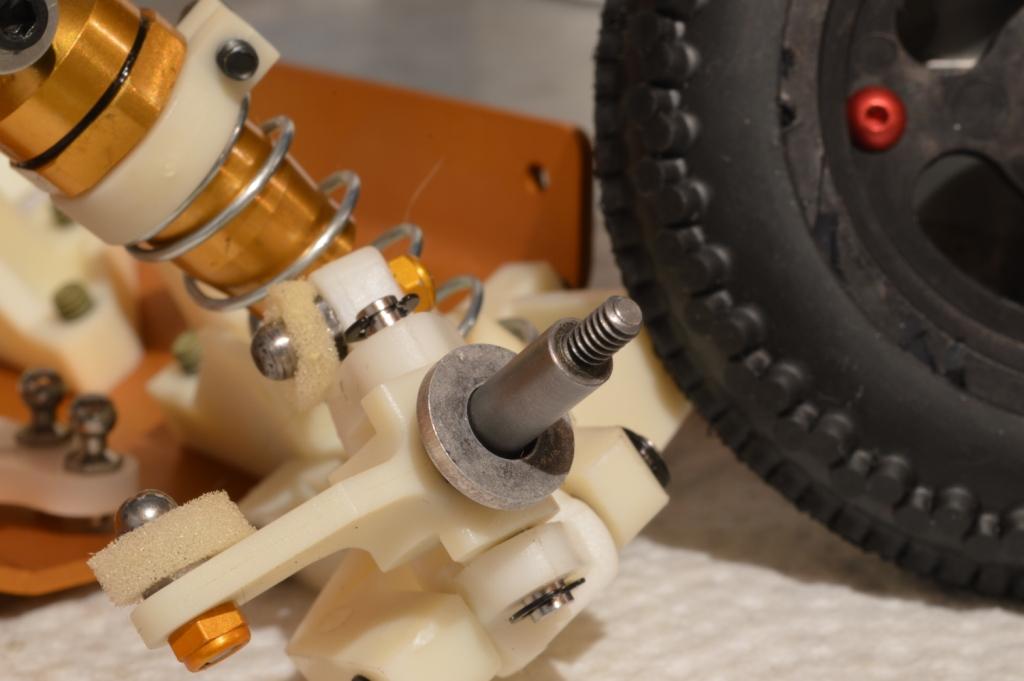

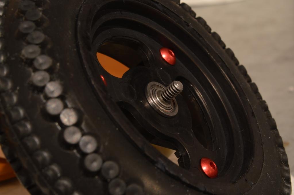

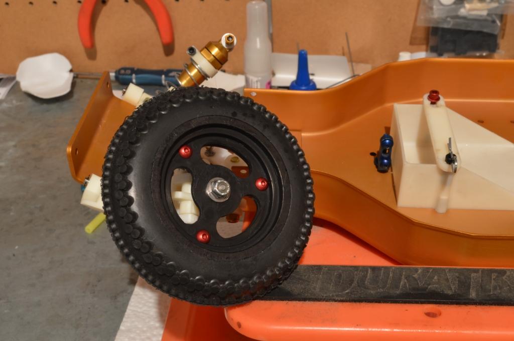

My next run in with the re-re is the length of the front axles. The are about 0.15mm too long and the wheels are loose when the nut is tight. To maximize my front track I put a body mount washer behind each wheel and everything is good.
Front axles is ~ 0.15mm too long Add body post washer to maximize front track and remedy the problem The nut is ~ flush with end of axle Needless to say, I'm doing a Jay Halsey tribute runner. I have the sticker sheet, so it's going to look similar to this one below... but better

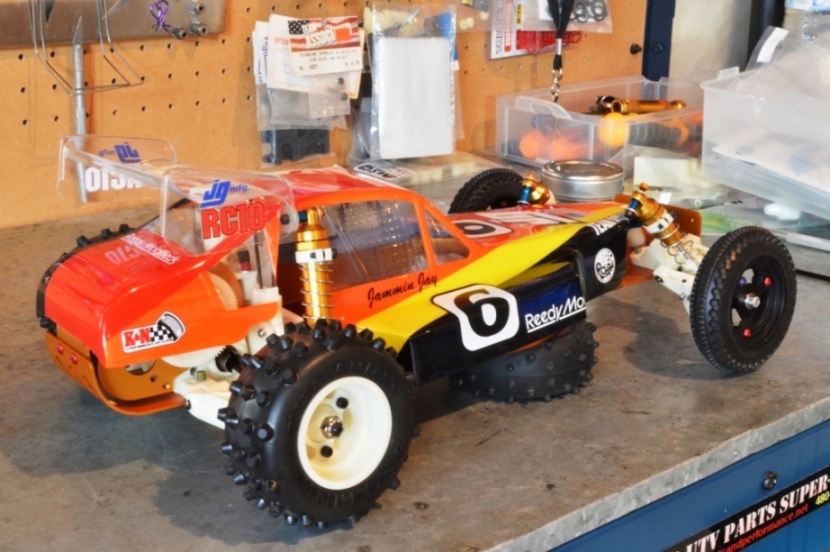

I ordered a front bumper from emerson. I'll be using the vintage looking turnbuckles from Lunsford. I am also using a carbon fibre front tower from JC and steering from JC. A Futaba steering servo, a Reedy brushless system and Reedy LiPo will top everything off

This was a problem back in the day as well. I had to do this to 2 different cars in the early 90's.vintage AE wrote:My next run in with the re-re is the length of the front axles. The are about 0.15mm too long and the wheels are loose when the nut is tight. To maximize my front track I put a body mount washer behind each wheel and everything is good.

It's the first time I've encountered it. What's the most popular fix back in the day?

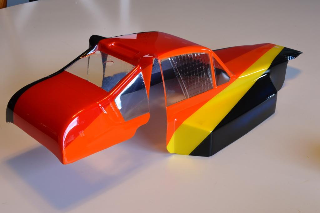

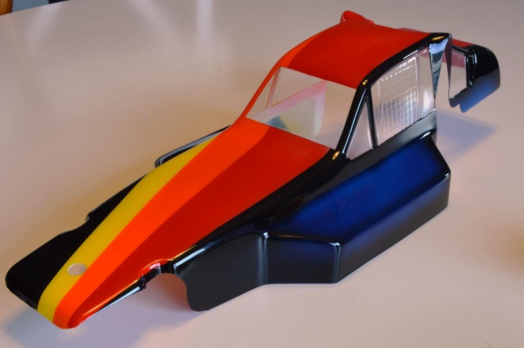

A little twist on the paint I'm doing.

I ran a steel washer from the hardware store, bitd.
Not that aluminum is bad necessarily but it is a large diameter washer and will rub the sides of the bearing. Ideally a pack of rear axle shims for 3/16 axles would be a perfect fit and run the inner race of the bearing only. Associated 7368
http://www.amainhobbies.com/product_info.php/cPath/1_25_1450_42/products_id/2787/n/Team-Associated-Universal-3-16-Shims-14
The classic kit doesn't call for a gold #4 washer on the outside like the old kits did. I found that odd and installed some on my classic. I also moved one shim to the outside again so the inner race is all that contacts

I remember just finding some washers that were small enough to ride the inner race of the bearing. Pretty sure it was something I picked up at my LHS. I do not remember what brand though.

I'll see if I can dig up some shims and oil them up with some synthetic lube.

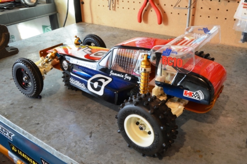

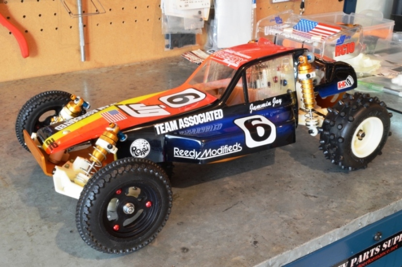

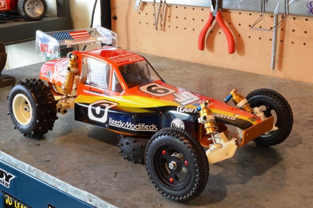

While I wait on parts to arrive in the mail I got the paint done. It's not exactly a replica paint job, but me like, a lot
Sticker time!
Sticker time!

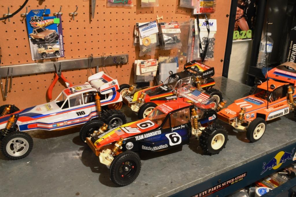

Got home and got the stickers off. Before doing so I snapped a couple of shots of my gold pans with their Protech bodies and small wings. Once I get the re-re runner complete I will do up a proper photo shoot if I can.
