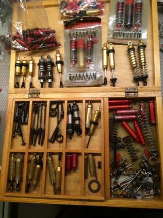

While I'm waiting for some parts to arrive I have gone through my old shock box. And I relished most of them need to be renovated. But do I have look for vintage parts or is there modern parts to be found that will fit my old Kyosho gold shocks? Pressure disks, O-rings, shafts etc...
- Posts: 12336
- Has thanked: 1129 times
- Been thanked: 3919 times
Re: Kyosho Optima for NVC
I've been trying some hardware store ("Buna-N" iirc) black orings and have not been happy with them. They have a sticky feel, very strange. I haven't been able to find that size in silicone. I have tried the CRP ones on eBay and they seem to work well but get expensive. Those are the white ones.
