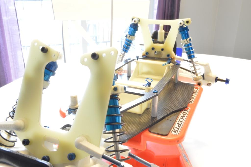

I haven't done the hinge pin hole yet, but here is an update... I think some will like this

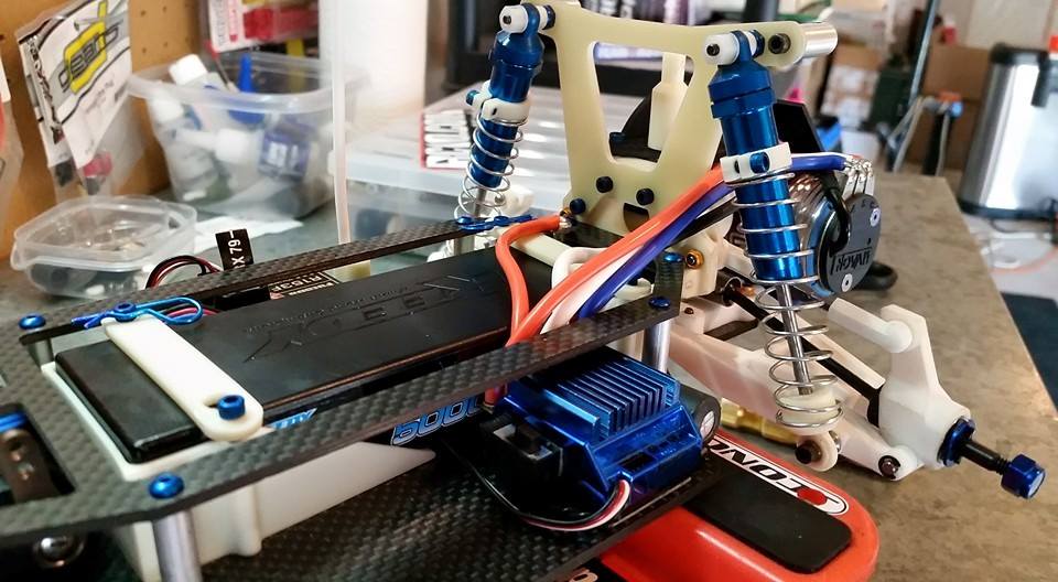

This thing is coming together quite nicely. Looks like I need to order some short FT turnbuckles. I used some B4 ones for the front, but had to trim the castor block turnbuckles about a 15mm. The rears weren't even close, but I had a random short one I used for mock up. I need to order 4 all together, the steering arm and bellcrank turnbuckles and the 2 rear turnbuckles.
Here are the electronics that are hopefully going to be installed. Got some white/orange/blue wires to match my paint scheme.
