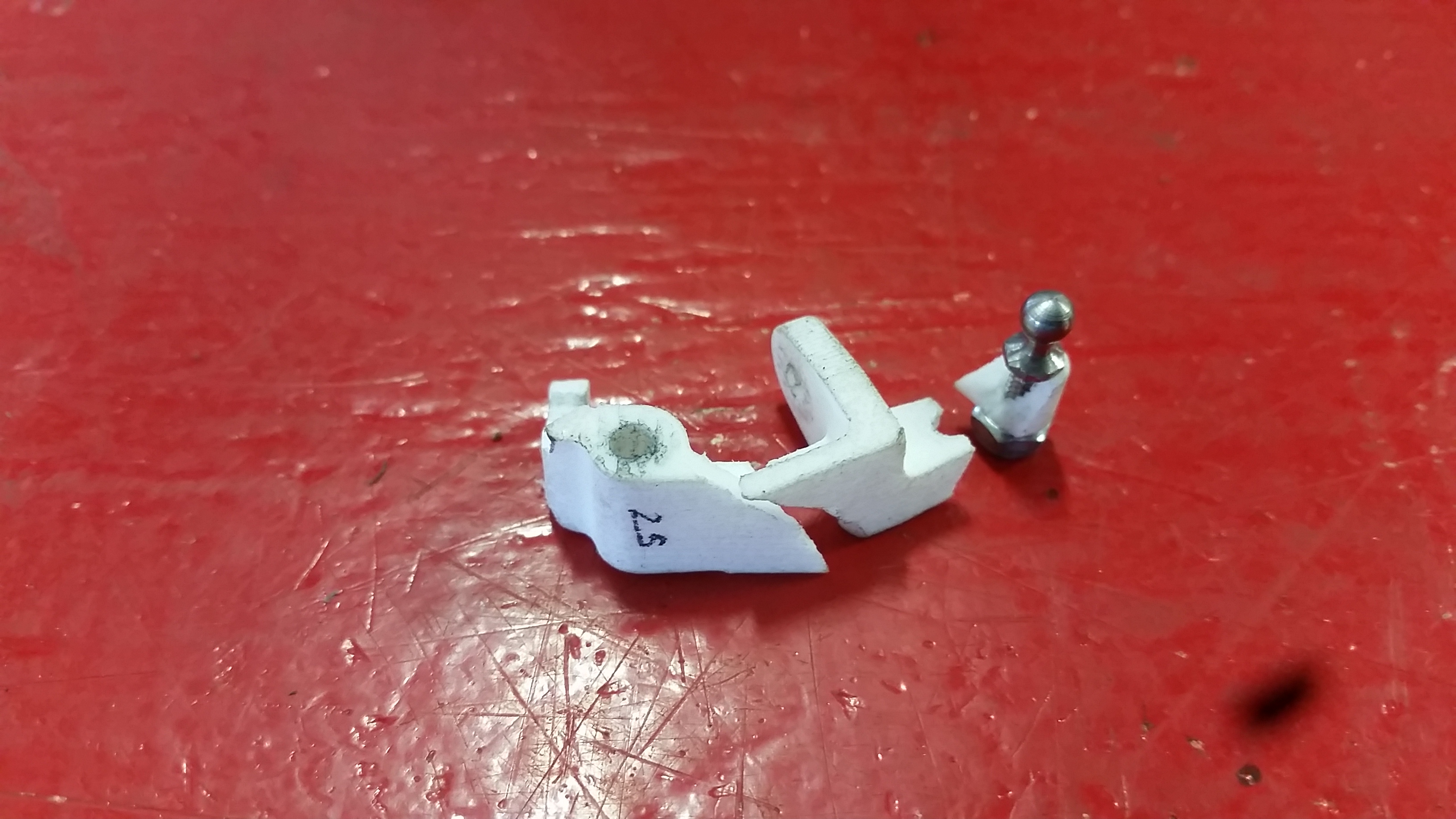

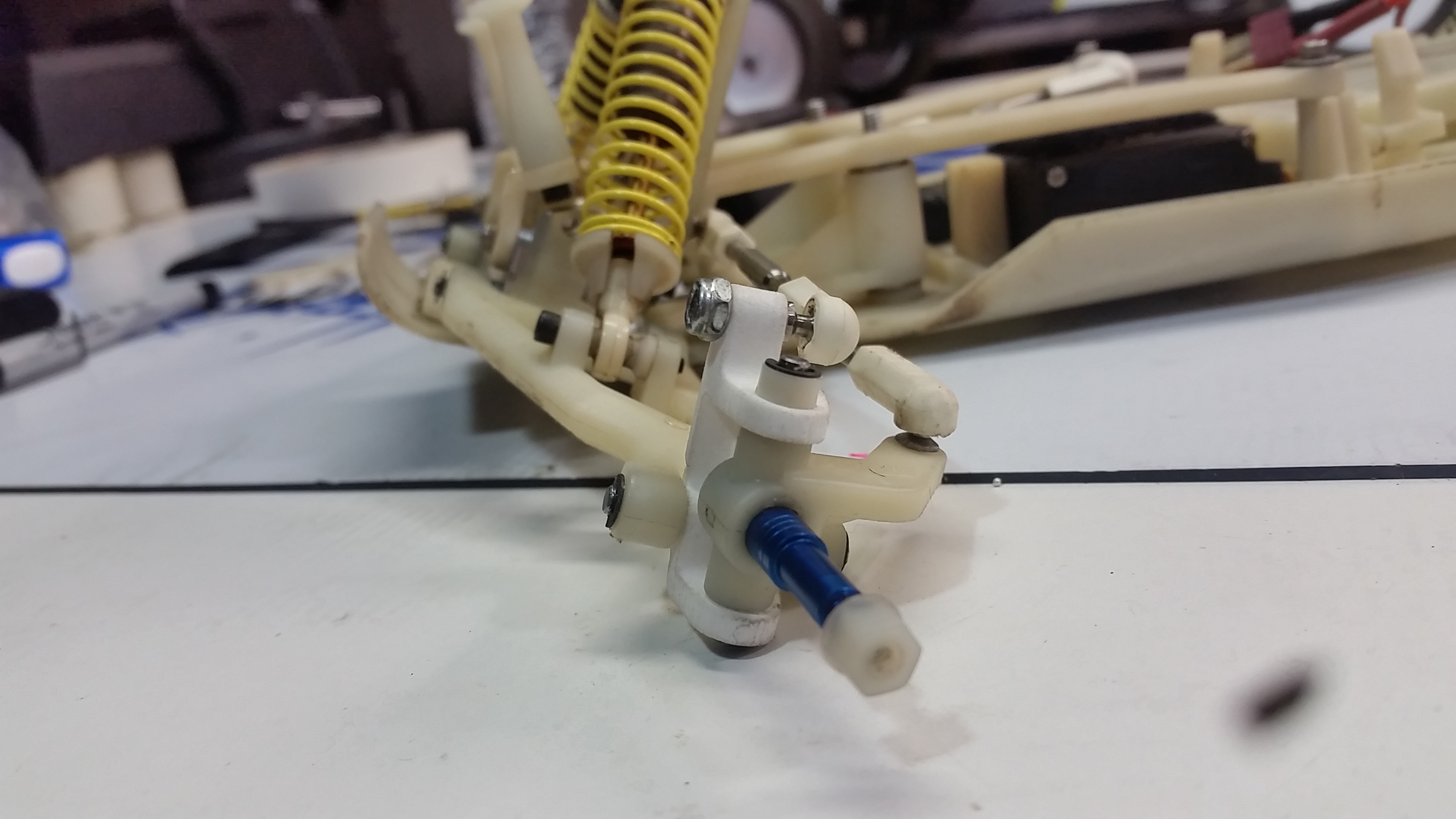

meh... i hit a wall in my ultramolded 10t after swapping out the rpm 30 blocks for these 25 ones from shapeways.
not a spectacular hit... but it would have popped a ballend off on my normal setup.
i didnt know anything about water seal or whatever. but i did ream out the holes and tap the threads, and while doing so the material just felt like it was gonna break.

I'm surprised to see 3D printed parts like this being used. I've been 3D printing things for a few years and would have to agree that I would expect it to break. Parts not under stress would be ok but I couldn't see these parts being 3D printed and holding up. At least not with the filament I use. Maybe some super strong stuff.

The 3D printed parts people are using from Shapeways are not printed with an FDM printer using filament, they are printed on SLS machines in Nylon. Completely different material and printing process. In my experience, the Shapeways parts are fairly durable, but can never match the durability of molded nylon parts. 8)
