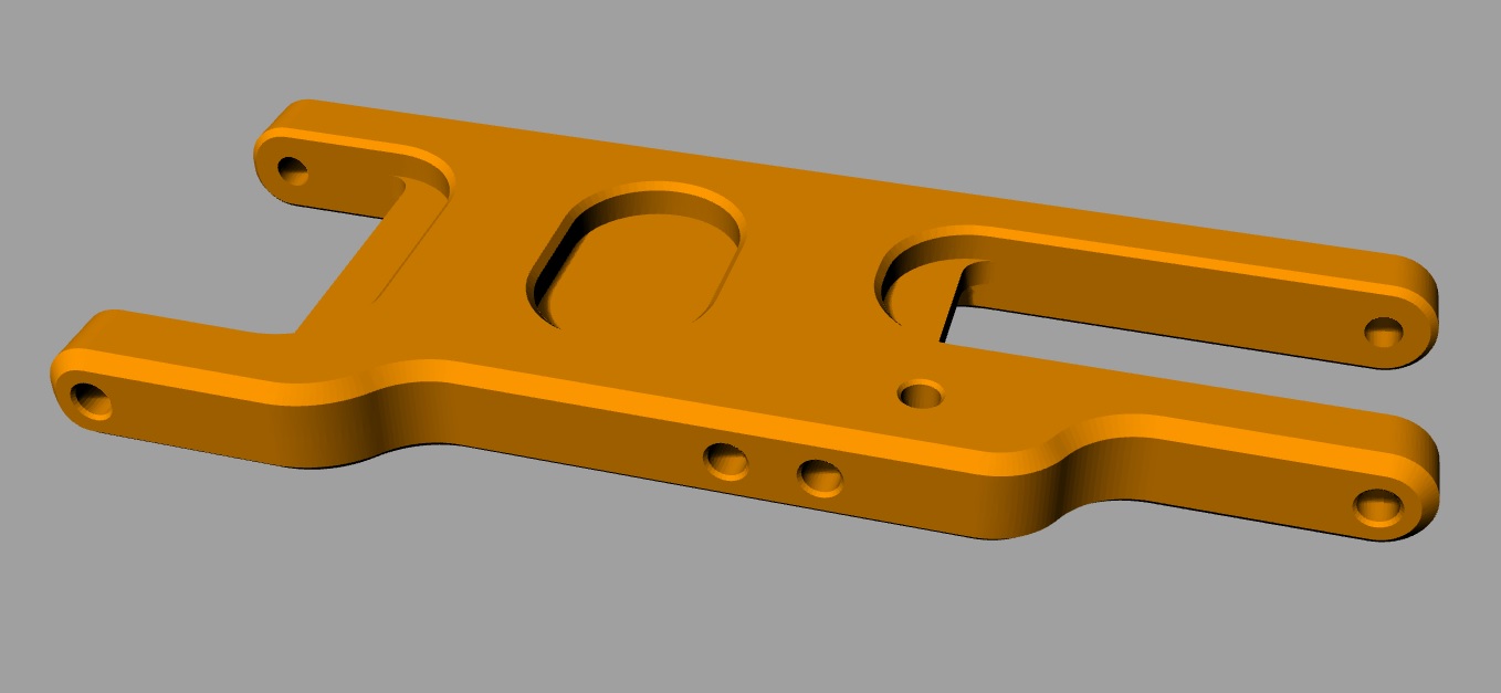

Post by Mr. ED »
The printed version for the front arm could look like this. Bottom and top are symmetrical so they'd fit both left and right.

jwscab
Posts: 6571
Location: Chalfont, PA
Been thanked: 498 times
Re: YR-4 custom buggy conversion
Post by jwscab »
Machined nylon plate ala dynotech style would be strongest. Printed stuff will not be as strong but can be made to look original where the machined stuff will not, dollar for dollar.

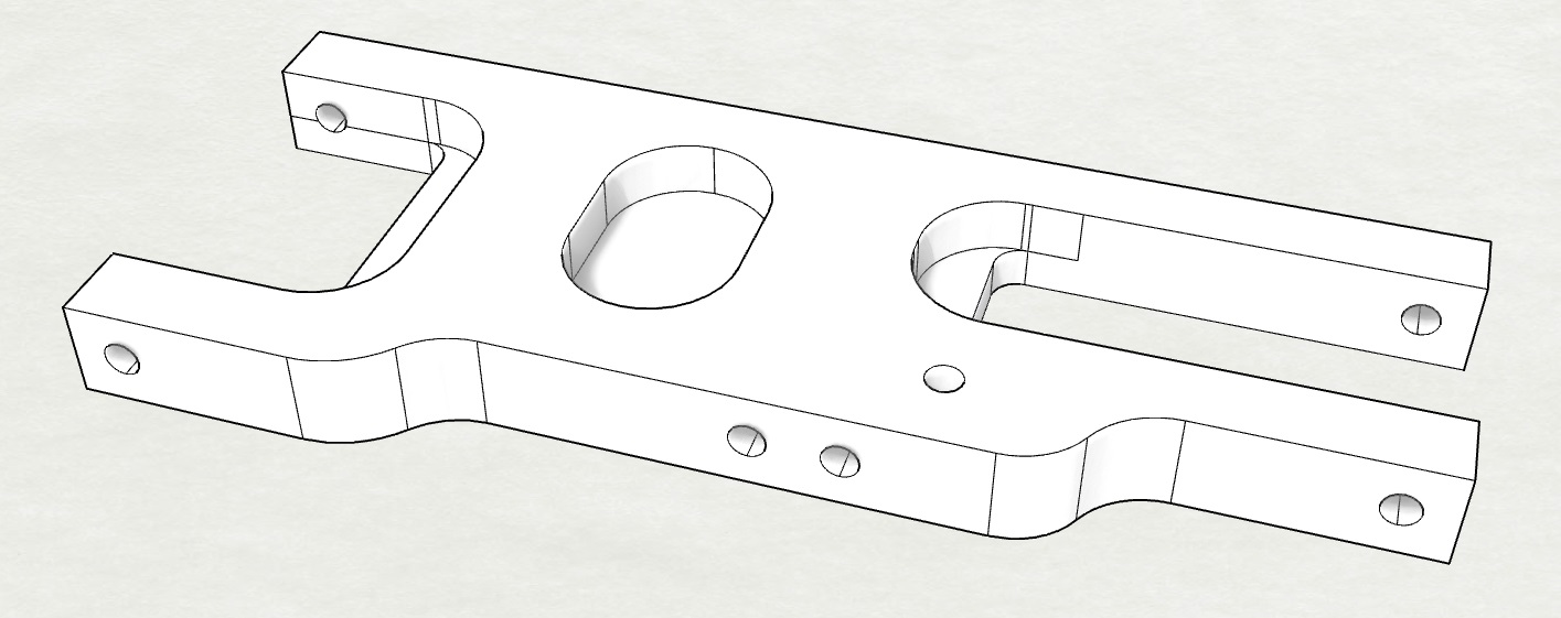

Post by Mr. ED »
Orb design uses printed parts for his FWD buggy, and the guys here for the ten-4, and the replica of the masami prototype too... I think.
Ideally you 'd have glass-fibre reinforced nylon.
Anyway, This is the design for machining: in Delrin or nylon or whatever you can get.
A 3 axis machine would be enough and you'd only have to change the part orientation once since there's no machining from the bottom side.
(Slight disadvantage: left and right are mirrored = not symmetrical, which means 2 different milling programs and possibly higher charges than 2 identical parts)
I recommend a 12mm bit to do the outline and pockets quickly, and 4mm to finish the smaller radii. The holes for the shockmounts and hinges are 2.5mm. You can manually tap them for M3 and ream them for the 3mm hinges.
What kind of file would you need? I can do a step (stp) export, stl (good for printing I think), or a 2D drawing in dwg format for a laser cutter or waterjet cutter, or plain pdf with dimensions: for the folks who have no data exchange.
Both versions are available for free: send me a pm with your email and tell me what you need.
(But maybe wait a bit till I've got the rear ones finished also.)

Hi MrEd, can you do a .dxf file? Ive been toying with making arms on a manual mill, but would like to try sing my cnc. The material i have is too thick, so I would likely add a rough cut process to the mix, or possibly mirror the process on each side to produce symmetrical arms.
Mr. ED
Posts: 5483
Has thanked: 62 times
Been thanked: 62 times
Post by Mr. ED »
Sure I can do dxf. That's just a variant of the dwg format.

And the machined version for the rear:
I've added 2° of toe-in at the wheel hinge.
That'll make it harder for the machined version, I know. But it made a world of difference on my YR4.
