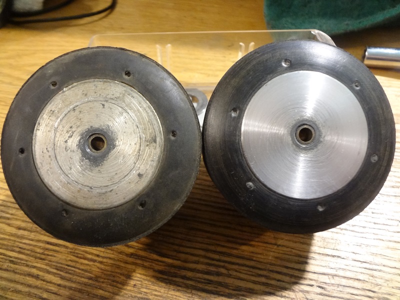

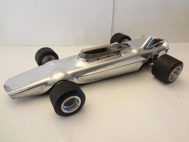

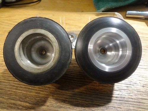

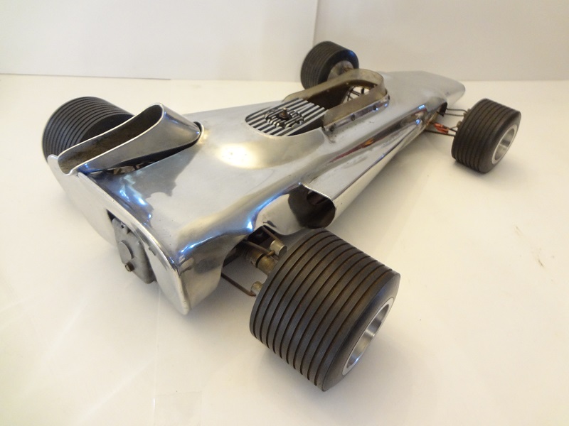

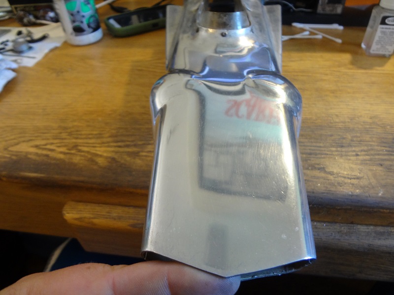

and so it begins...
A couple before and after shots of the front wheels.
Coelacanth
Posts: 7421
Location: Alberta, Canada
Re: Antique Aluminum Body 1/8 Nitro Car
Post by Coelacanth »
Yep...I'd rather look at that than several decades' accumulation of funk & munk. 8)

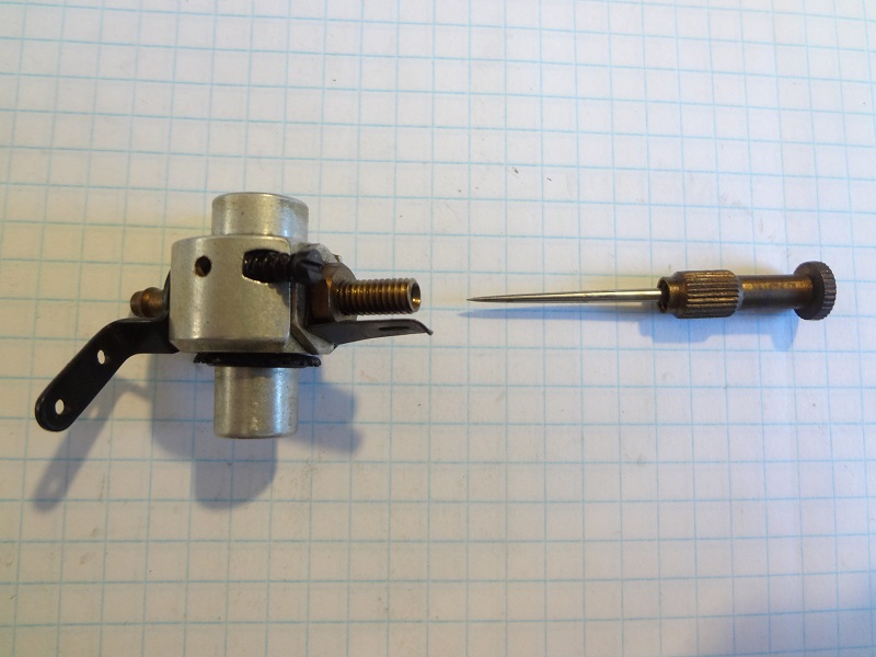

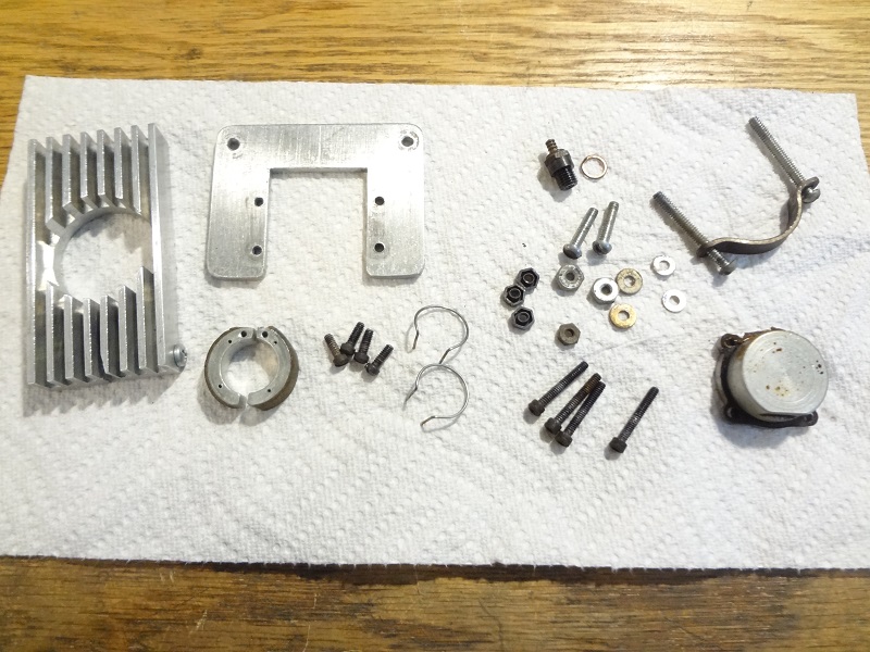

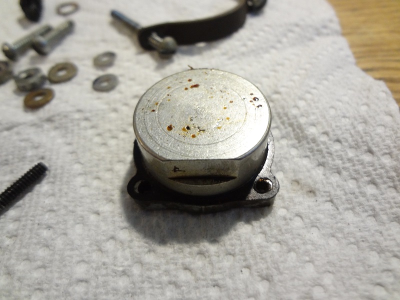

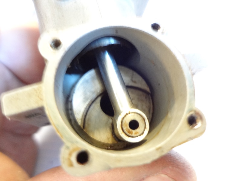

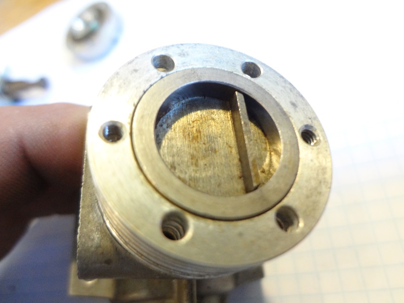

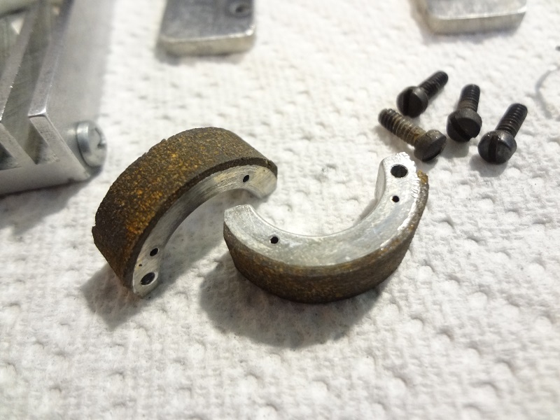

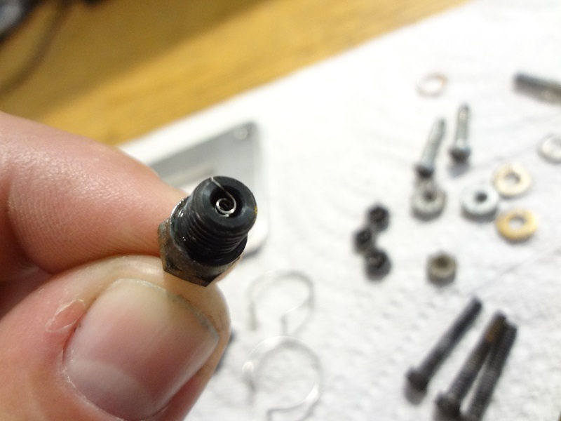

:lol: yeah, me too. I pulled out the engine. The builder of this car made a nice aluminum engine mounting plate instead of the crappy wood ones. All I'm doing with all these parts is a careful cleaning. The clutches came out like this. They have not been cleaned or anything. It looks like this car was run once around a parking lot and then shelved for all this time. Even the coil inside the glow plug still looks new. The engine had the expected dried gummy nitro residue inside as you can see on the inside of the backing plate. The engine is stuck, not so much from the piston but from the residue binding up the crank bearing. I will try to get that sorted out today. If I have time, I'll try to get to the gearbox. Heading to the track today to get some practice :mrgreen:

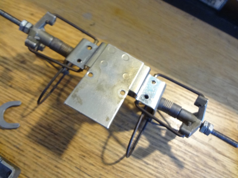

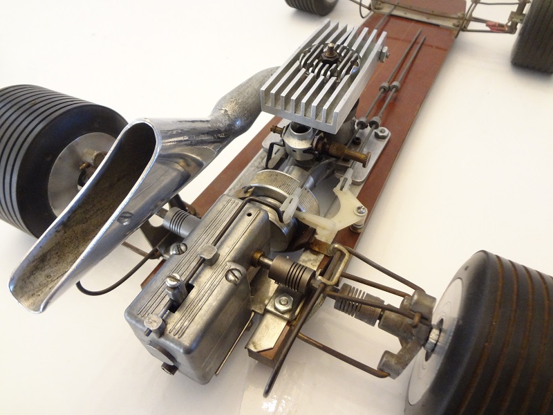

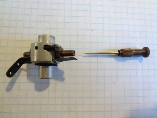

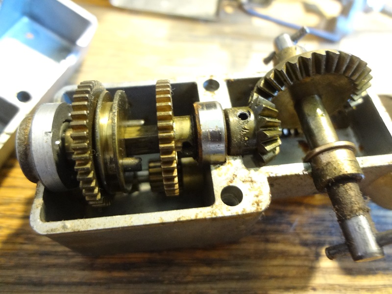

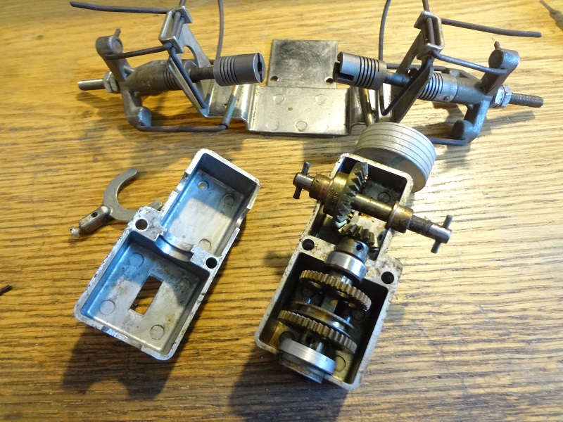

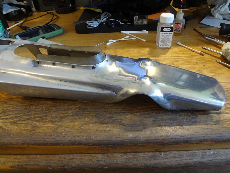

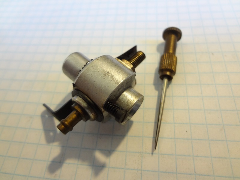

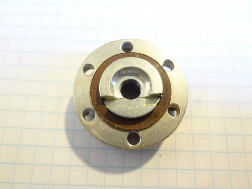

I coudn't leave it alone so I just got to work. There isn't alot of pics or info on these cars so I thought I would share some more pics of the parts and workings of this car. I decided to just hand polish it for now. The engine was unbelievably new on the inside. The cylinder still has the crosshatching. Crazy looking piston. Cleaned the carb thoroughly. The engine turns over silky smooth with excellent compression. Feels like a new engine. Real trick to these it seems, is getting the clutch/engine lined up correctly with transmission/clutch bell. It used thin brass washers to achieve proper alignment and I happen to have a bunch that were identical to the originals so I was able to get a perfect alignment after about 8 attempts. I'm pretty happy with the condition now. I doubt I'll do much more if anything to it.

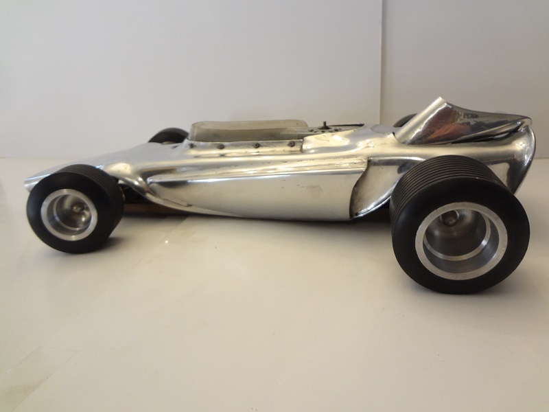

Few more Pics
