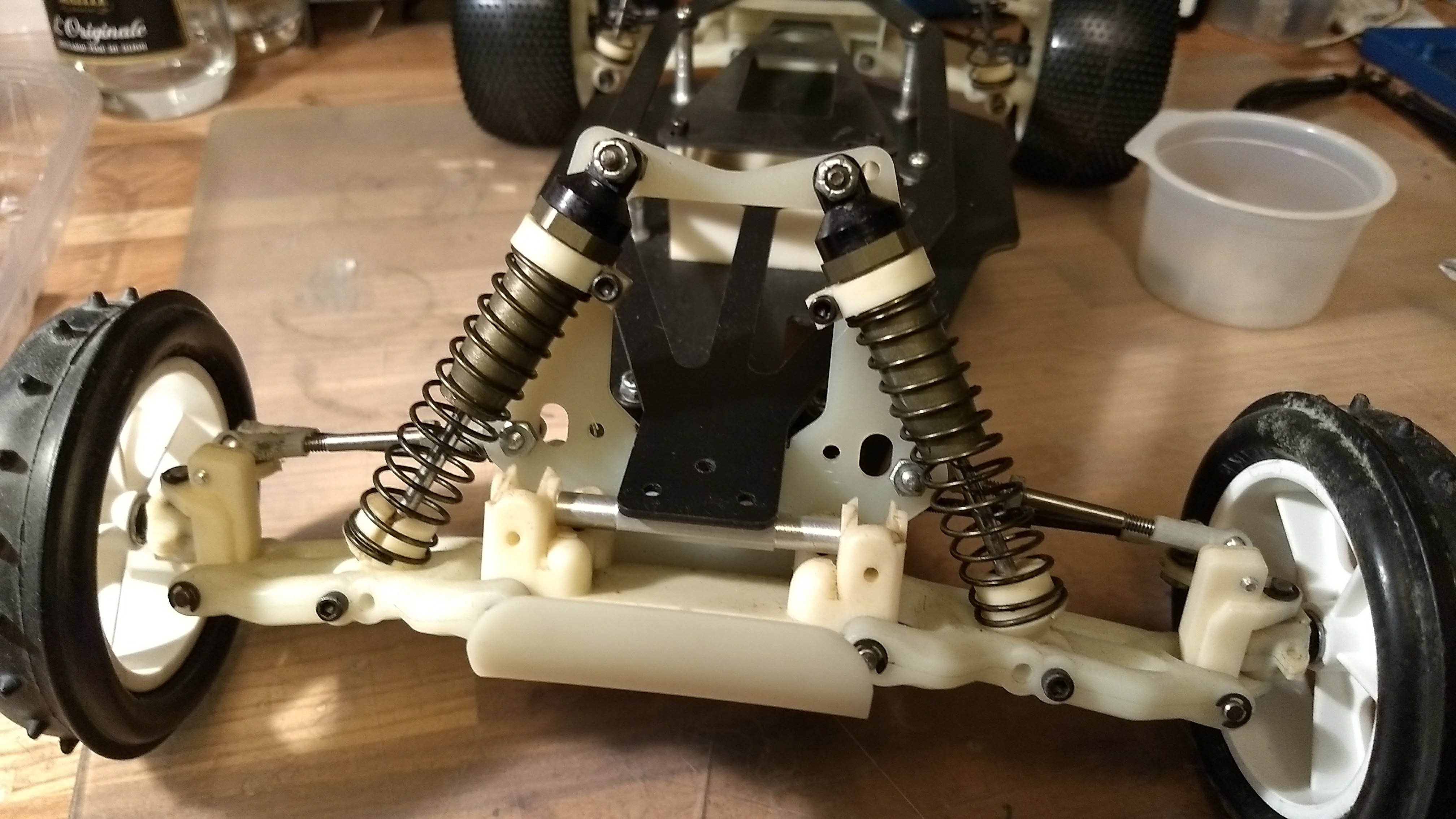

First qualifier, I popped a ballcup. Marshall cut put it back on. Second and third qualifier was ok but everyone was getting faster as they were learning the track - I wasn't. In the end I dropped a full 8 spots and started as 1st of the D
I don't think there is a single run where I hadn't rebuilt my shocks and tried something different. I must have downed two full bottle of oil and the hydraulics were still crap , I think I had some 55WT at the rear

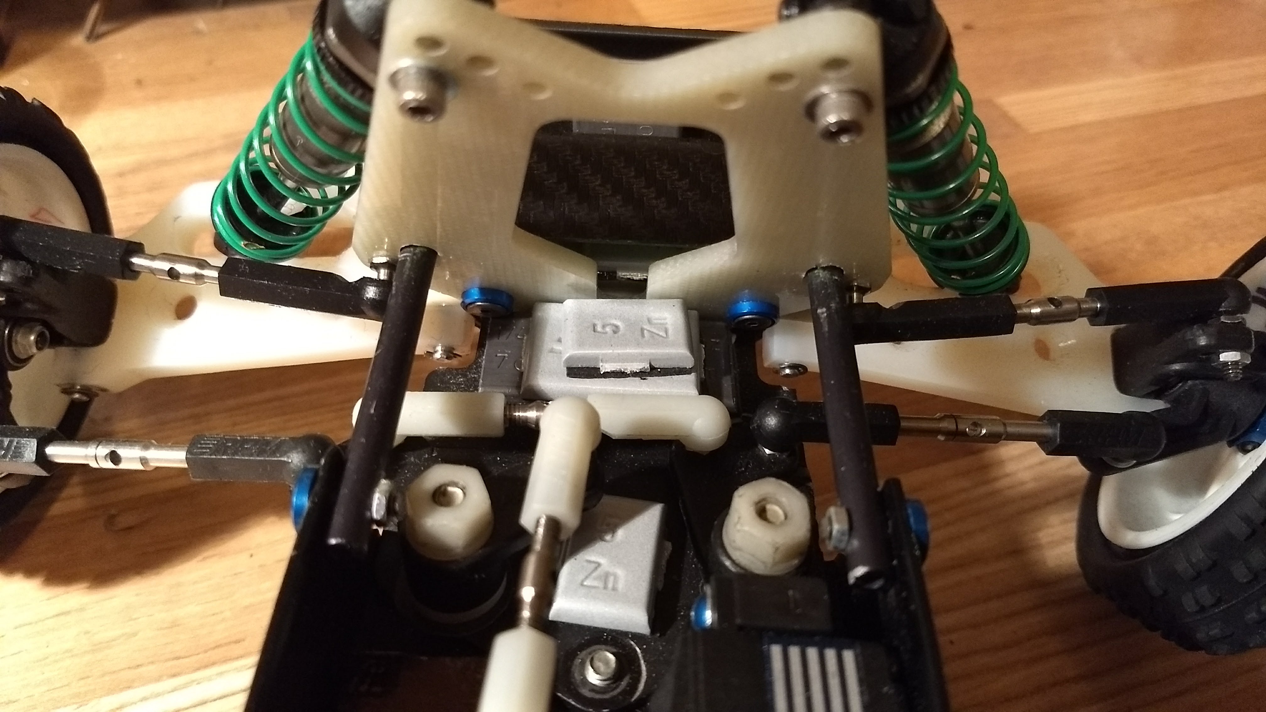

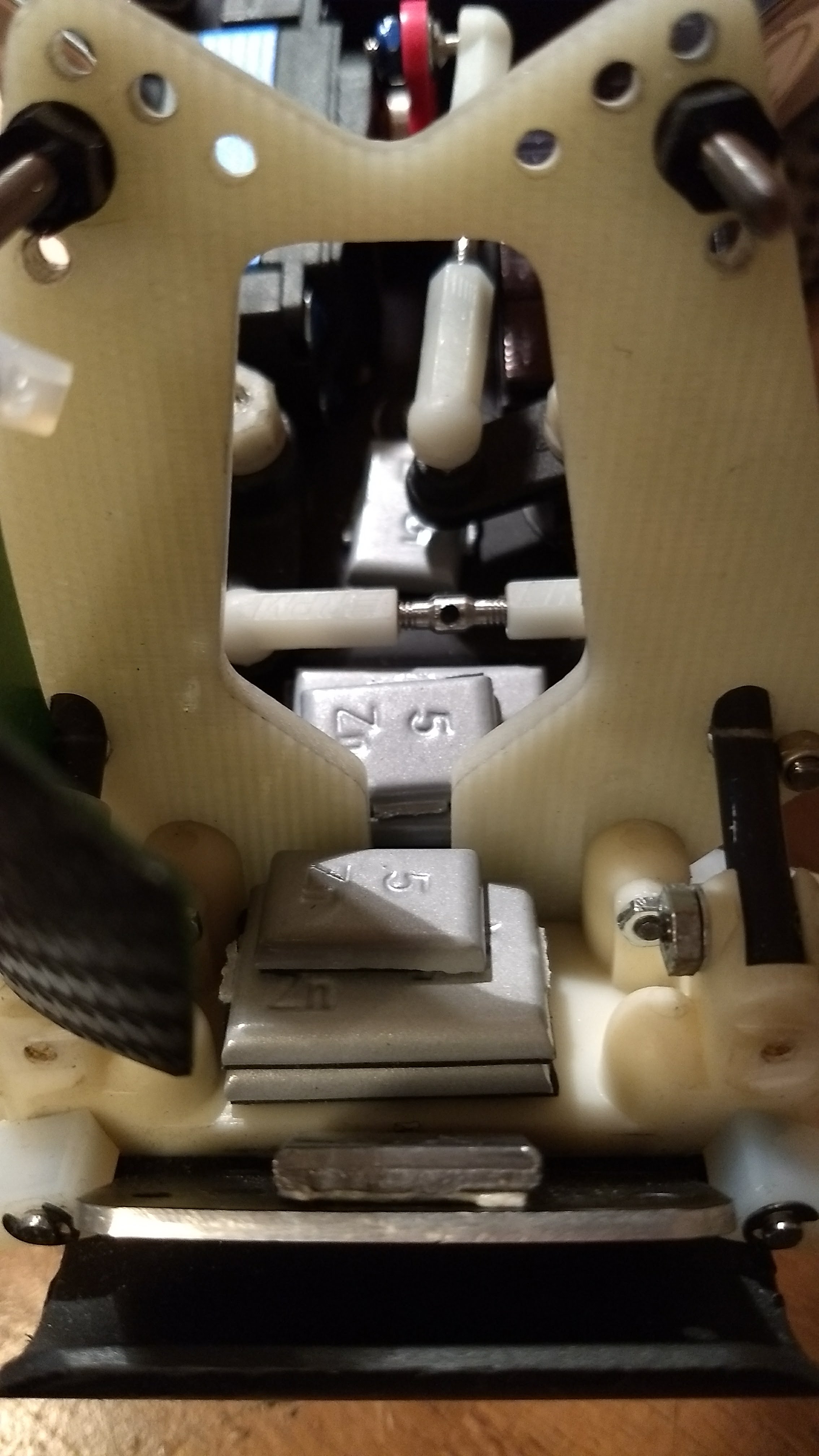

I've also added a significant amount of lead up front, behind and in front of the shock tower, as grip was coming up and my car was pushing wider and wider. This also helped the car be a bit more lively in the slow sections, but not by that much.

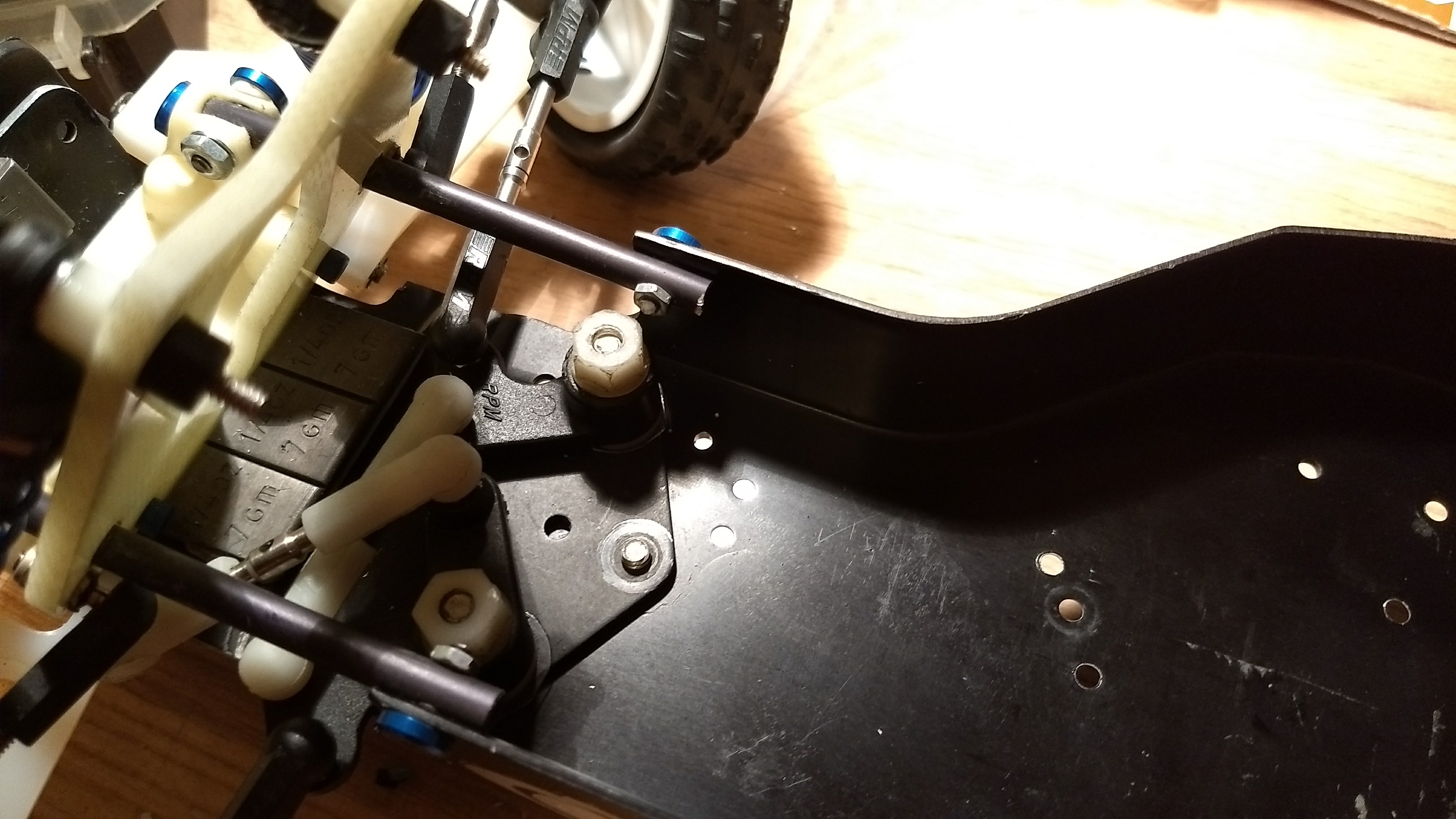

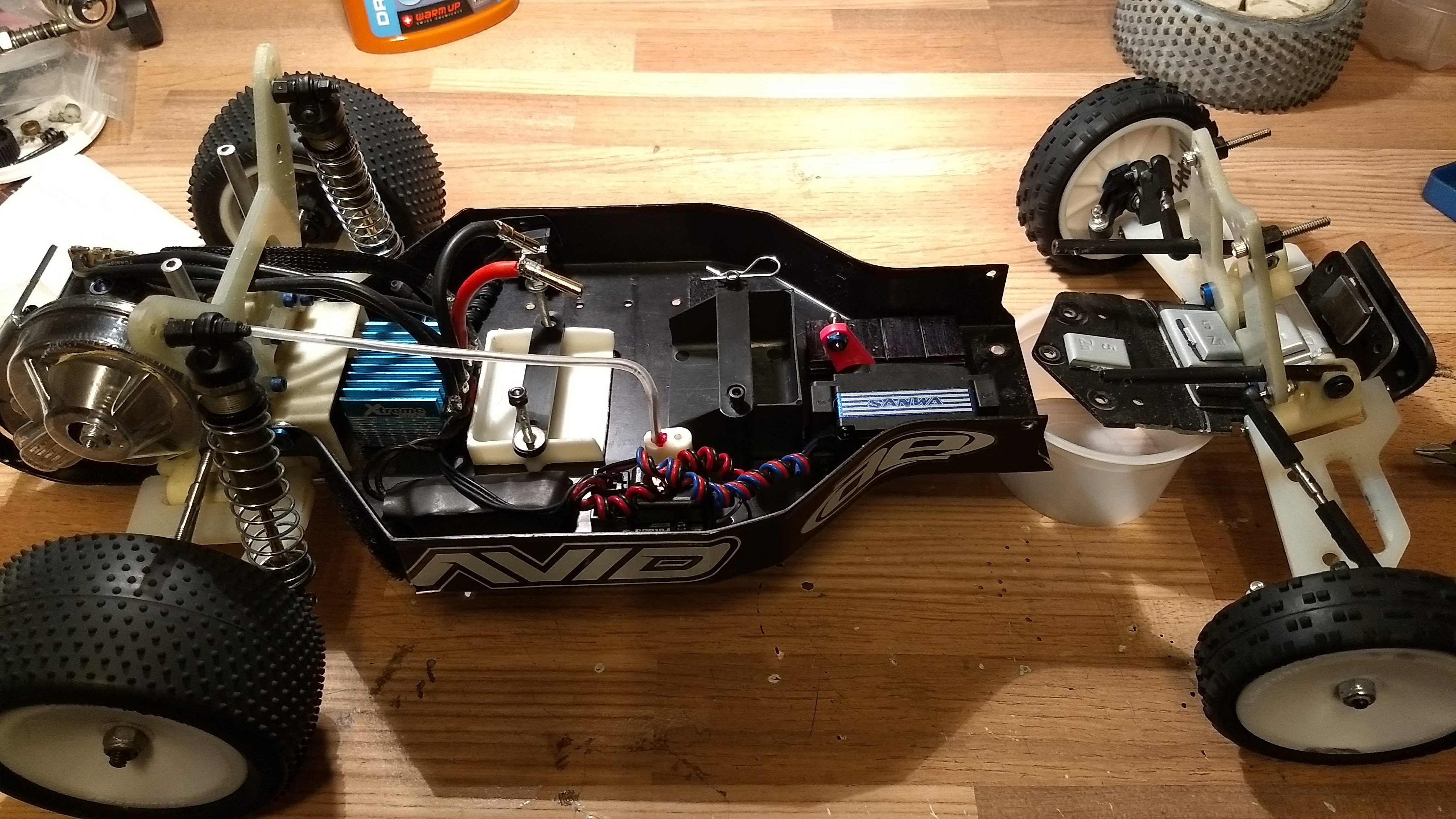

One other thing I forgot to mention is that I'm running a front LWB car, but a "normal" RPM steering set.
This configuration gives a stupid ackermann (sorry, no pic) with VERY different L/R angles... which make for an easy-driving car on the one hand, BUT as the inside wheel throw is maxxed, the outside doesn't have much at all. This doesn't help with getting corner speed, really
- Lonestar
- Posts: 4270
- Has thanked: 623 times
- Been thanked: 171 times
Re: Lonestar's RC10 OIN Racing chronicles
(c'ed)
The solution for this is to install an A&L-like steering system - the "connecting bar" will help alleviate this issue, by bringing the putside steering link closer to the front end once at full lock, hence dialing in more wheel lock (more on this later).
Also, note that all modern cars have their steering pivots at the front of the car - the bellcranks are oriented the same way as the spindles. This is a much better design...

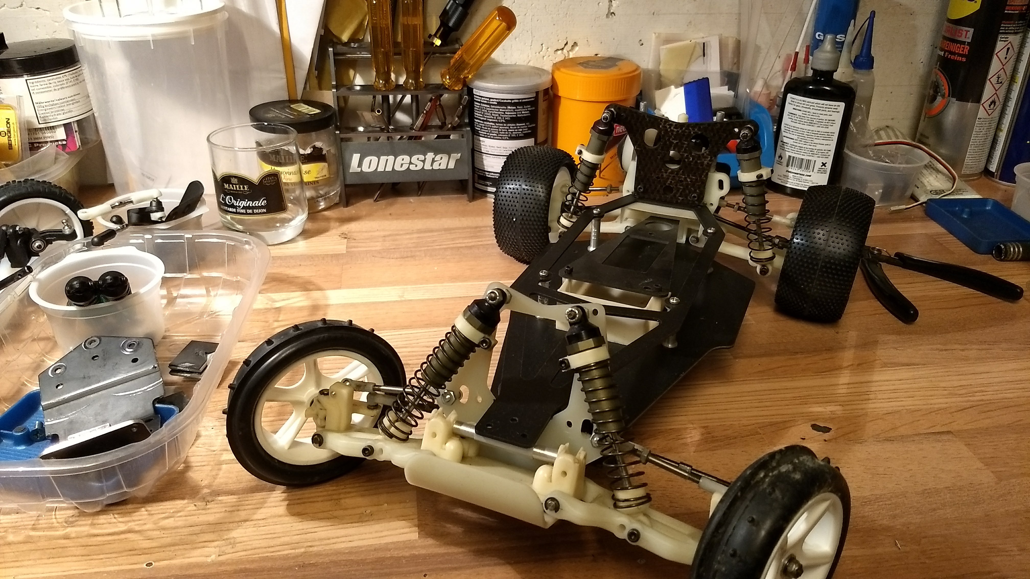

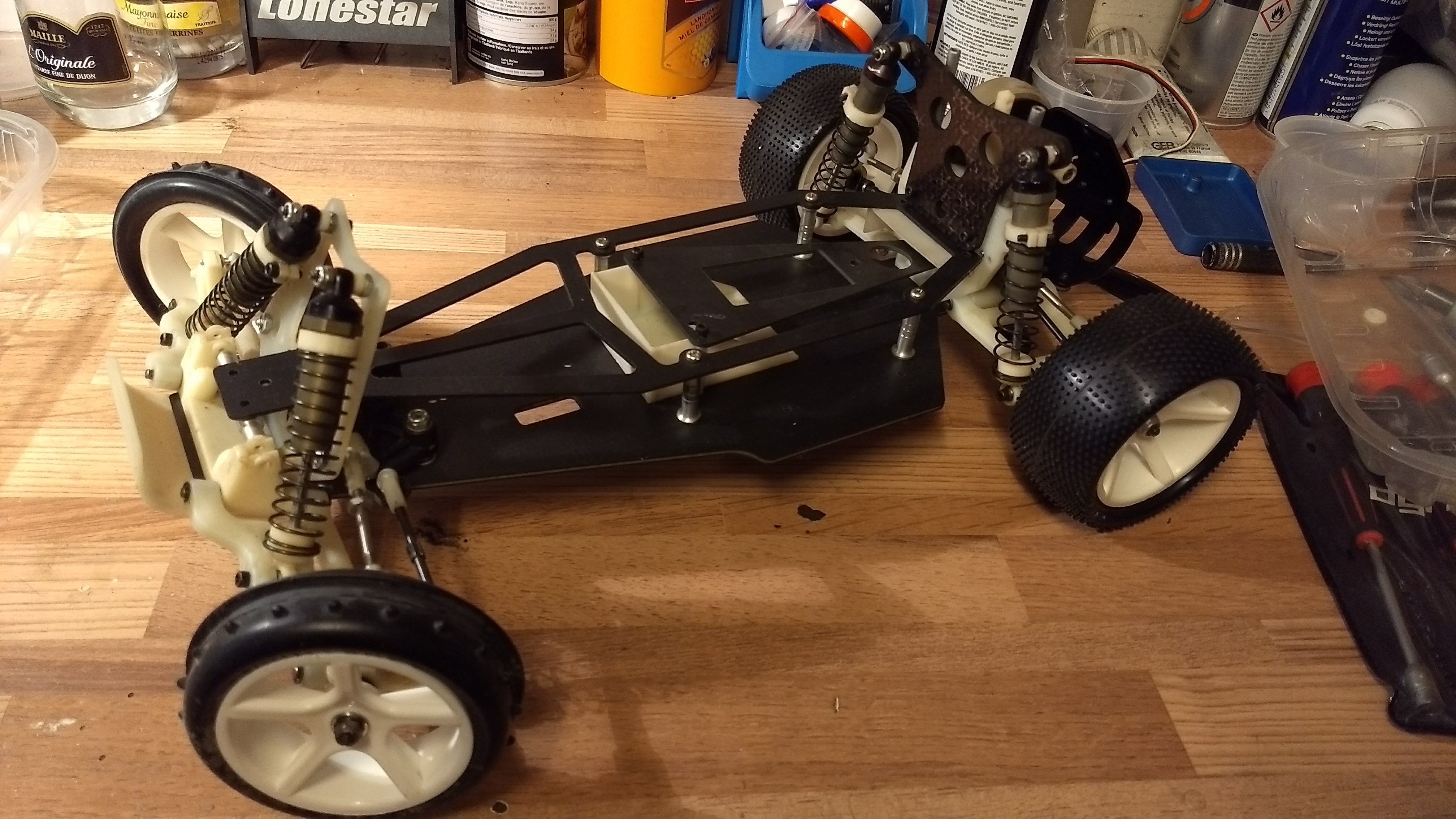

I'm not quite done with this car yet...

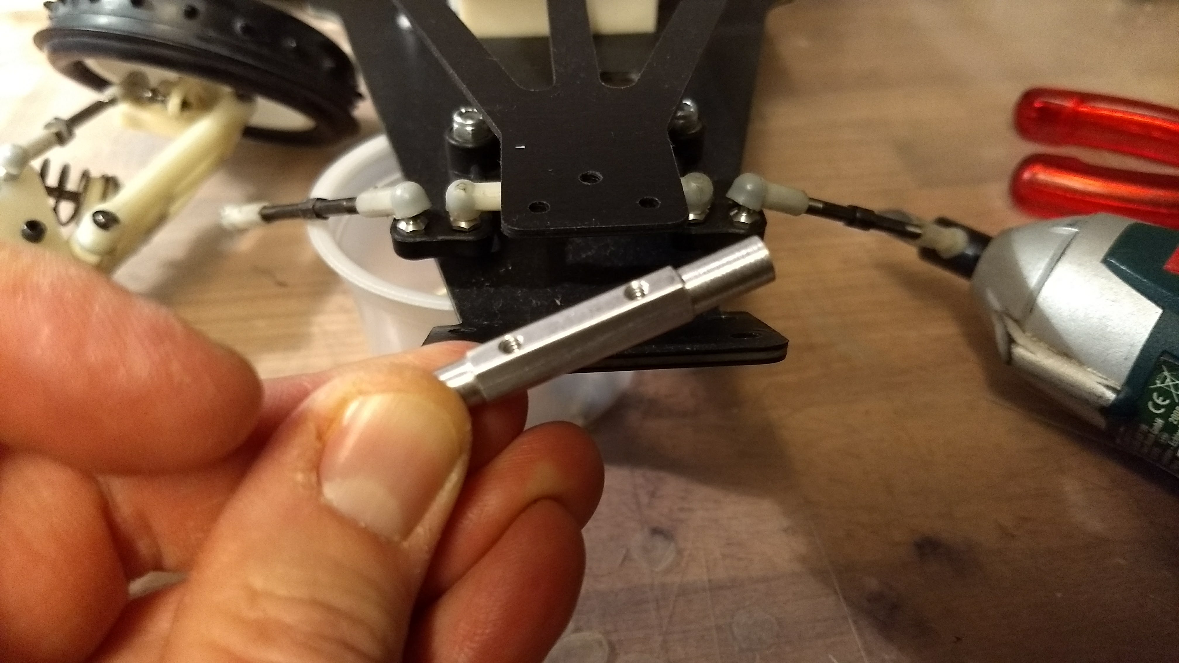

First, I want to install an A&L-like (or TRX-1-like) steering on this car. I'll either pillage the steering from my Stealth CE here (thanks Georges for the pic http://www.overrc.com/vintage/autos/assorc10ce/assorc10ce.html )
I thought about buying one from Jeff, but this car only has a couple more races to do ... either taking that one rom my gold pan, or doing myself a cwf bar and bolting it on the stock bellcranks.
Second, I want to try Big Bores... Again, don't want to buy, so I will take them off my Blue-is-Better TRX1 to try.
Third, I've bought a MM conversion kit from Brian/Mark... I know, I know, by now I've spent pretty much as much as I would have paid for a B6 kit in the first place. But frankly I love the engineering behind it, and I also want to feel by myself how different a MM car drives from a RM car that shares the same platform

Your steering definitely whacked. If you run long wheelbase, you still need to place the steering bellcranks in the short position otherwise yeah you are all over the place. The nose is held in place with three shorty screws.
Get those shock towers fixed, fix the steering and reset your shock setup to B4 carpet.

Joe, roger that about the steering mount. The thing is, even a worlds car has some pretty crazy ackerman already - the outside mounting point on the bellcrank is too far back when some steering is dialed in. What it's missing is a "floating bar" connecting the bellcranks, again like an A&L setup or a TRX-1jwscab wrote: ↑Wed Dec 13, 2017 10:48 am Your steering definitely whacked. If you run long wheelbase, you still need to place the steering bellcranks in the short position otherwise yeah you are all over the place. The nose is held in place with three shorty screws.
I will try other towers, too. I'm struggling to see how just taking B4 shocks setups as-is (are?) on normal RC10 team/worlds towers on that OIN can be work given that everything is different... the spacing between the arms, the lower shock mounts, etc. All dimensions are different. Still a lot of playing around with shocks needed

yes, it has ackermann built in by design. I agree that maybe it might be more than needed, but its something to adjust back to 'stock' and then tune. as is, it's way off. bumpsteer is probably the more critical parameter here.
the oin suspension is closer to B4 than team car, so you are closer starting with the b4 settings. longer arms, longer links, camber gain, it's all closer to b4. the other thing, if you take 5 fast guys and look at their shock setups you are going to probably get 4 variations, so you gotta start somewhere.
I've been right on top of this because I have my woin at the point where I need a shock setup. based on what Jason is doing, a bunch of clay b4 and team car setups, including the b4 manual, I'm setting up my shocks initially as:
Front:#2 piston 35 weight oil
Rear #1 piston 30 or 32.5 weight oil-going see how it feels on the bench.

I bet you popped one of the camber link ball cups? You should try to fix that too, it keeps on bugging me
What I would do:
- bring your car back to short wheel base
- solve that camber link issue by limiting the steering on the radio. I always found it had too much steering travel and if you bring it back and to SWB, you’ll have anyhow more steering.
- use a wider front shock tower that allows your shocks to stand a tad more vertical
- use a buggy rear shock tower or drill similar holes in your truck one and cut the unnecessary ears. You want the rear shocks to be more at an angle, especially on hard surface/carpet.
- use blue springs front and silver in the rear
- limit the shock travel inside the shocks (at least by 5mm)
- shocks: I would start with #2 piston front and 35 oil, #2 rear with 35 oil
- you should also try to add weight below your battery if you’re using lipos, it will help stabilise the chassis.

I bet you popped one of the camber link ball cups? You should try to fix that too, it keeps on bugging me![]()
What I would do:
I will leave the car LWB for now as I'll be swtching it to a MM setup using Mr. Conklin's finest 3D-printed wizardry
I had started the day on Rsilvers/Fblues, I ended up on Rsilvers/Fgreens in the hope to have a bit more front end. #2's might work again as weight is moved up front and the car's weight distribution is more "balanced" than a RR.
I will also try other towers as you guys mentionned!

Working on the front end first. This is what it looks like now - you can see some lead there

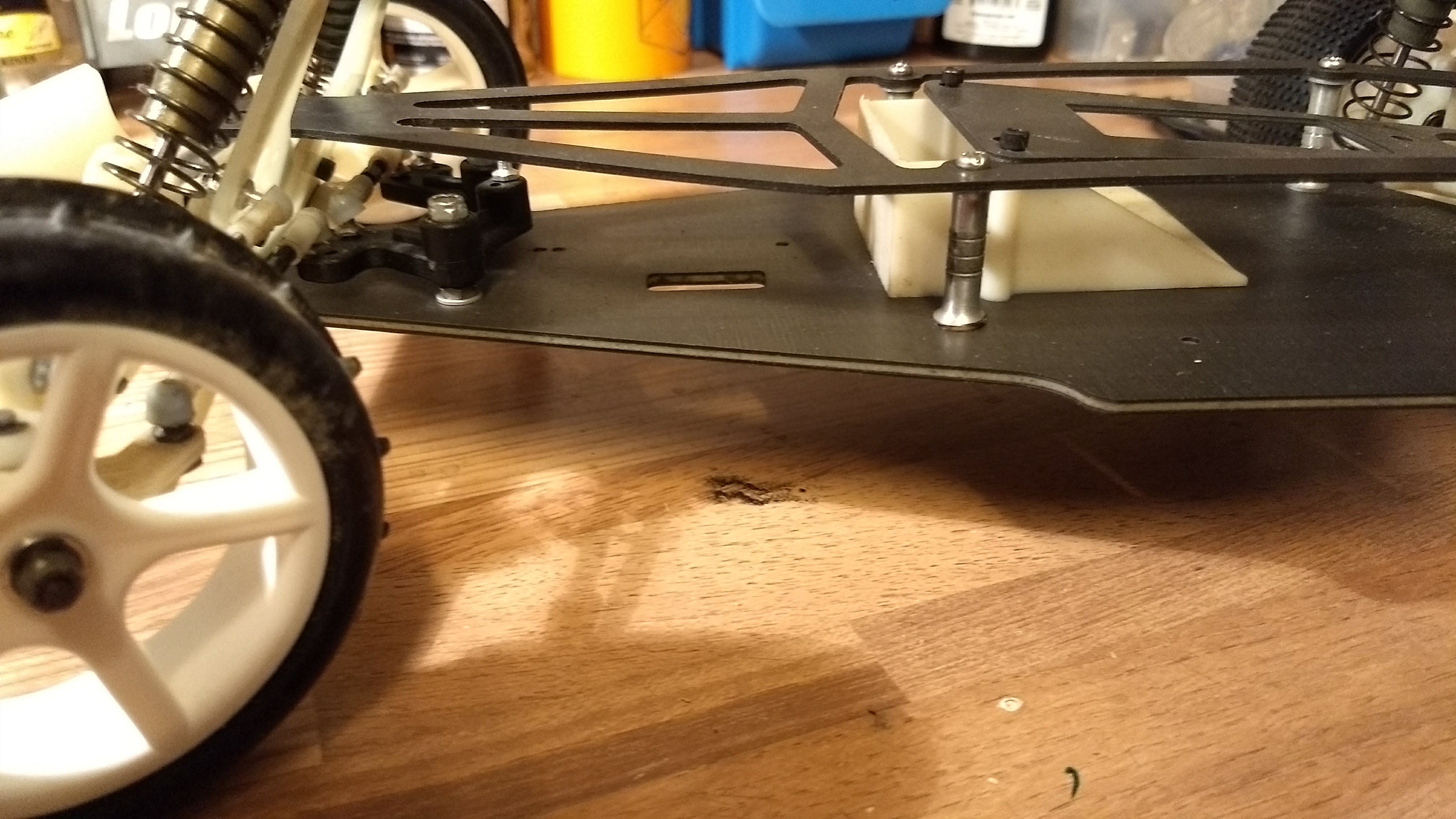

And once you remove that body extension (which is bloody smart btw!) there is even more
How about going extra-LWB
My scale tops off at 100g... so that 102g here
Still pushing like crazy

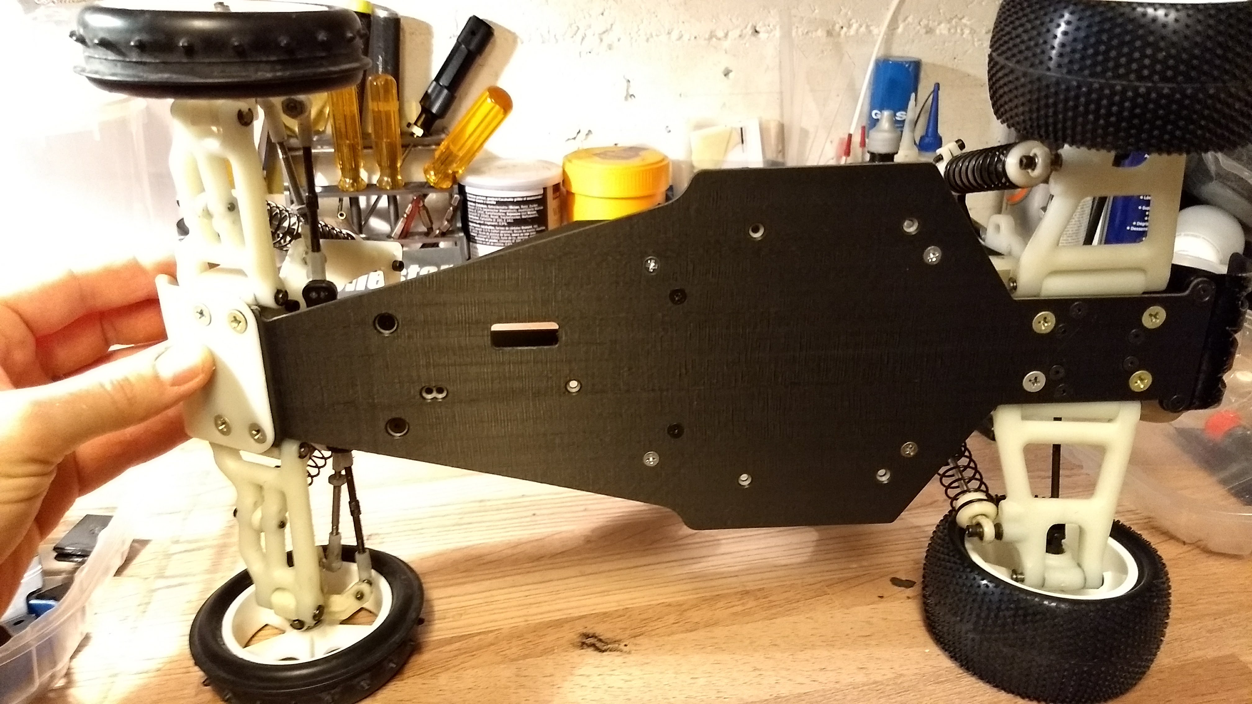

Right... no spare used RPM-style front shock tower to replace the 10T front tower, so I had to partly strip down a car I've had in the pipeline for a while...
bring on the new-built CC
cute, eh? Even if not perfect... still needs some work, but eminently desirable already!
here's what we need:
Note that Joe did this part for me a looooong while back - and I had never attached it
