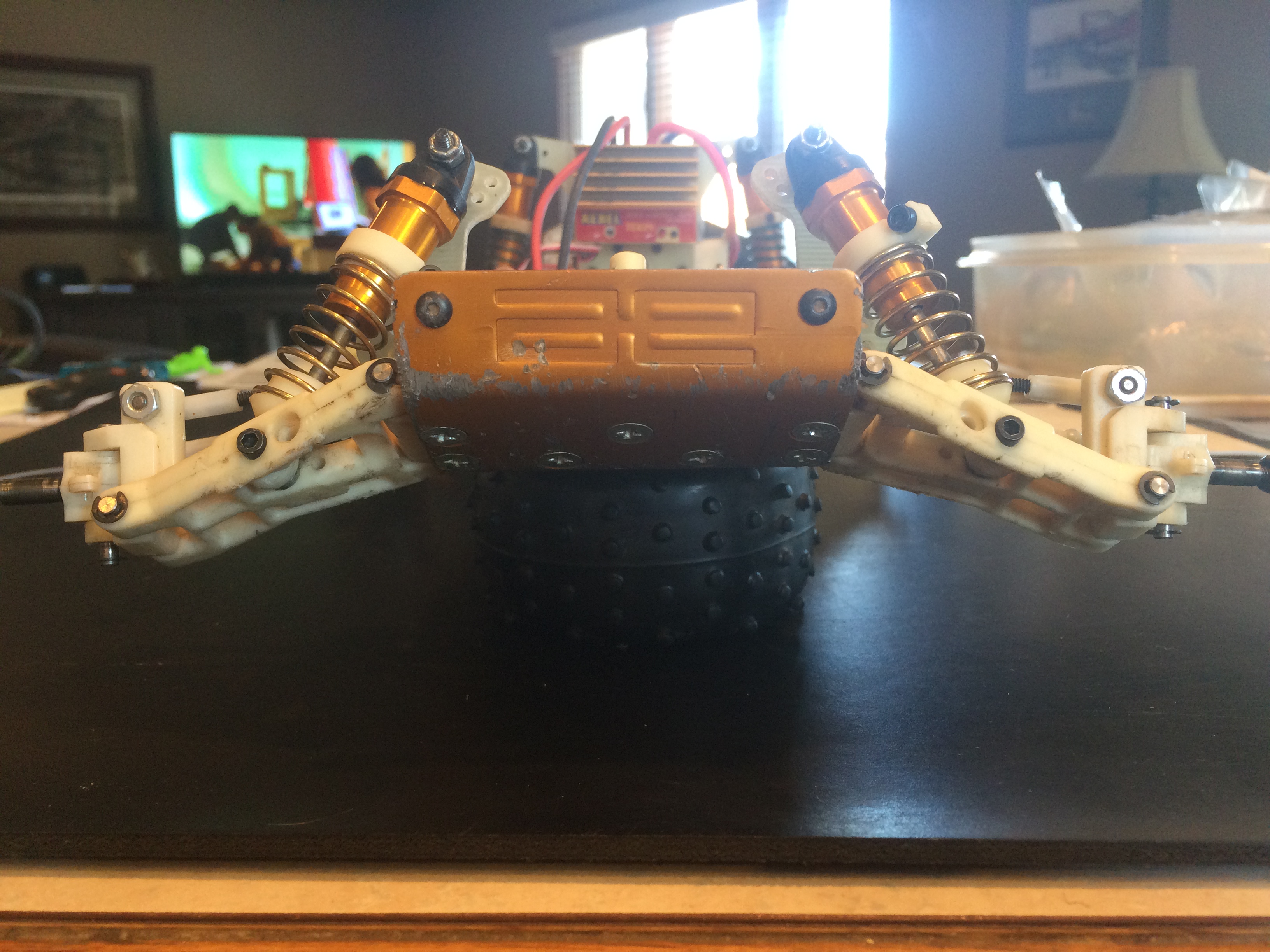

where should I set the collar for the gold spring? before I took the shocks apart to check air/fluid levels, I adjusted the collars to make sure they were even on both shocks. They were not even before. I now have the collar set so the bottom of the collar is where the shock body starts to neck down. seems low though. really compresses the spring for rebound action. however doing this and putting both shocks back on the car, now neither shock fully extends, ( I dont understand that, the collar was higher previously) and the arms are closer to the same level but still not even when left to hang. i can fully extend each side on its own. next im going to check the fluid/air levels. should I fill the entire shock body with oil, oil the threads of the cap, then put cap on and tighten? will that leave the proper amount of air in the shock? im assuming consistency is more important here
pic is after i adjusted the shock collars. im half tempted to leave it. looks fairly even.

The shock collars are used to set ride height. You would want to have everything installed on the chassis, motor, battery, wheels/tires,etc. Now use the collars to get the ride height you want. Refer to the manual for tips on that.
