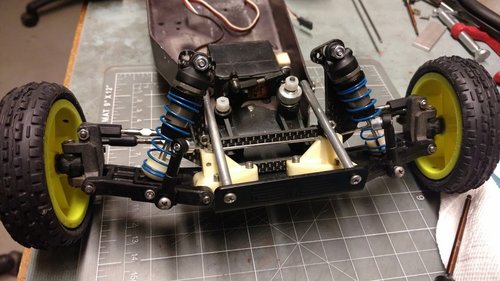

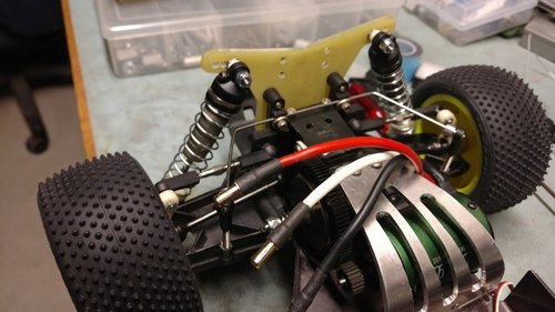

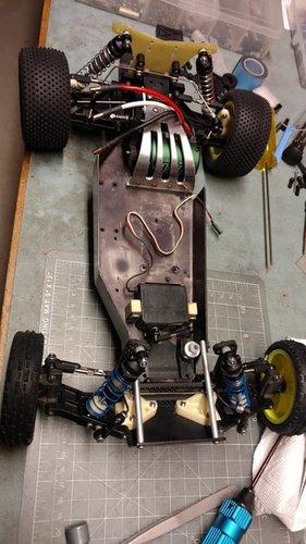

finally on it's wheels, shocks are bled. Adding some electronics and still need to make up the battery brace/mounts. I think I'm going to have to run 1.5 degree hubs backwards, as the mounts I have are 3 degree and seem excessive.

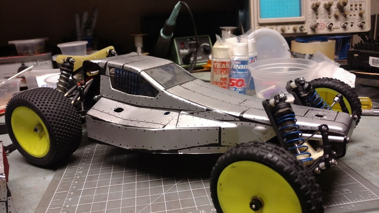

Re: e-GT buggy build

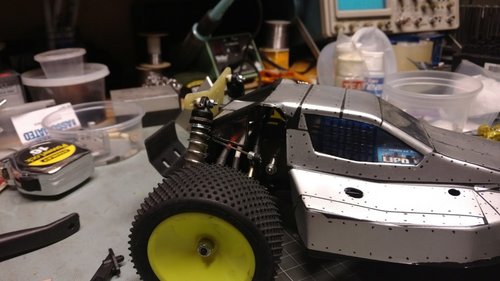

spent some more time with this guy to figure out a body fit. The jammin jumper I wanted to use still had interference in that front corner because of the funky chassis shape so I grabbed my scrap/repurposed/repainted viper I have and mocked it up. One correctly placed slice in the rear of the body, and she fits snugly, neatly and pretty slammed, so I love it. Body mount added on the small plastic trans brace and it fits the same as a standard body post fitment. I'll get that detail on the next go round of photos, still need to add the wing mounts back and trim up a wing.
- XLR8
- Posts: 3318
- Has thanked: 1684 times
- Been thanked: 1180 times
I agree, that body looks right at home on your car.
Roll bars on both ends -- are you planning to run on carpet?

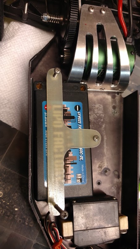

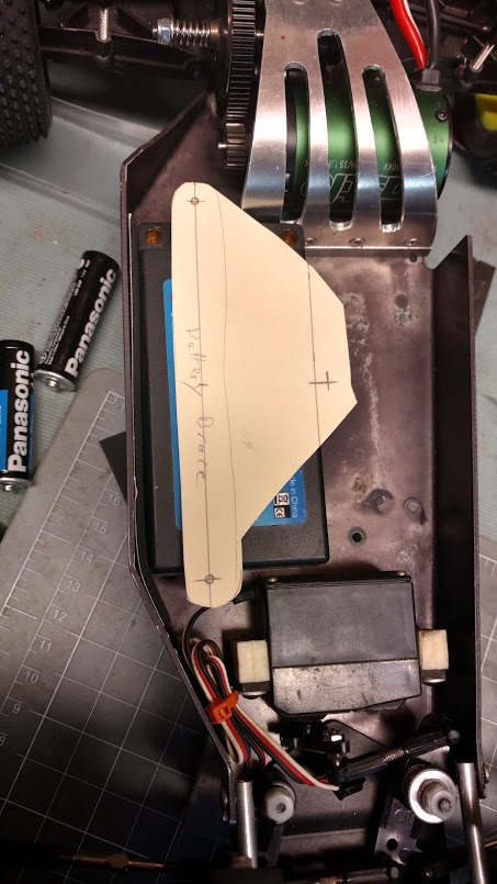

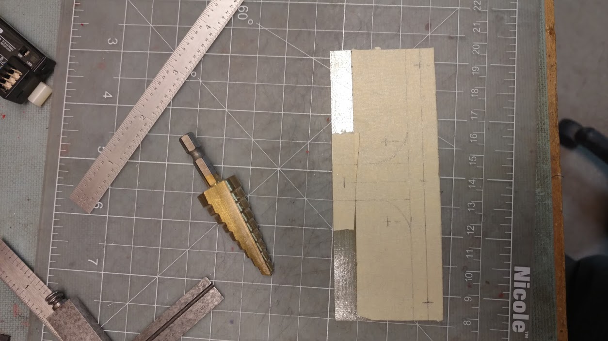

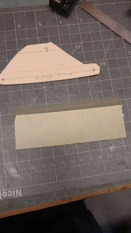

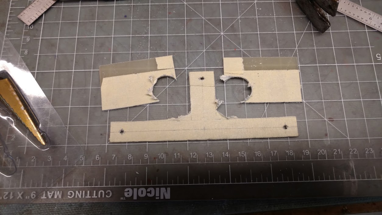

The next few photos/posts I thought I'd share on a typical custom fab for me, in this case, it's a battery strap. these are the methods I use, some a little rough around the edges because it's for me. If I was making this for sale, I tend to use a little more care, trimming the cut lines and radii.
rough battery layout with some foam cushion and cardboard mockups, piece of material (G10, 1/16" thick, masking tape applied to add markings):

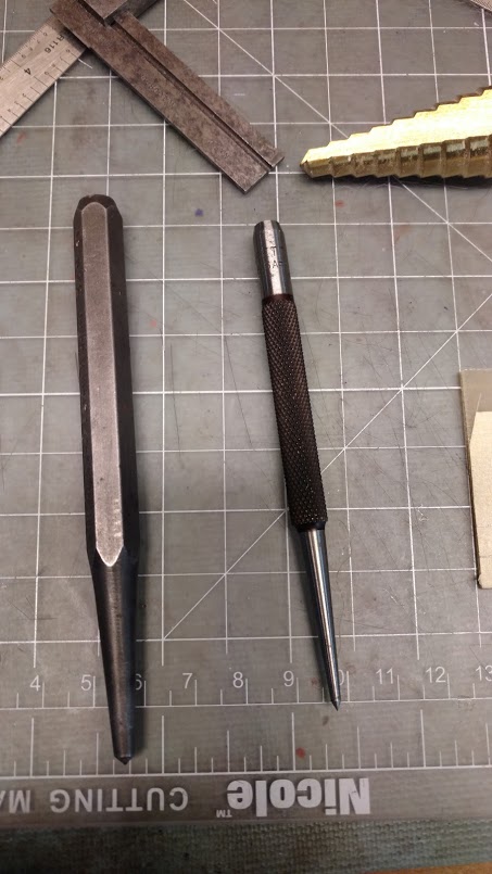

some tools used, uni-bit is great for thin material and large holes, I decided I wanted a large radii on the brace for strength. two step punches, one is very fine for easy location of center (you can get down to .005" accuracy pretty easily) followed by the big dumb punch to give you a solid target for your pilot drill.

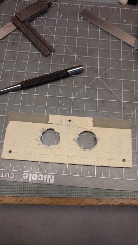

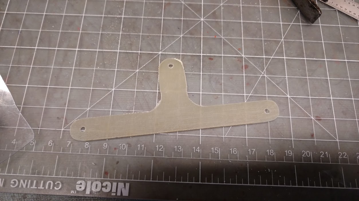

part drilled, and drop cuts done on my band saw (converted porta band to a vertical layout). Rough cleanup with disc/belt sander, with rough radii cut on ends.

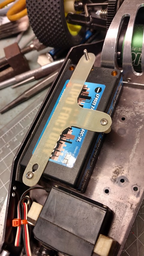

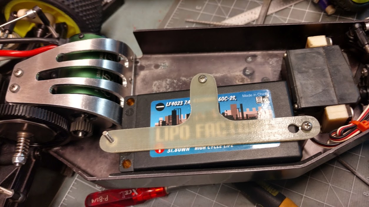

check fit. added small plastic stop, mounted with 1" hex standoffs, and decided on a keyhole mount in the front due to very close body clearance in this location, with a thumb nut to be added when I make it. brace was cleaned up with a file on the edges and radii to smooth out the bit of kerf leftover after disc sanding and sawing.
- NomadRacer
- Posts: 1467
- Has thanked: 81 times
- Been thanked: 79 times
Great tutorial on your battery brace. I can see it helping some one out that needs to do it but doesn't no how to get started.
