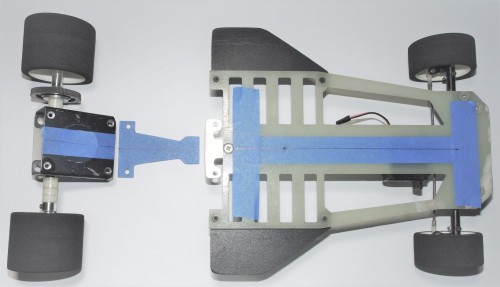

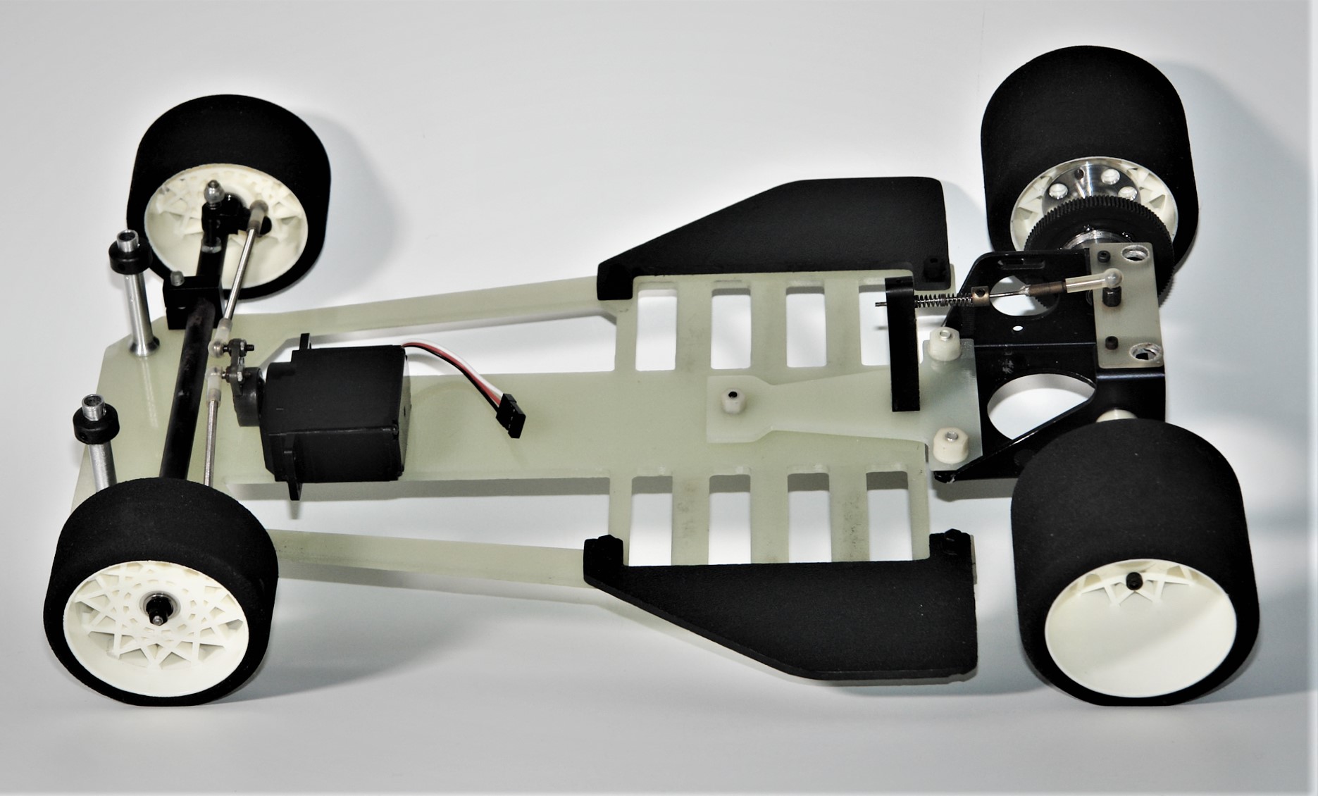

Few more items knocked the list
First I found the centerline before drilling any holes that would align the rear pod.
T-plate, still needs "tweek screws" and maybe a little more trimming.
For now, just because I have them, O-rings under the T-plate.
Rear tires turned and trued
New diff rings and diff balls
Bearings fully cleaned and oiled
Still needs
Thrust bearing. It's OK but not buttery smooth
The brace on the top of the motor pod could be replaced
A new body. Probably like the F40 that it originally had on it.
Chuck

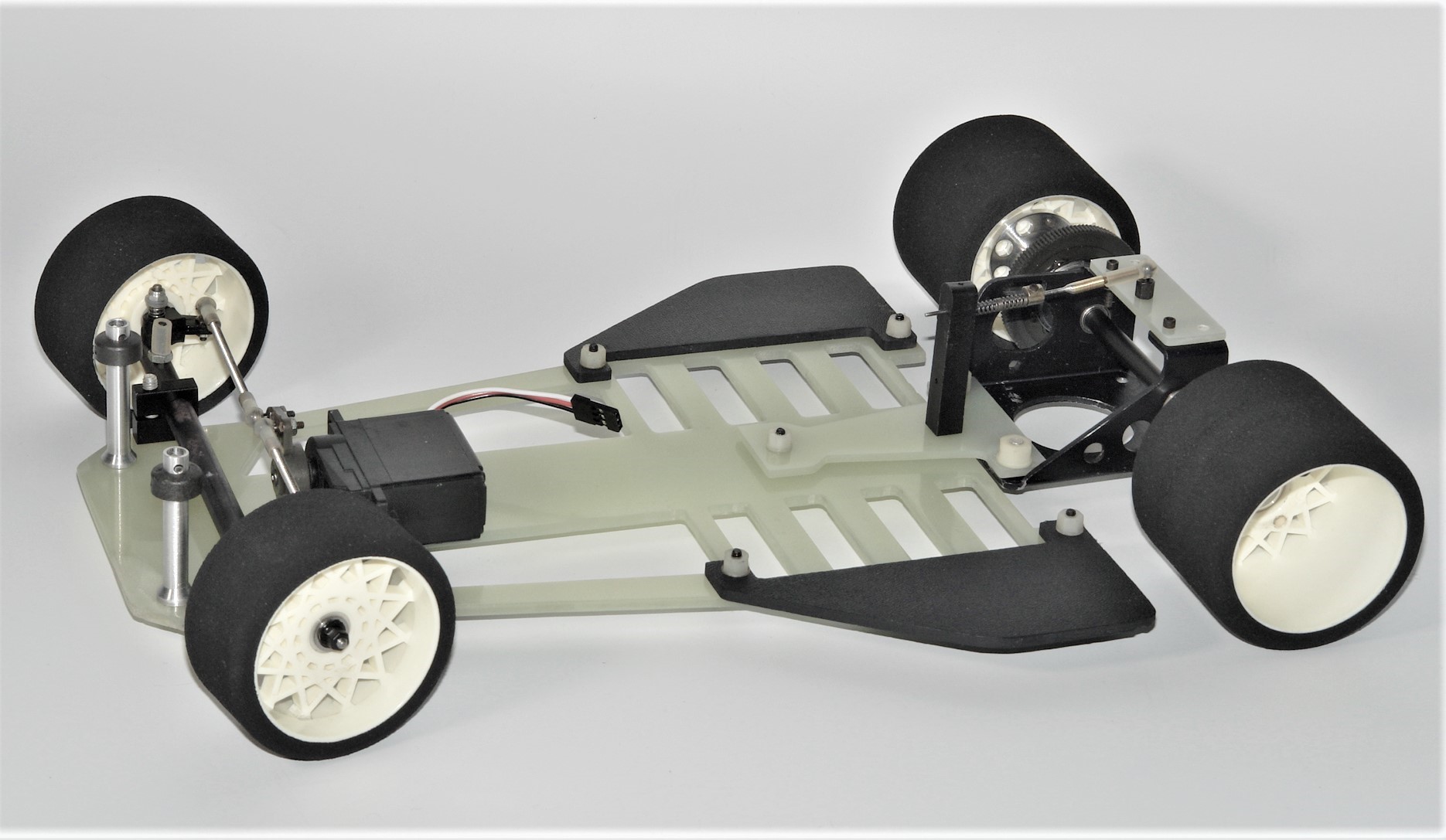

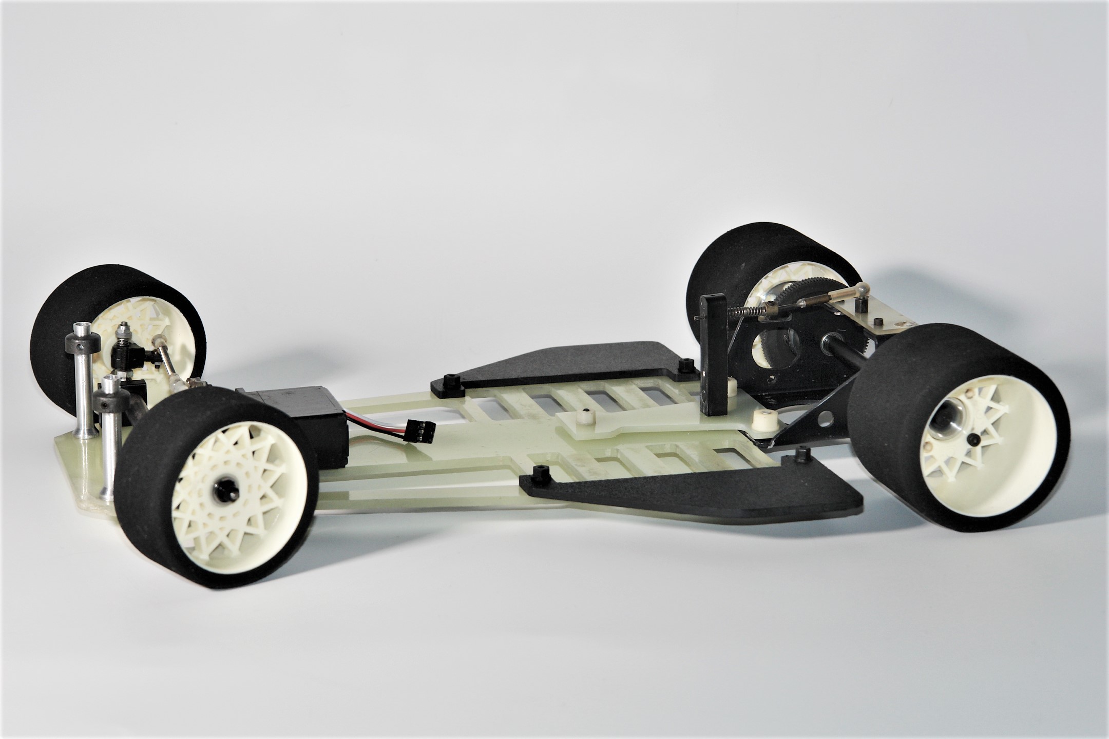

Incremental but better
Lightly sanded and polished the chassis, got rid of 80% of the scratches
Cleaned and blackened all the steel screws
Cleaned and put the original white plastic nuts on that hold the wings
New G10 plate/ballstud mount on motor pod
Cleaned and resoldered the upper T-plate to motor pod thingy
Chuck
