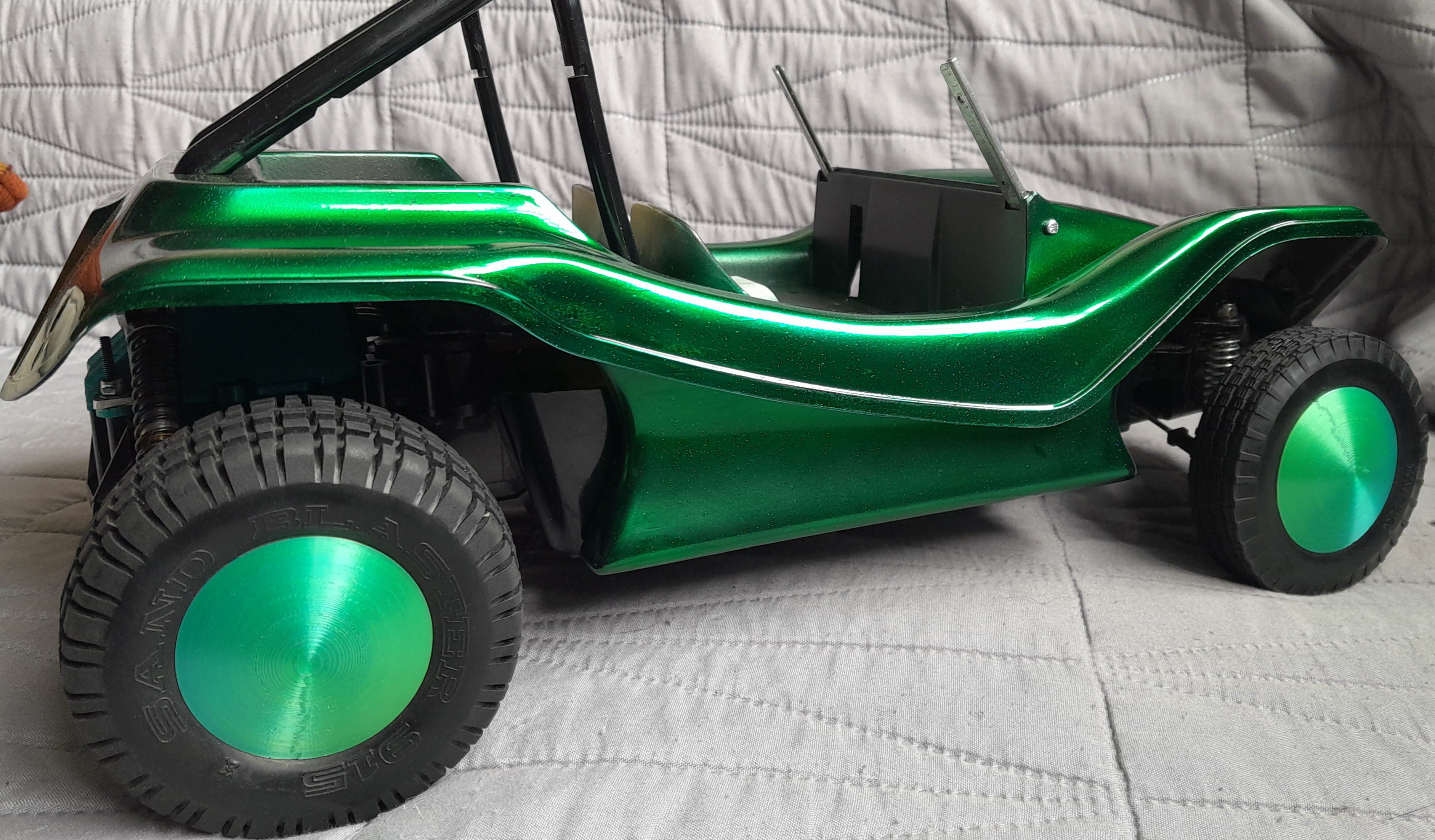

Your just not going to see this how it is in real life , black chrome , holographic flake topped by candy green .

Replaced the printed shock tower with an aluminium one, bolts replace the self tapping screws , the holes go right through the chassis and are used to hold the bottom gear cover on so the bolts now do both jobs and won't strip out the threads in the plastic . I'll shorten the bolts later.

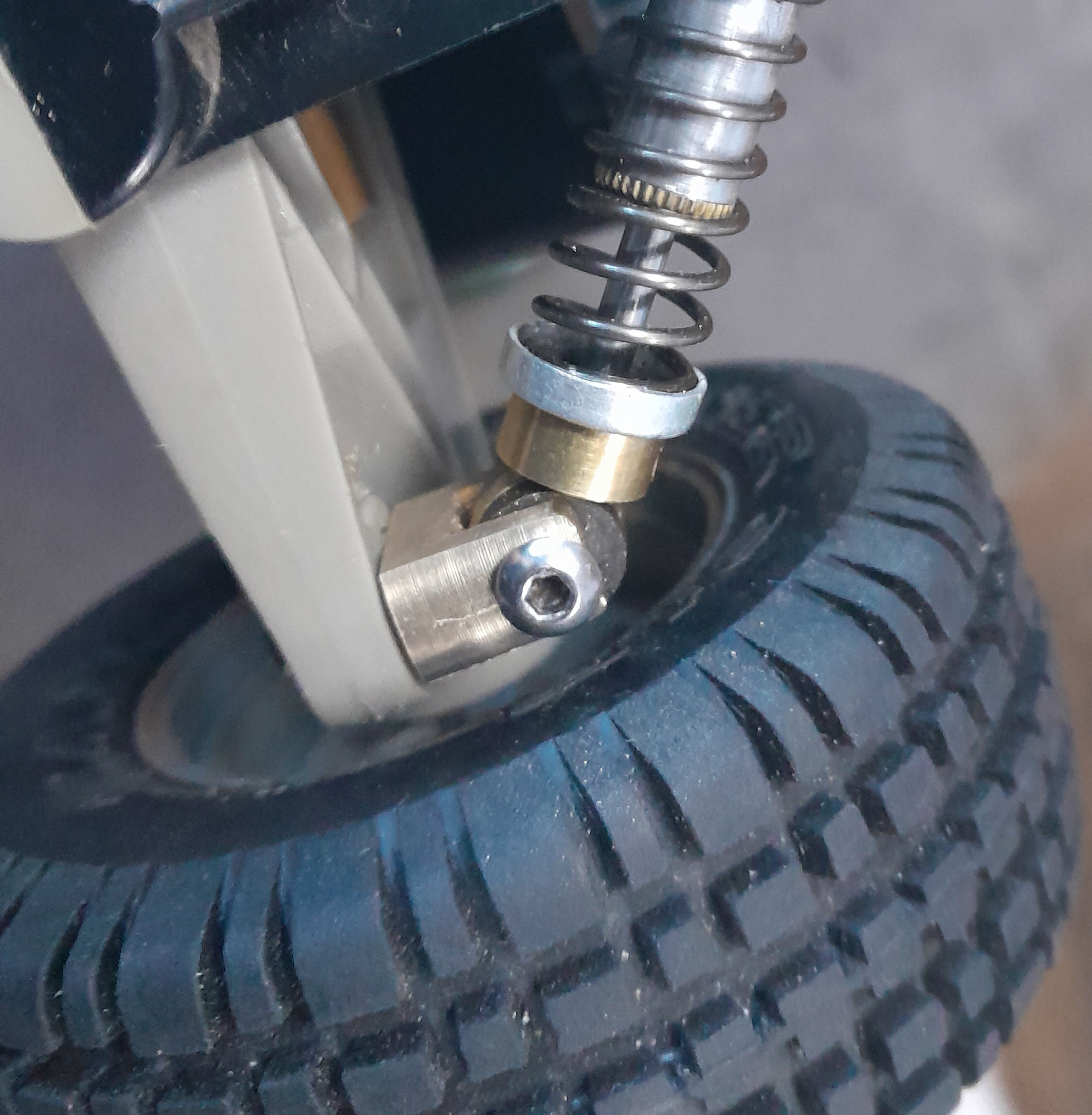

Machined up some bottom shock mounts out of brass , thought it would suit the shocks , should have been a quick job but I ended up doing a full service on my lath/mill combi machine before I started.

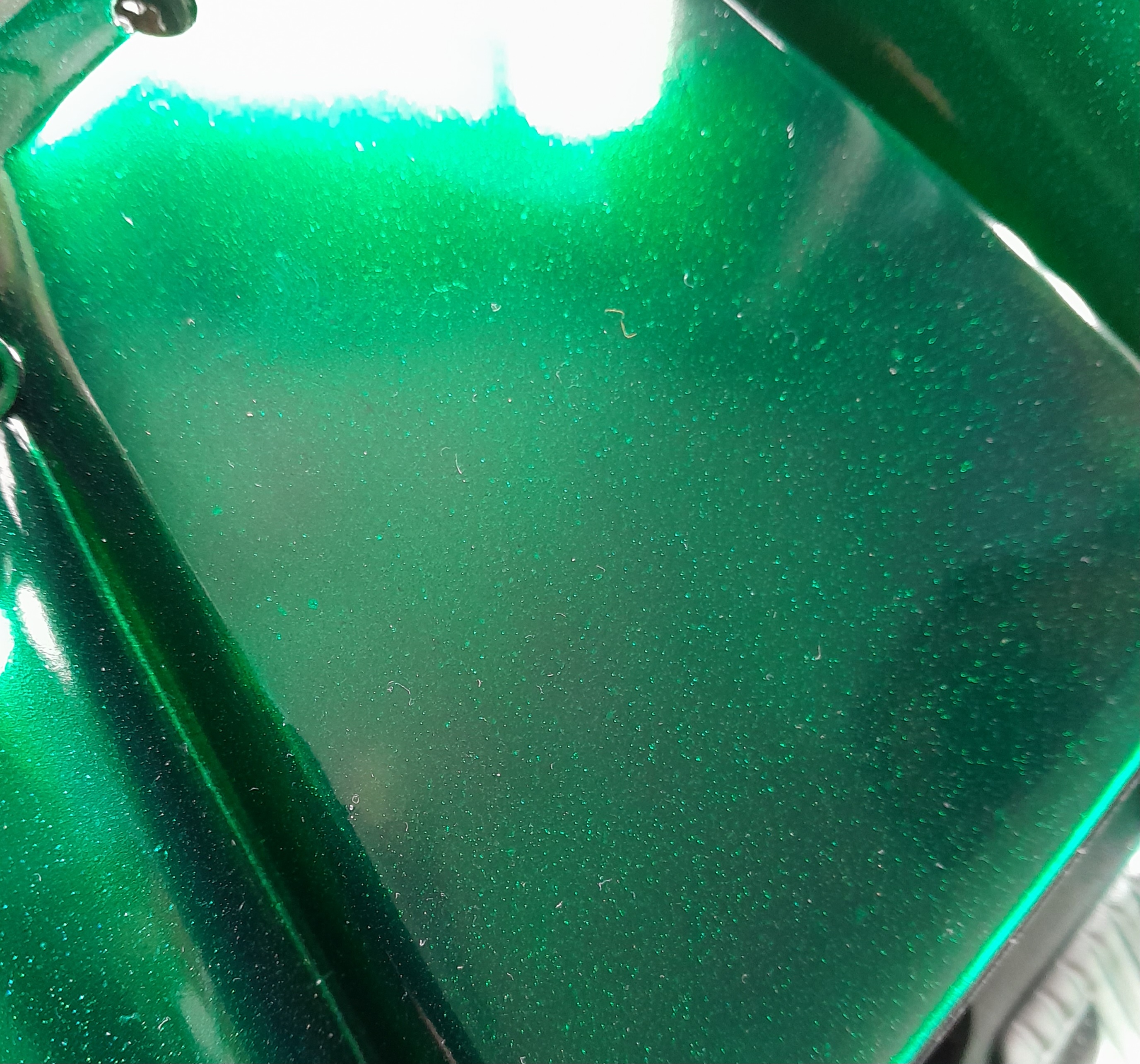

Re: Sand Rover, Tamiya's unlovable child

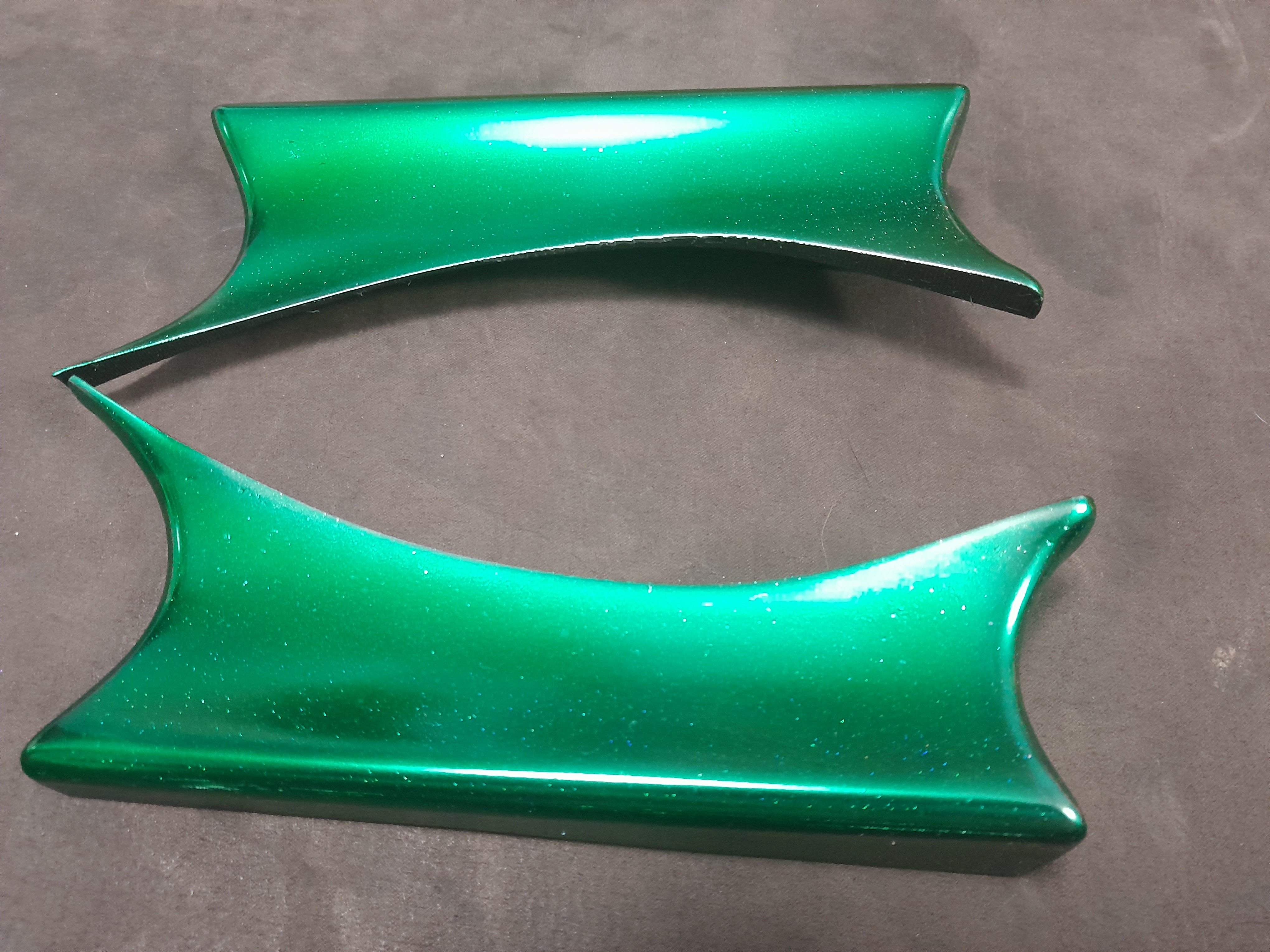

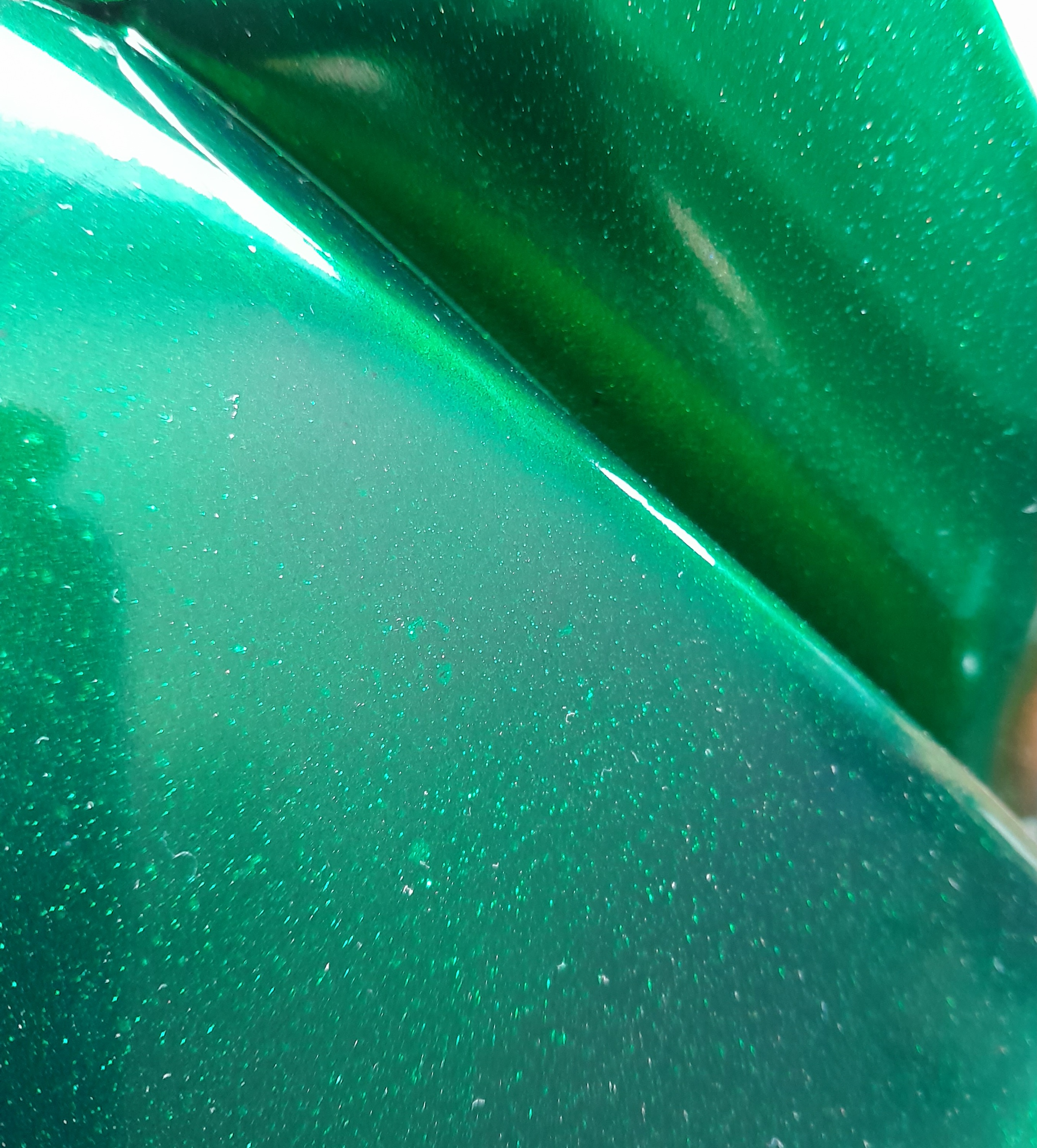

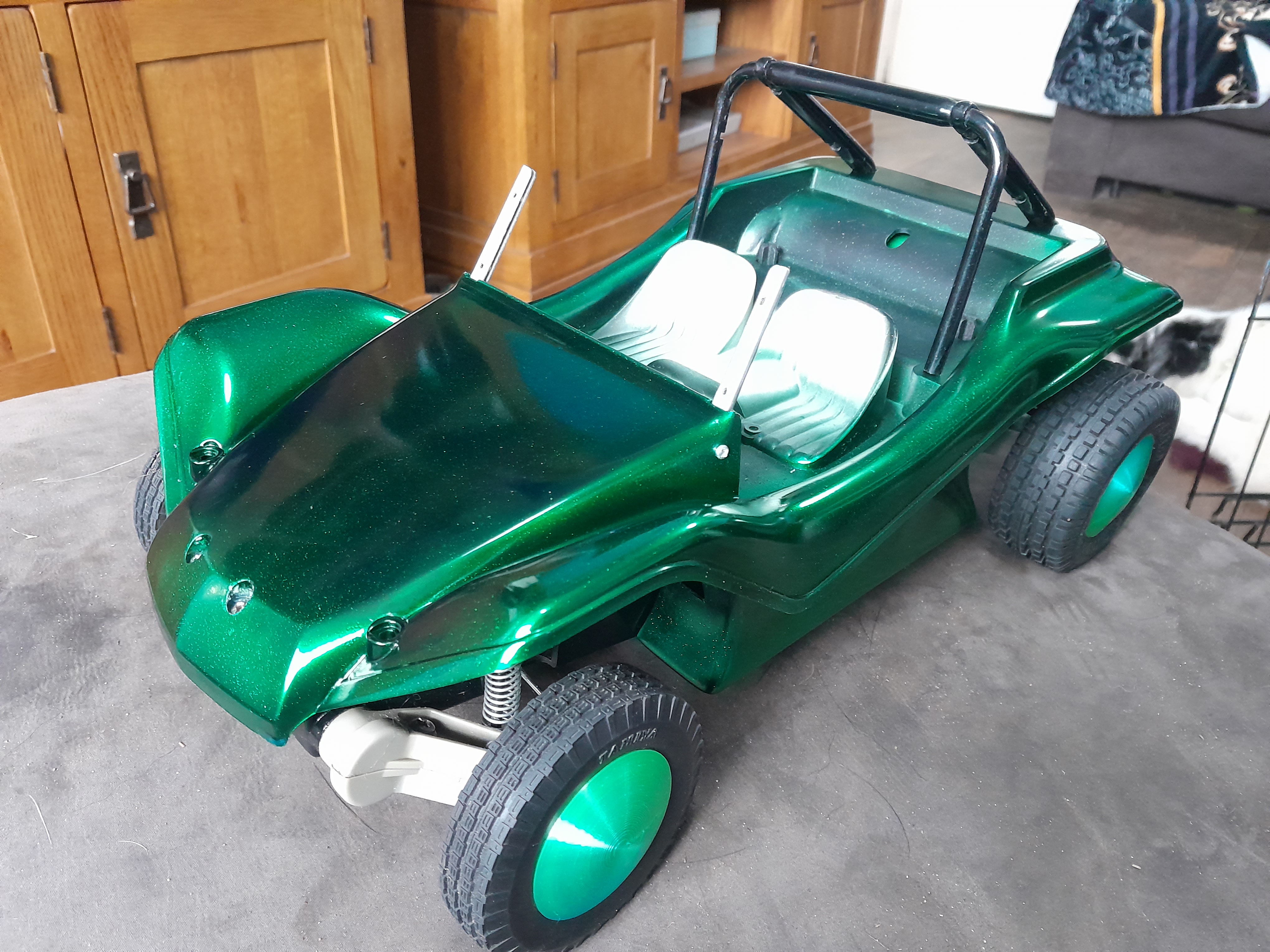

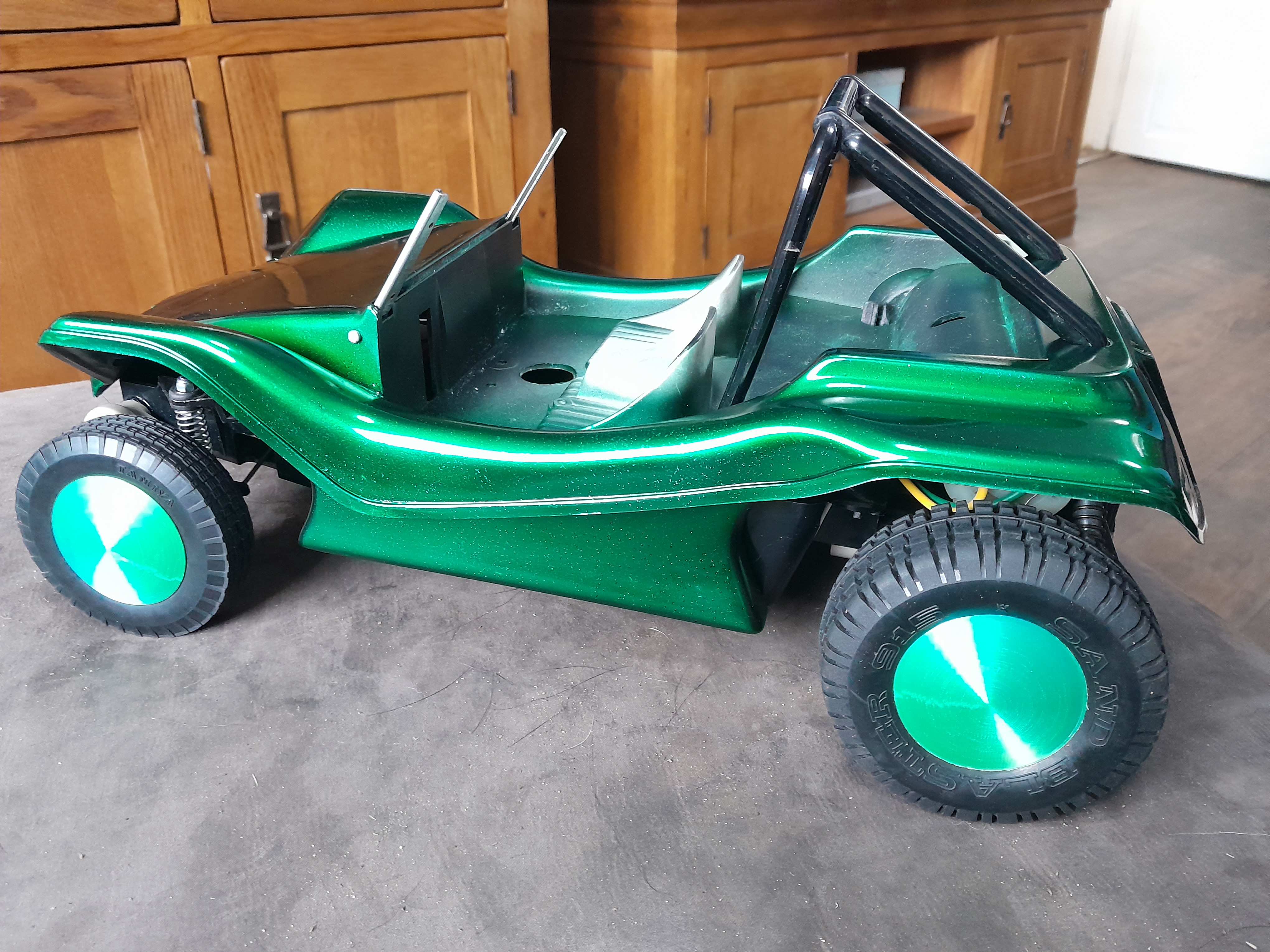

Paint is getting there, you just can't see the holographic metal flake in pictures.

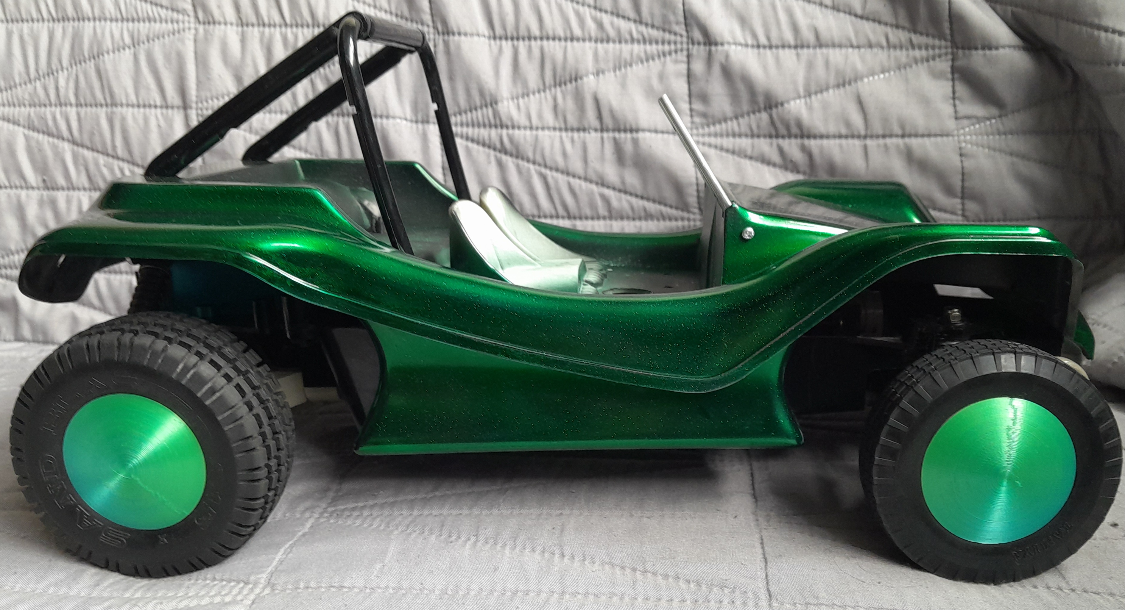

Few more shots.

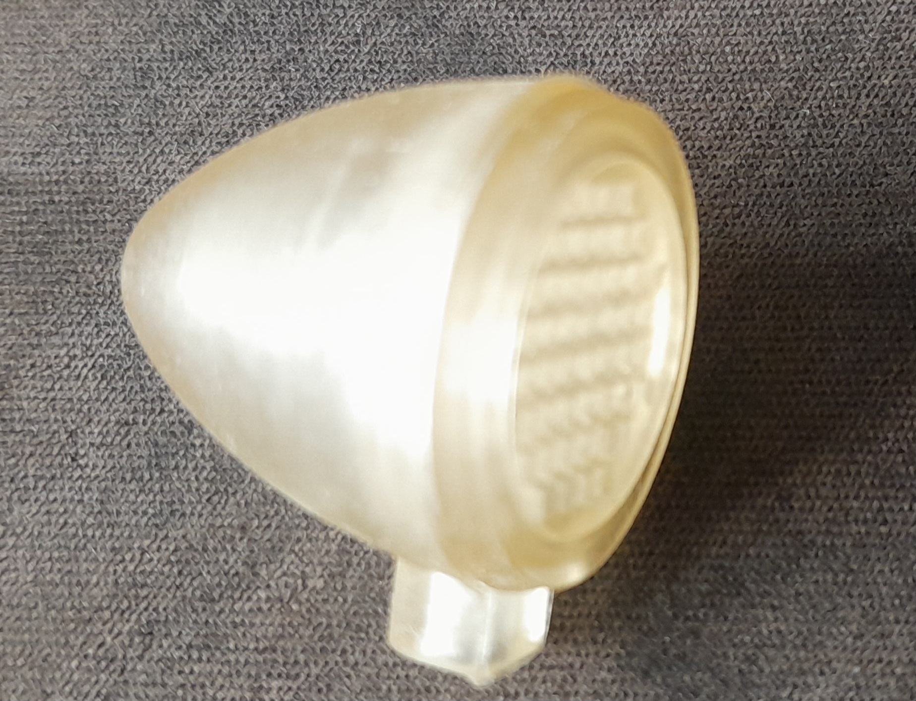

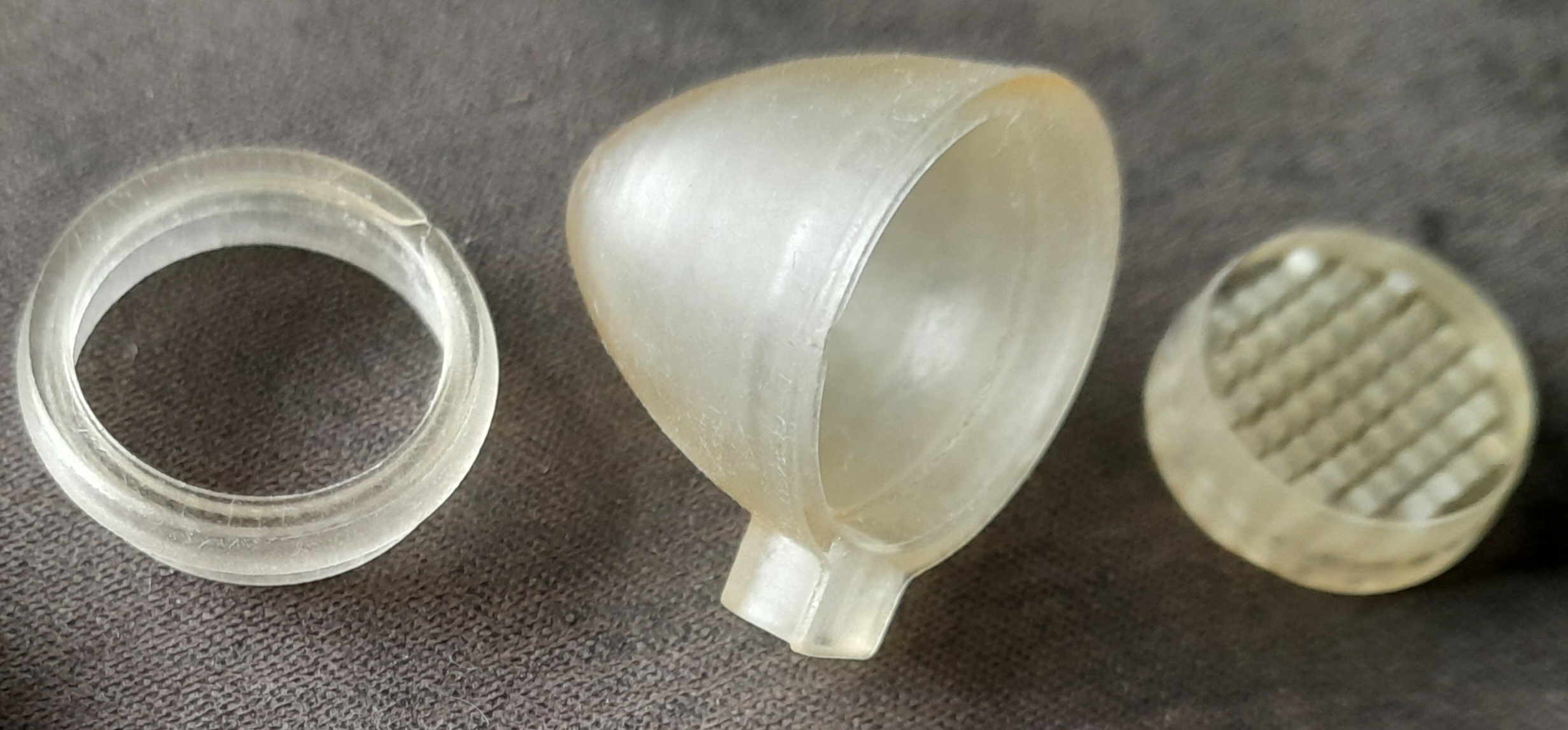

Headlights , in 3 pieces and ready for LEDs

I love leds on rc cars... I find it more realist and it's nice to finish a car this way...

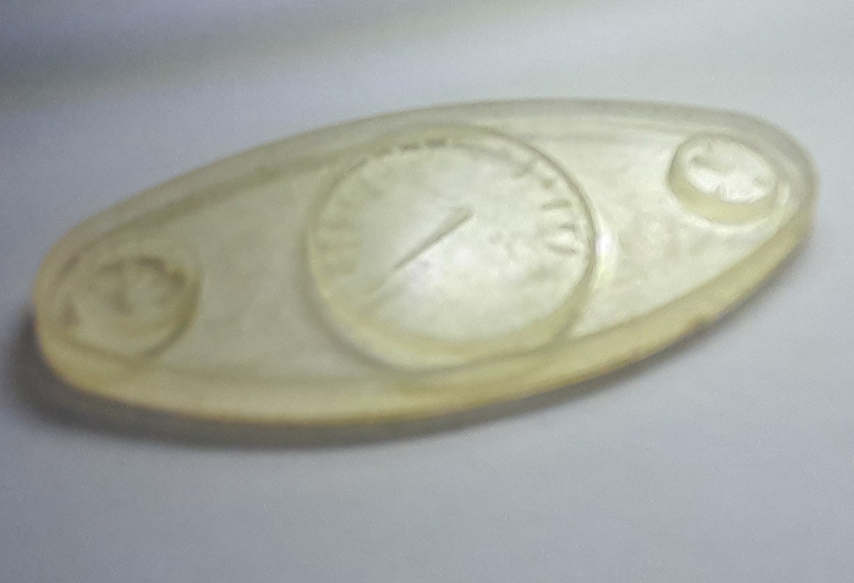

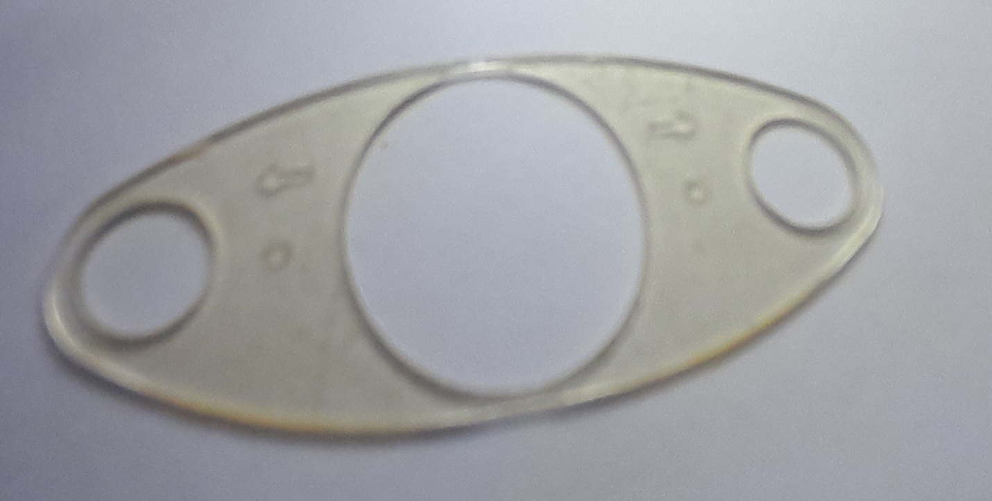

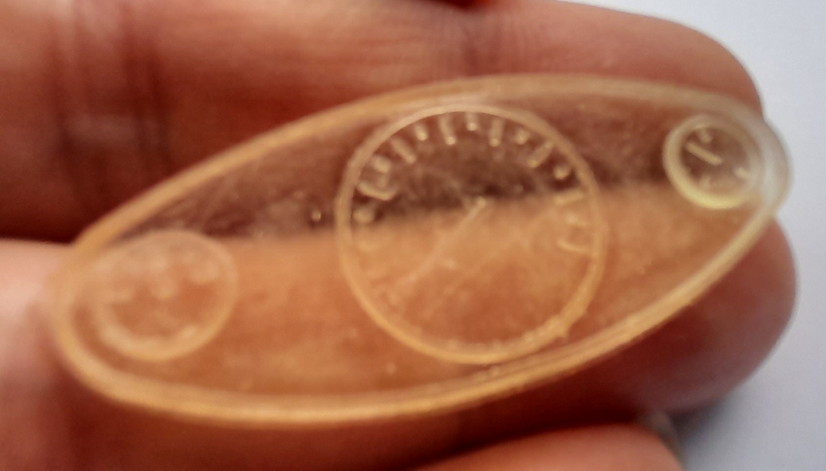

Dash board , incredibly difficult to photograph and I made it I two pieces which may have been a mistake as the facia is Incredibly thin , I thought it might have been easier to paint with my fat fingers but I will probably have to make it one piece .

I can see where you are heading to
. Enligthed dashboard is going to be super nice
- Posts: 4069
- Location: Guildford UK
- Has thanked: 2759 times
- Been thanked: 2250 times
Yup , I have several colours of translucent paint I'm going to paint behind for indicators , ignition light , dials etc then just a single light sorce .silvertriple wrote: ↑Mon May 08, 2023 11:31 am I can see where you are heading to. Enligthed dashboard is going to be super nice
