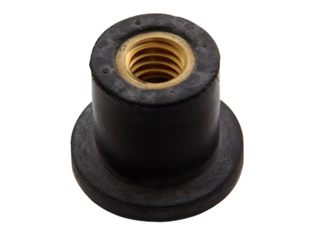

Went to finalize the battery box by attaching it to the chassis, as it's listed in Step 19, and then Step 9:
The problem is the (1) 3x18mm screw is too short to reach the well nut, in the rear position of the battery box, unless I turn the well nut upside down, or pointed end down.
I searched to see if anyone else mentioned this problem, and apparently I'm the only one.
Parts listed in manual Step 19 and Step 9.
The nut inside the 'well' doesn't thread until the screw is this far in, there's no way I can get the threaded portion to bite, while forcing it through the battery box.
This is making the correct installation not possible for me. Anyone know of this problem, or a solution besides installing the well nut upside down?
Thanks!
Posts: 12214
Has thanked: 1084 times
Been thanked: 3762 times
Re: Tamiya Sand Scorcher - 2010 Reissue
Something ain't right about that wellnut. The threaded portion should be at the small end, and it draws that towards the thick end. Is your front one the same? The screw length hasn't changed since the original kit.
Posts: 12214
Edit- going by your wording, I think your doing it wrong. A wellnut is attached to the screw first, then the radio box is slid over it, then you tighten the screw to draw the wellnut tight. It doesn't go "through" the radio box.
