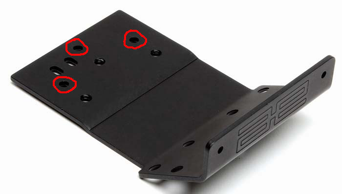

I'm posting this question in this thread, as it might concern other people as well.
I finally got hold of a black nose plate that was not cut, so that it could be used in the long configuration required by the Ten4. To my surprise the holes for the long position (marked with red) were not threaded. And as I'm totally lost with the imperial screw size system, could someone please tell me what size of tap I need to thread the holes? A direct ebay link would be nice
Thanks
Tom
Thanks
Tom

Re: Ten4: the 4WD RC10 project
ive seen some tapped and some not
one example...
http://www.ebay.com/itm/New-8-32-HSS-Right-hand-Tap-8-32-TPI-/400876830769?hash=item5d561f0031
one example...
On my gold pan prototype car I had to tap them... I had never really looked to see if they were tapped before I went to put it together.
