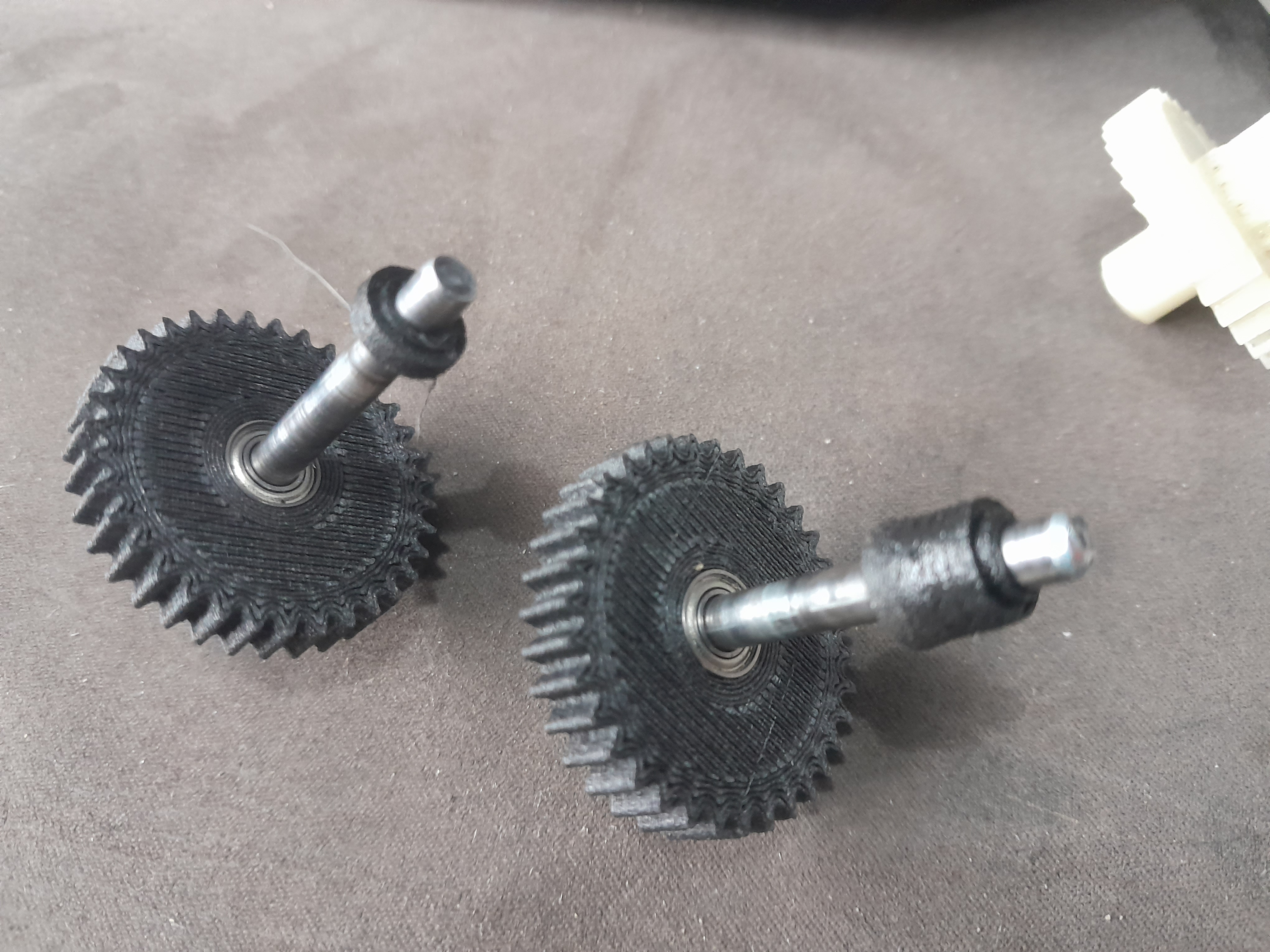

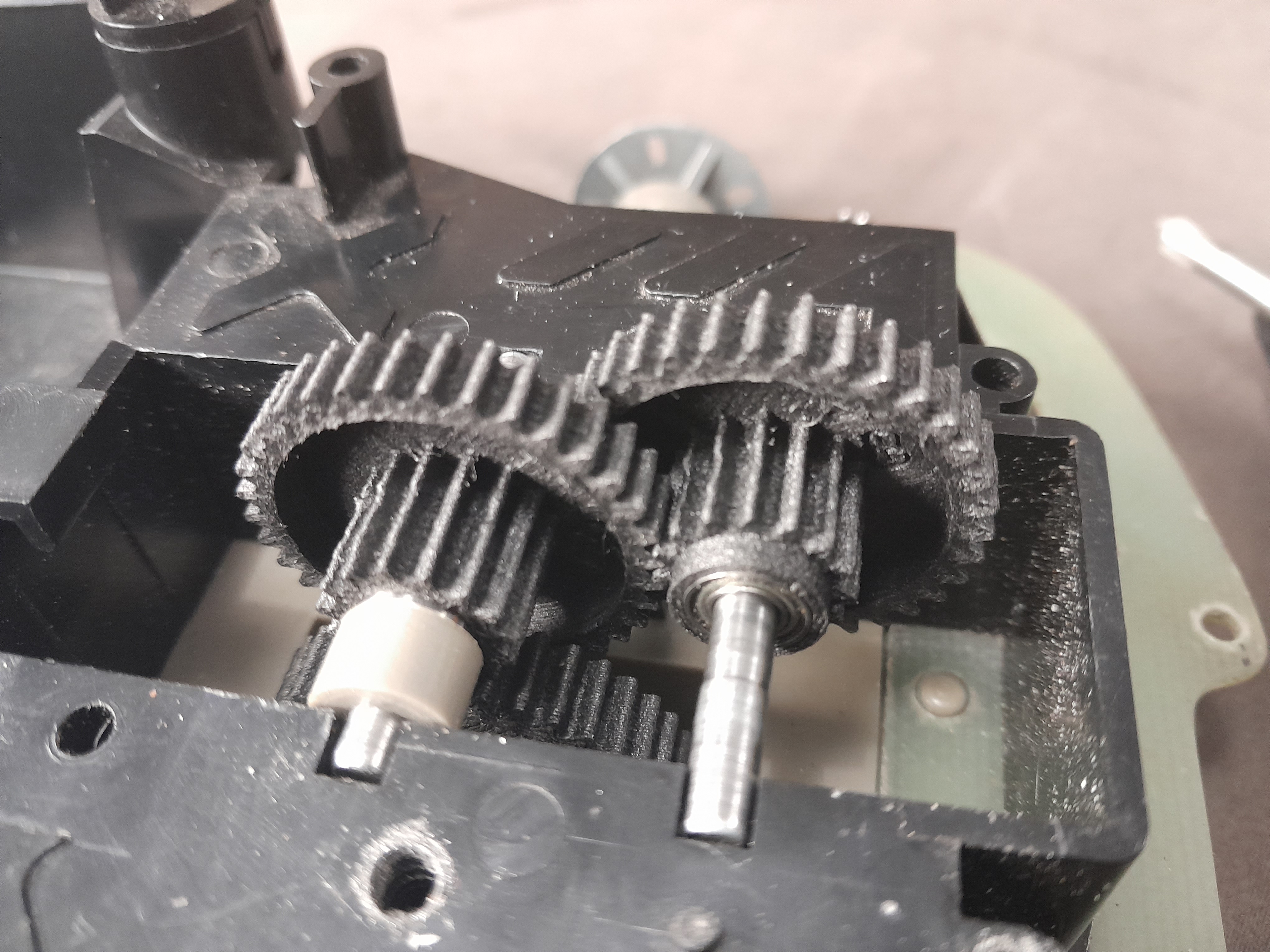

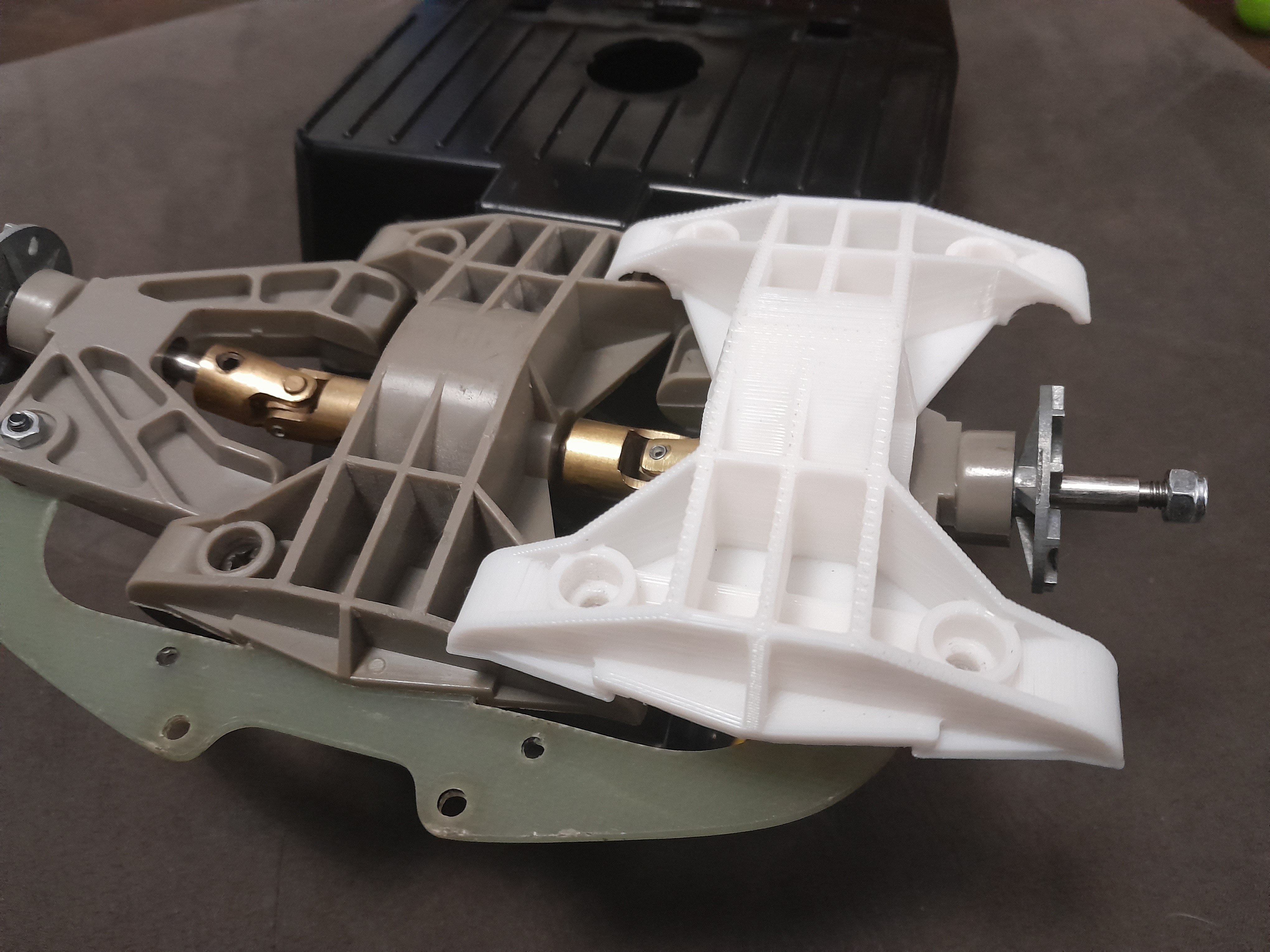

Remodelled the Holiday Buggy gears to fit 8x4x3 bearings , stock they just run naked on the 4mm shaft without even bushings , both gears now need a spacer as well now , I'll get a set pro printed next month to check the model then add them to my shop .

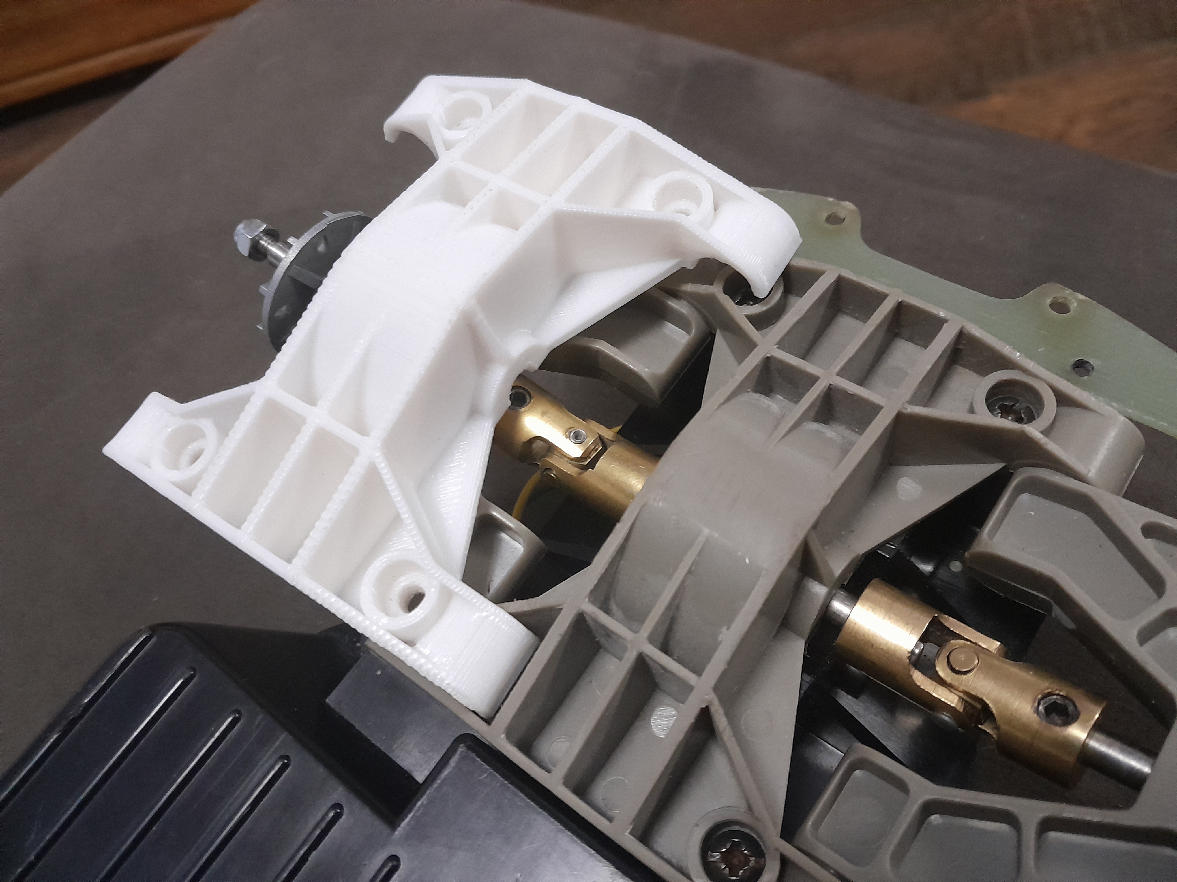

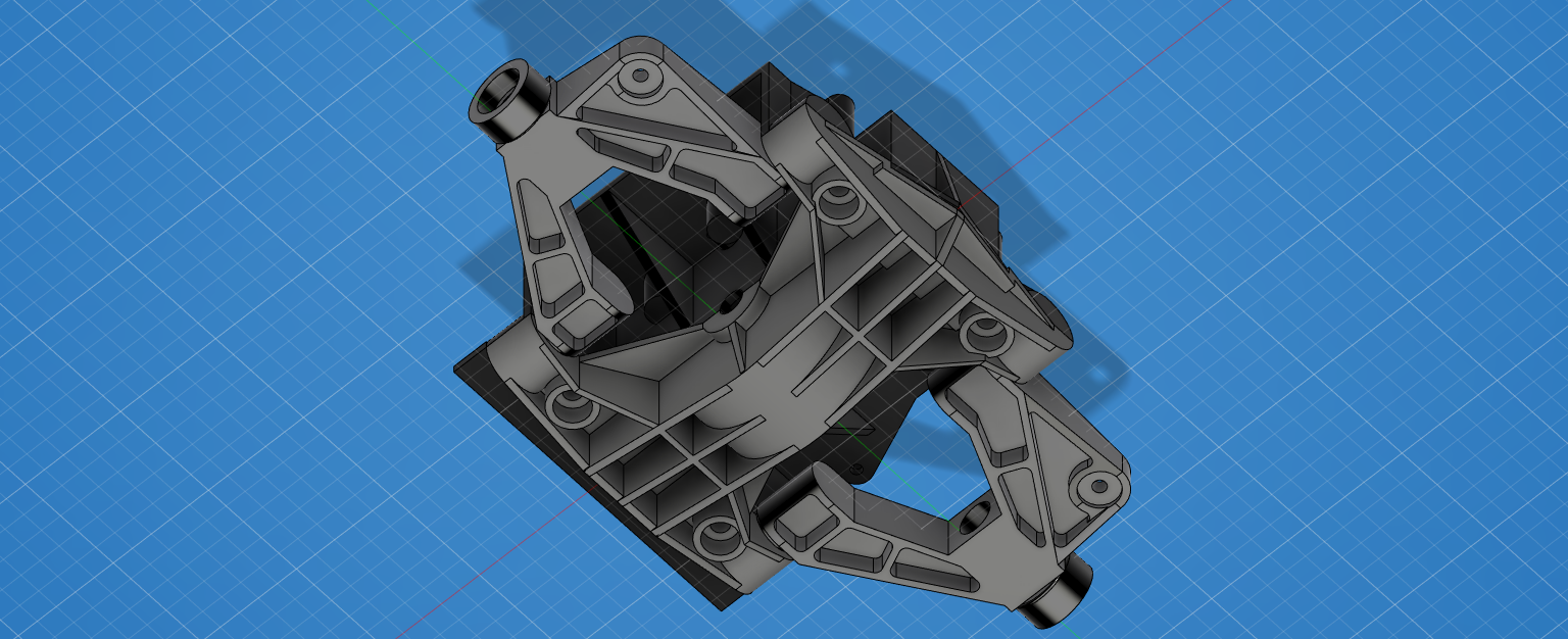

Another Holiday Buggy / Sand Rover part , this time the lower gearbox and suspension mount , fits perfectly .

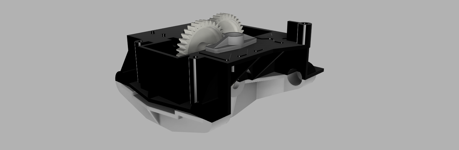

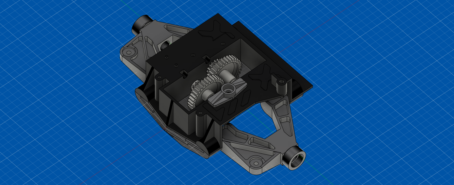

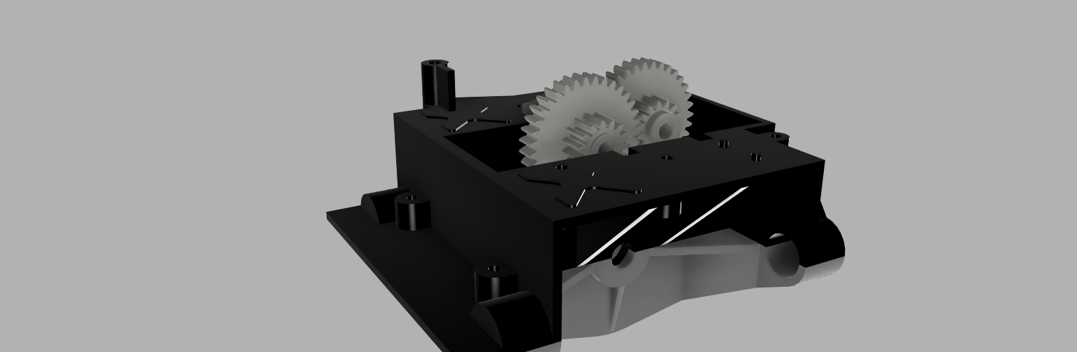

Full Holiday Buggy gearbox and gears , tried a render , needs better lighting .

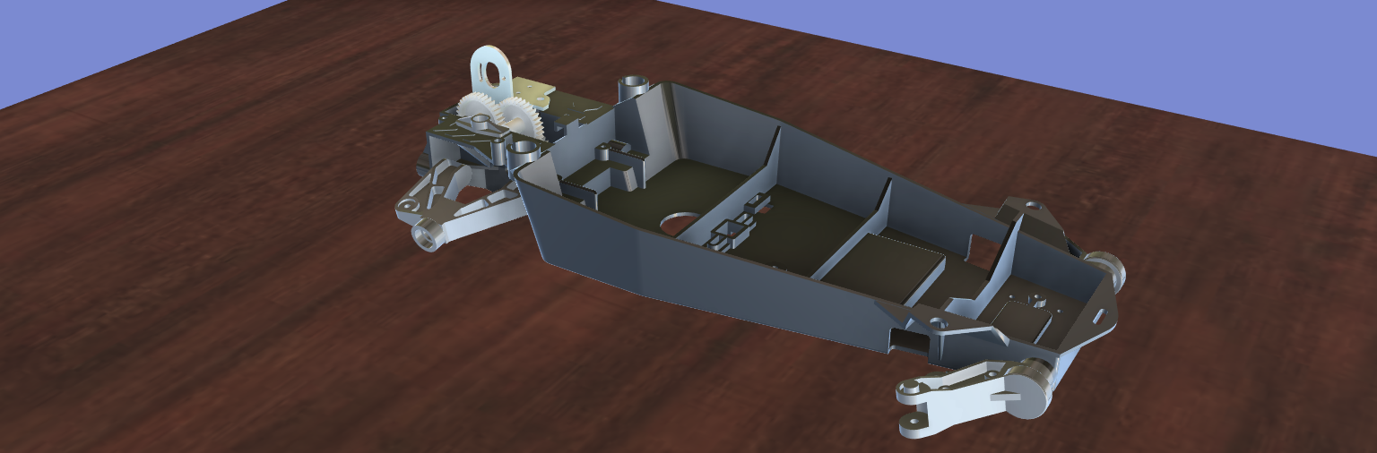

No Tamiya already did a re-chassis although I may do some mods to have oil shocks , this mostly started to be able to supply replacement gears so people could get them going again , I'll design a gear cover as well as the lack of a closed gearbox was the cause of needing gears :roll: , not really sure why I'm modelling other parts as this is probably the least loved of all Tamiya cars , it takes a few minutes to find any reference to the old version even on TamiyaClub Forum :lol: anyway I just finished the rear arm model , its not handed so I didn't even have to mirror it .

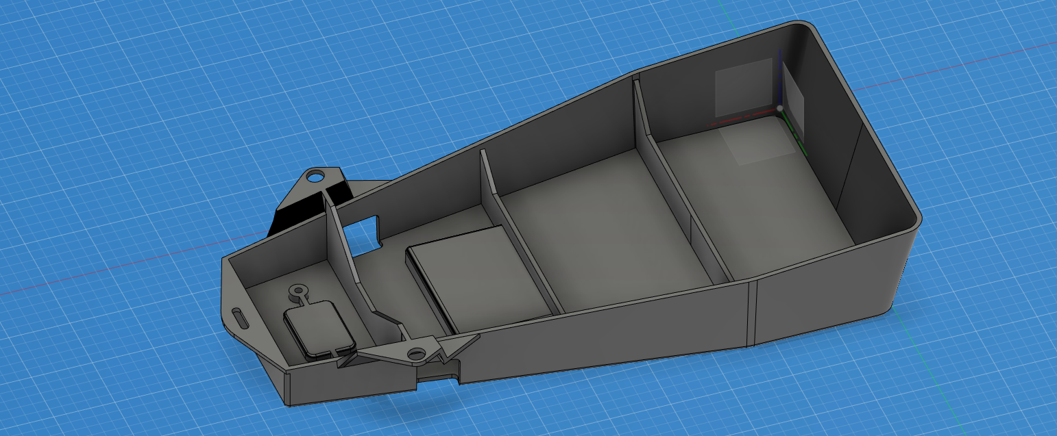

A little more Holiday Buggy .

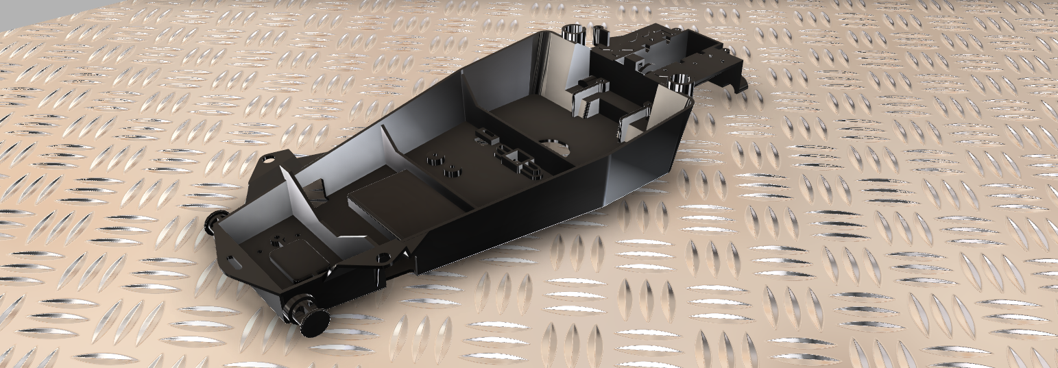

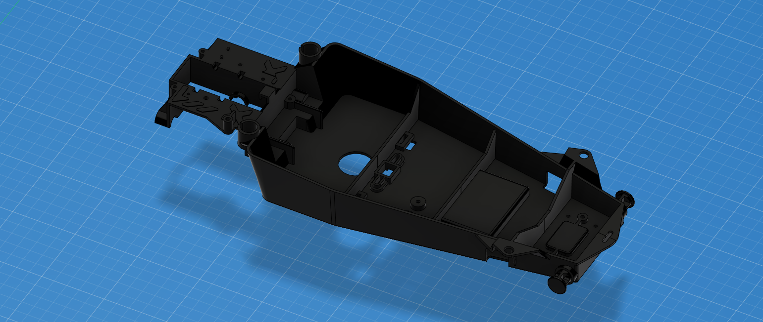

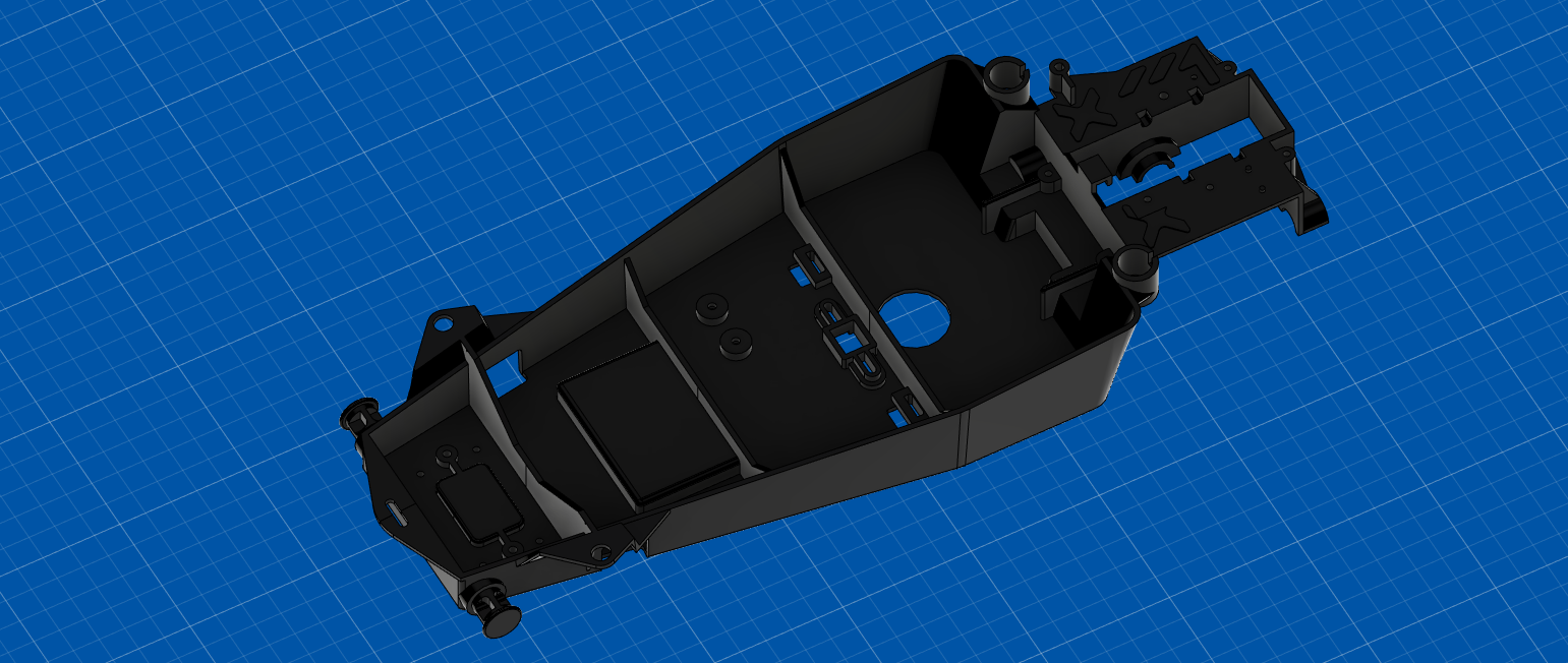

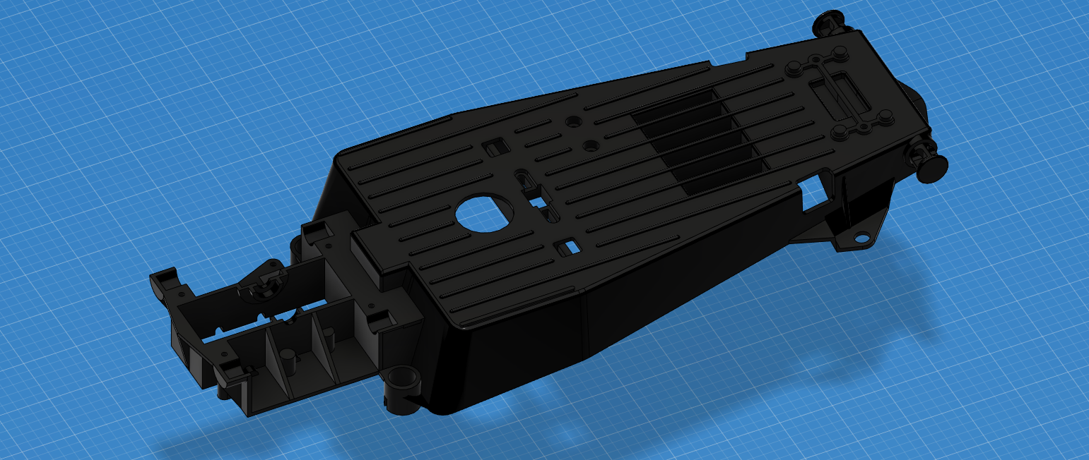

Done
