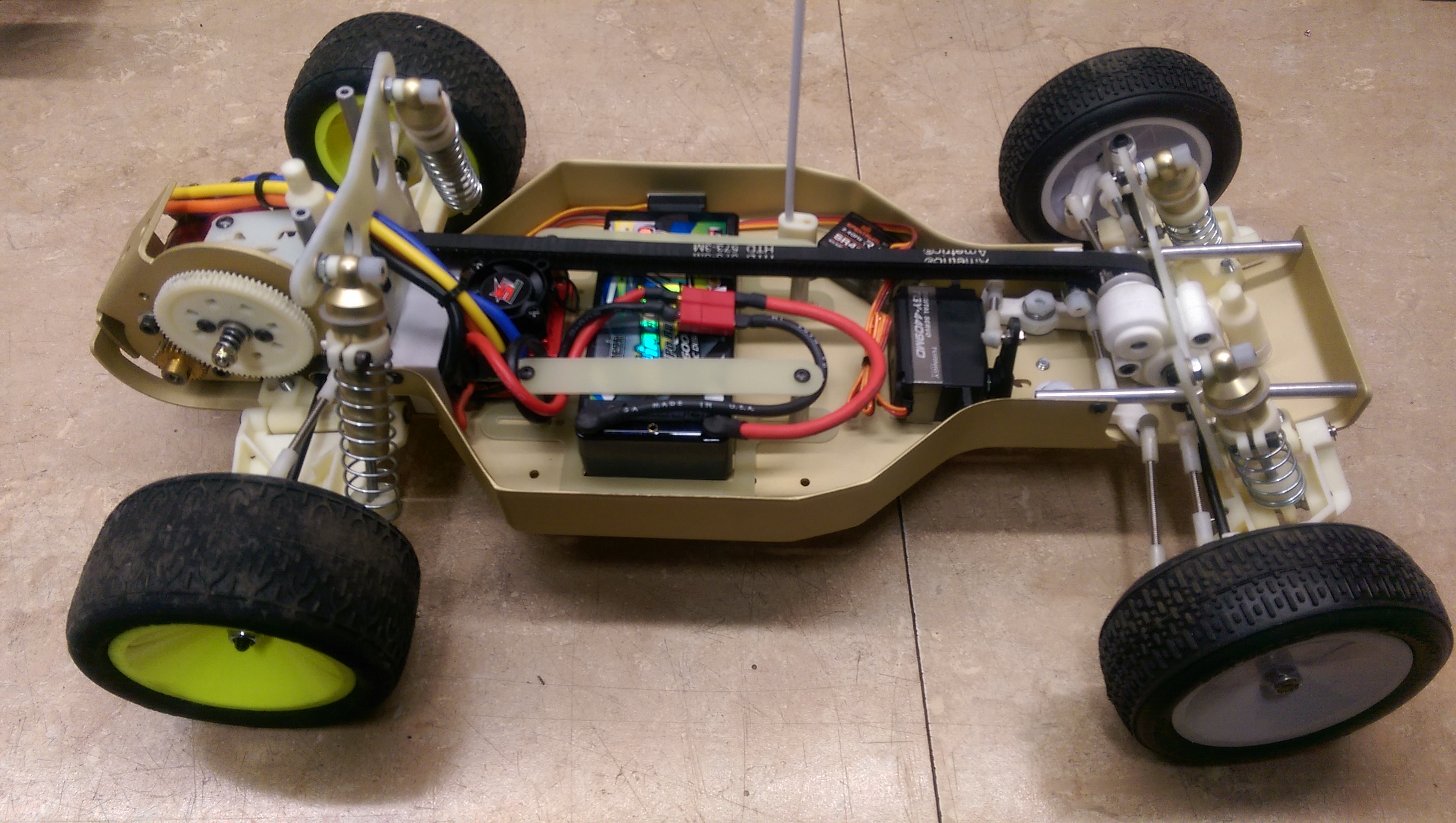

Just double sided tape, the mounts were just left onwydraz wrote:Jeff I'm liking the lipo trays, may need to get me some
How is the servo mounted in that orientation? Did you need to drill? I might just be slack and use servo tape

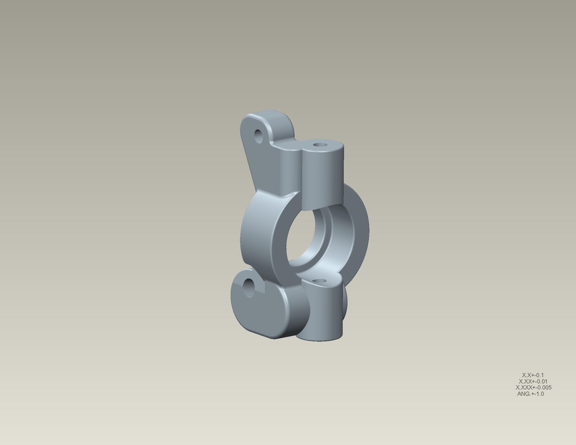

Well guys, unfortunately the caster blocks need some more reinforcement
I didn't really add much at all to them, and apparently it wasnt nearly enough. Now I'm going to add the maximum amount of material space will allow, which i think will do the trick.
I did manage a lap, the car felt pretty good. I took out the caster block on the same big jump i broke both caster blocks and steering blocks last time. I think the new steering blocks are pretty bullet proof now.

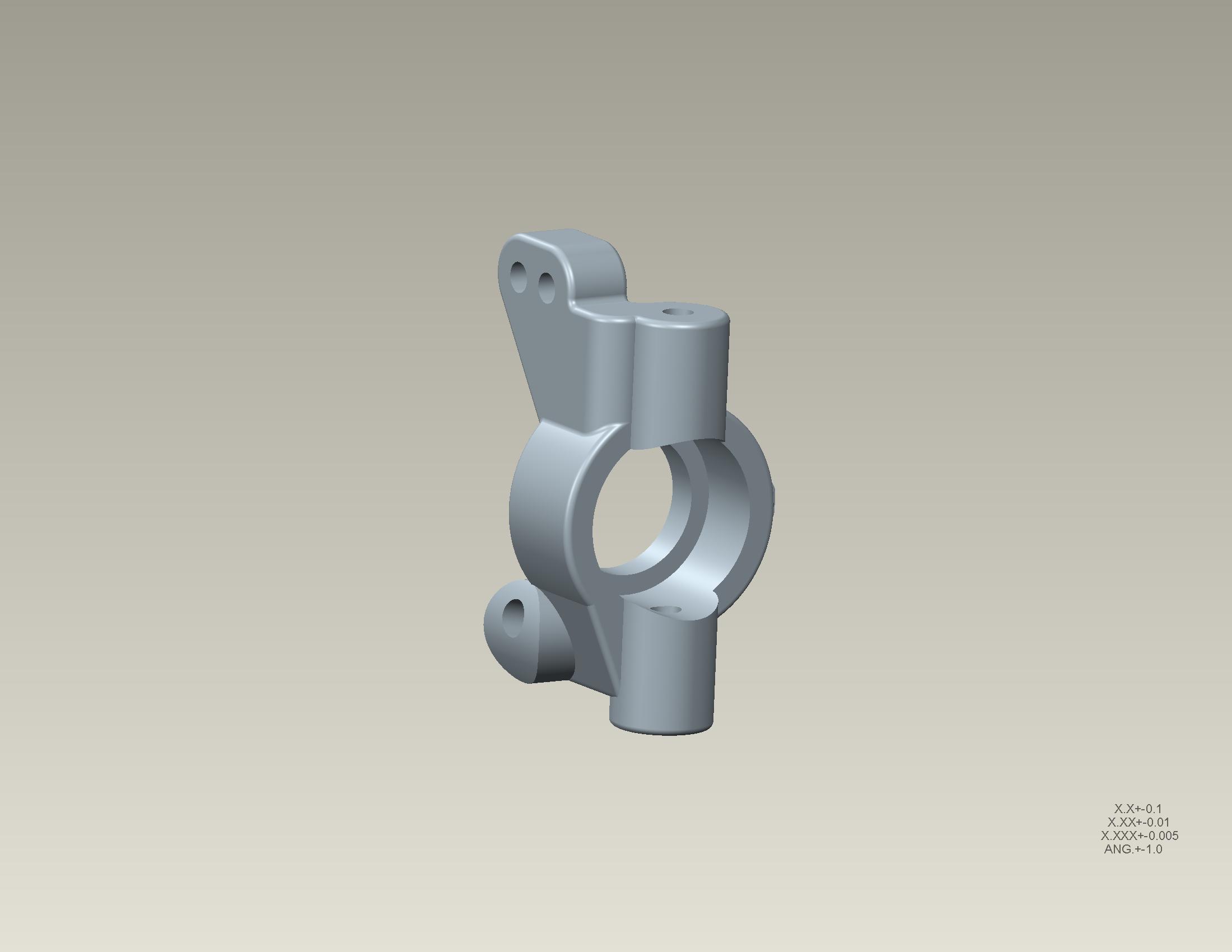

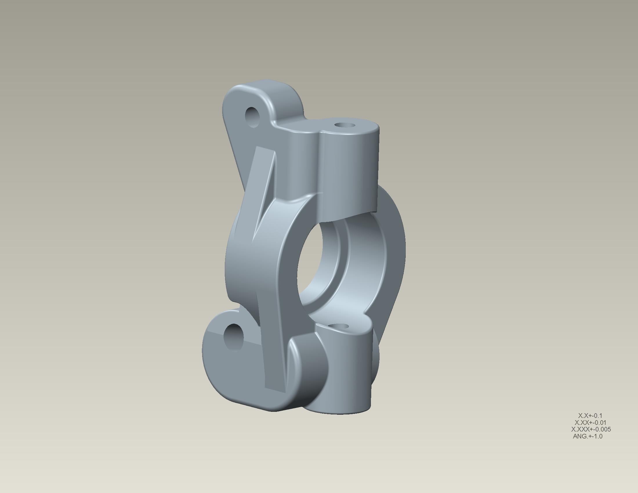

Alright, so I've redesigned the caster blocks and added a LOT more material in the areas they broke and extended the hinge pin boss to support the round portion where they have broken, as well as made some other changes to make them stronger. Maybe the 3rd try is a charm, lets hope so!
Old New
Old New

There, I added some 1/8" thick gussets to further support the area that broke between the round body part and the hinge pin boss, and one to support the camber link boss, just to be safe. I'm a man on a mission now, I'm tired of f'ing with this thing

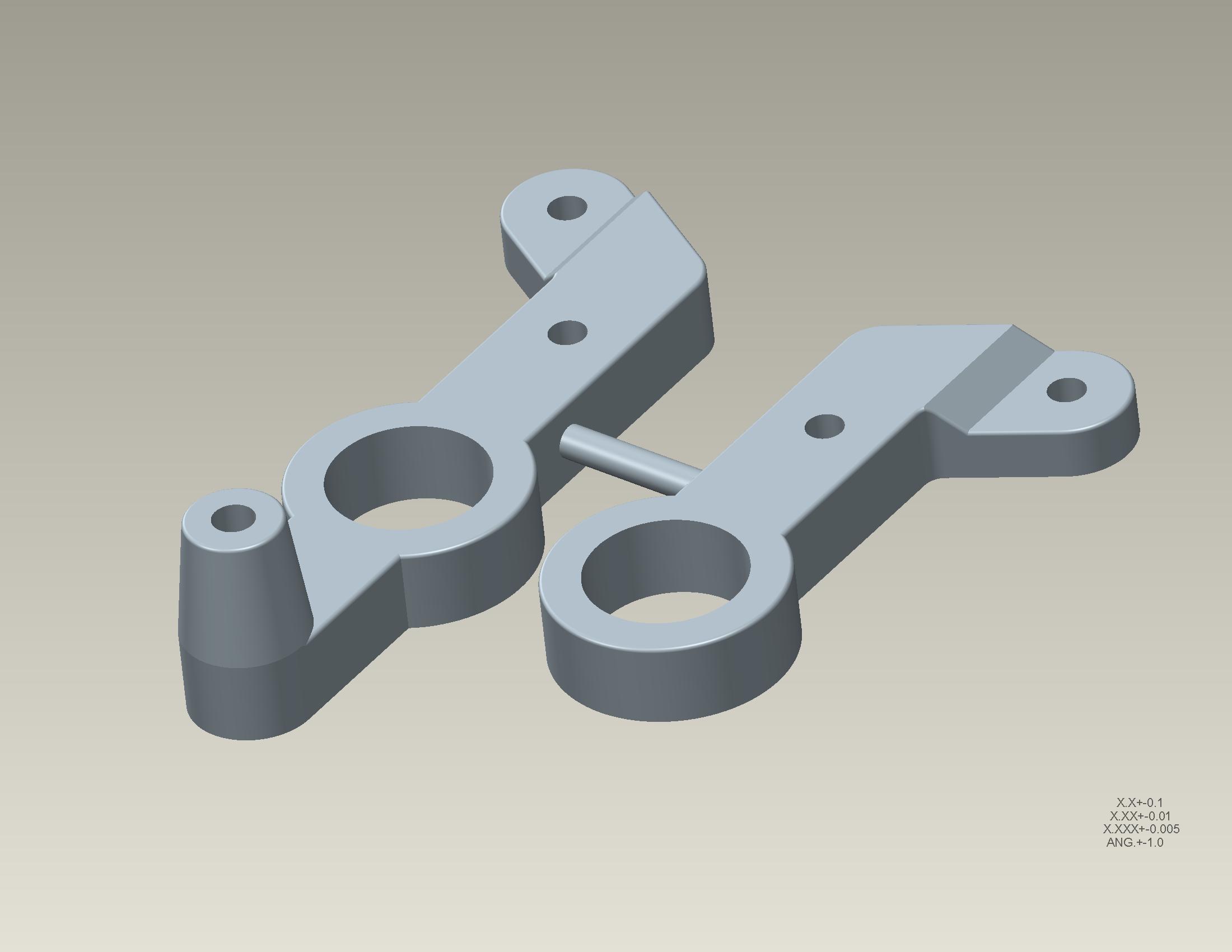

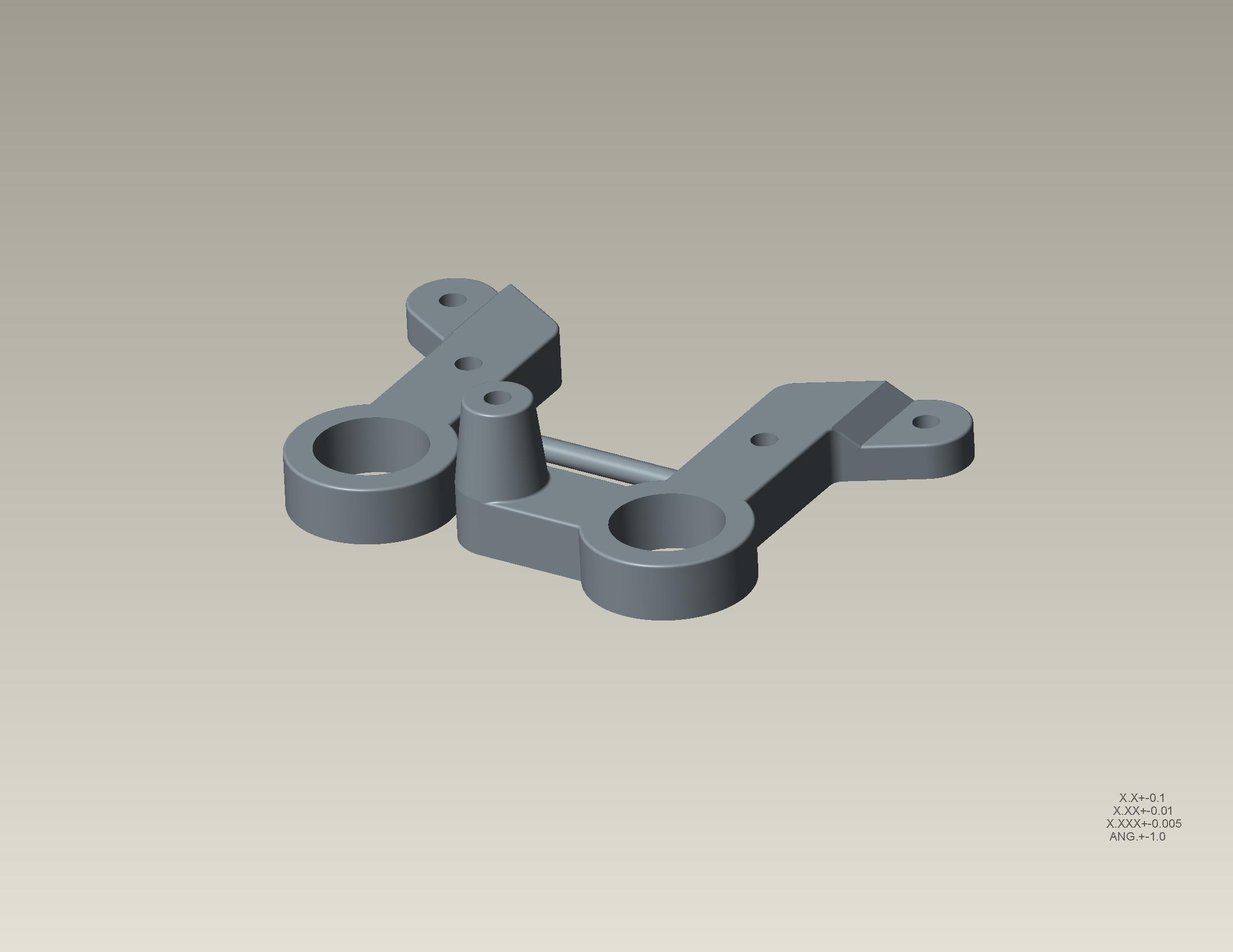

Here are some new steering options. Mounting the steering servo in the stock location results in a very *slight* rubbing between the servo horn and the bottom of the belt. In my testing so far this causes no issue at all. But in case that sort of thing bothers you, here are two more choices.
The first is an in-line steering set up. Jeff has been using this on his short arm Ten4 prototype car and it works well. You will need to either drill new servo mounting holes in your chassis or use servo tape to mount the servo: The second option has the servo link on the right-hand bell crank and therefore moves the servo horn to the right side of the car, away from the belt. As with the above option, you will need to either drill new servo mounting holes in your chassis or use servo tape to mount the servo: All 3 steering options will be available once the kit is released.
