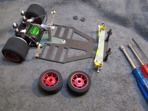

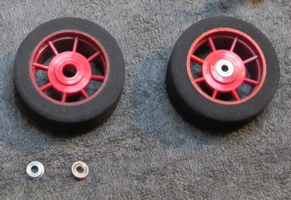

Red wheels added also. Rear wheels use 5-40 screws as early Associated RC12E wheels. So regular steel screws are used, no aluminium screws.
For the front wheels I found regular ball bearings don´t work. Parma front wheels need much smaller 1/4" OD bearings. :(
This means the project will stop here.

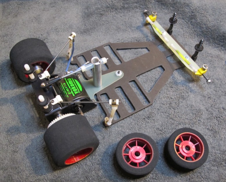

Final picture for the moment.

Received the special bearings for the front wheels now. This size is very unusual.

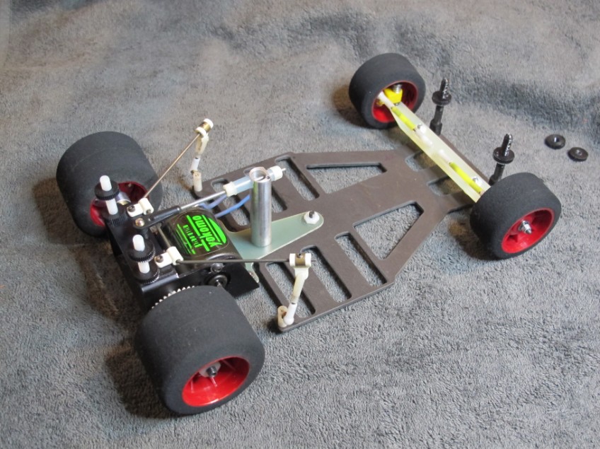

Front wheels mounted to the Parma Euro Panther Chris Arnold Special. This project is finished now. I decided not to continue with adding electronics beside the Parma Yokomo Ferrari motor, so details of chassis won´t be hidden.
Final picture also. Remember, this is a replica car using original parts. So could have been one of the cars built during prototype stage.
