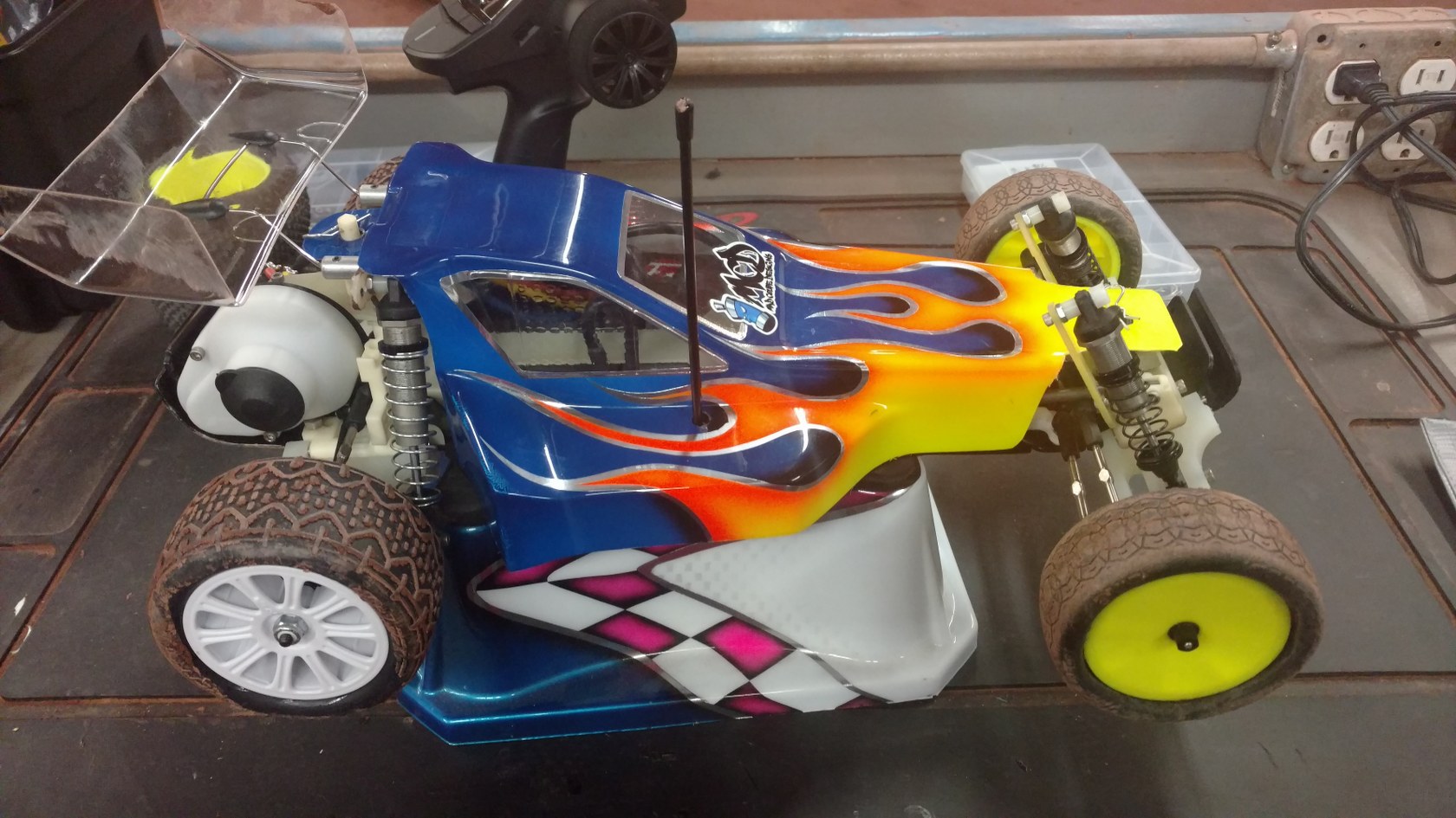

Jason, Ed and I went up to a raceway in NJ, Crispy Critters yesteray. It's pretty decent place, and the track is a red clay base.
Initially started with #2 piston 35W up front, black springs, #1 piston 30w rear, silver springs. Didn't change shocks from there, but really, I still need to figure out my tires. lack of rear traction made it pretty tough, but even with that skating, I could tell the car handled really well. We were running a practice session along with a bunch of 4 wheelers and short course trucks. This track has a monster jump over a part of the lane, and lots of carnage and mayhem happens if you can't land it right. Considering all of the punishment the car took, I was very happy with it. The rear was a bit too soft for that jump, but otherwise was suited pretty well. I didn't want to firm it up since rear traction was already poor. Jason let me borrow a set of better tires and that really woke up the car. It's nice when you can point the car and it goes in that direction
great day of messing around and sharpening the skills. The worst casualty is my wing and wing wire. In the future I may consider moving to a shock tower set up for wing mounts.
other thing is to get some better suited tires. We will probably try and make this a monthly thing, anyone that is local to this area should try and sync up with us. Practice on Sunday is 11am-3pm for ten bucks.
Shot of the car with the body Jason decided to let go.

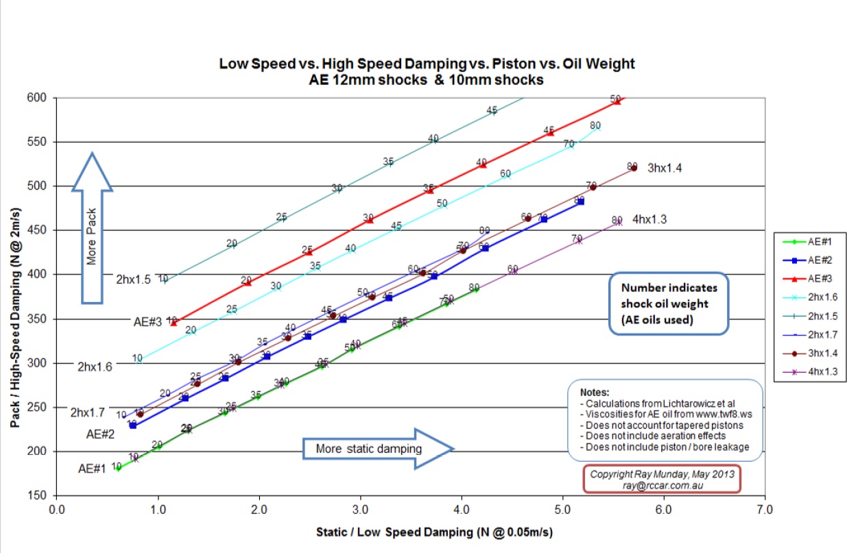

yeah, the #1/30 is a touch light. I'm afraid #2/30 might end up too stiff, maybe #1 with 32.5? Something I want to play with That reminds me, I found this cool chart that overlays regular bore and big bore shocks on a chart along with piston/oil combo so you can study how to adjust both to get the right feel for the shocks. I'll add it shortly.

Amazing how close I am to my 'standard' set up with that chart and my big bore shock car.
10mm 12mm
#2/32.5 front #1.5/30
#2/30 rear #1.5/27.5
10mm 12mm

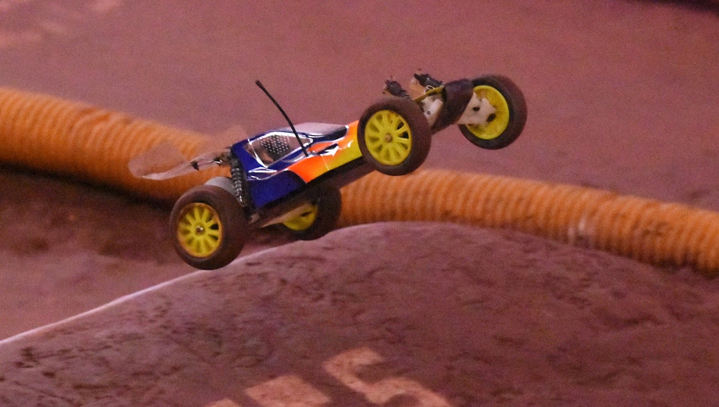

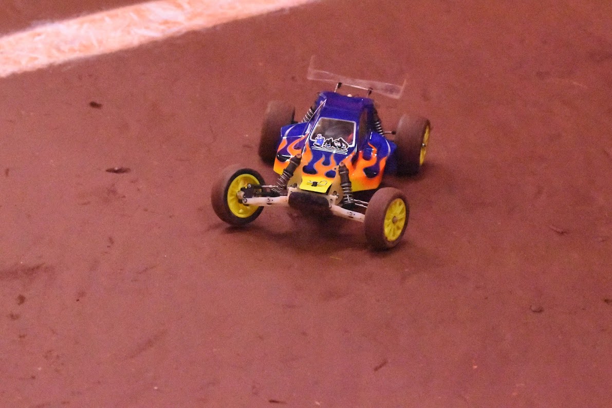

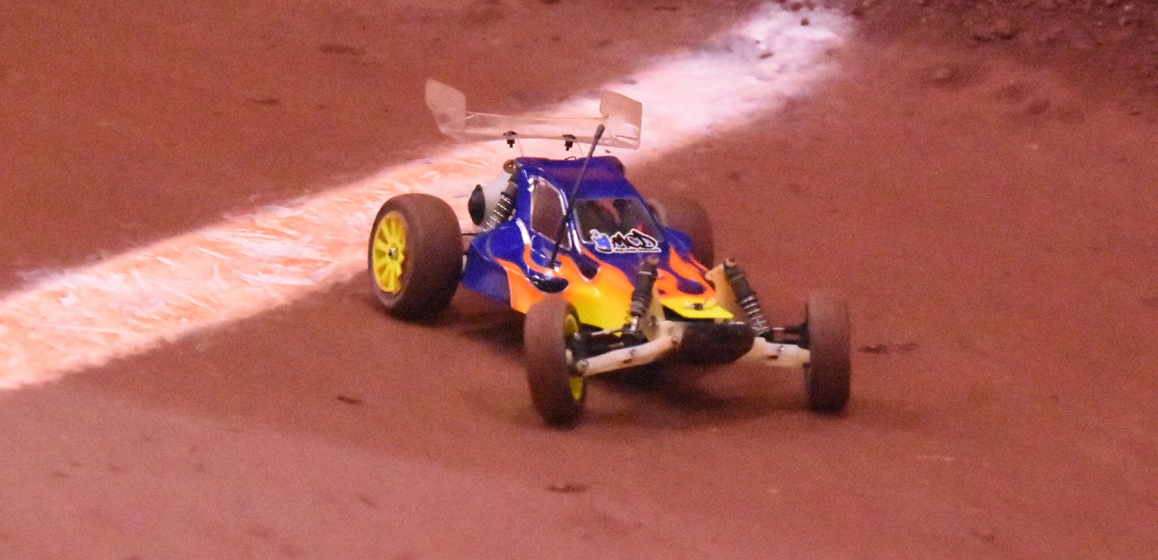

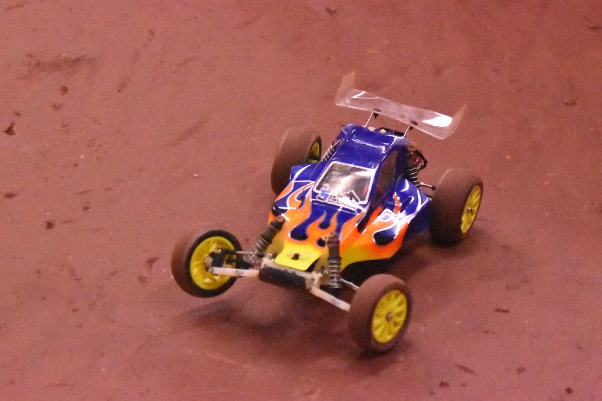

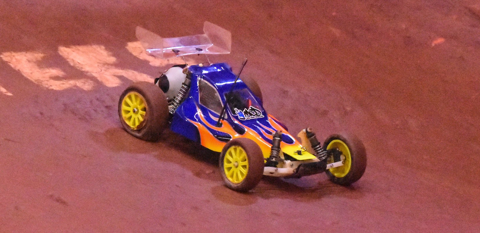

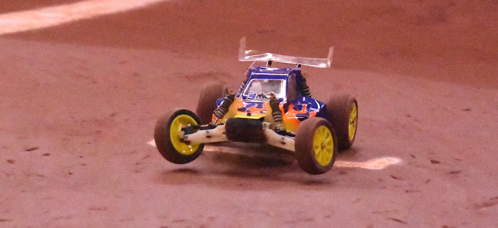

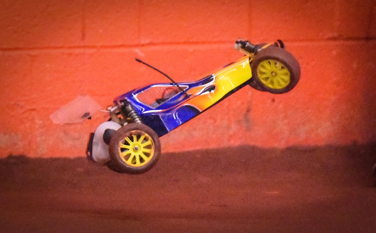

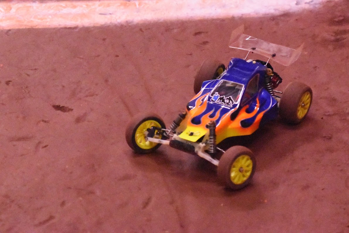

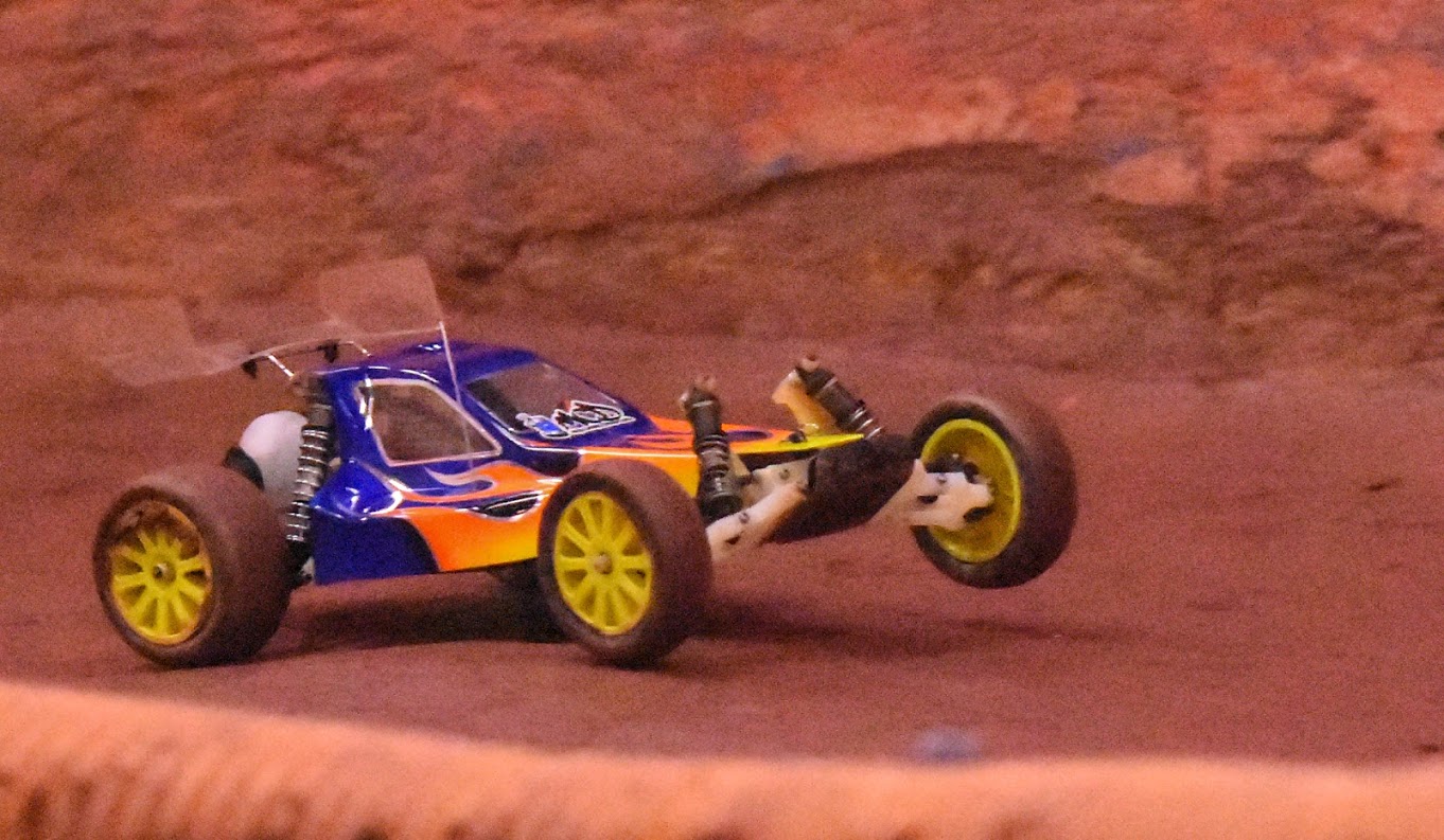

So this update is on the scale of Scr8p, although this is not a build update per se, but some action shots taken last year (HAHHAH) at Critters racing up in North Jersey for the Vintage race we had sponsored.
There are some great action shots showing some nice traction and suspension articulation, the sequence is a hard jump up at the end of the 'back stretch', into a sweeper dropping altitude with some bumps, into the front straightaway.
